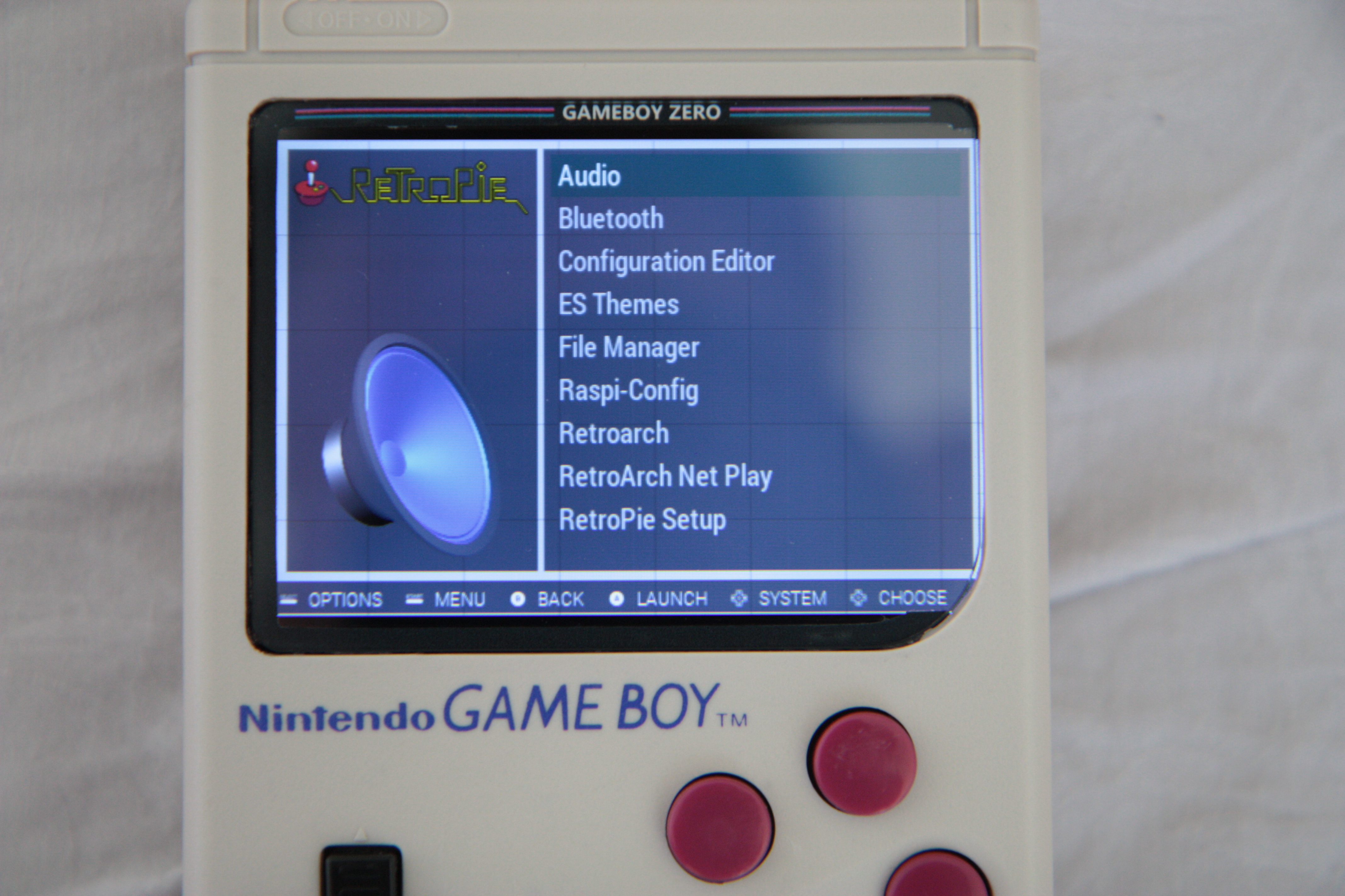

Here some pictures of the HDMI display I used from aliexpress...
Hard to explain but the display looks more clear by eyes than the camera is capturing. Maybe caused by the screen refresh frequency. Not visible by eyes...
As I wrote previously in the other tread the screen ratio is something like 16:9 in stead of the 4:3 original... As I keep the cut-out from a previous BW display a managed to cover the space below and upon the display by a bigger screen label. Another argument for keeping the 4:3 cutout was to re-use my existing screen protection cover.
To get the right boarder visible I need to cut off the screen boarder label.
On addition I need to mention that I removed the touch layer (similar to another tread here). No need from my point of view during running retropie.

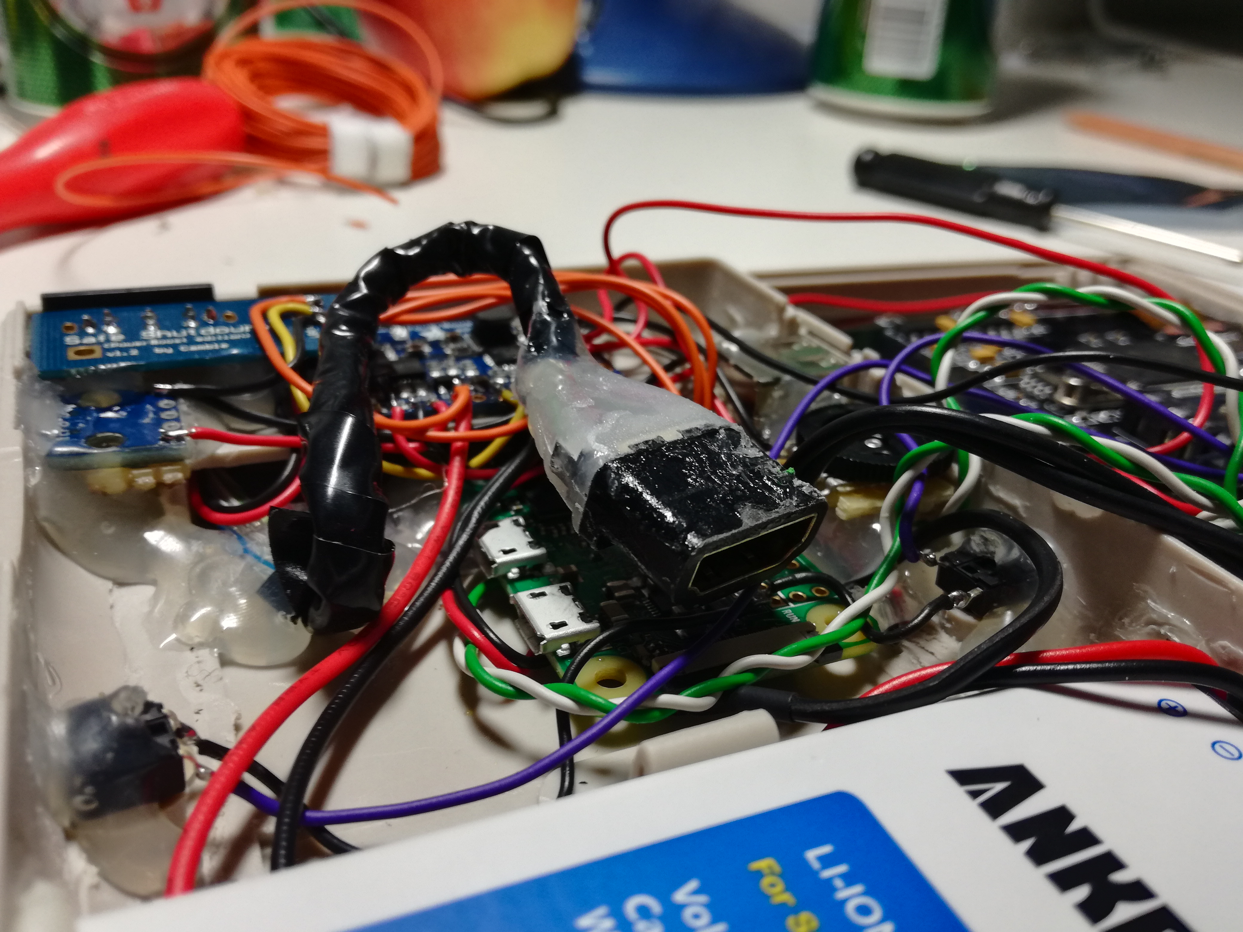

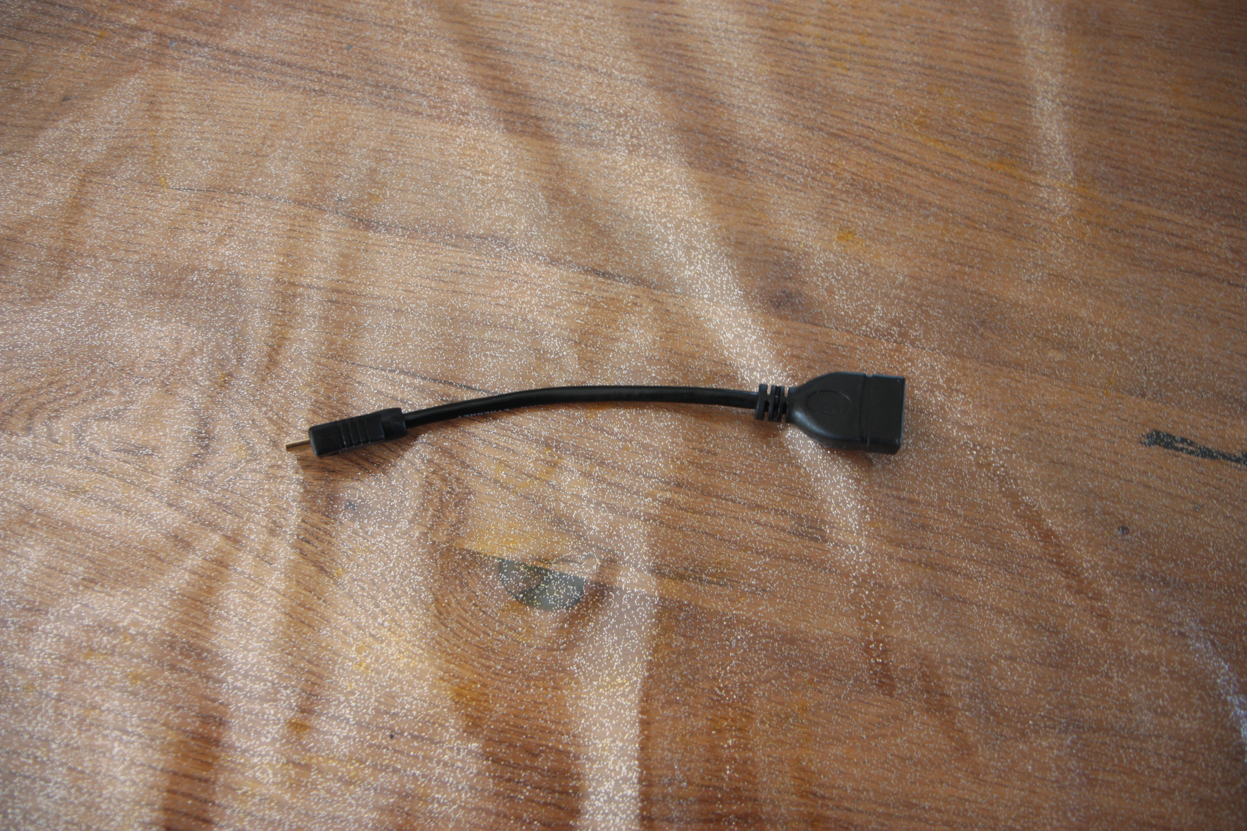

I installed the display 180 degrees turned to have the HDMI connector accessible from the bottom. My Pi Zero is located in the game catridge bay to have external access to the Micro SD Card. For wired HDMI connection I used an approx 15cm HDMI-Mini- to HDMI cable with stripped outer insulation and stripped off connector housing. (quite easy to remove with some help of heat and knife). The harness is internally insulated by aluminum foil. For avoid shortcuts to neighbor circuits I wrapped this harness afterwards by some tape.

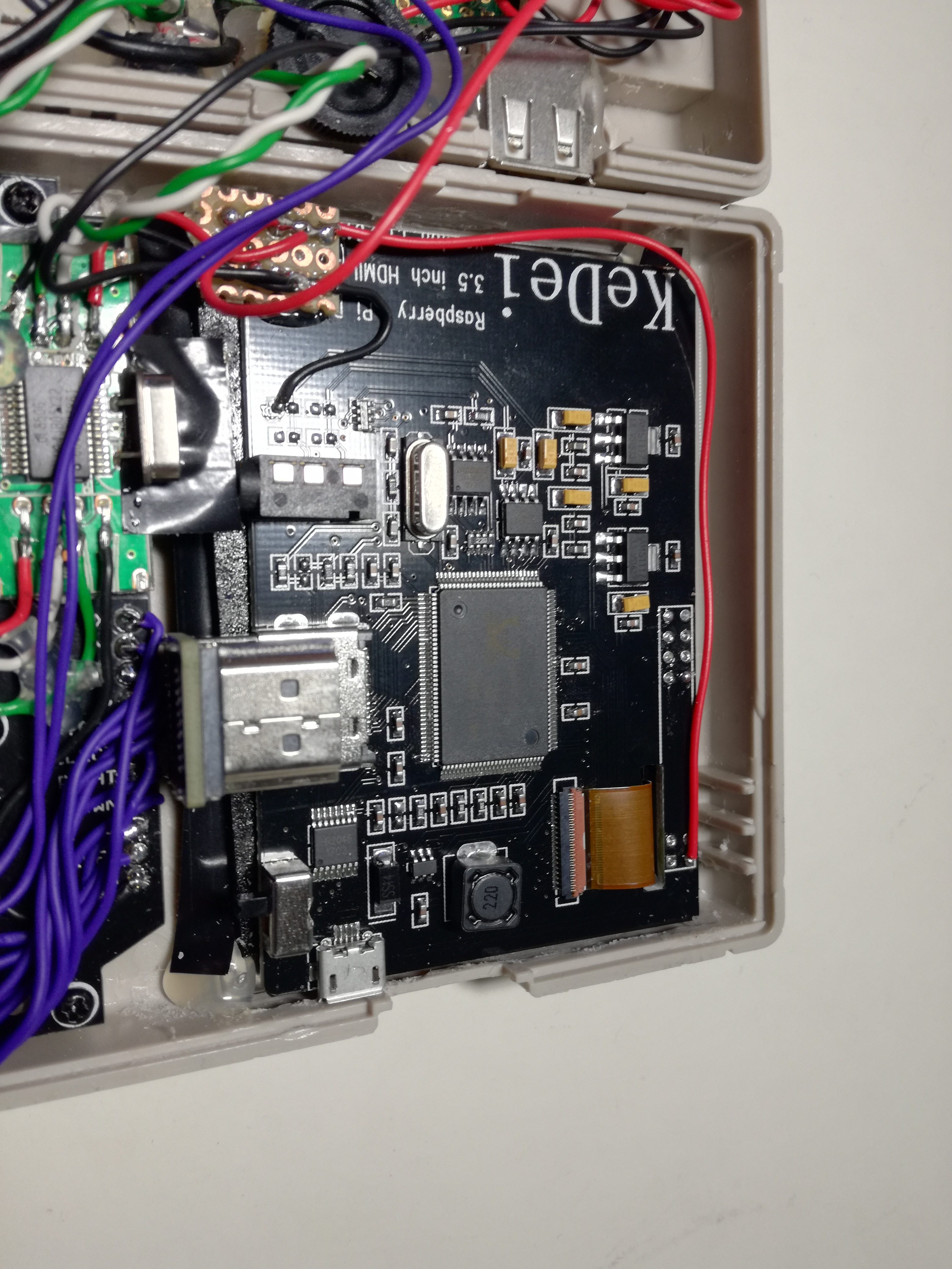

-Display controller board does not fit into the gameboy: needs to be cut for some mm. (not difficult)

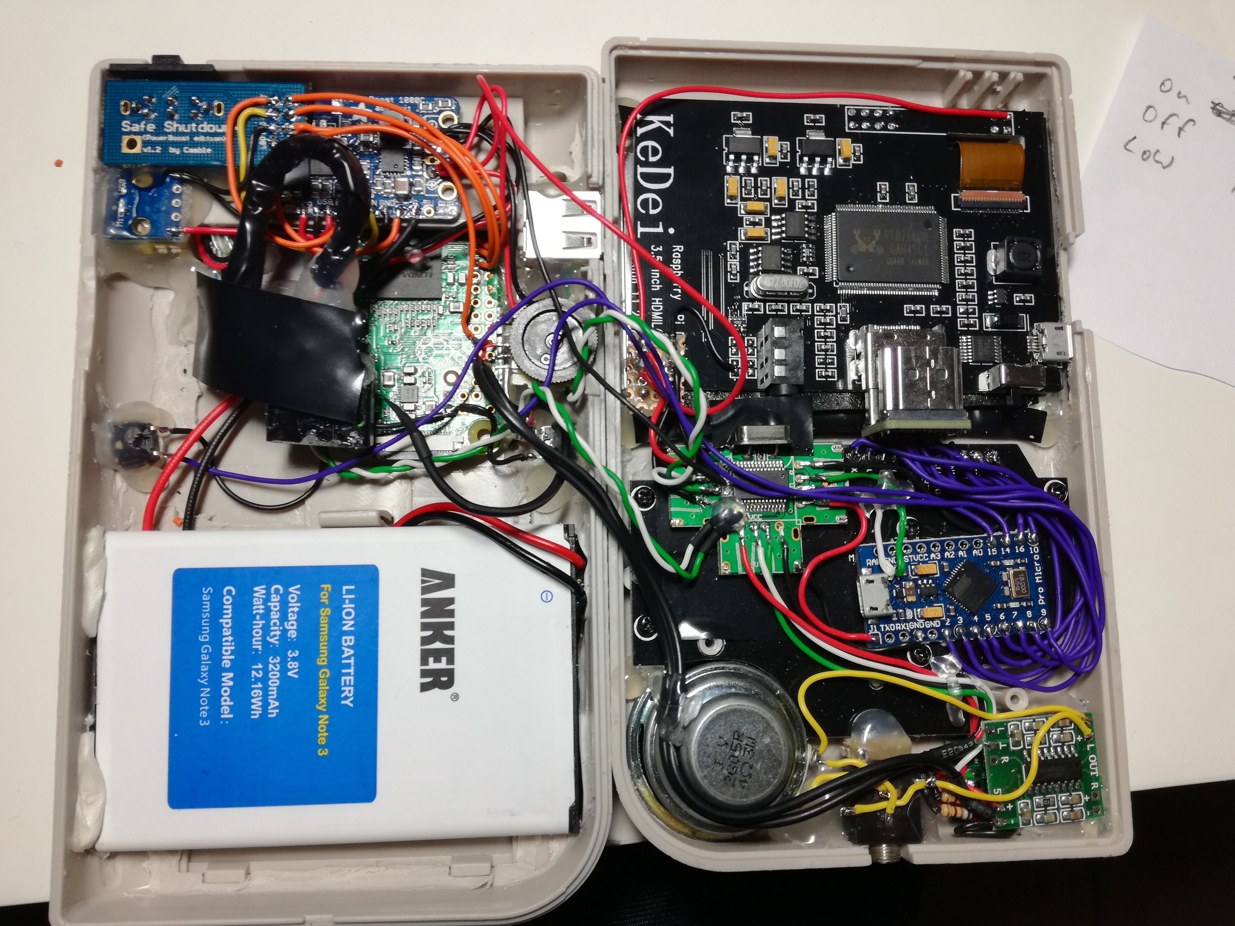

As announced, pictures from inside...
