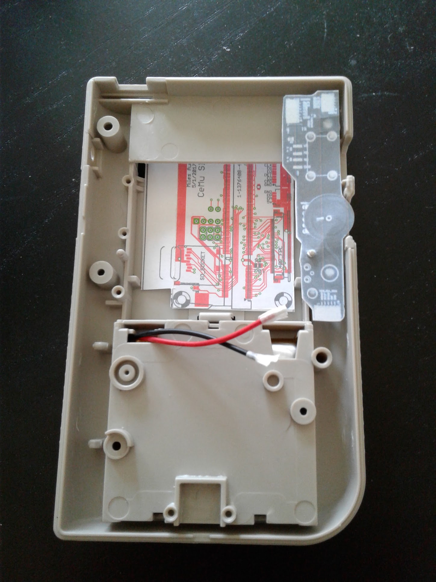

This is the possible placement so far.
I'm thinking I'll just need to cut out the cartridge bay and cover it up with part of a game cart on the outside. Once I get more parts in my hands (instead of paper cut outs), then I can see how things go like with the cables plugged in and such.
Here's a mockup if it and Kite's board together. Shows how it might look straight on or flipped down both at once. Since I made this I decreased the size of my board significantly so the images here make it look pretty big. I didn't try to mock up what the cables would look like twisted portrait like I plan to have it in the case.

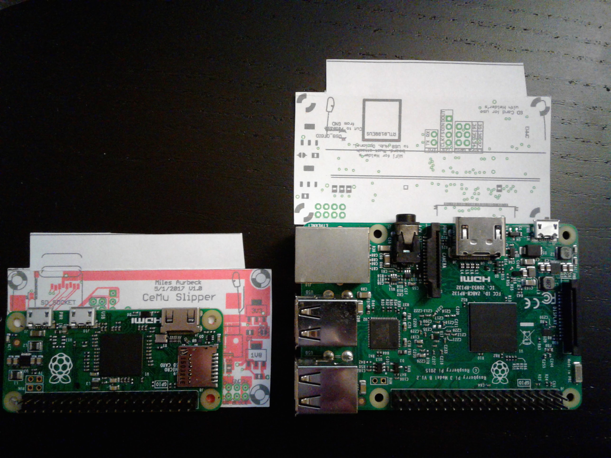

This is the size comparison of my prototype against the Pi Zero and the Pi 3. You can see that it's a bit smaller height and width than the Pi 3, but the main advantage is the height gained. My board's height will be about 6mm whereas the pi's is about 18mm. Plus, there's no painful modifications required. And there's no power hungry ethernet/usb jacks either.
The white flap hanging off the top of my paper prototype shows the expected reach of the Compute Module once it's plugged into the CeMu board.

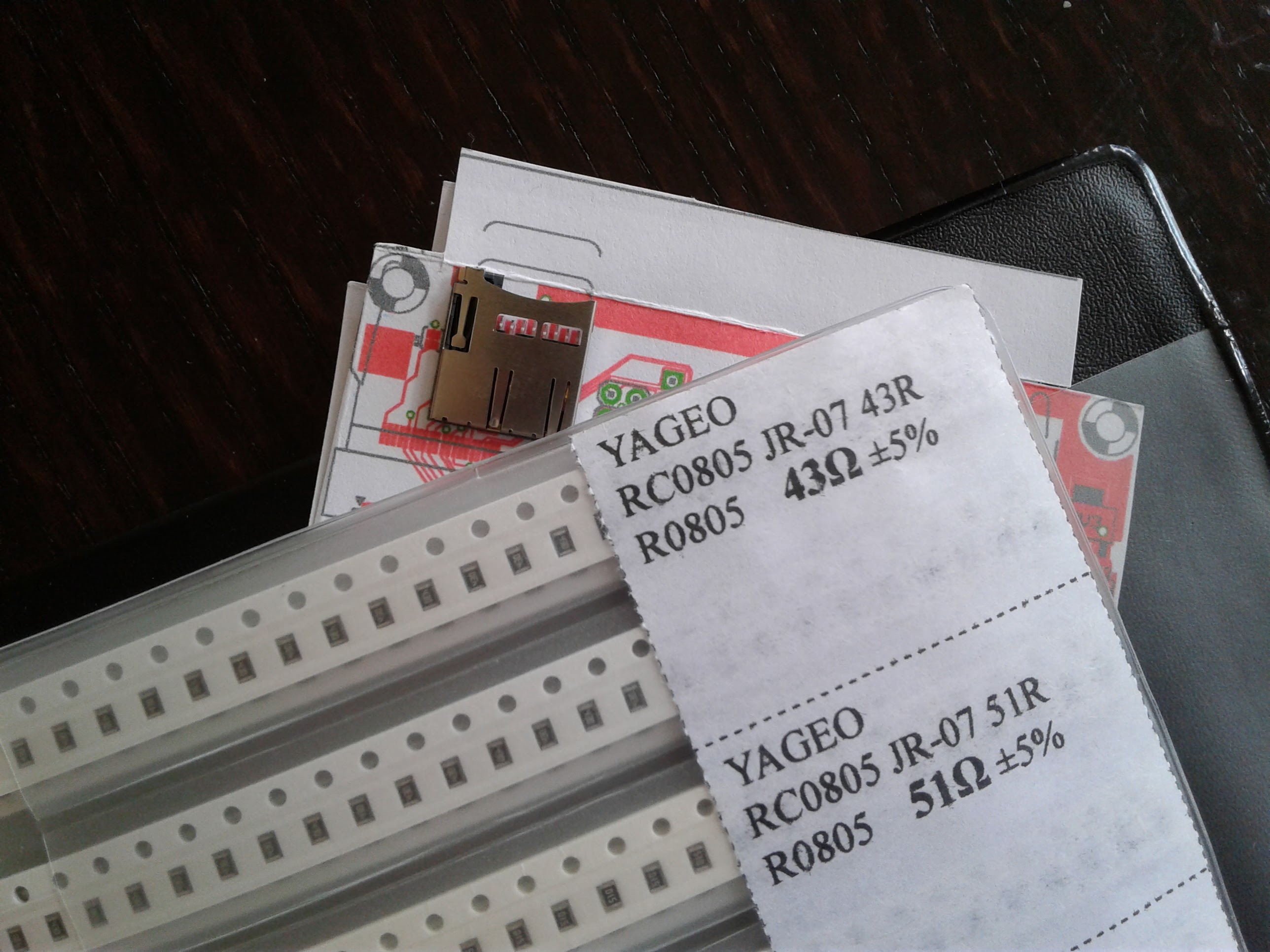

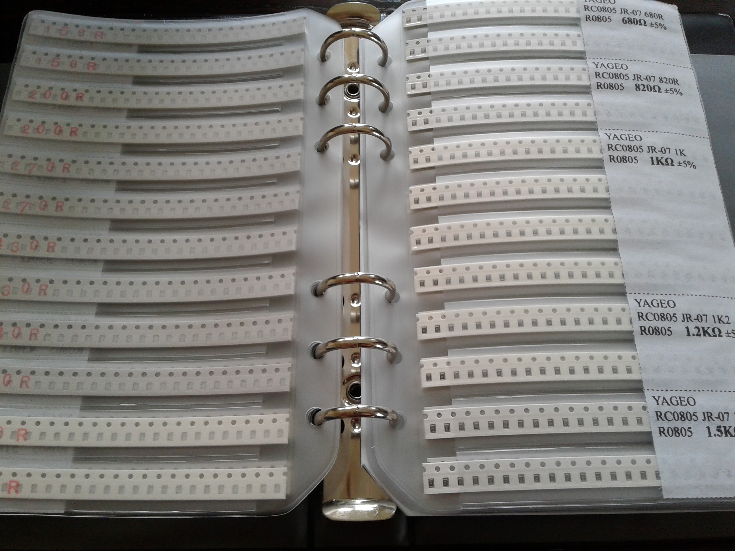

More parts from Mouser.
The SD socket used in Adafruit builds. I chose this because it will be easy for my to solder the prototype by hand.
PAssives Book.jpg (632.65 KiB) Viewed 29552 times
I also got a book of resistors and capacitors. I chose this one because it had a more curated count per value based on how common they were, plus some of the electrolytic capacitors I've gotten from China before were on spec for certain things but way off assumed specs on others. I wanted to make sure there were no secrets in these parts, so I paid a bit more for them to come from a US distributor. It's still got Chinese characters and such on the book, but whateves. Trust is expensive.

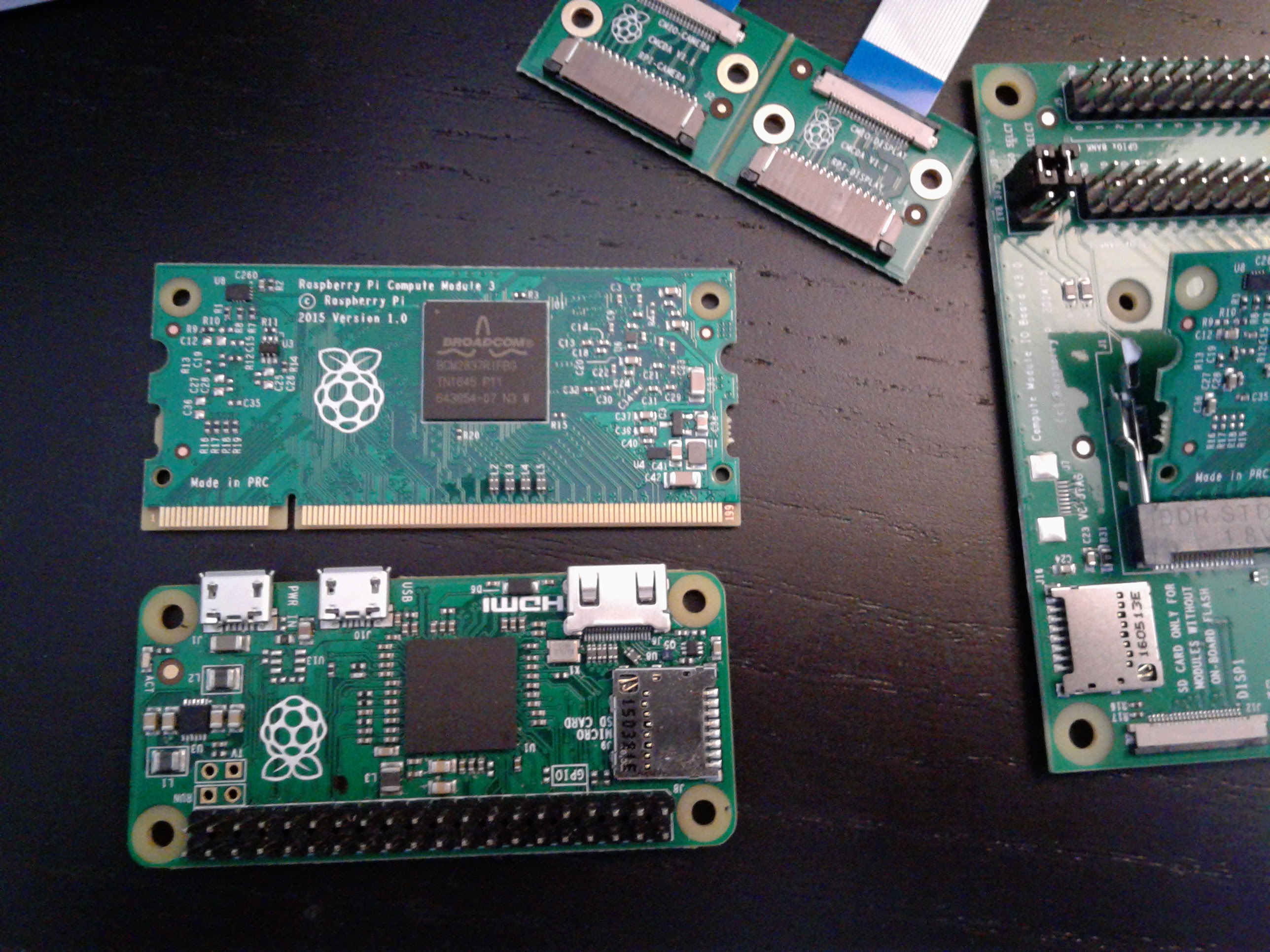

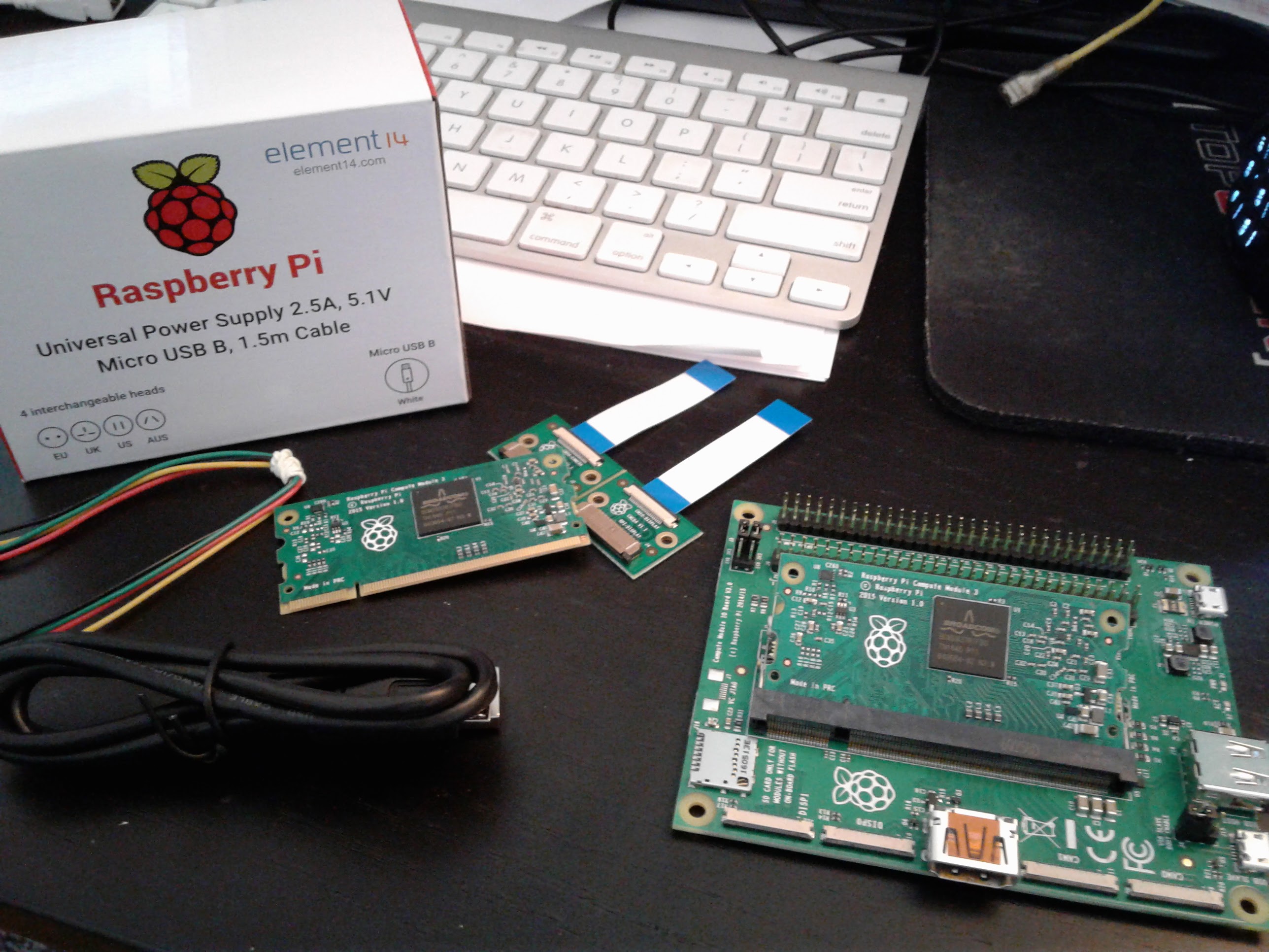

I got the Compute Module 3 Dev board in. This thing is neat, and at $200 it's probably the most expensive electronics tool purchase I've made so far. The next expensive was a $60 hot air station with a soldering iron from Ebay (unless you include Kite's SAIO).
That's all the bits that come with it.
You can see it's about as large as the Zero. What you can't tell is that it seems paper thin. I'm afraid that I will snap the thing like a potato chip.

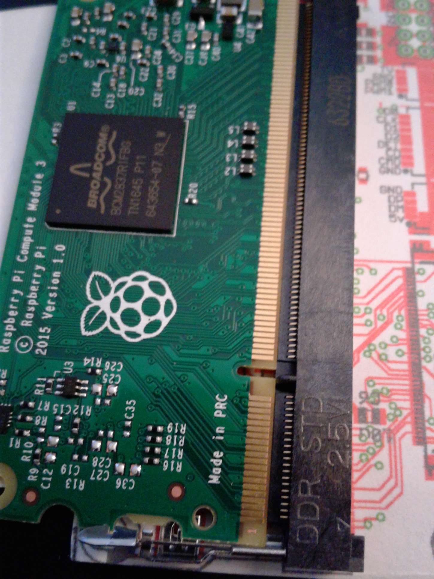

While checking out the fit, I noticed the mechanical key doesn't line up >_<
The datasheet for this part was shared amongst like 7 very similar parts and was really convoluted. Also, the Eagle Library provided by the distributor was of a memory module, not a connector. I'll be ordering another 3 of the appropriate ones.

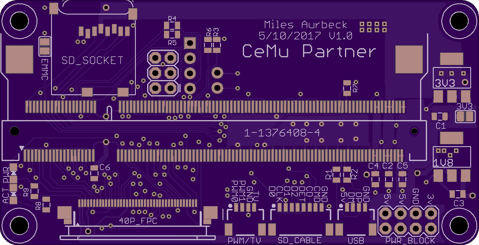

Update #4:~~~~~~~~~~~~~~~~~~~~~~~~~~~~~~~~~~~~~~~~~~~~~~~~~~~~~~~~~~~
Just got word that my PCBs have been received by OSHPark and were awaiting depanelization. Then one minute later they had been shipped apparently ^_^
This is a bit earlier than I expected!
