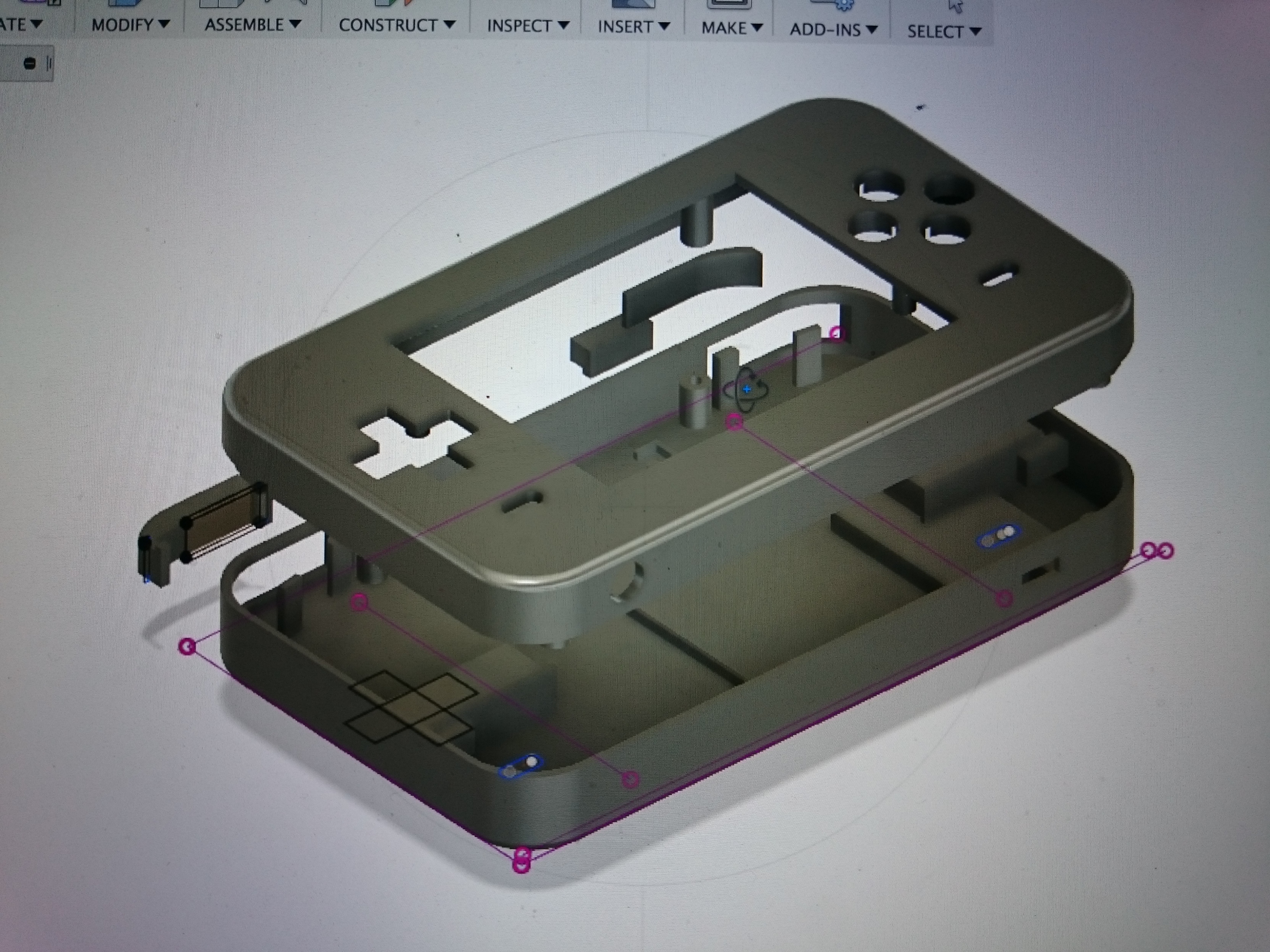

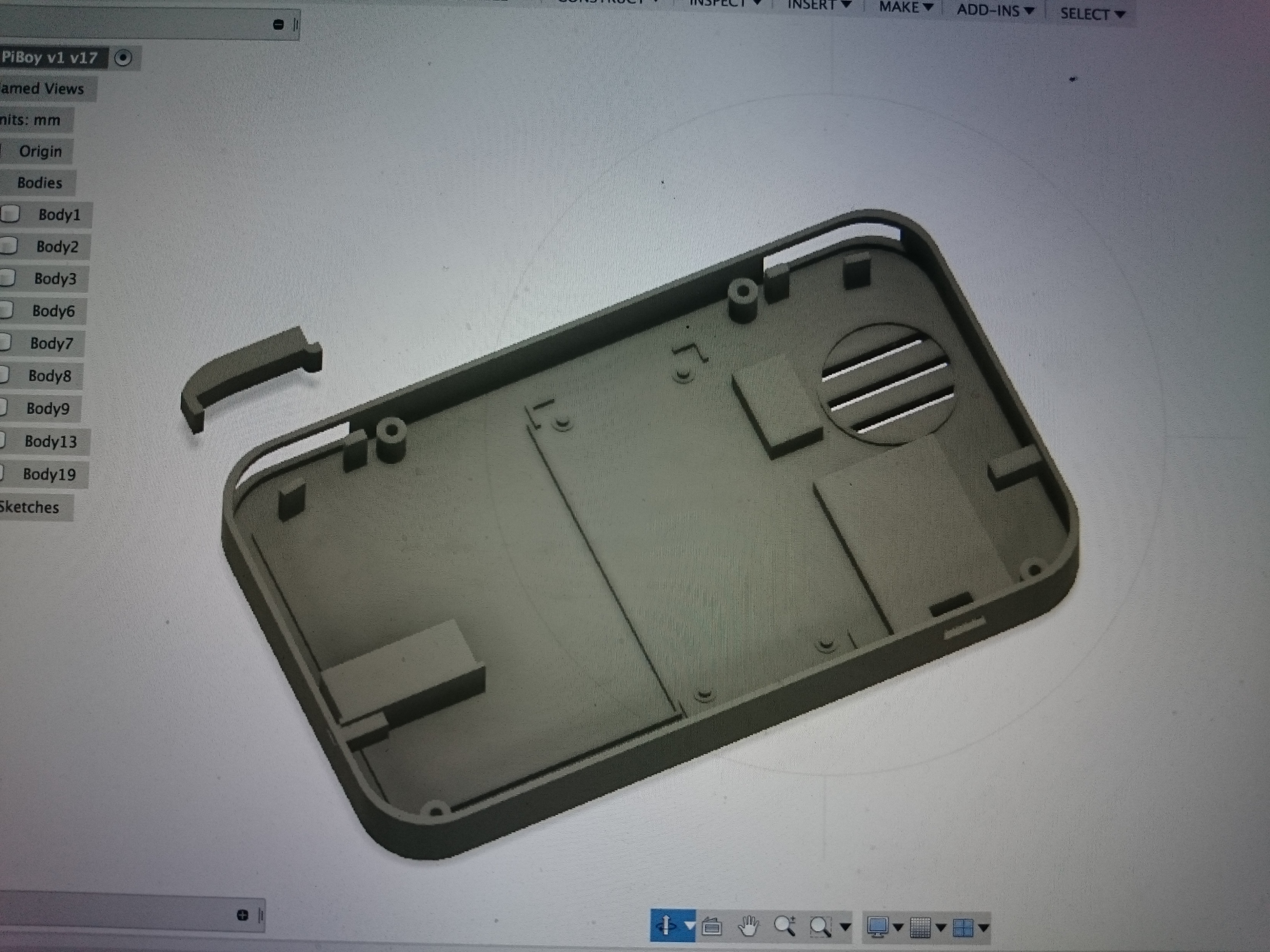

Gone are the days of franken-casing, when I could design my own case on Fusion 360 and 3D print my own design. Using a digital caliper, I measured all the components I had bought, sketched them in Fusion and created a case around the sketches.

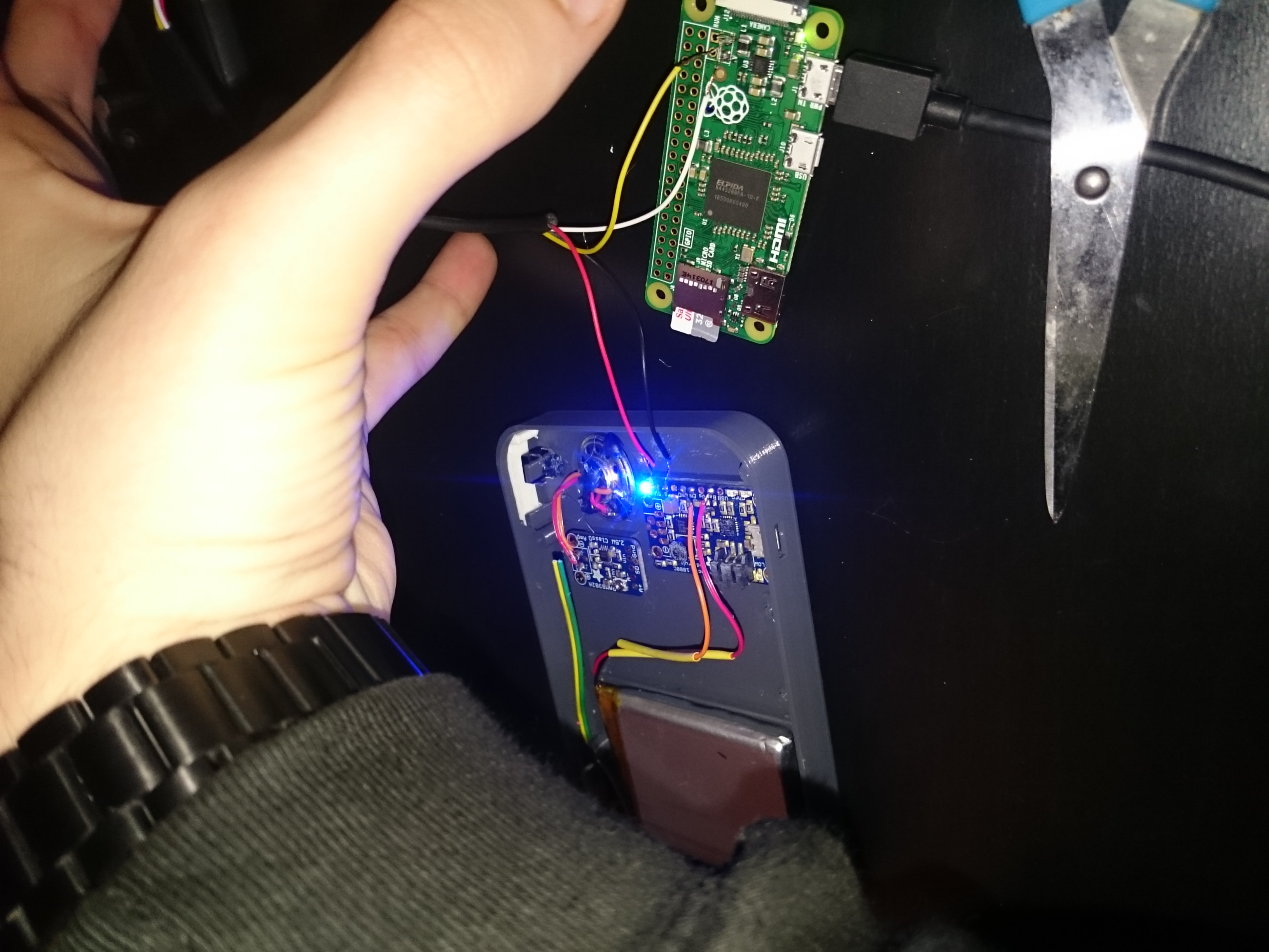

From this, I printed the models on our fancy new printer, and tried initially did a fit test to make sure my measurements were right, also made sure the Pi Zero worked on my 3.5" screen.

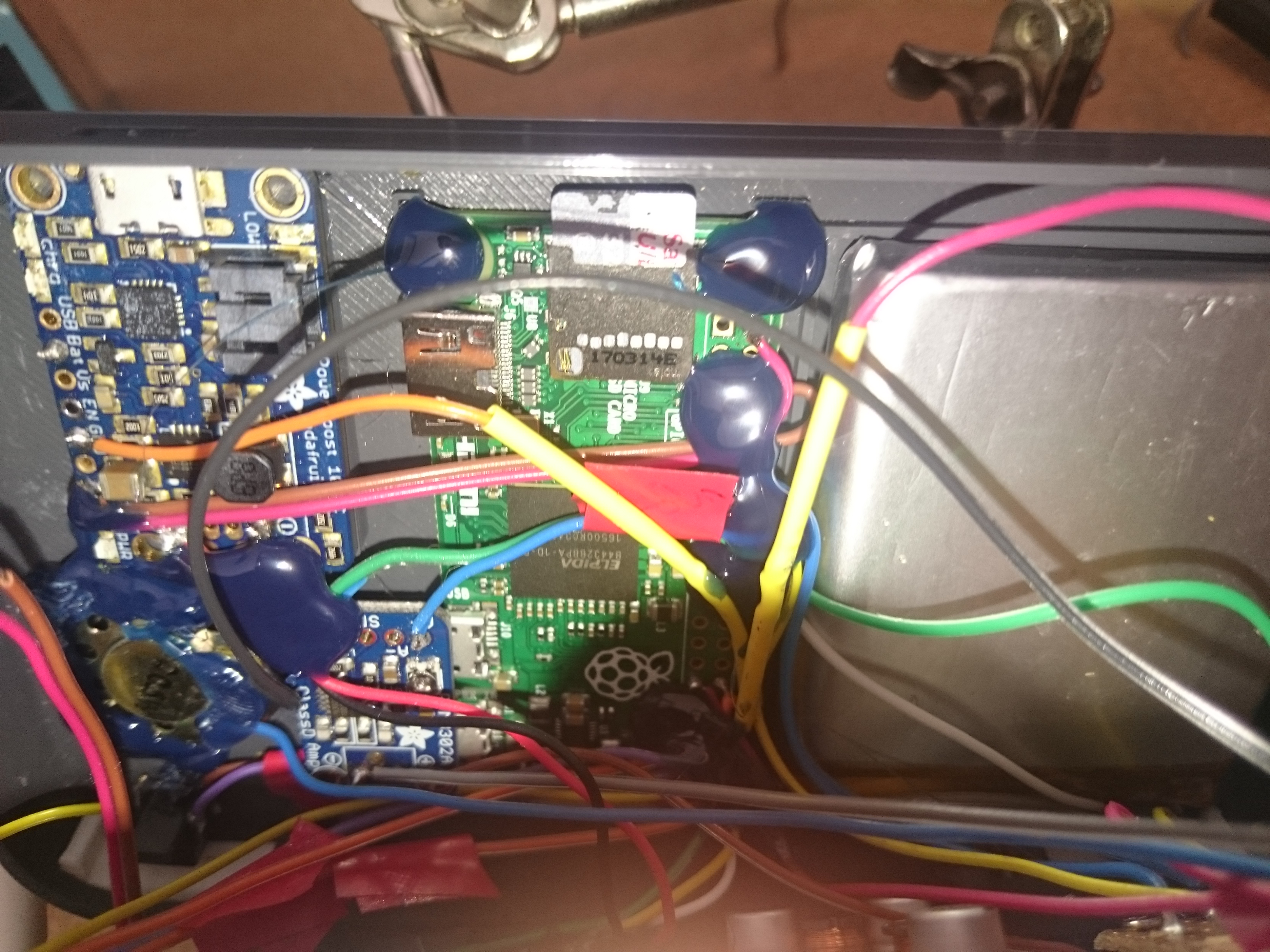

Seeing that everything worked, I then had to burn my image on to my SD card, and figure out how to gain audio out from the GPIO pin. There is a very handy article on Adafruit, which shows you how to get audio out from GPIO#18 using an alternative function on that pin: https://learn.adafruit.com/adding-basic ... -pwm-audio

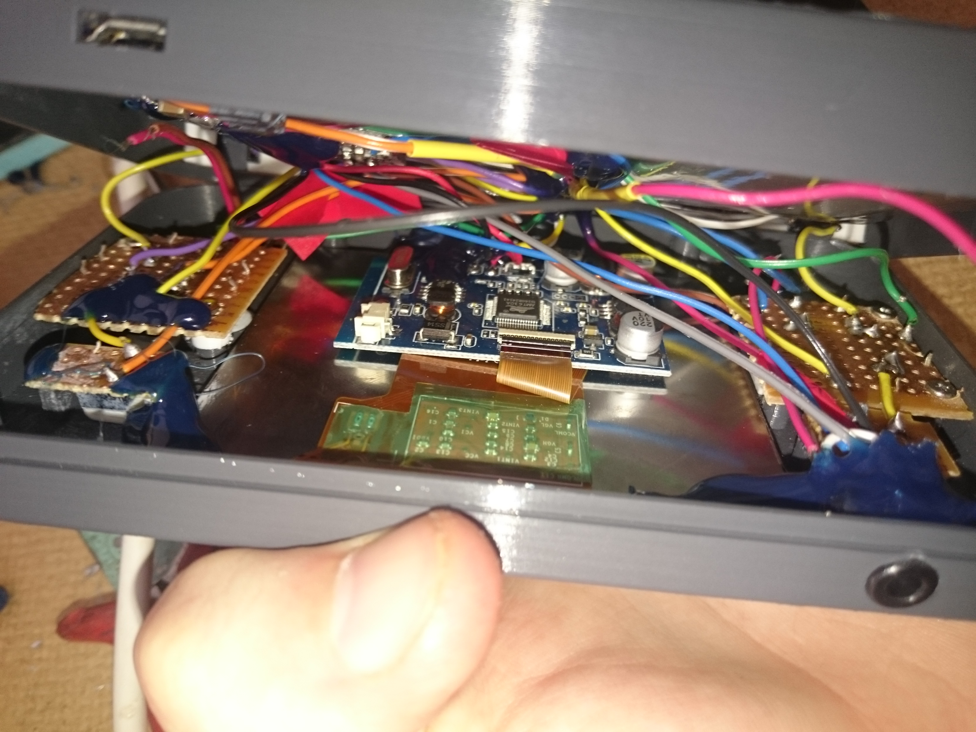

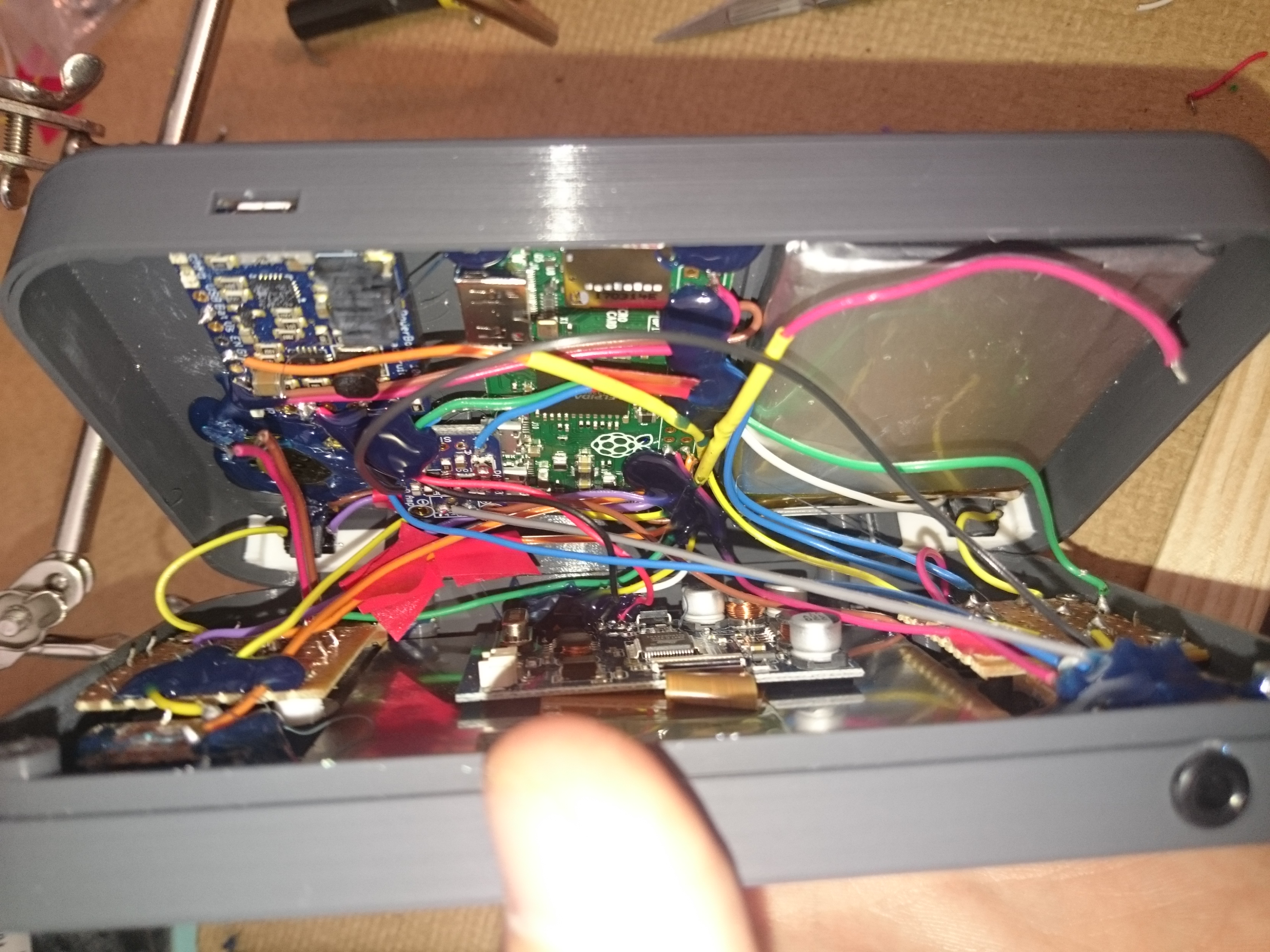

After getting these working, I hard wired everything together and placed it all inside the case (this was the less time consuming part of the build surprisingly!).
N.B. The wiring was not the most tidy of wiring jobs :roll:
Everything worked first time, which I am very surprised about!

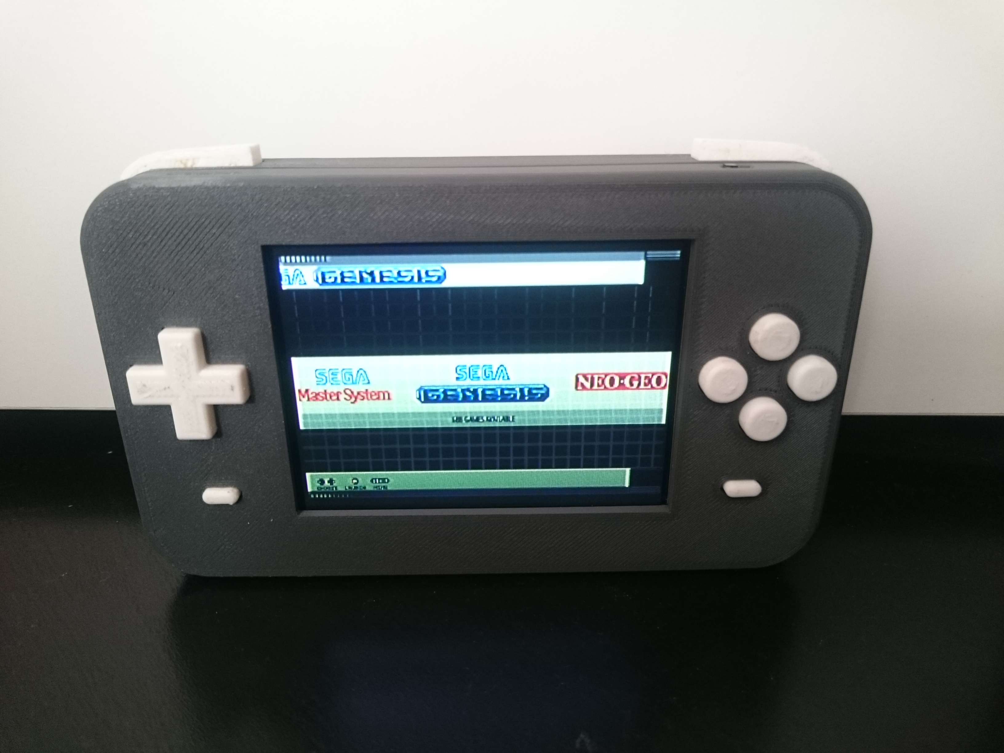

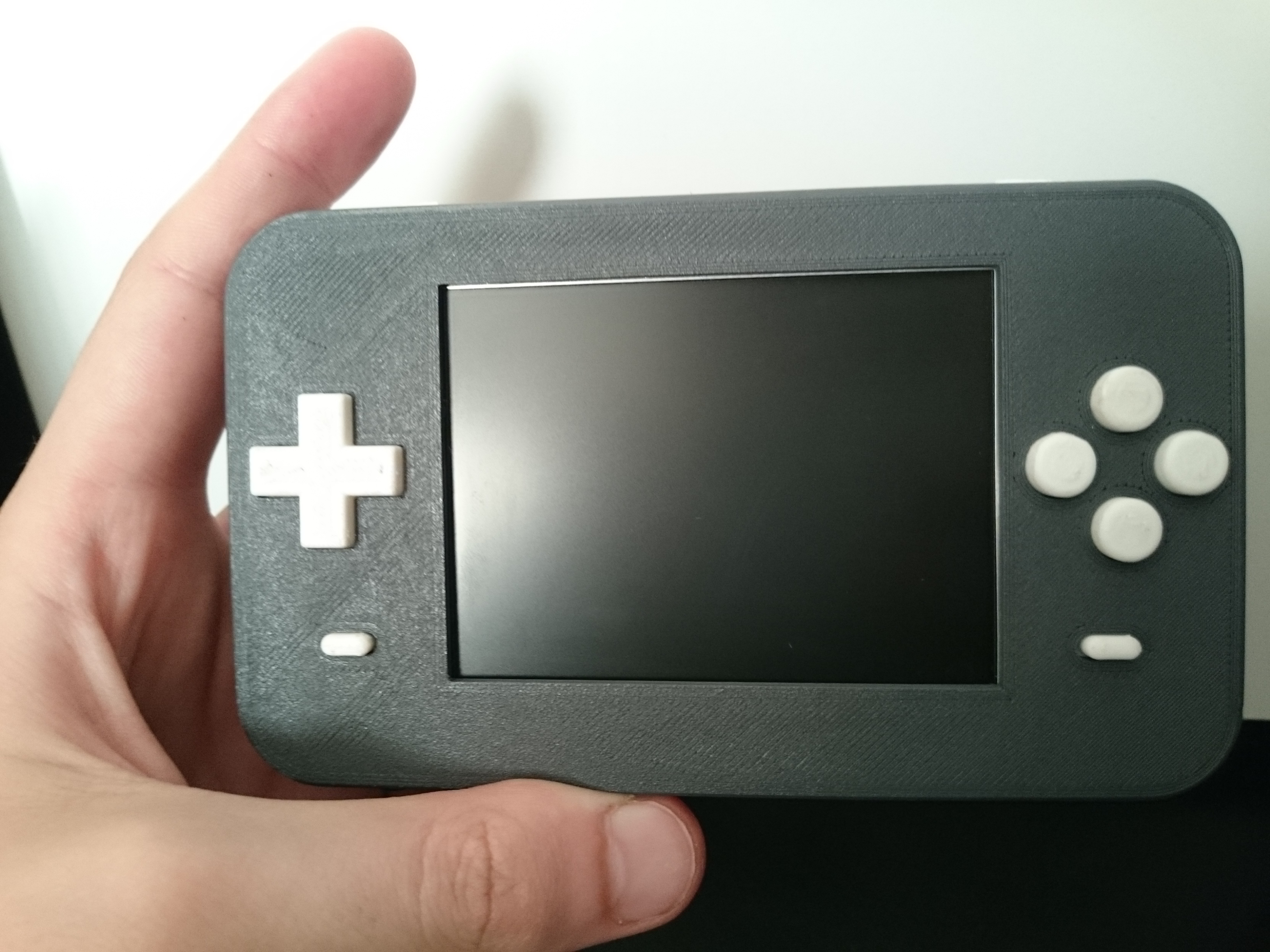

Few things I would change for next time:
- The video out is from one of those rubbish composite reversing screens, the quality is naff, but good enough for a first go. Next time, I would look at getting something which outputs better quality.
- The audio is not the greatest, it struggles with highs and lows.. I have seen people using USB Audio adaptors to get their sound, or even follow Adafruit's guide to creating a Low Pass Filter. But for the efforts of a first time, the audio works fine :D

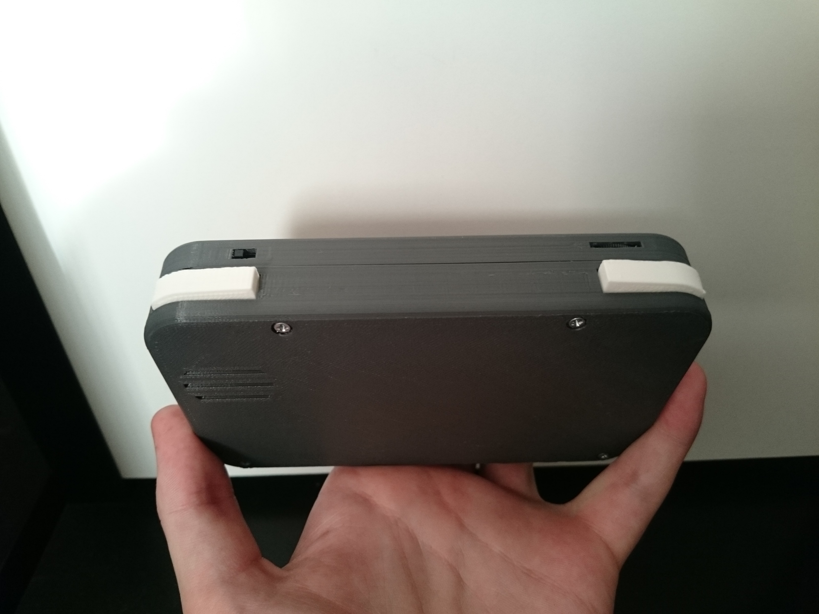

- The image which I downloaded, does not have working roms for Arcade and Neo Geo, which is a slight bummer. Not to fear though as the Nintendo and Sega roms work great! And as I cannot remove my SD card now as the Pi is hot glued in place.. it will have to do 8-)
- I bought those rubber tactile switches and thought I would try them for the buttons.. I'm not a fan of them for the 4 circular buttons, however they work great on the shoulder buttons!
And there you have it!

is it comfy to hold?

Thanks man, it's very comfy. I have quite big hands and it fits nicely for me!
