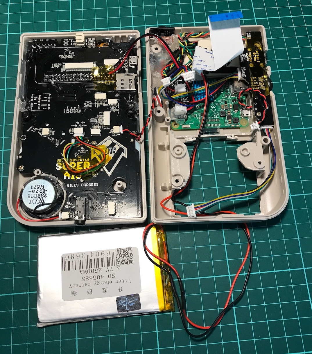

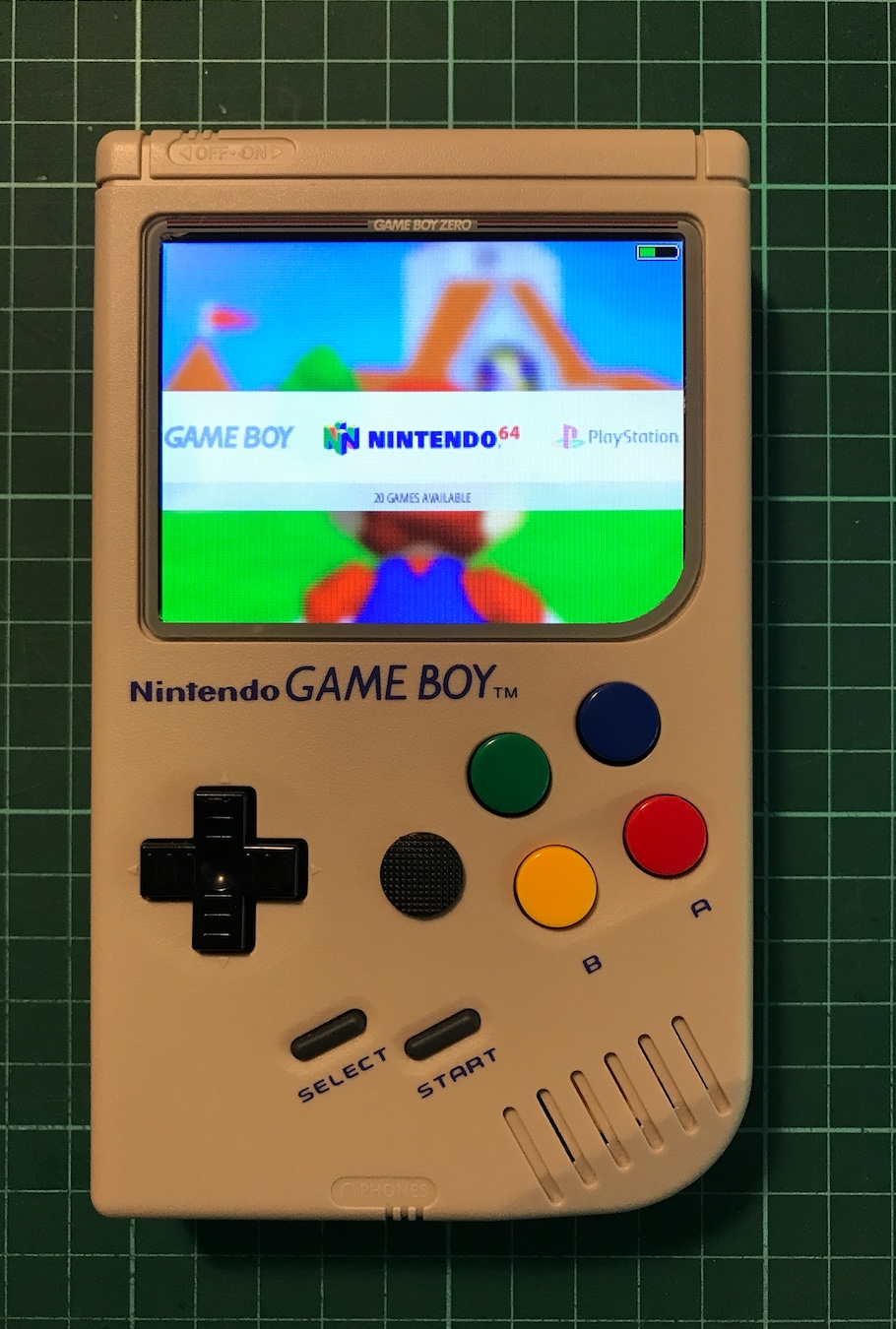

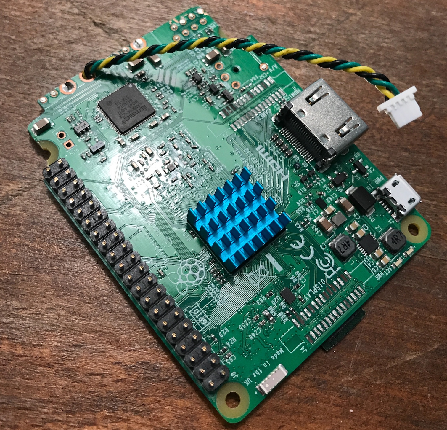

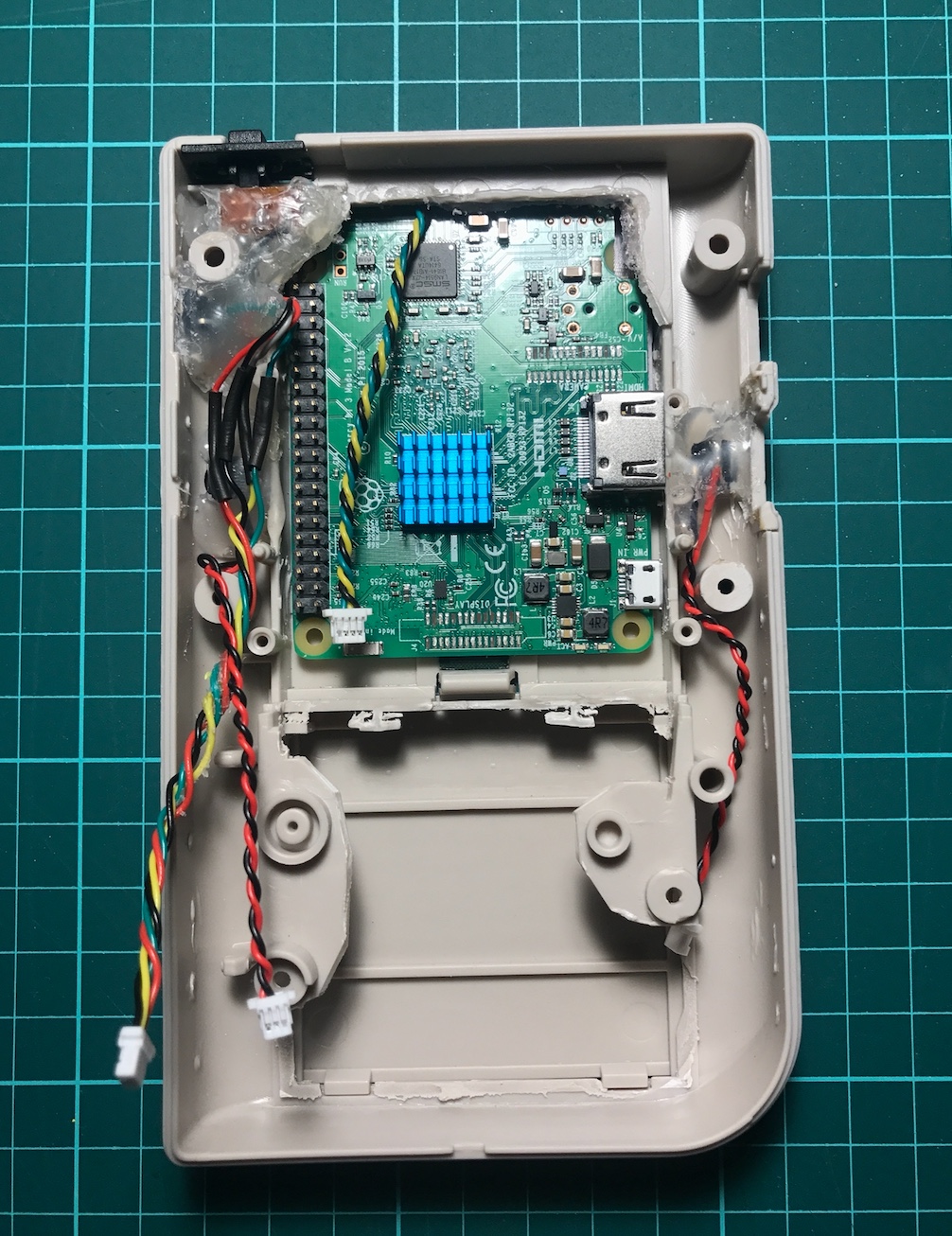

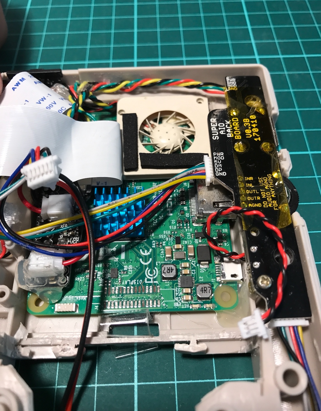

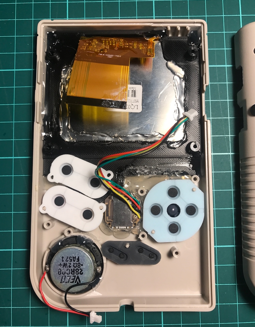

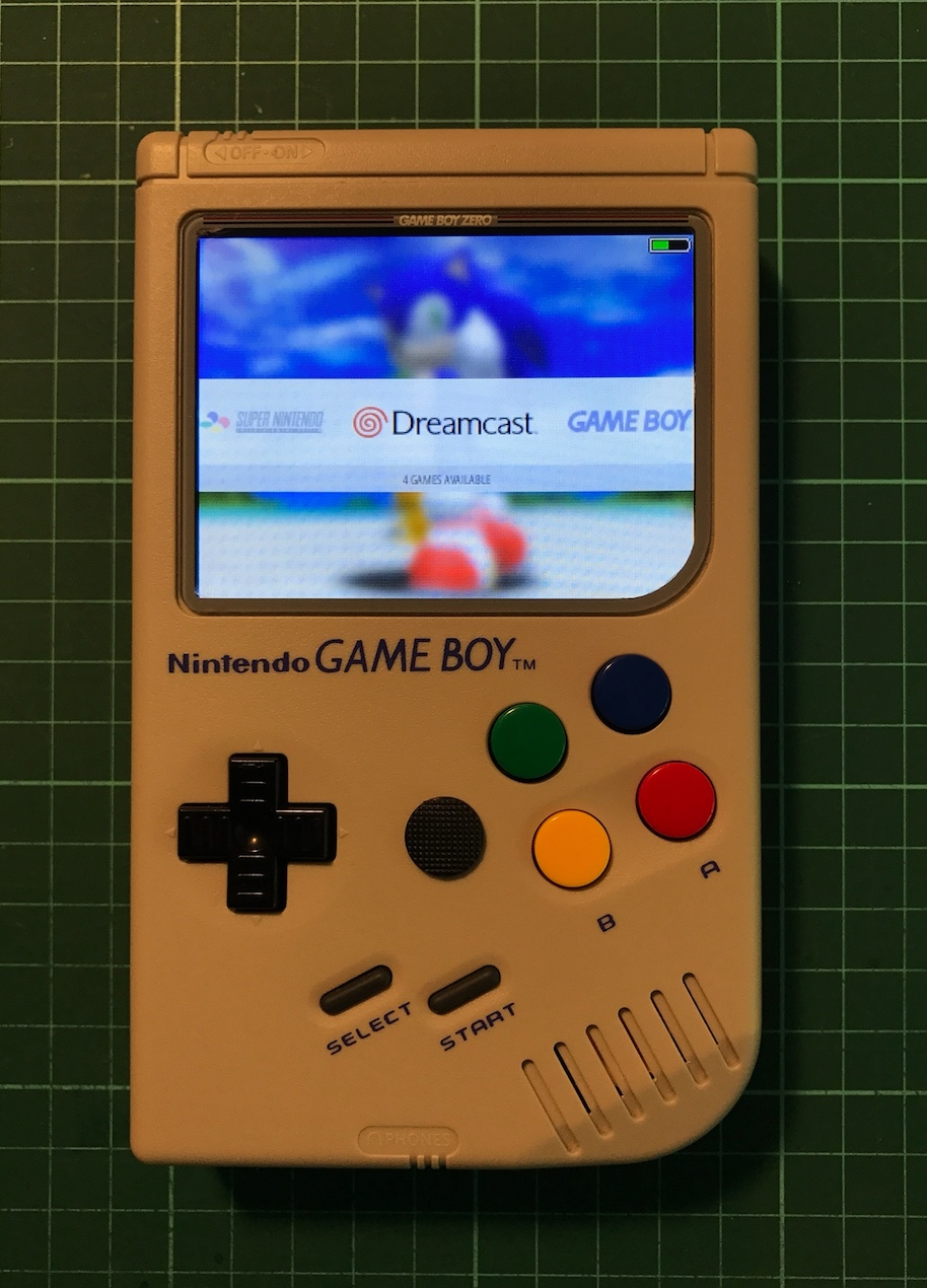

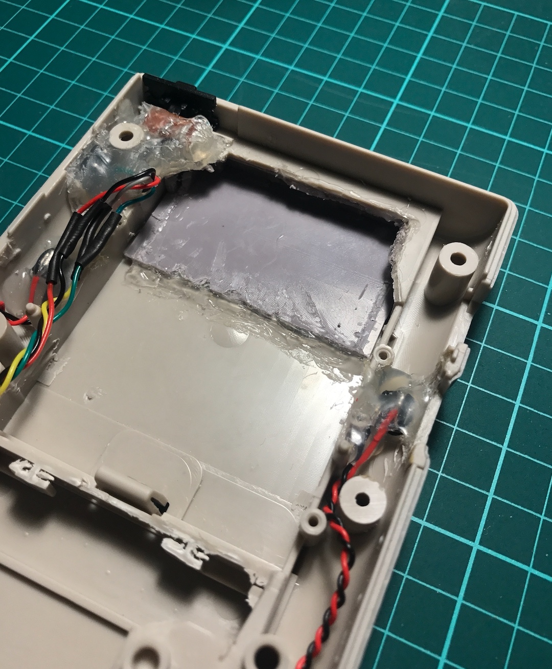

I want to show my first GBZ Build. I started with the Idea of using a Pi Zero, but switched later to the much faster Pi3 because I want to play some nice N64 games. I hope some of the pictures will help anybody to get an idea how to fit anything in the case. When I started with the project, it was very difficult to find good pictures of an Pi3 Build.
These are my overclock settings:
arm_freq=1350
gpu_freq=525
core_freq=525
sdram_freq=600
sdram_schmoo=0x02000020
over_voltage=6
force_turbo=1
over_voltage_sdram_p=6
over_voltage_sdram_i=4
over_voltage_sdram_c=4
v3d_freq=525
temp_limit=85
gpu_mem=512
avoid_pwm_pll=1

Congrats! Nice build! What theme is that? And where did you get those good looking buttons? :)

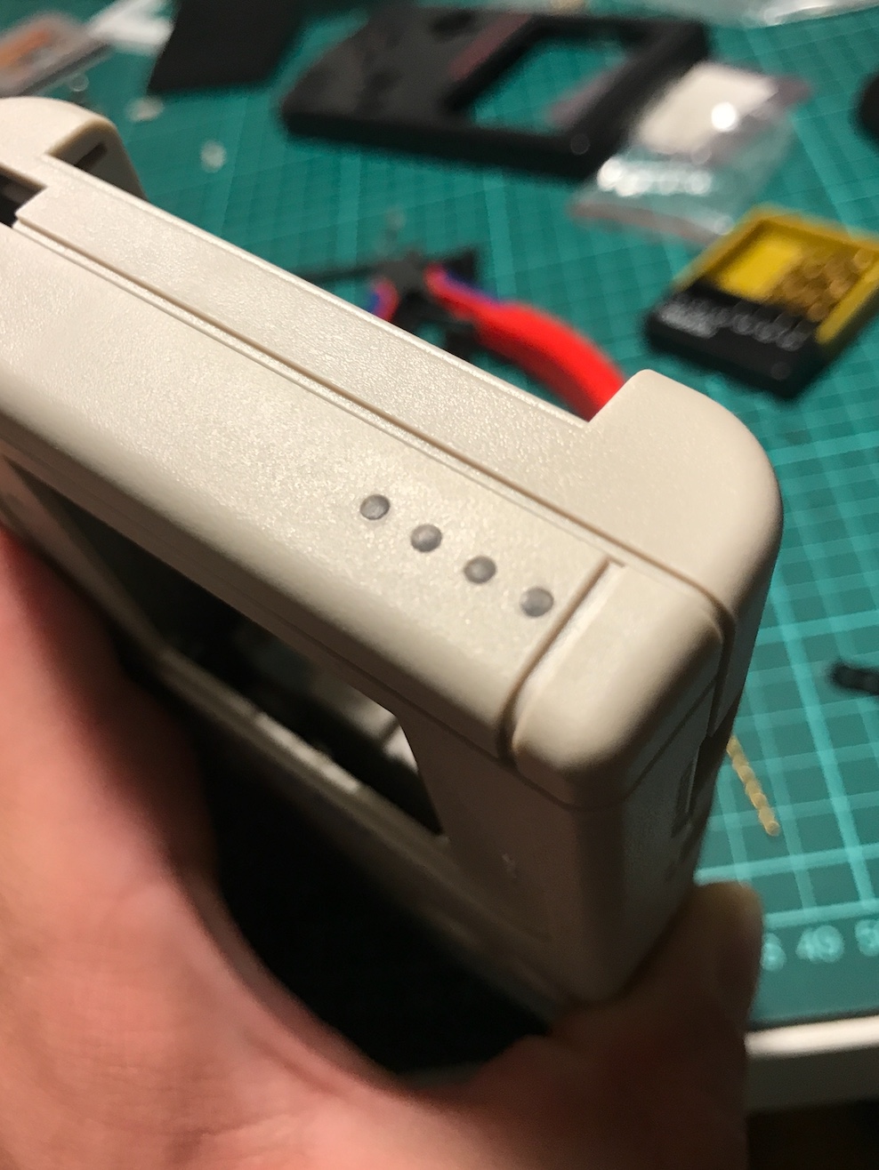

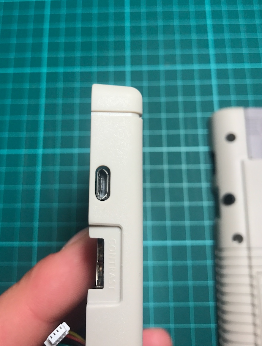

How did you drill that perfect hole for the micro usb charging port ? :shock:
The hole is just... perfect :D

really nice build... (top job)....
the SNES/Famicom coloured buttons, where are they from....

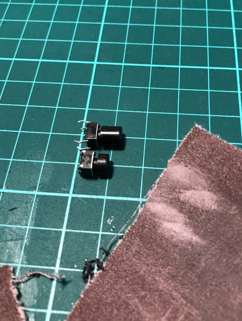

also the caps, did you cut them (if so, how) or did you buy them (if so, where)
thanks....

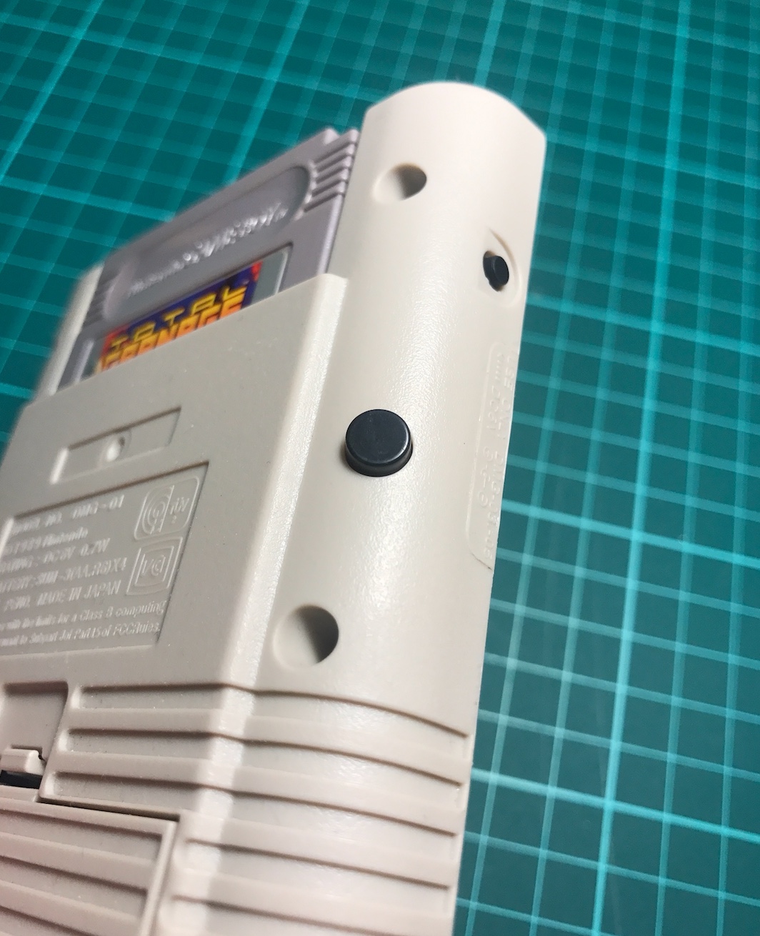

I only fear for the backbuttons being hold by hot glue. Since you are also overclocking the Pi, the buttons might get a bit loose after long playing times.

What theme is that?
It´s "Simple"

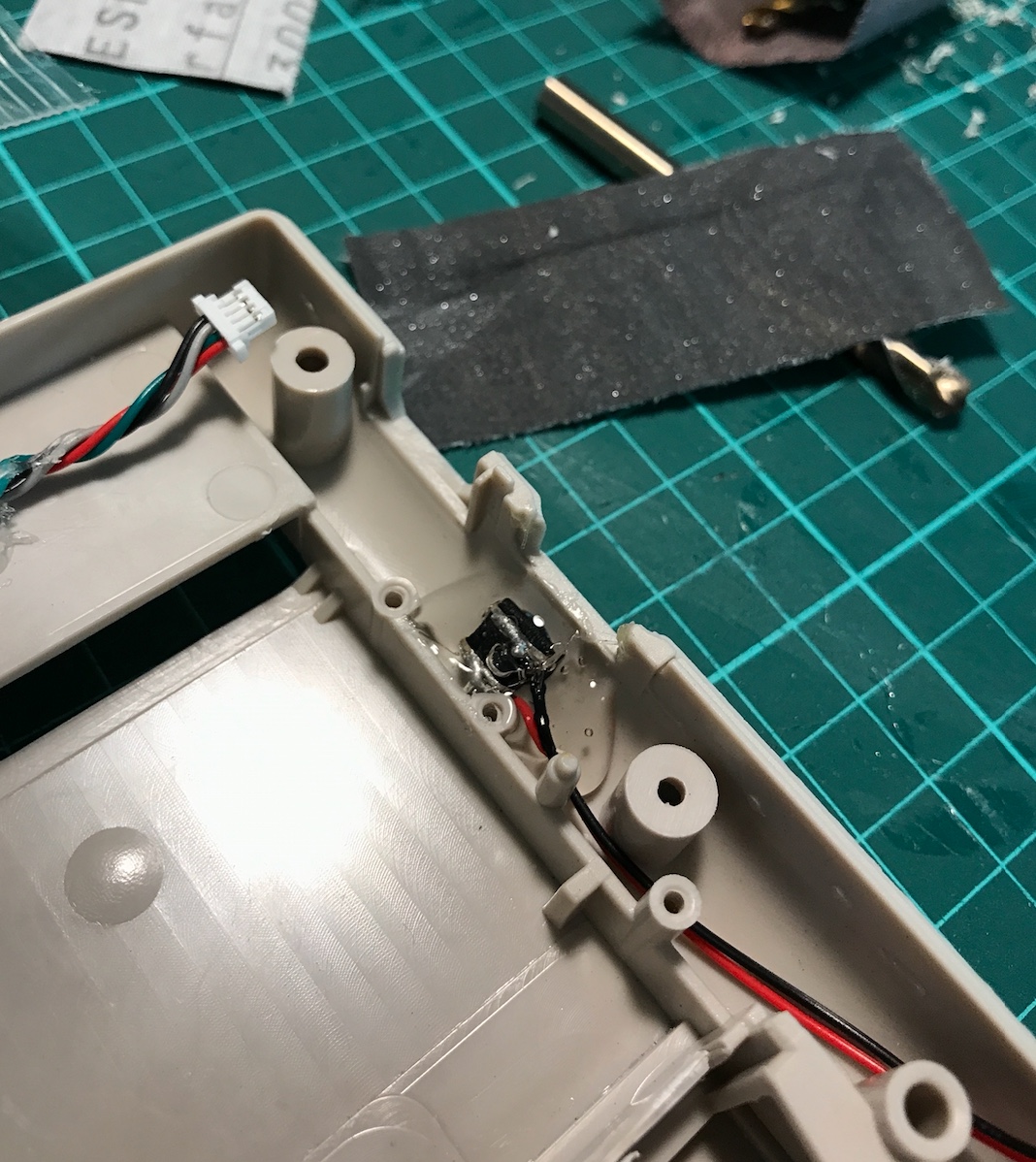

How did you drill that perfect hole for the micro usb charging port?
Started with drilling two holes, then I used different files and much grinding at the end.

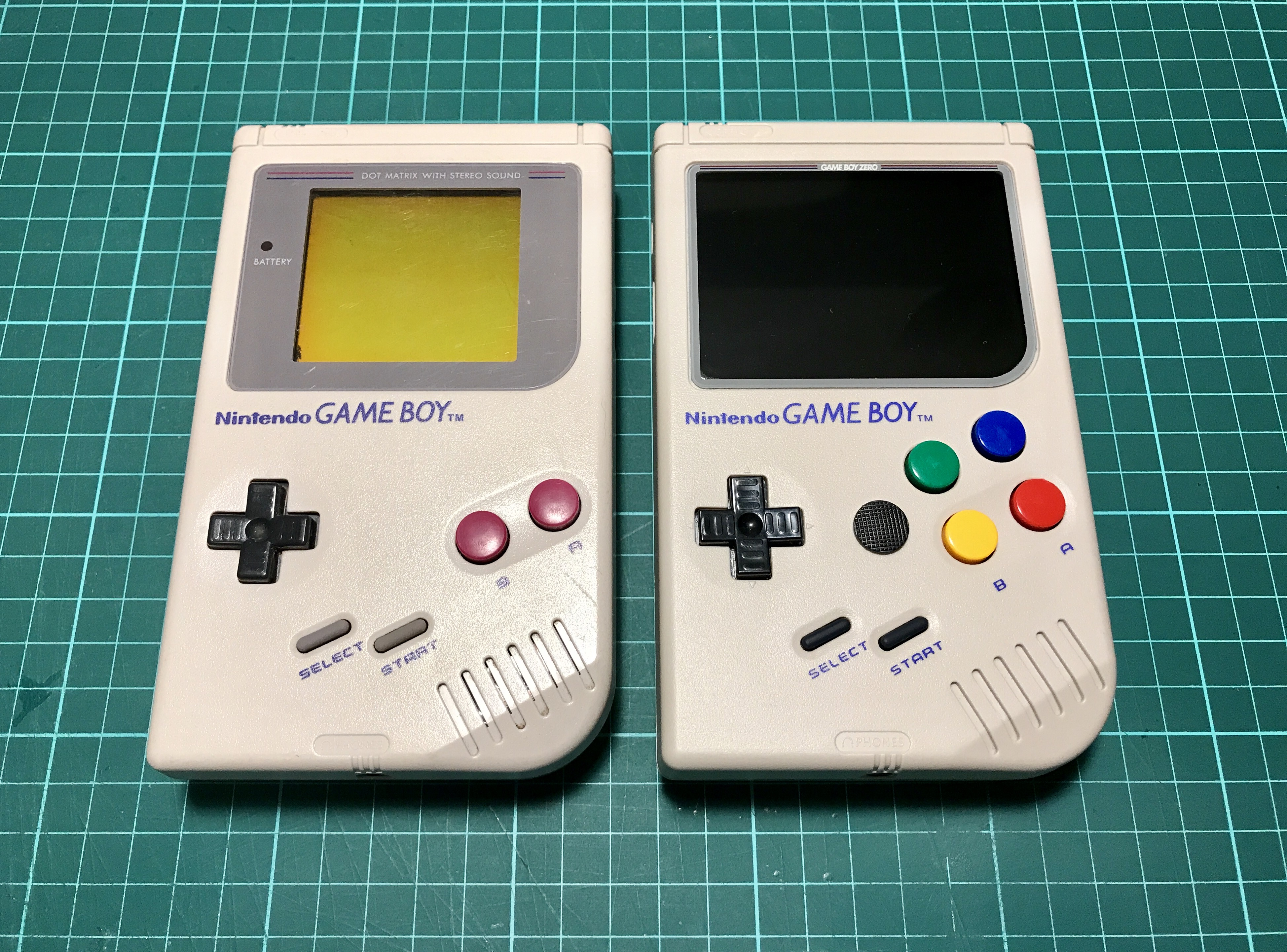

The SNES/Famicom coloured buttons, where are they from....
They are from an original NES Controller. I found that all the repo´s are slightly smaller in diameter, the Original ones are just perfekt.
Just grinding them down until it was the best fit. Also the holes needed much grinding inside of the housing to get a the switches nice clicking and don´t stuck in the holes. You can get different sets of the switches including the caps from ebay.

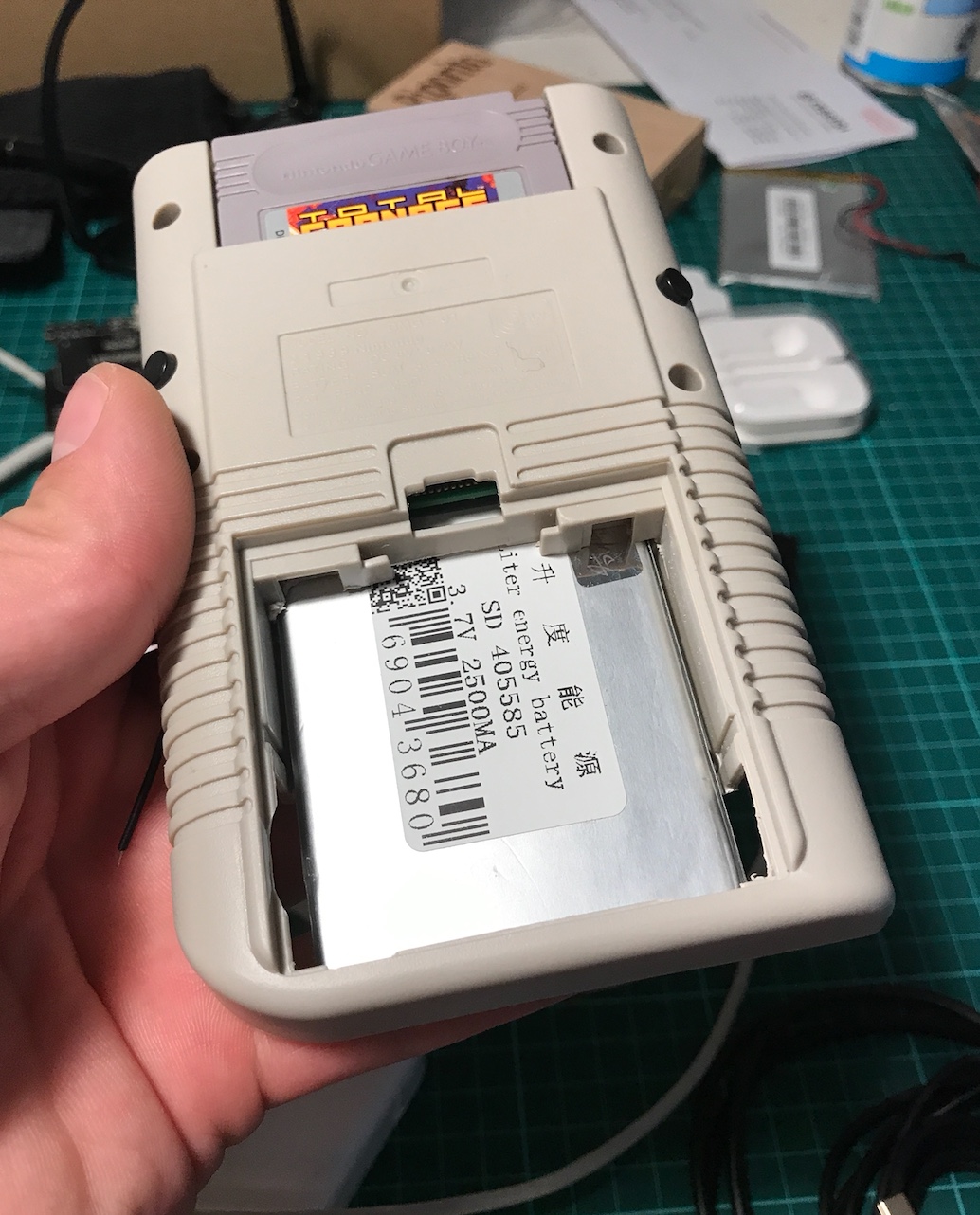

you should be able to get a ~4000mAh or more battery in there which should help battery life I'm sure :)
I get nearly 2 hours playtime with the 2500mAh battery, maybe i can find a bigger one with better fit soon. I ordered a 4000mAh battery, but it is slightly wider than the battery tray, so that is not an option...
I have absolutly no temperature problems. The highest I got during playing N64 ToyStory or Zelda was around 65C. The fan starts spinning around 60C. This temperature is far from getting the hot glue weak. 8-)
