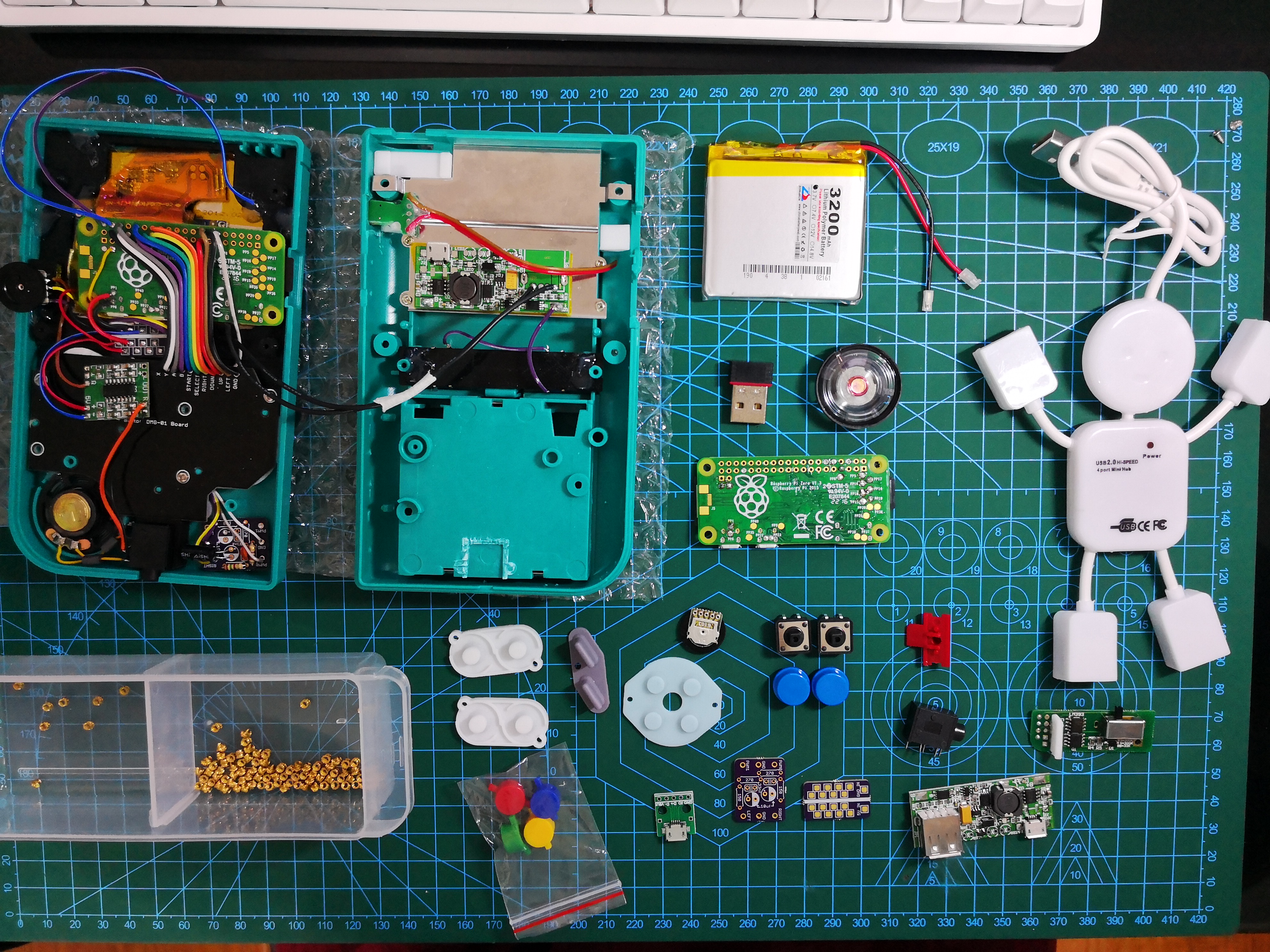

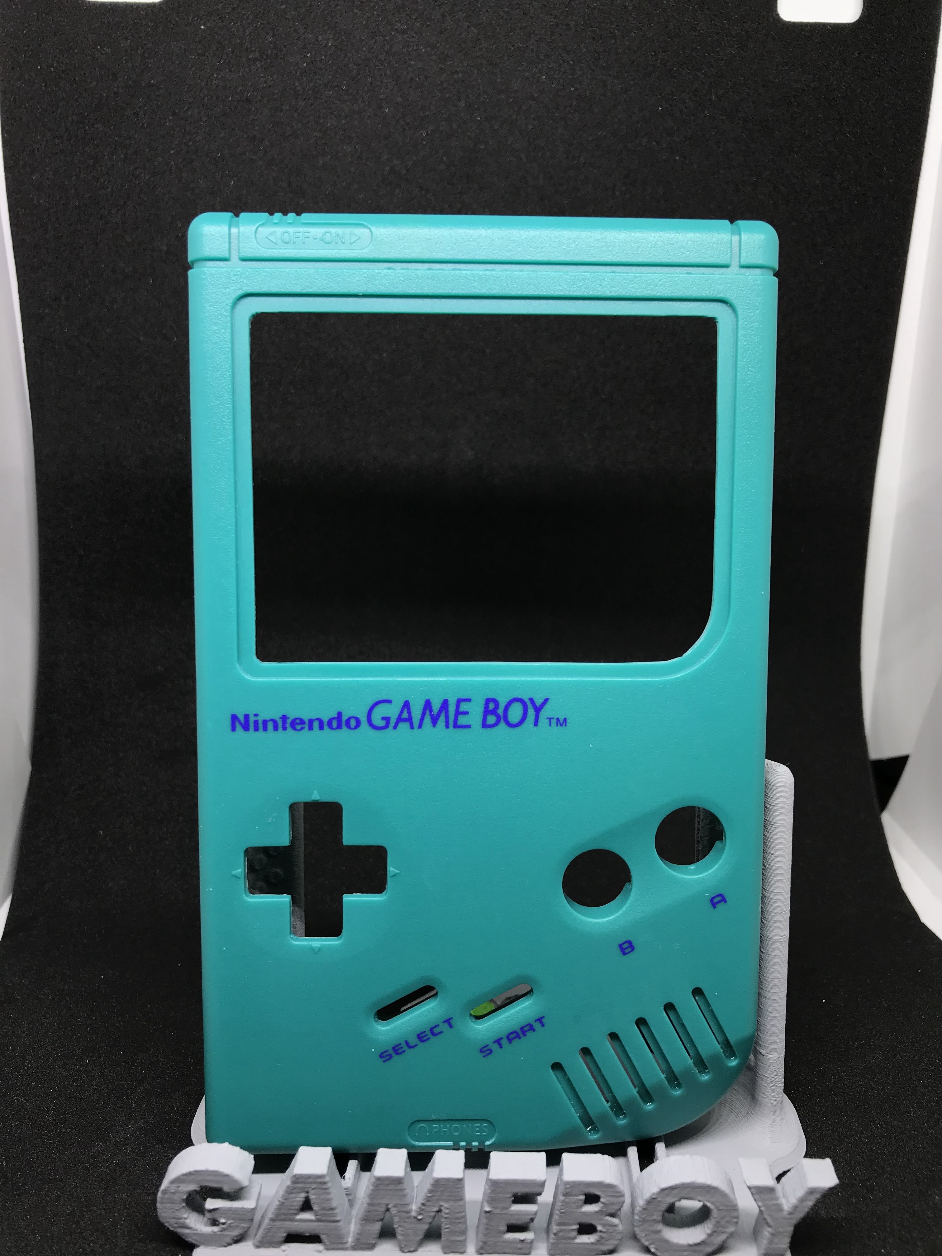

Hey all,

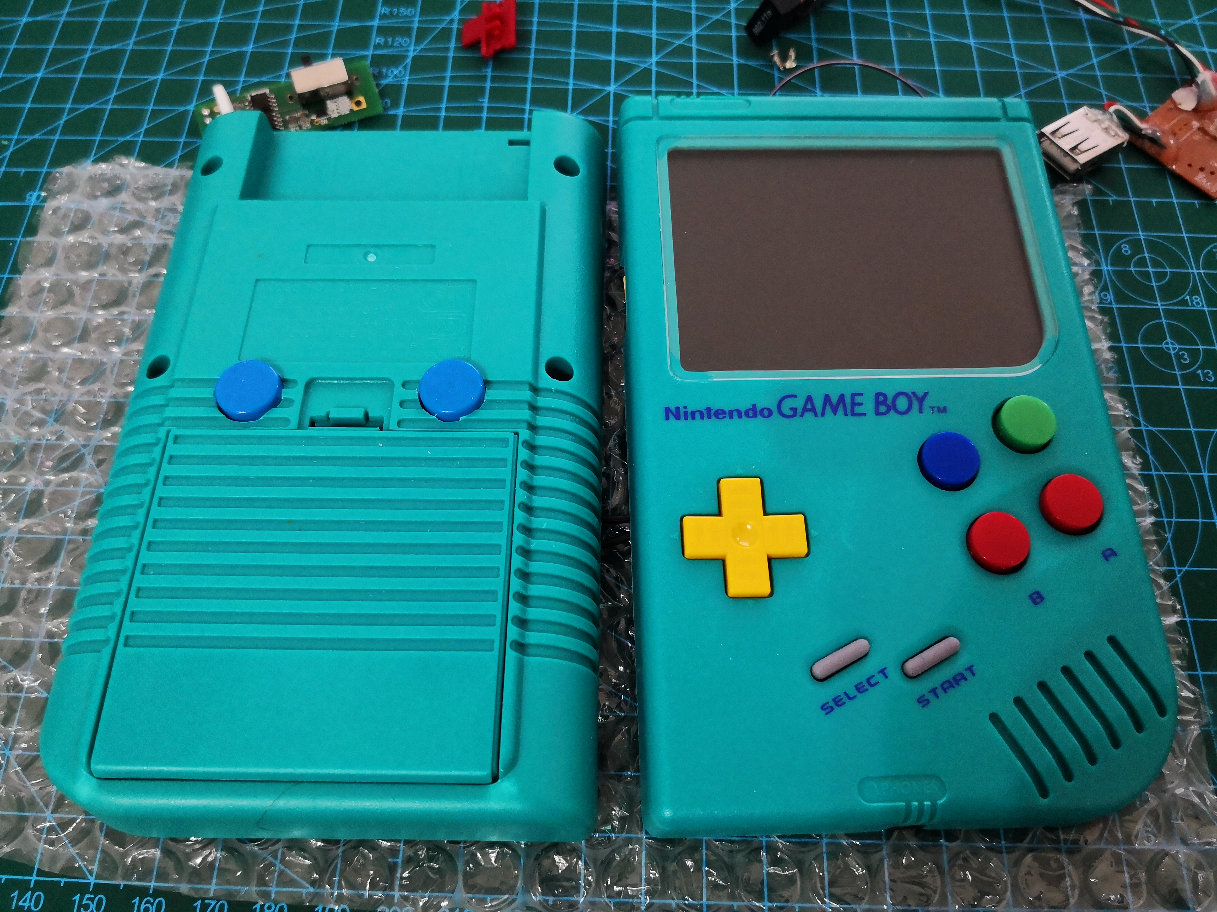

I started working on a new GameBoy Zero that is supposed to look similar to BMO from Adventure Time.
Nothing special really on the inside. It's my first build without a teensy lc and I am trying to use GPIOs for my buttons.
I spent quite some time on filing the case to fit the screen as I want to use a plane screeen protector without any colored surrounding to match the theme better. I think it turned out pretty smooth.

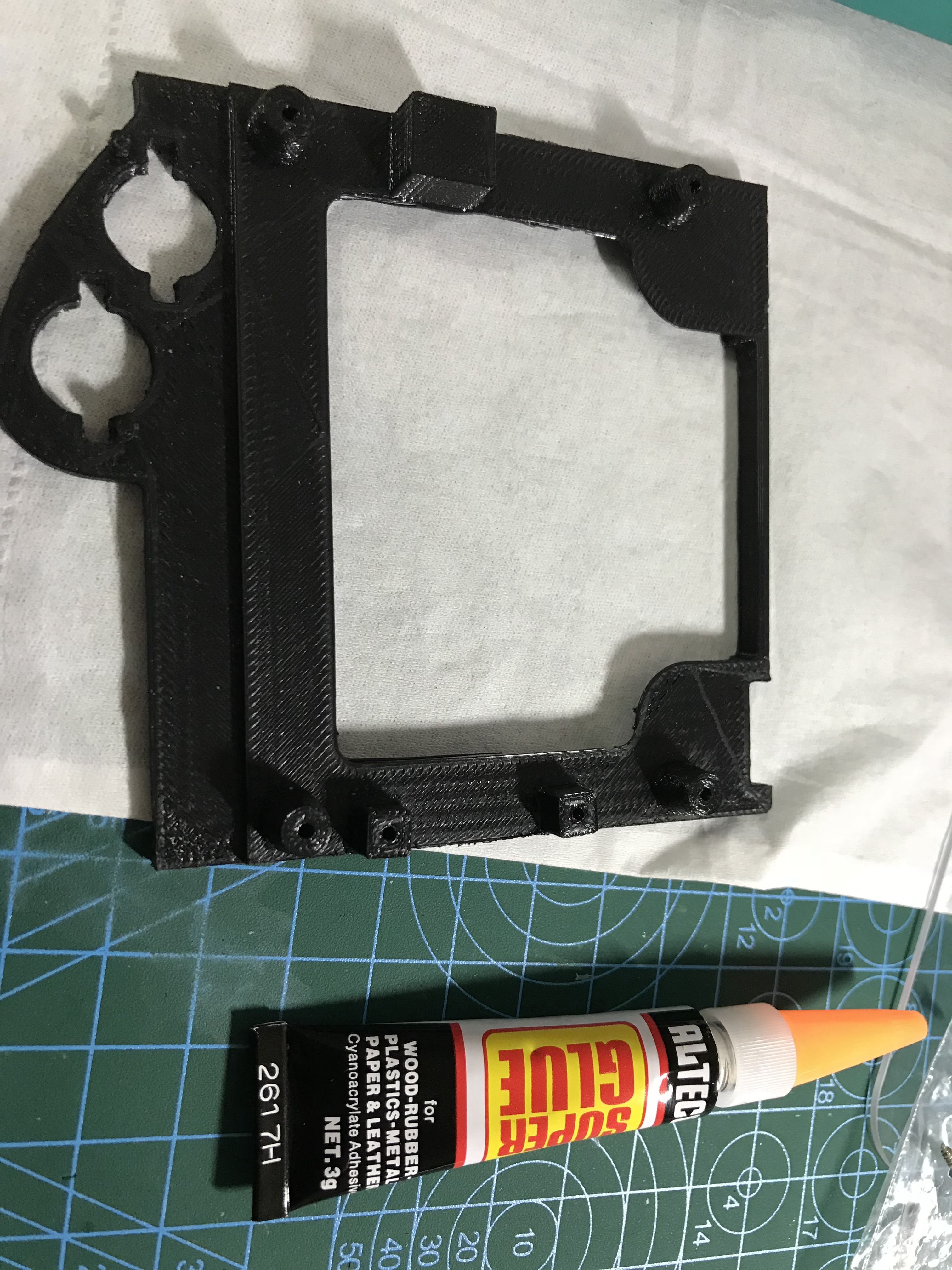

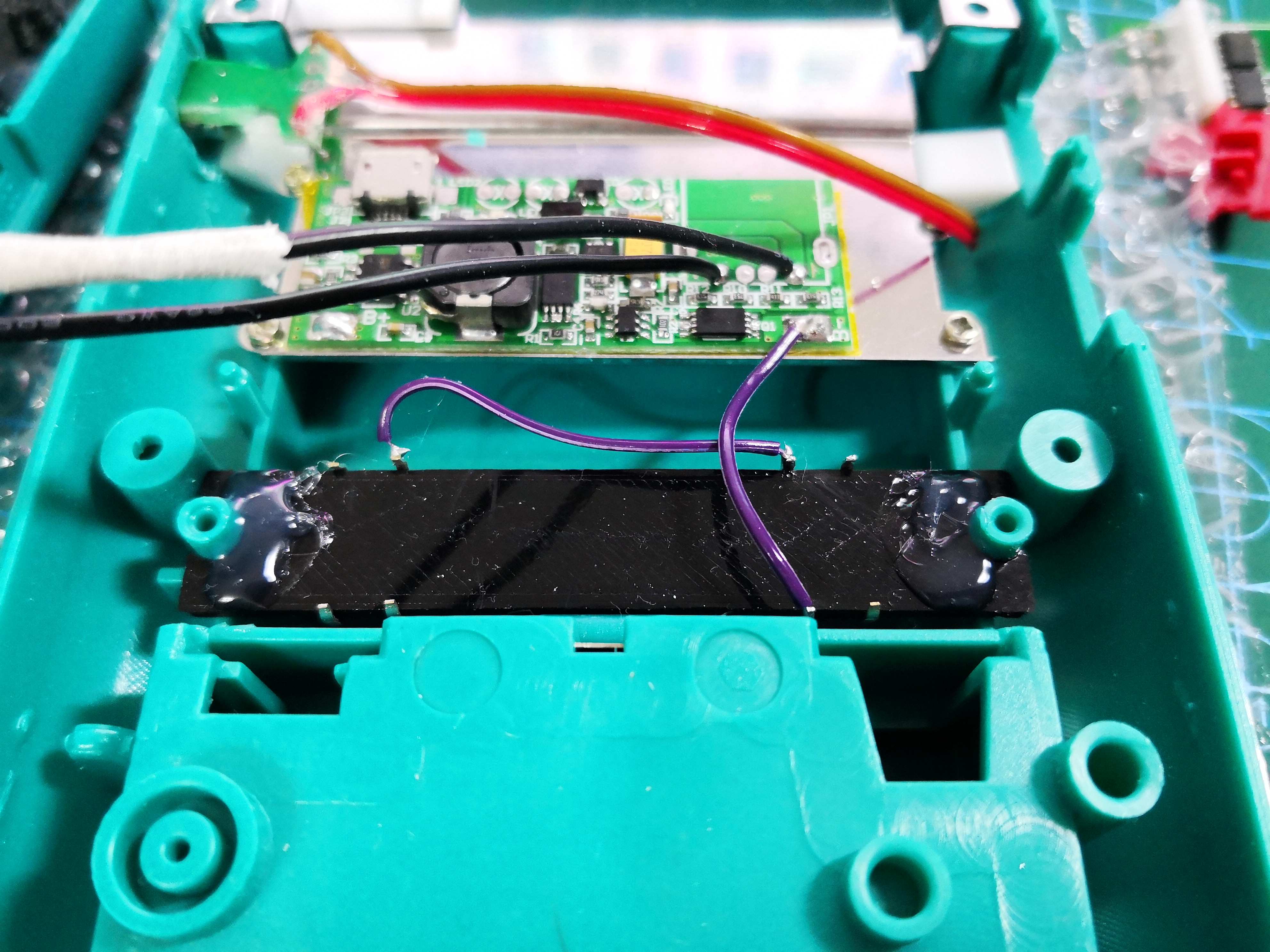

I used Hoolyhoos Screen bracket, but added 2 posts for the Pi and 1 post for volume wheel. I tried modifying the stl file in Fusion360 but I am too much of a noob. So I just printed 3 cubes and glued them on the existing bracket.

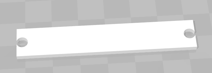

For the LR buttons I use tactile buttons and printed a plate so the buttons have a place to sit on. I still added some hot glue, just to make sure it doesn't move.
LR Button Plate.PNG (9.05 KiB) Viewed 9828 times
As I said I used GPIO for my buttons for the first time. I managed to set it up according to prerunnerseths manual:
viewtopic.php?f=22&t=57&hilit=wiring+without+teensy

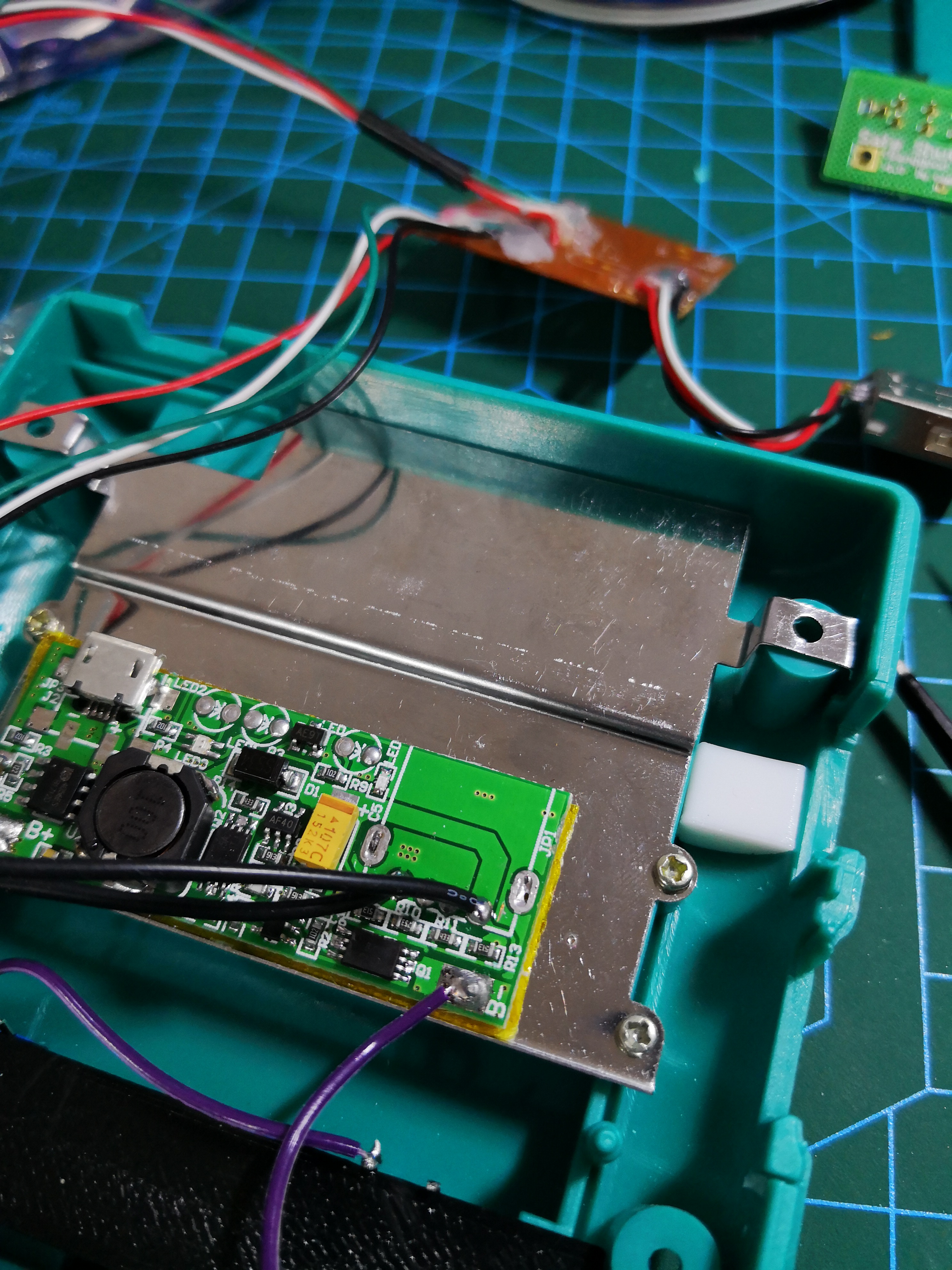

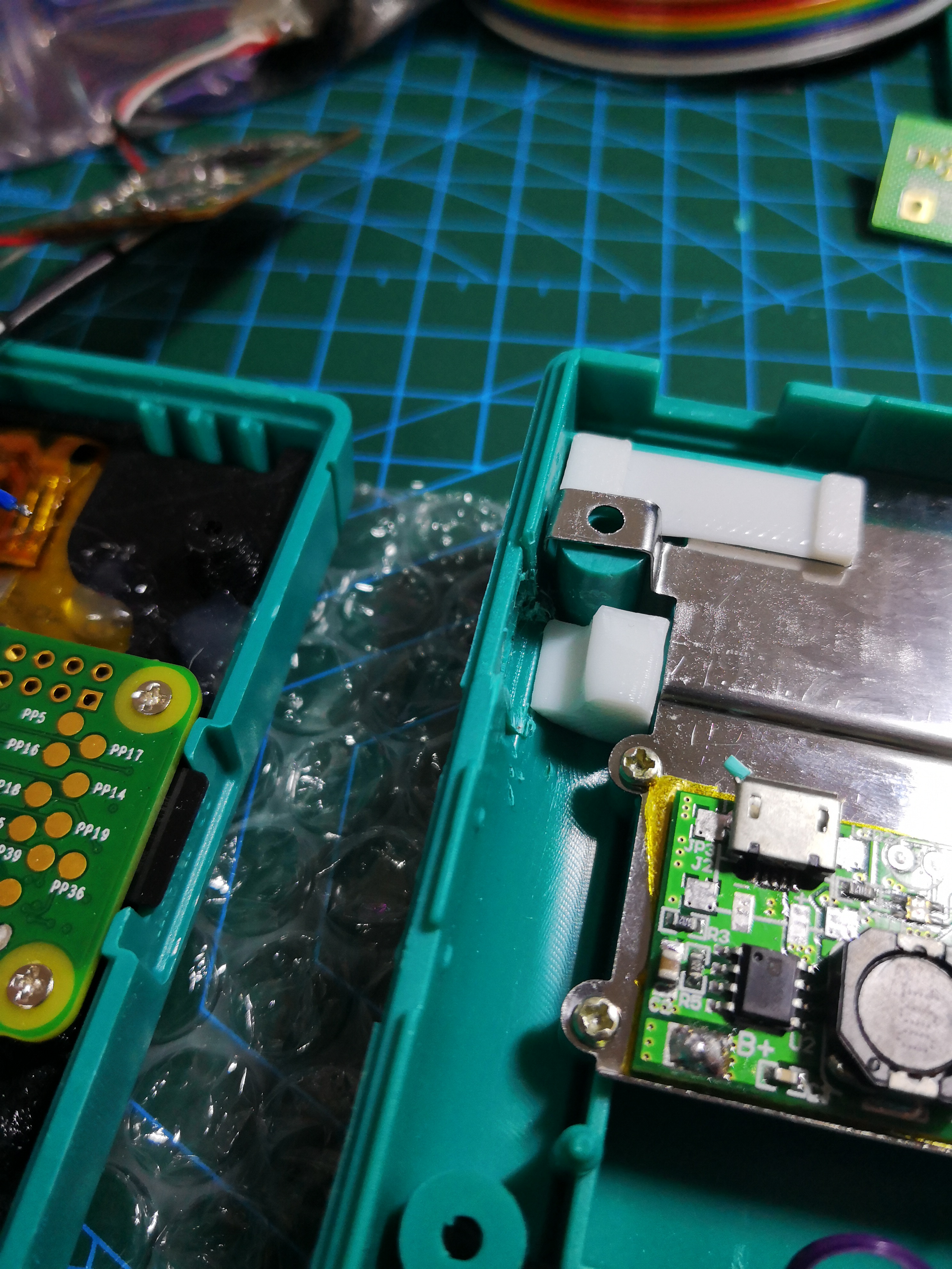

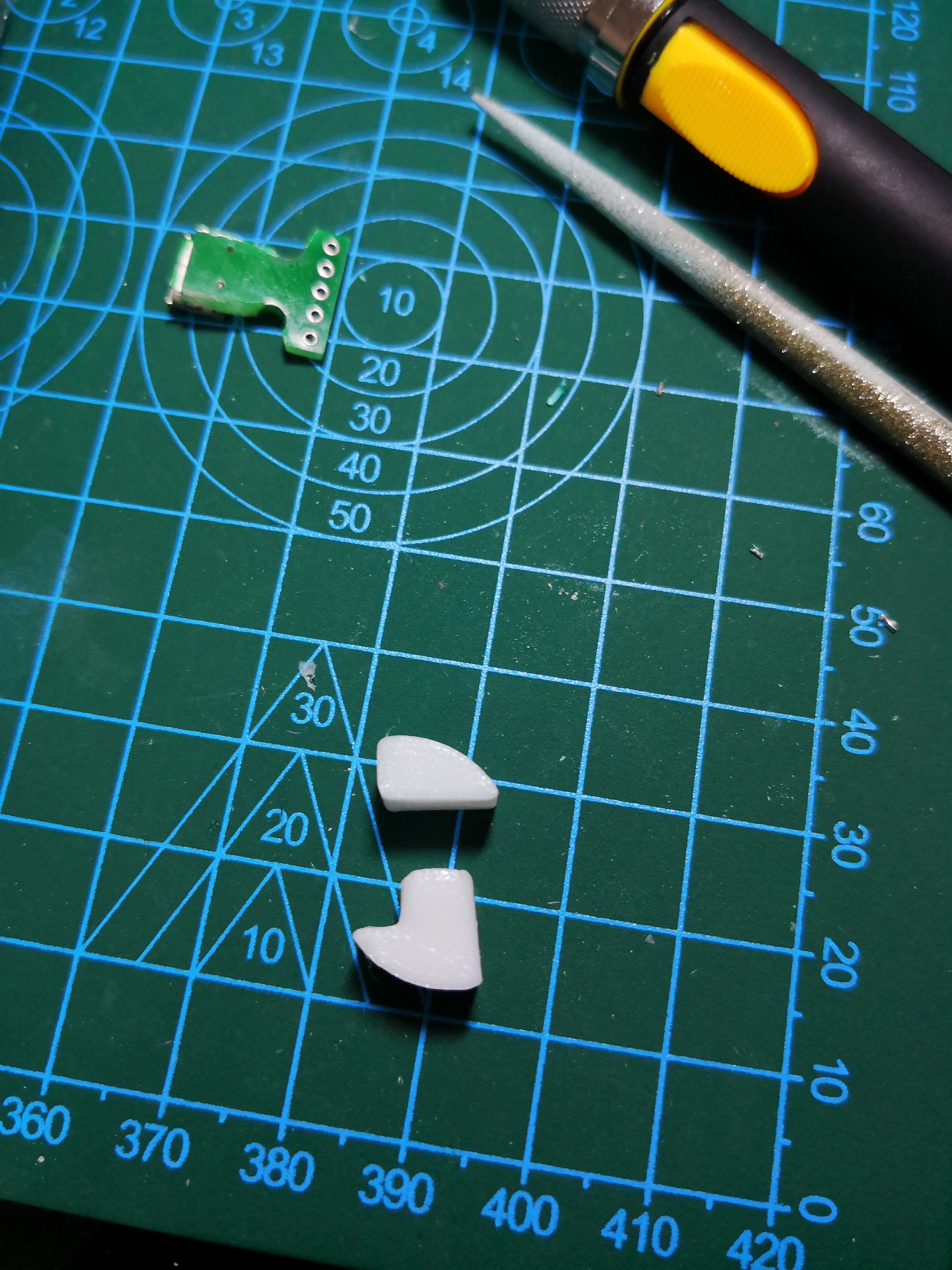

Additionally I designed 2 supporting 3D parts to hold the micro USB charging port and the external USB port.
The next step will be to set up Cambles safe shutdown, wire up the USB hub and then it's done.
That's my current status:
