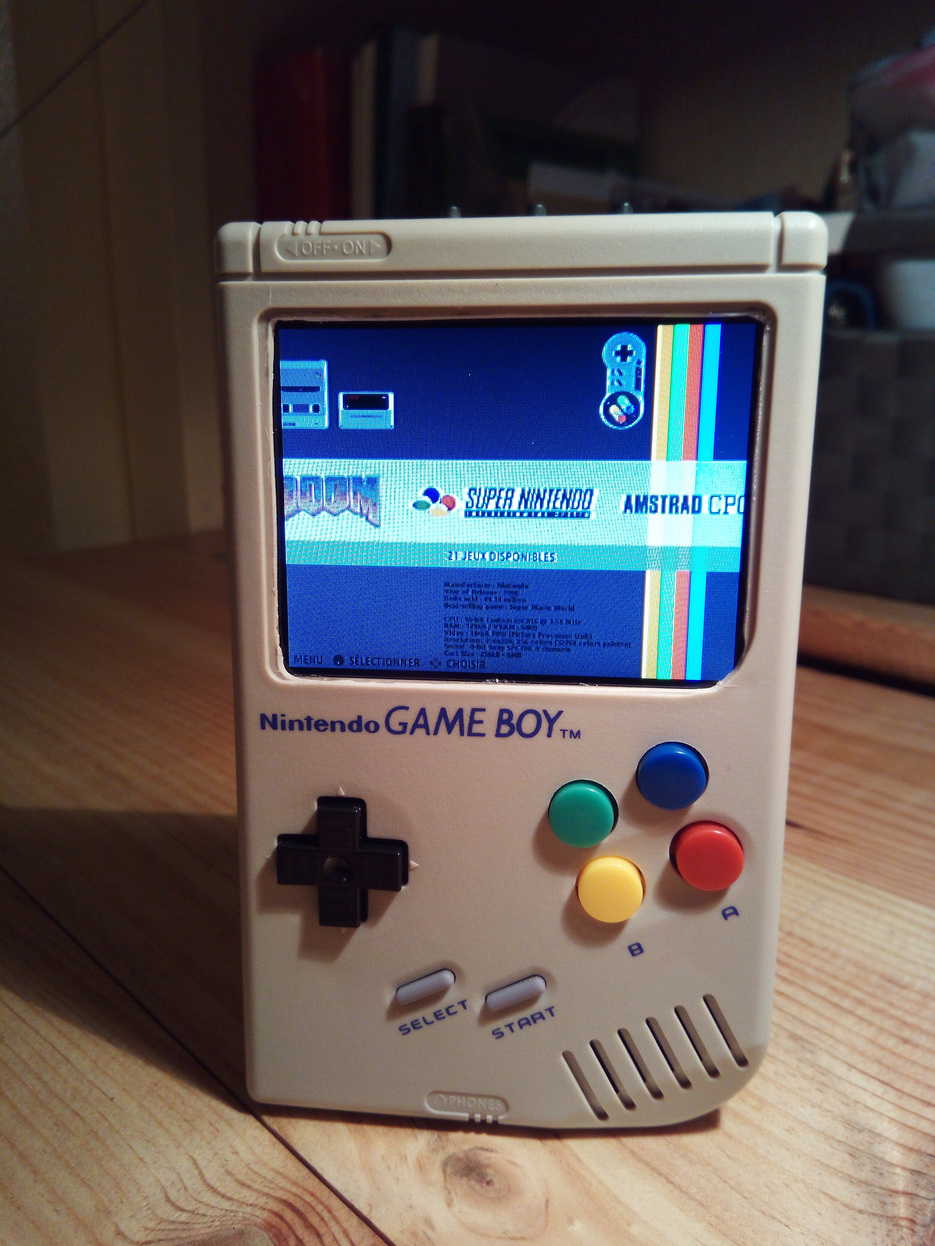

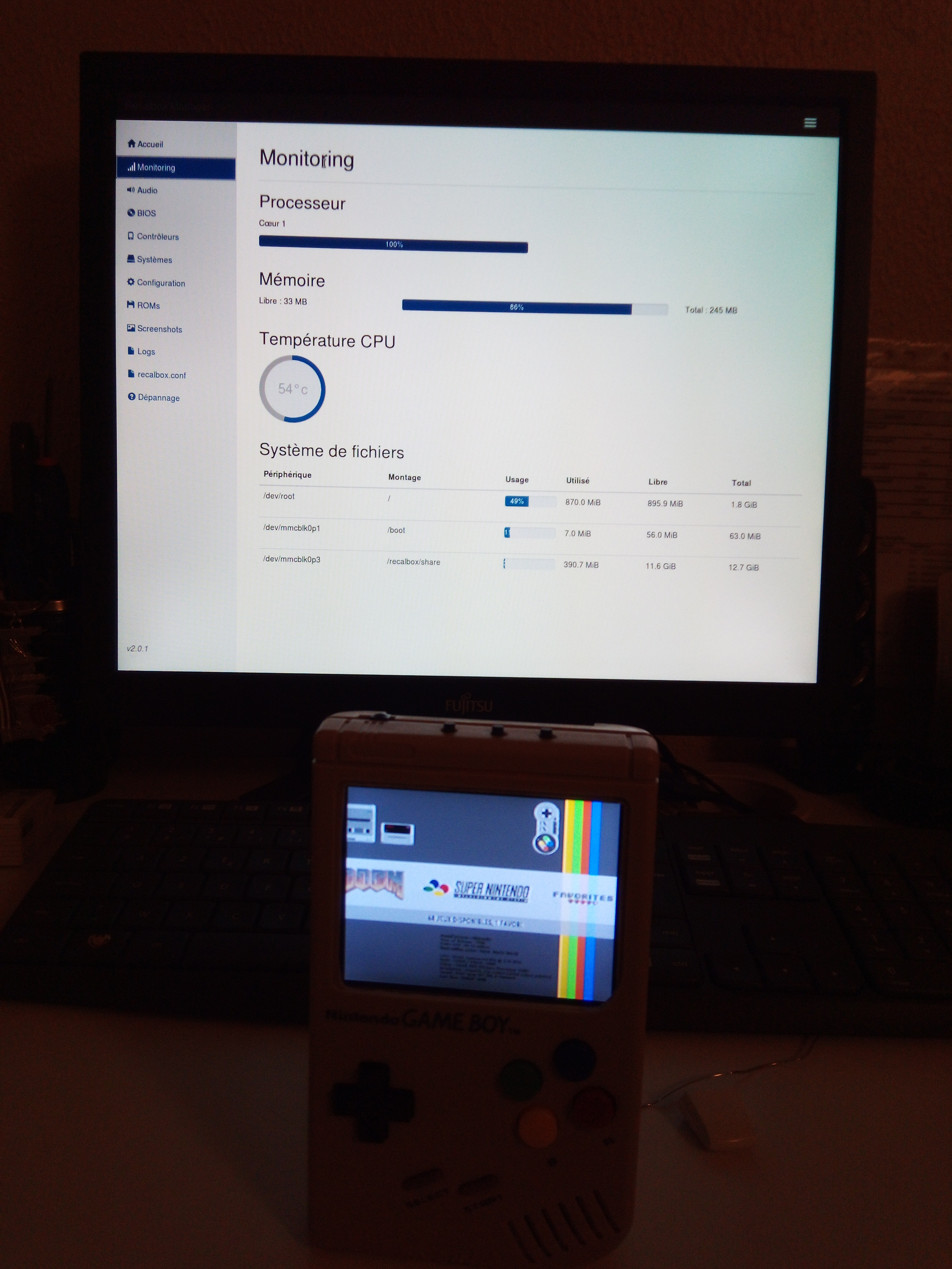

I have made a very classic GBZ (with Pi Zero W) running Recalbox.
Pi Zero W
white DMG-01 case
A/B/X/Y buttons with Snes colors
L/R buttons from a dead medical monitor
Gameboy Zero Button PCB from Gooeys retro gaming
3.5 composite LCD (BW screen) (I really thank you for the wiki)
Generic Power Boost and 1A lipo charger
4000mah 3.7 Lipo Battery
1S Lithium Charging Battery Capacity Percent Level LED Indicator
Mini stereo audio amplifier with integrated rotating wheel
5.1 USB stereo sound card
2 x notebook speakers from a dead Dell D610
Gameboy Zero Top Screw Bracket (printed by a friend)
I have only buy on Ebay or Amazon for this project
No extra stuff on my build, no external USB port, no audio jack, there is just a battery indicator integrated in the batteyr compartment cover. It's my first project of that kind and I have prefered to strat in beginner mode :mrgreen:
I choose Recalbox because of its webmanager which allows me to easily control the GBZ (virtual pad & system reset directly with my laptop) and manage my ROMs directories
Now I have to customize the splash screen and order a protective screen glass... and start a new project with Pi 3b, HDMI screen, external ports, in 3d Printed case (I would probably have a printer soon)

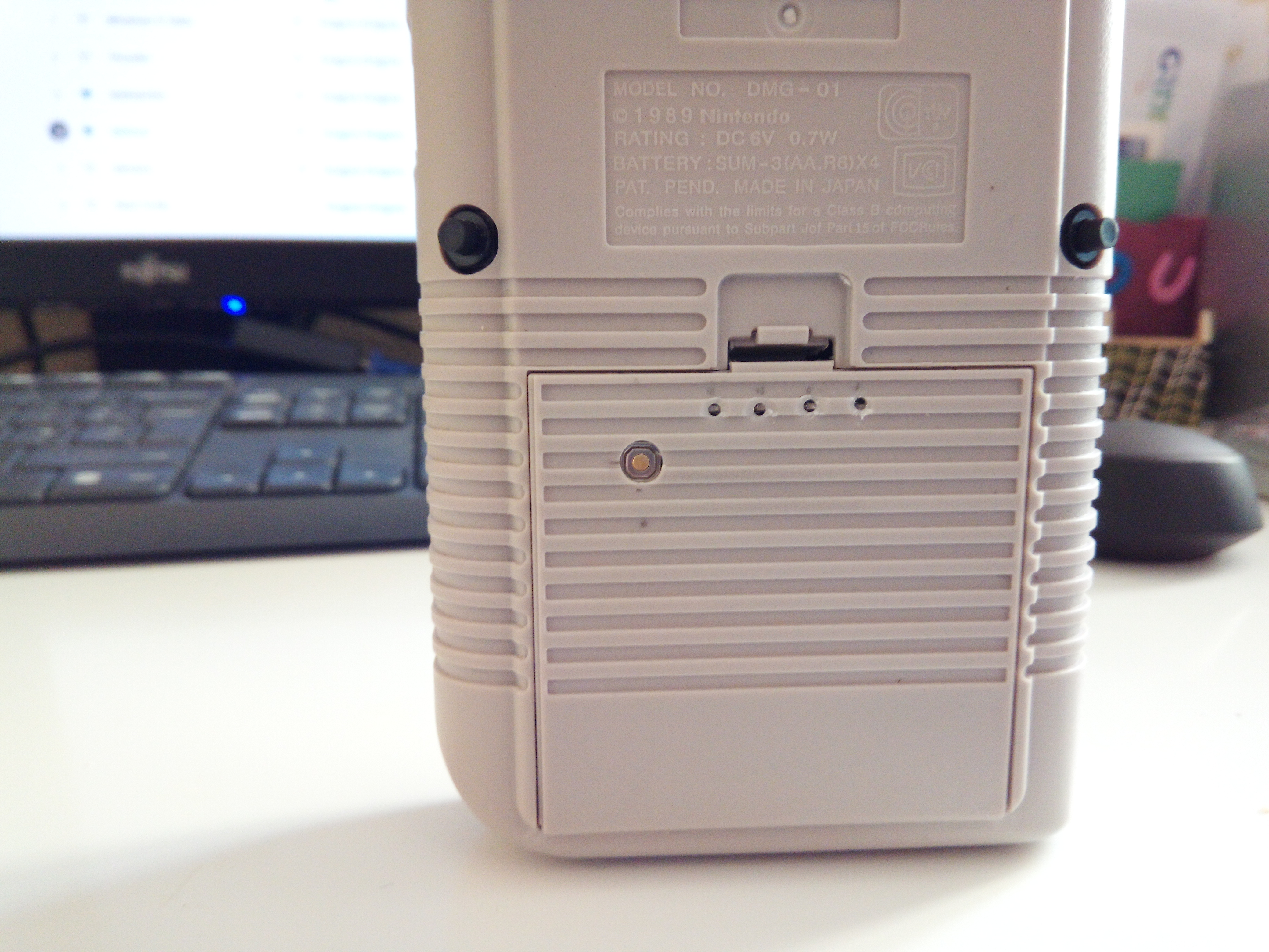

RogJ07
Posts: 7
Joined: Fri Jan 26, 2018 5:58 am
Location: France
Re: One more classic GBZ from France
Post by RogJ07 » Wed Mar 07, 2018 1:04 pm
@ ekilla - I use the 3.7V 4000mAh that is fitting perfectly in the GBZ and the battery indicator sizes 40x13.5x3.5mm. I glue it directly over the battery compartment cap. Ther it is https://www.ebay.fr/itm/0443-1-5S-Lipo- ... mh6TQ6Ln6A

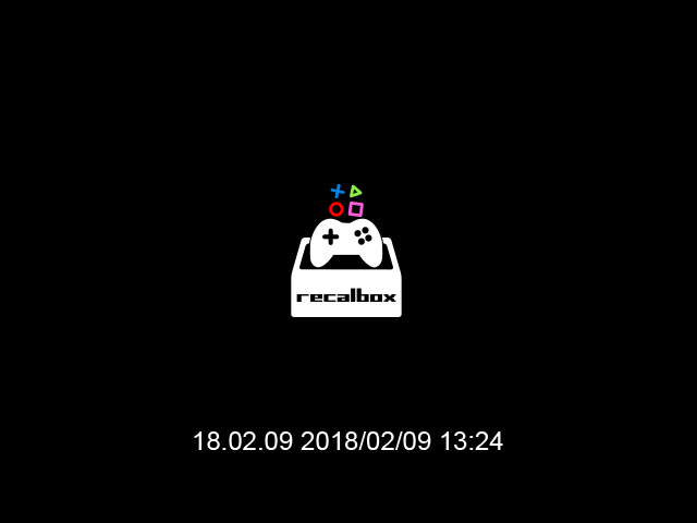

I'm softly and safely customizing waiting screens because default images resolution is too high for 320x240 display

Ce week end j'ai essayé de me fabriquer une vitre en découpant une boite de CD, c'est pas trop compliqué à couper et façonner mais le résultat n'est pas étincelant :lol:
Glass cut in a CD box :D :D :D
C'est la première fois que je réalise un projet de ce type, c'est très prenant. A l'avenir je tenterais bien une build à base de Pi 3 B (+) avec des pièces imprimées en 3D (quand j'aurais choisi une imprimante) histoire de faire un peu moins de collage....

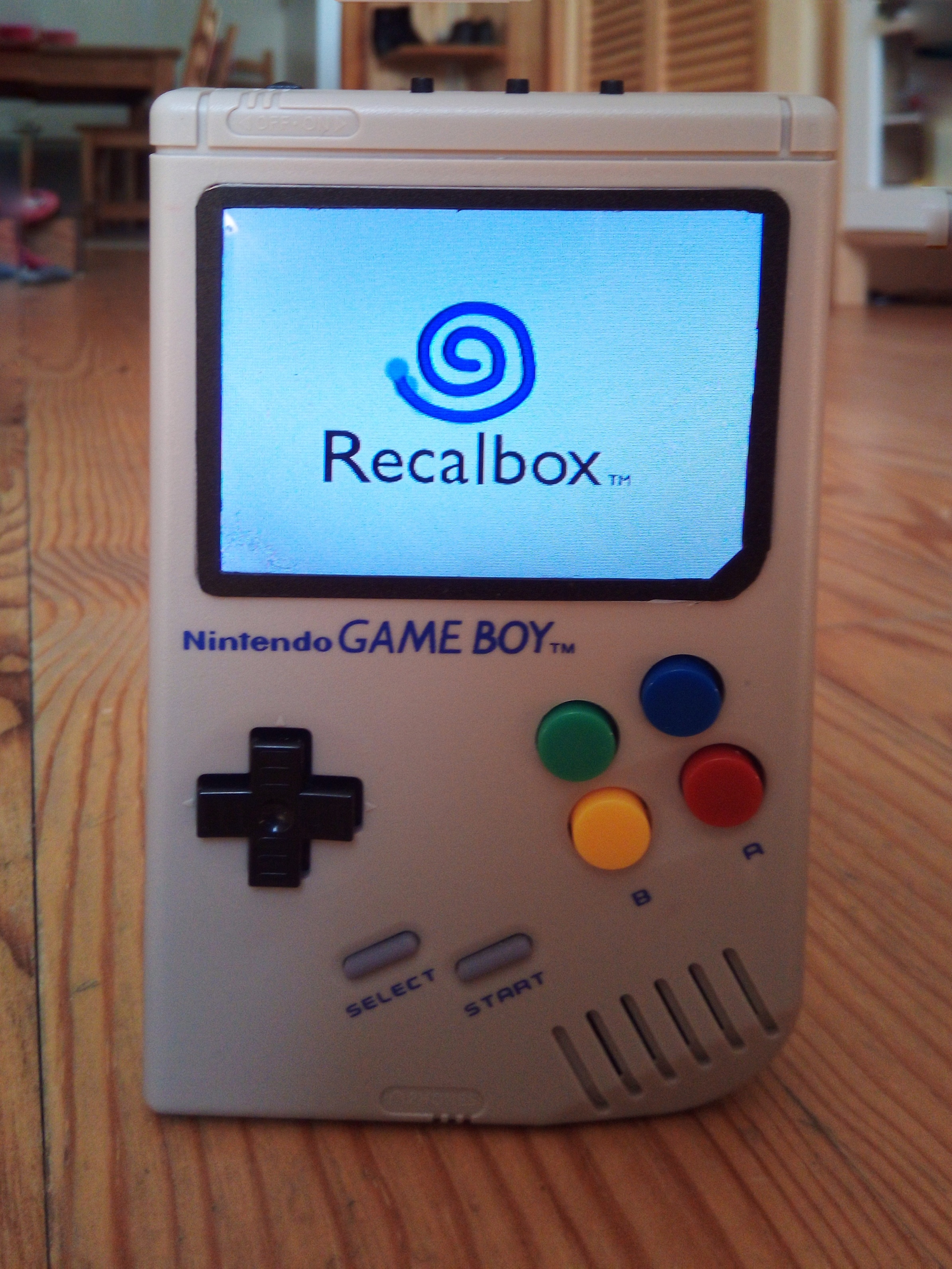

Hi
Just a try, because this first build is just to learn, I have cut a frame for my screen protection (cut in a spare CD box) :?
My build is very handmade :lol: :lol: :lol:
