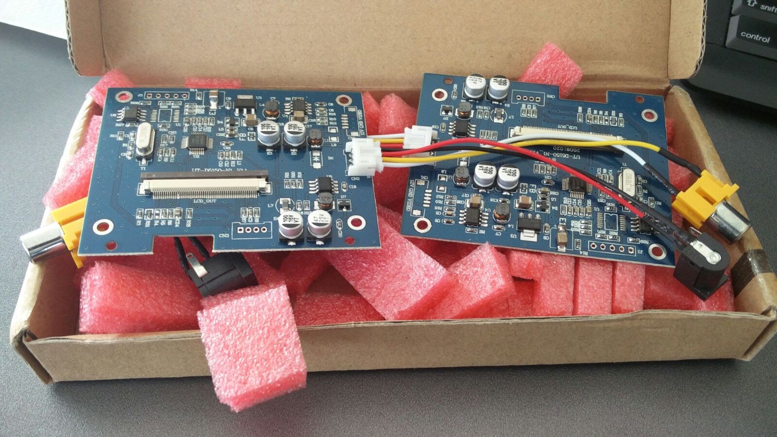

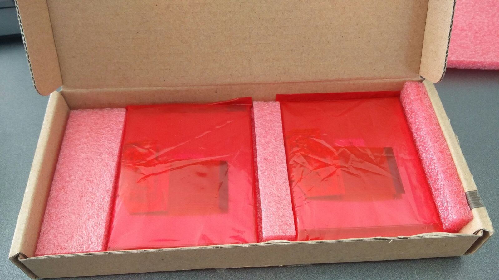

I don't have many progress pics, but I waited for the longest time for the displays to finally arrive after waiting a couple other weeks for the Adafruit display (and missed it once it was back in stock for a short time).
They came with a real nice packaging (both boxes were taped together and sent as one parcel, neat!):

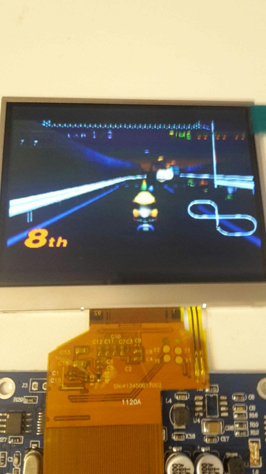

Testing without modification on 9V.
And testing with modifications as supplied by the vendor.
The image flickers a little bit, I hope this is just my friend's rusty old N64 and cheap composite cables.
We did fry one tiny coil on one of the displays, because we switched the polarity: We used the cables on the included harness as cues before noticing that they swapped the red and black cables... who does this?! The PCB itself is correctly labelled but you don't see that until removing the plastic connector.

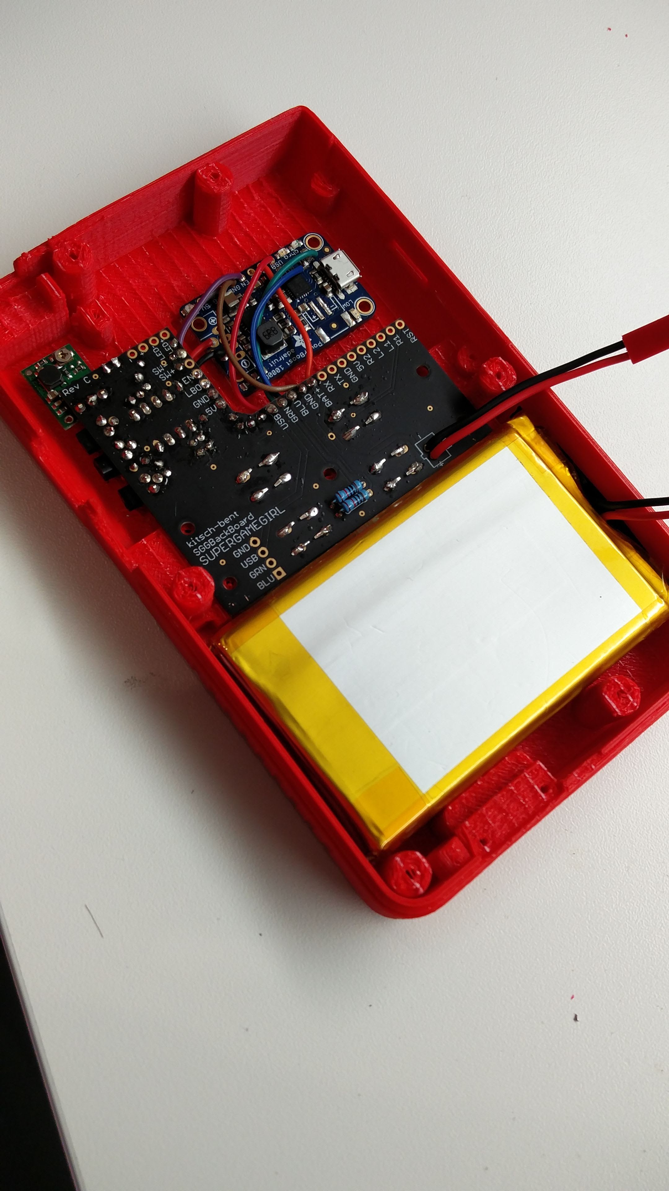

Finished with the first part, main PCB with shoulder buttons and 1000C!

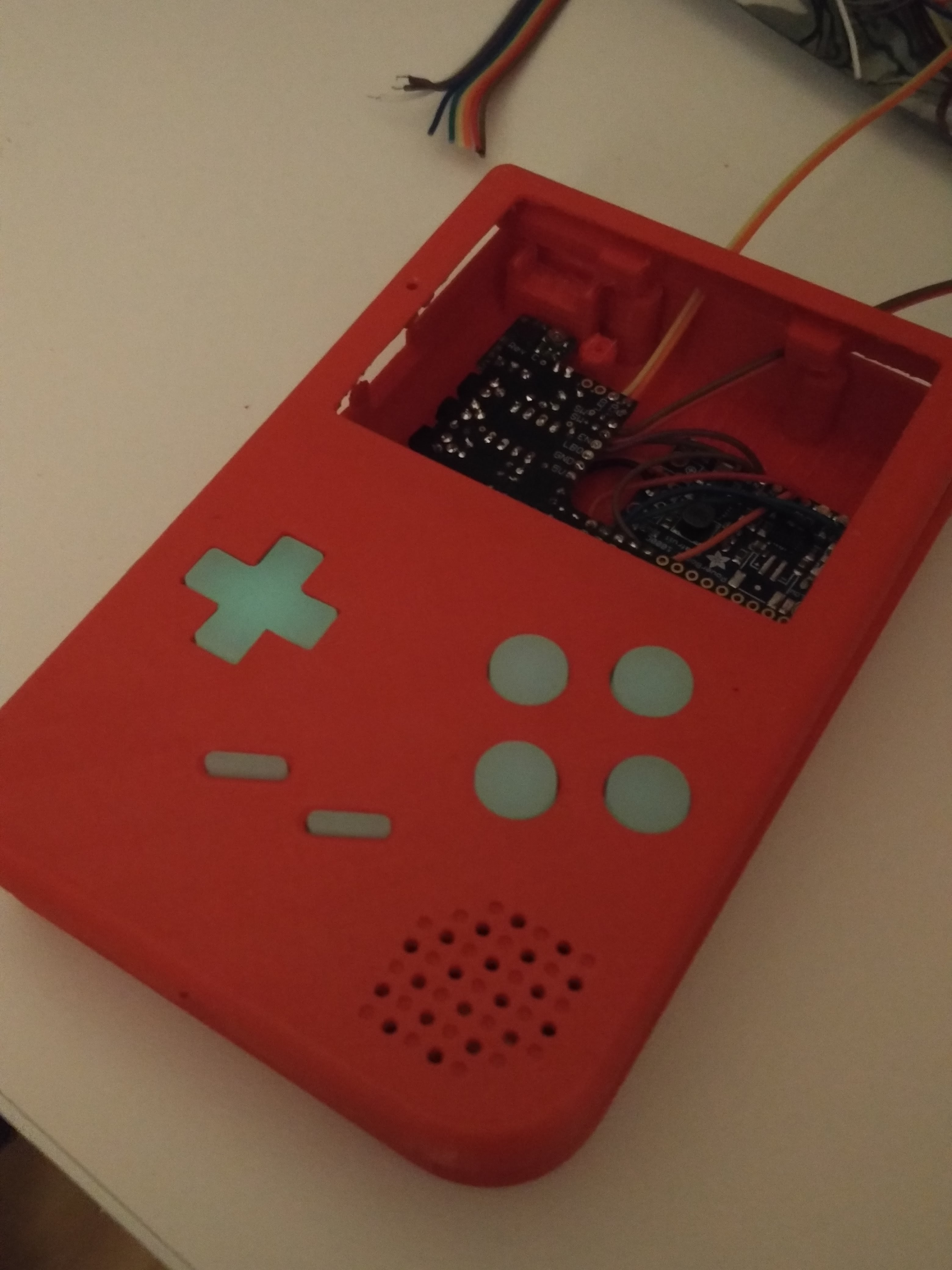

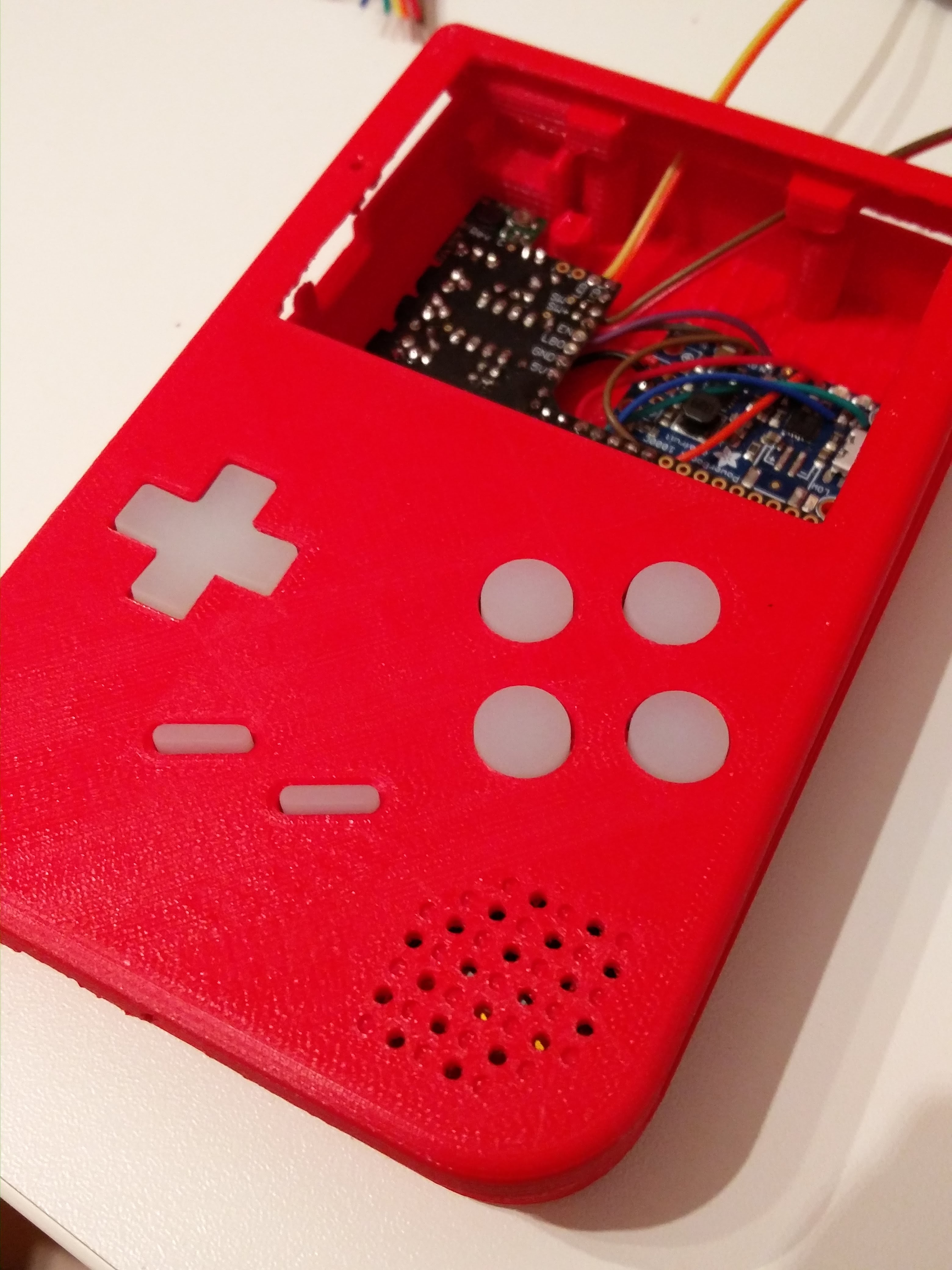

The case with front and buttons placed, they're glow-in-the-dark!

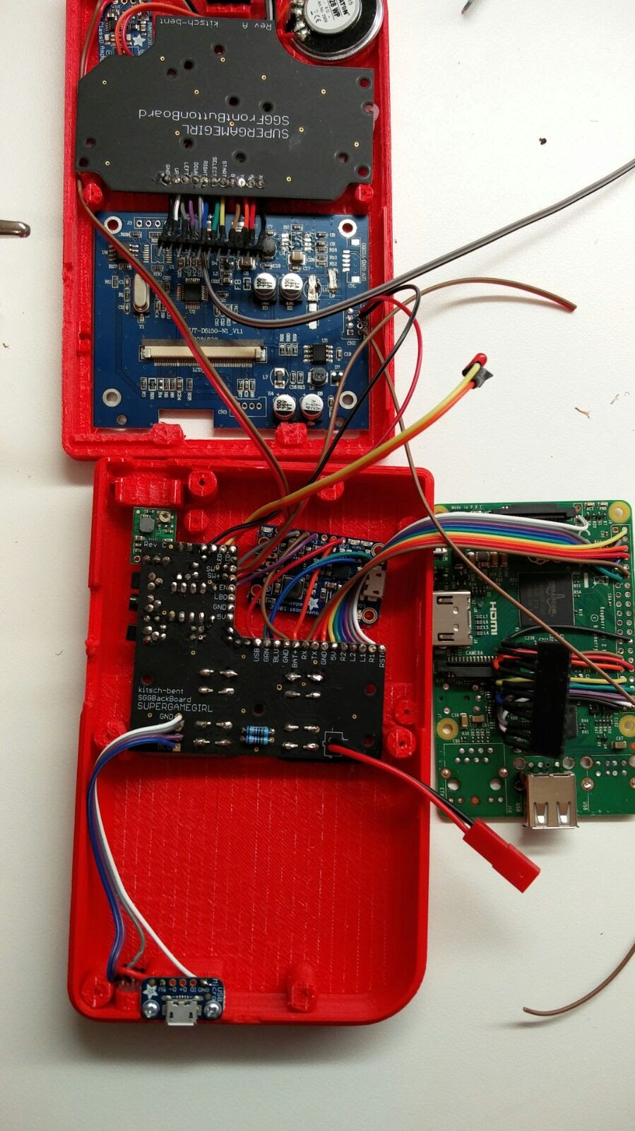

My most recent state:
Finished soldering together the audio amp, speaker and headphone jack, all the wiring on the Raspberry Pi.
All that's left now is finishing the case (some, err, a lot of sanding required) and waiting for the stereo volume knob. I originally ordered a 3-pin potentiometer which obviously can't be used for a stereo signal, so I'll be doing mono until it arrives I guess.

Very nice! I started this project, got 90% of the way done with it. I ran into problems with my case, not sure if it was the 3d print or just the way it's built but I snapped 4 of the screw supports off before I got fed up and said F it. My advise is before you start putting screws in the supports, tap all of them out first so the screws go in easier.

mattfl wrote:Very nice! I started this project, got 90% of the way done with it. I ran into problems with my case, not sure if it was the 3d print or just the way it's built but I snapped 4 of the screw supports off before I got fed up and said F it. My advise is before you start putting screws in the supports, tap all of them out first so the screws go in easier.
Damn, so close to the finish line! :(
I already effed up a tiny bit by pushing the charging led in too hard and now there's a tiny crack next to it. I'll definitely tap them as the screw posts aren't perfect and are partially blocked because of the generated supports (we printed the case upside down, gives a nicer finish on the outside!)
