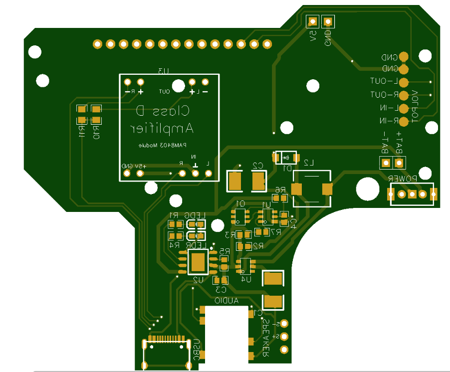

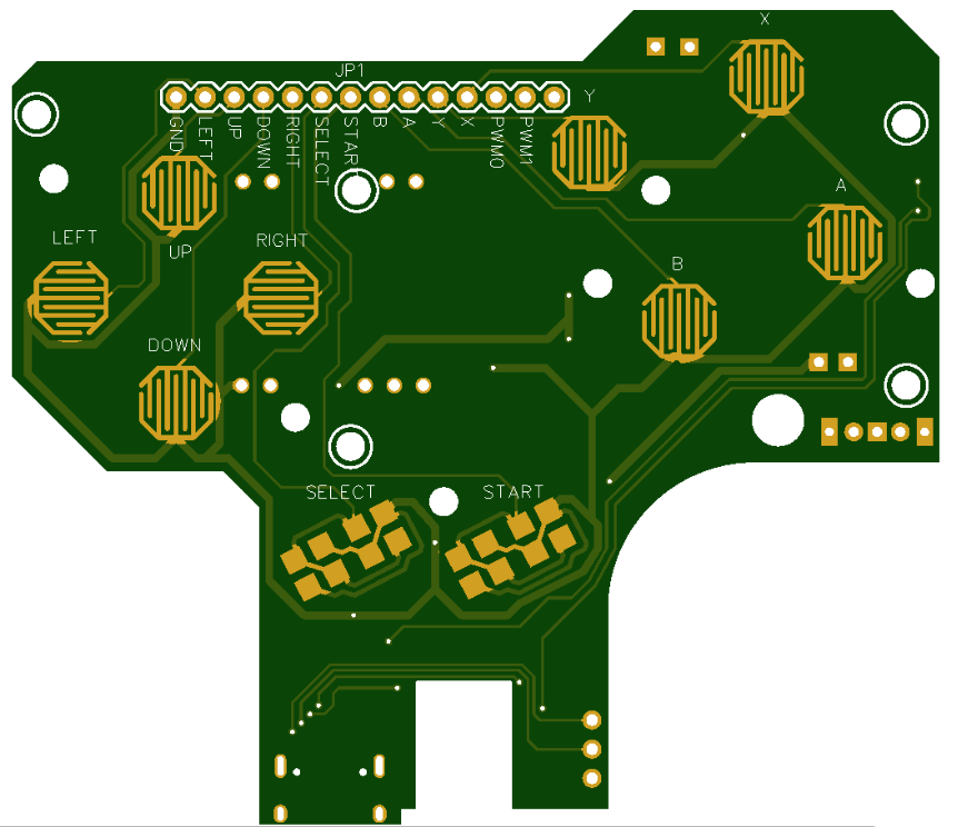

Hi, I´m on my way to build my first Gameboy Zero Mod. I decided to use a Raspberry pi 3 B for this. My goal is that i want to leave the Raspberry pi as complete as possible means I don´t desolder any ports. Also I want to have accsess to the HDMI port so I can use it as a Retrostation. I also want that I can easily remove the Pi so I don´t want to use a lot of hotglue and no hotglue to fix the Raspberry at all.
Since I´m quite practiced in PCB designe I created my own custom Button PCB with integreated Battery charger, boost Circuit, overdischarge, overcurrent and overcharge Protection. The PCB has also place for a PAM audimodule, an aux port, volume wheel pins, pins for a speaker (also stereo Speaker) and an USB-C connector to charge the battery.
Top Side of the PCB
Bottom Side of the PCB
The PCBs are ordered and until now I wait for them.

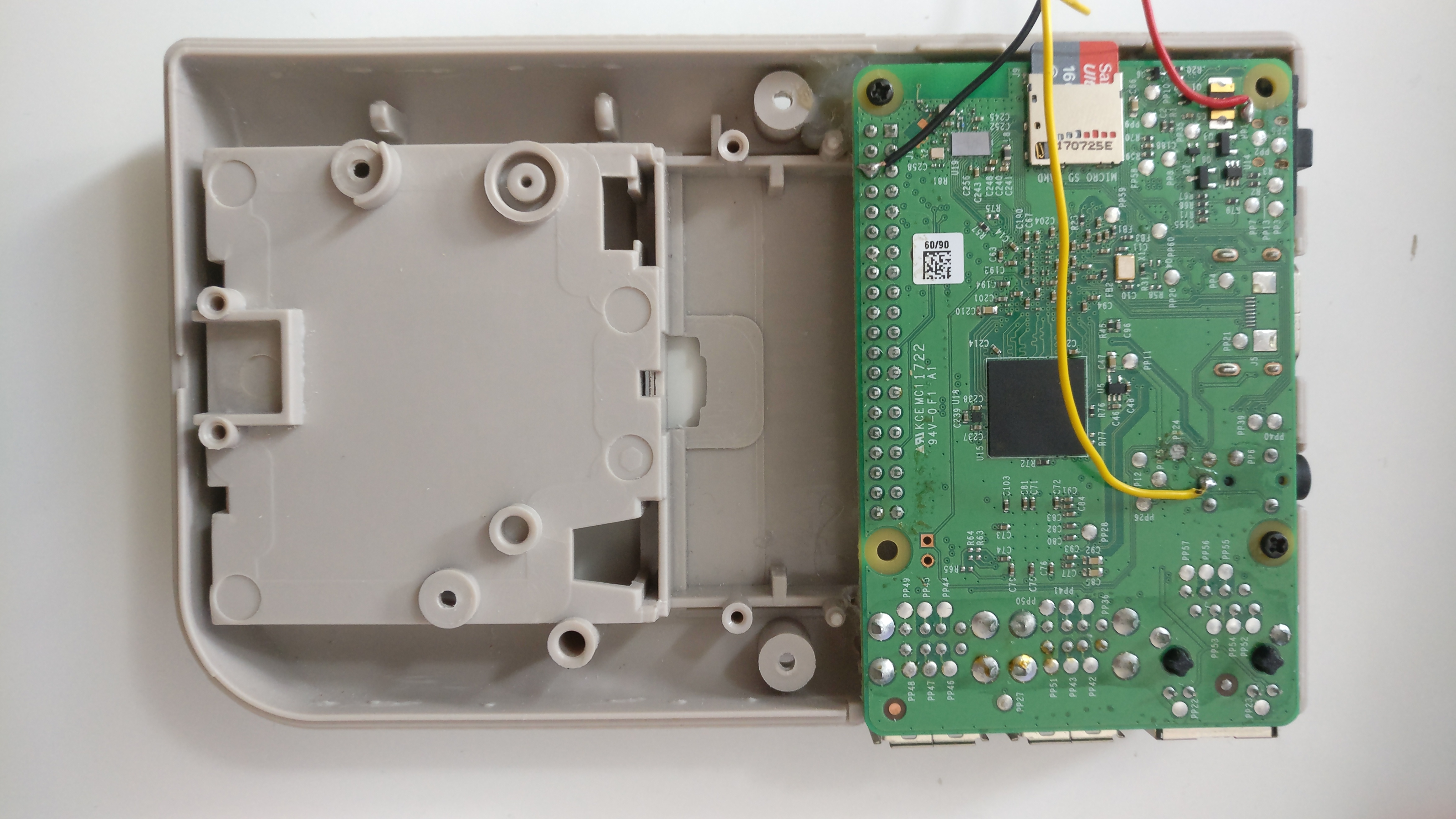

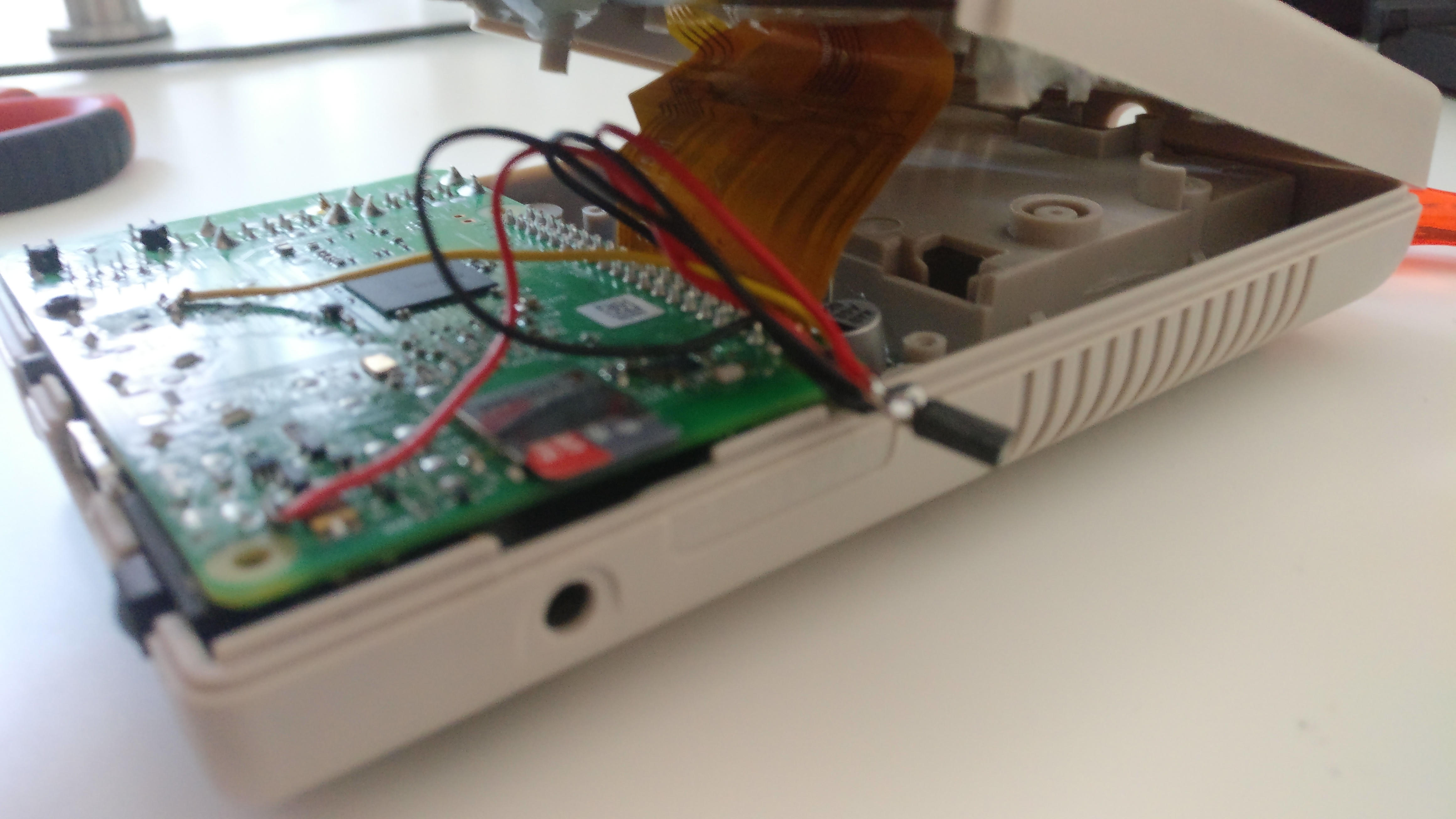

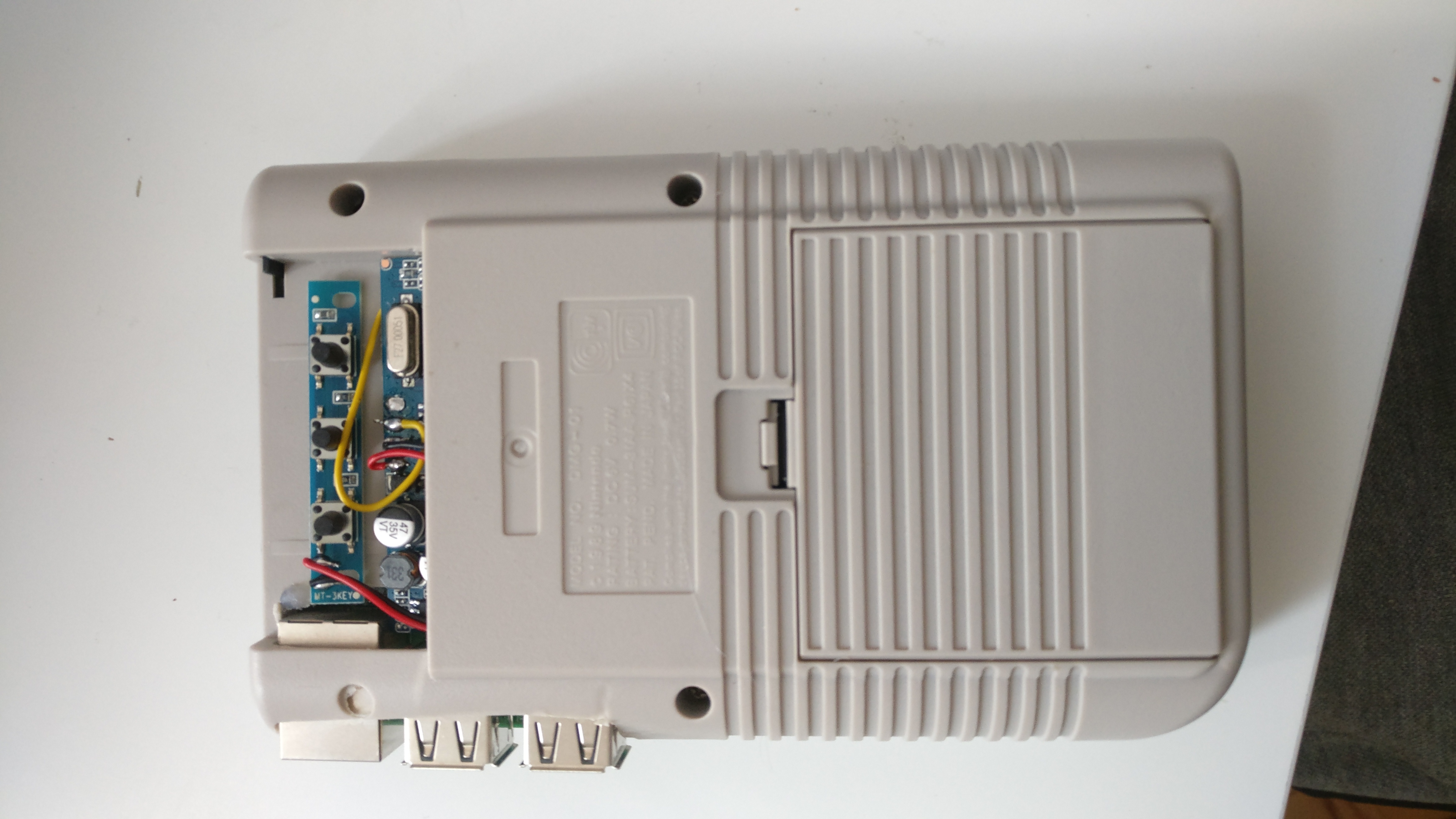

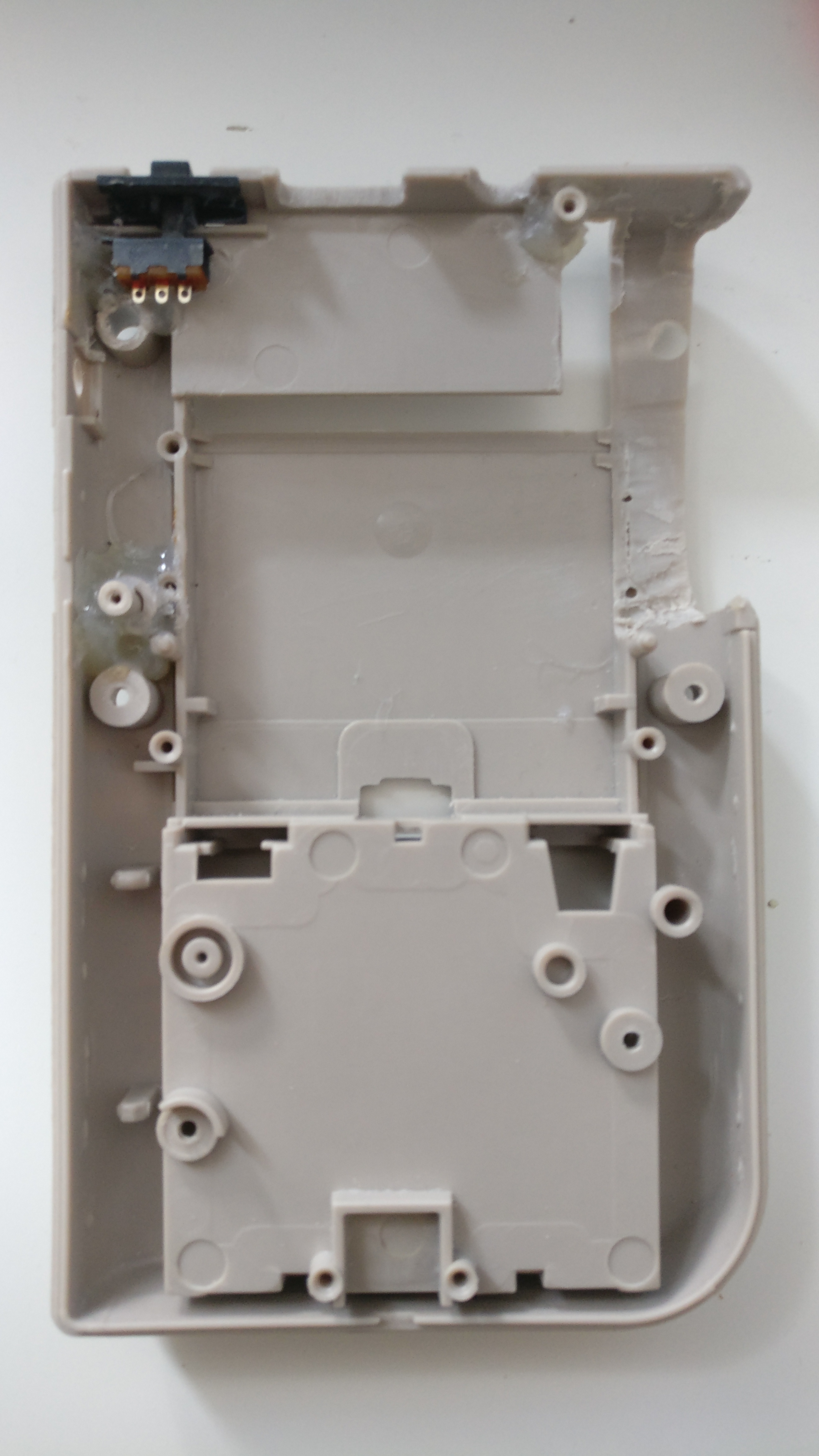

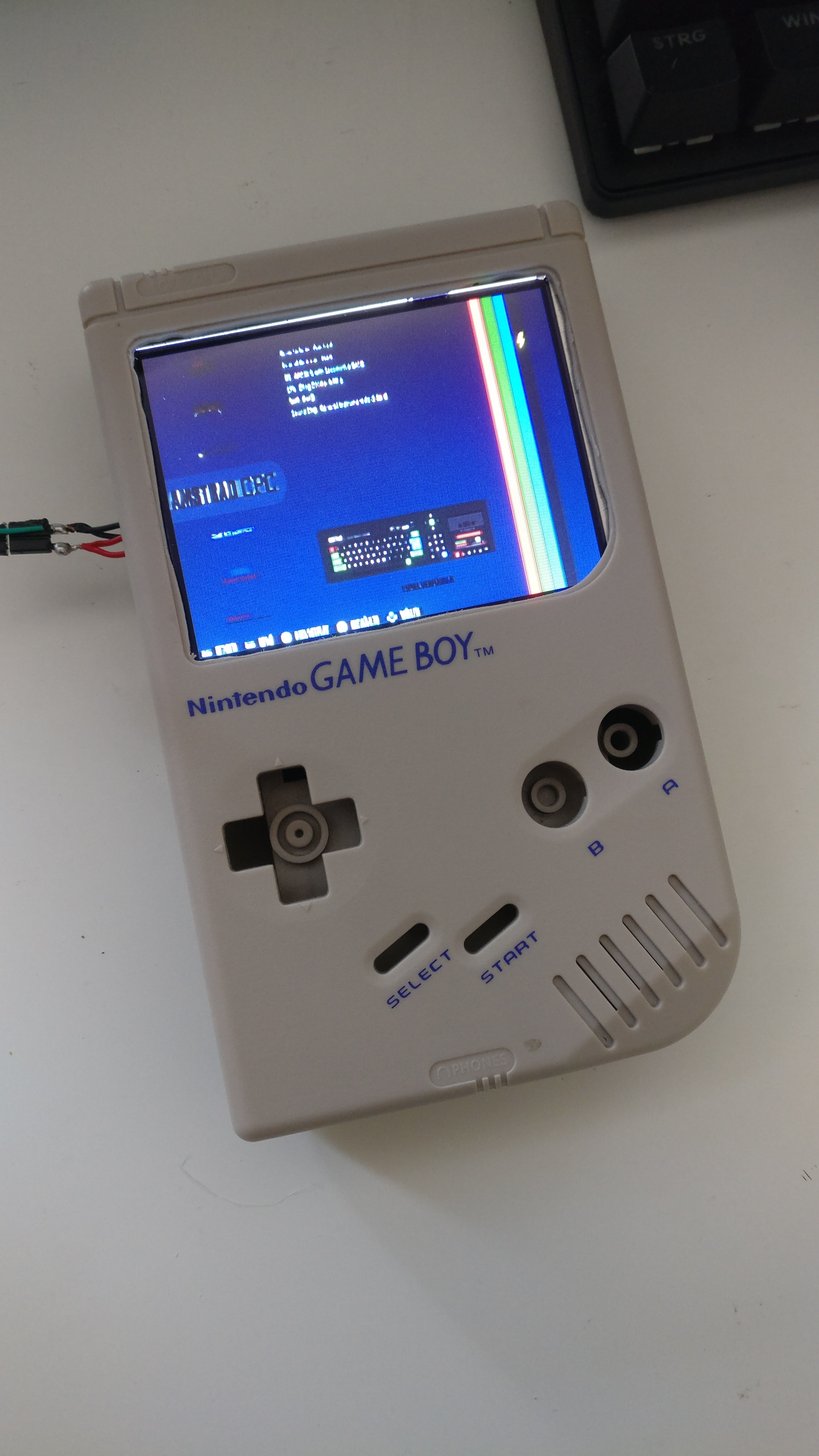

Until now I have modded the case to fit the raspberry pi, added the screen and set the pi up. Down bellow some first Images.
Front of the Gameboy
Back of the mod
Side of the Gameboy with the ports
The Gameboy turned on
hdmi and aux of the pi
Inside It looks like:
Inside what i modded
inside with the pi in place
how the pi is screwed in
The closing is until now not that straight forward but I have ideas for that ;)

rlcmtzc12 wrote:
Wed Aug 01, 2018 11:44 am
Very nice design I love it
But I want to advise you something
Name the polygon GND so do not disturb yourself in connecting all GND one by one and to save more space in PCB, sorry my English not very will but I hope you get my point.
https://www.youtube.com/watch?v=pRrKirNMuqk&app=desktop
Wish you luck .
rlcmtzc12
Posts: 20
Joined: Wed Aug 01, 2018 10:47 am
Been thanked: 35 times
Re: GameBoy Zero with RP3 (unmodded) and custom designed PCB with USB-C charging
Post by rlcmtzc12 » Wed Aug 01, 2018 3:16 pm
Thanks, yhea I realized to late that this is a thing in the editor I used and so I already connected all grounds with another. But in V2 I will do this :D
