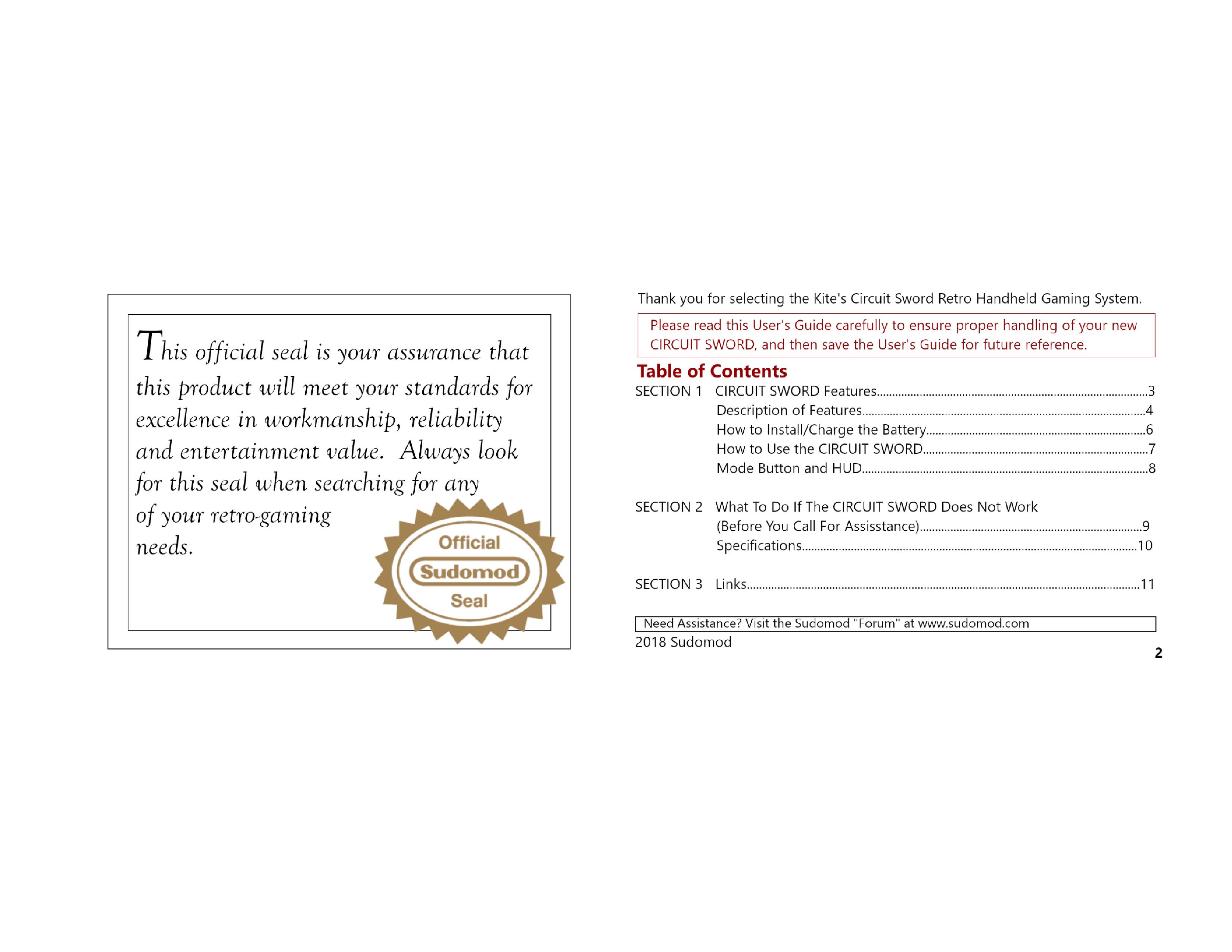

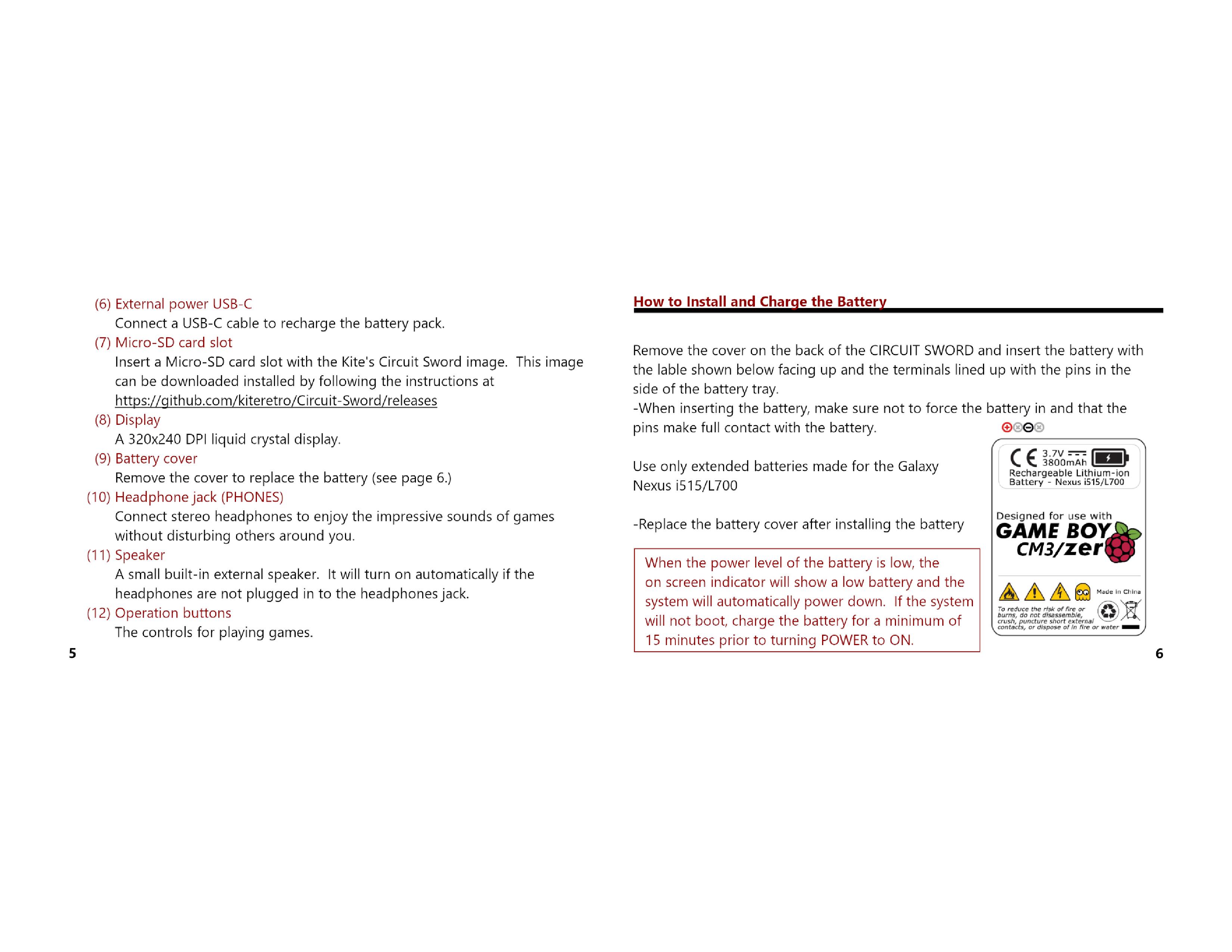

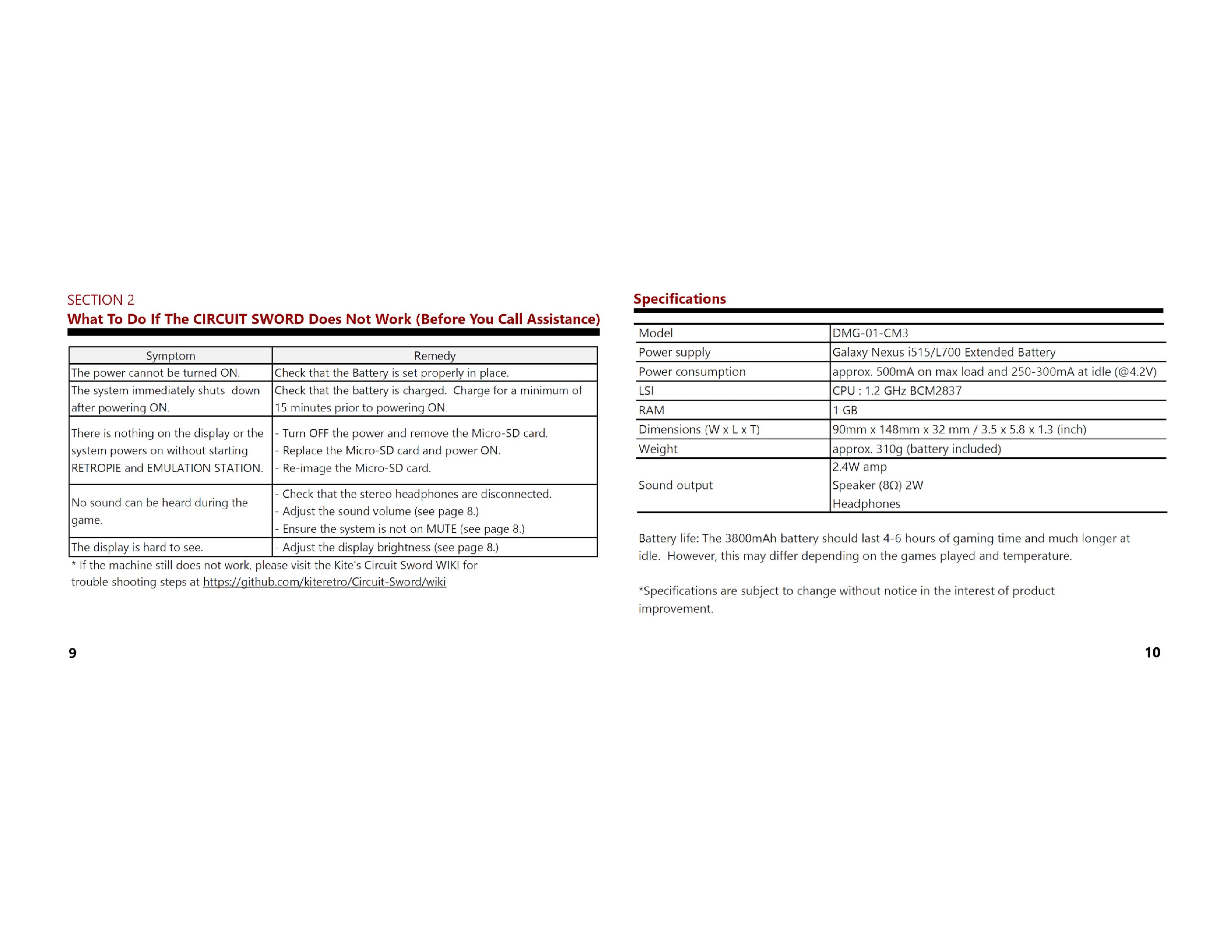

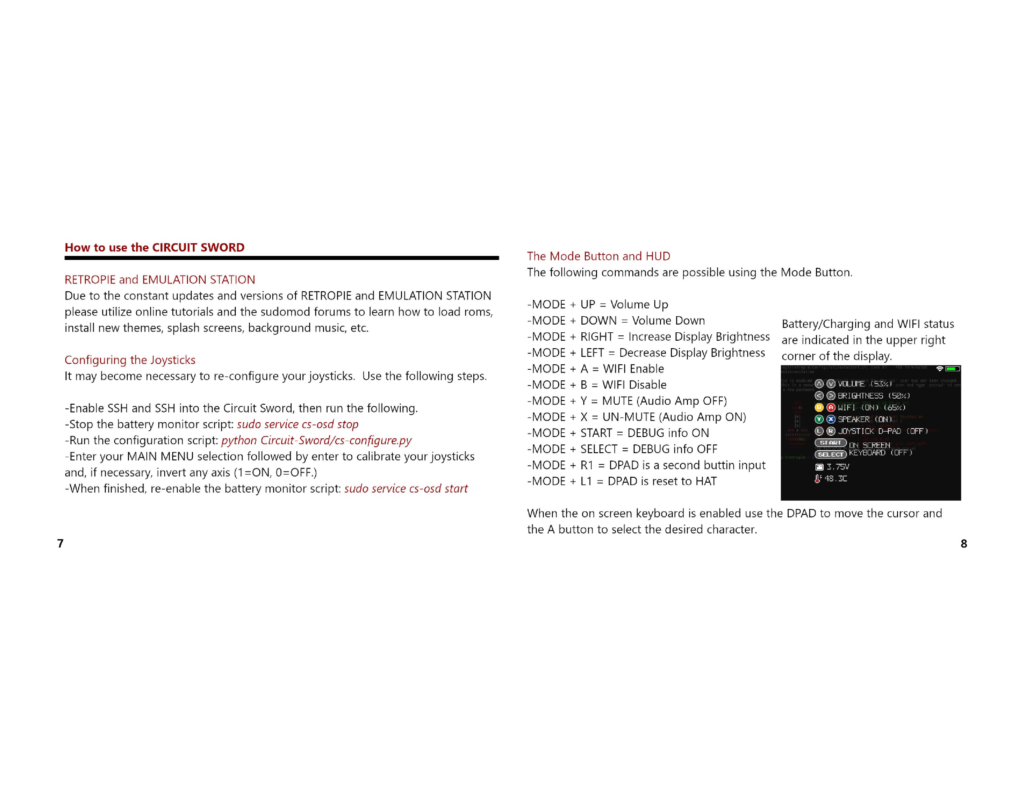

Hey folks... I ended up making a manual for the most recent Circuit Sword.
Enjoy!!! I've posted the GIMP files below in case someone wants to modify it to suit their needs.
GIMP Files .zip -
Manual.rar
(1.99 MiB) Downloaded 959 times
PDF Manual and Printer Friendly Version .zip - -Ant

This is super cool! I didn't know about all those shortcuts for the mode button (I only seem to see wifi on/off and keyboard on my Lite!)

This all applies to the circuit sword lite too I am assuming?
Re: Circuit Sword CM3 Manual
Post by rodocop » Tue Nov 27, 2018 10:44 am
littleferris wrote:
Tue Nov 27, 2018 10:37 am
Seems mostly to be the case, but on my Lite, I do not have all of those mode button hotkeys, all mode does is show is this:
MODE + A = WIFI ENABLE/DISABLE
MODE + B = ON SCREEN KEYBOARD ENABLE/DISABLE
It also shows the battery voltage if I recall correctly.
Need to control the brightness etc...via those little switches in the battery bay.

At the 3rd picture I see under the "description of the features", nr (2) a double "button". So if you remove one of them, it's all right again.
Awesome thank you. Don't have access to my computer for a while. I try to fix it in a few months.
