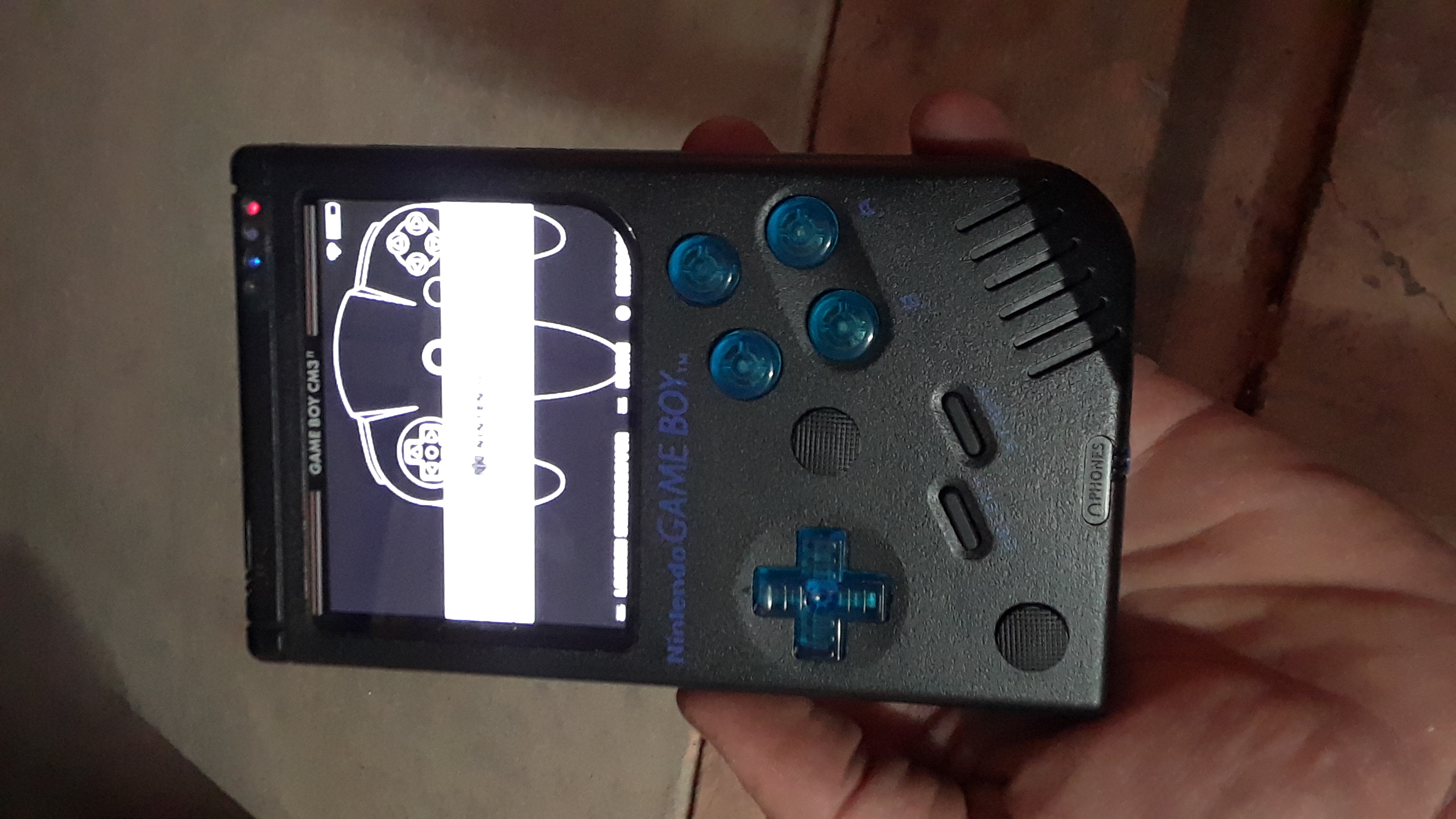

Thought I'd share my first build. It's a Circuit Sword build from the first round of orders, so there's not much that hasn't been seen.
Black shell, clear blue buttons, two PSP1000 joysticks, my personal "BatteryCoverButtons" for shoulders/triggers, YaYas screen glass and optimization. HoolyHoos stormtrooper theme.
I did, however, overclock the cm3 pretty high and have DiddyKong Racing running flawlessly.
The game cartridge is a clear blue and I added a couple blue LEDs to illuminate with power on.
Also, made the holes for the CSO LEDs in front instead of on top. That placement seems to have adjusted the brightness to a more comfortable level for my taste.

Looks sweet - illuminated case modding seems to becoming a thing in the GBZ community this week.
Great job though, looks clean!
I'm interested to know, looking back. Is there anything you would have done differently?

Only thing I would've done differently is make the time to finish this build sooner! I did have some unforseen circumstances, however, (newborn not sleeping for months) but that was out of my hands.Hellweaver666 wrote: ↑Fri Nov 16, 2018 1:09 amI'm interested to know, looking back. Is there anything you would have done differently?
Kite did an amazing job with simplifying this build process and simultaneously maximizing it's potential. Amazing to say the least, but I know he doesn't need us to tell him that.
I will have to check the numbers when I get home in order to specify accurately. But, if I remember correctly, I was trying to push it as far as the max for the Pi3B+ and I may have went a little further. Please don't quite me on that yet. I do remember being pleasantly surprised to see no kernel panics or freezing the entire time. I will update with exact OC numbers as soon a I can.
