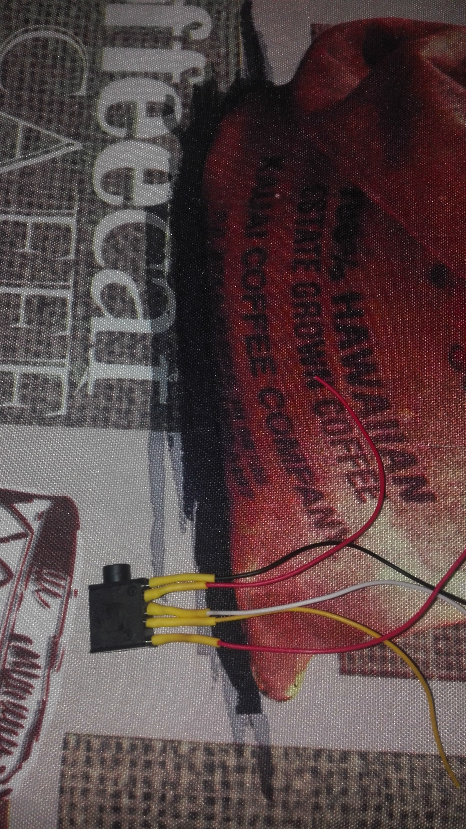

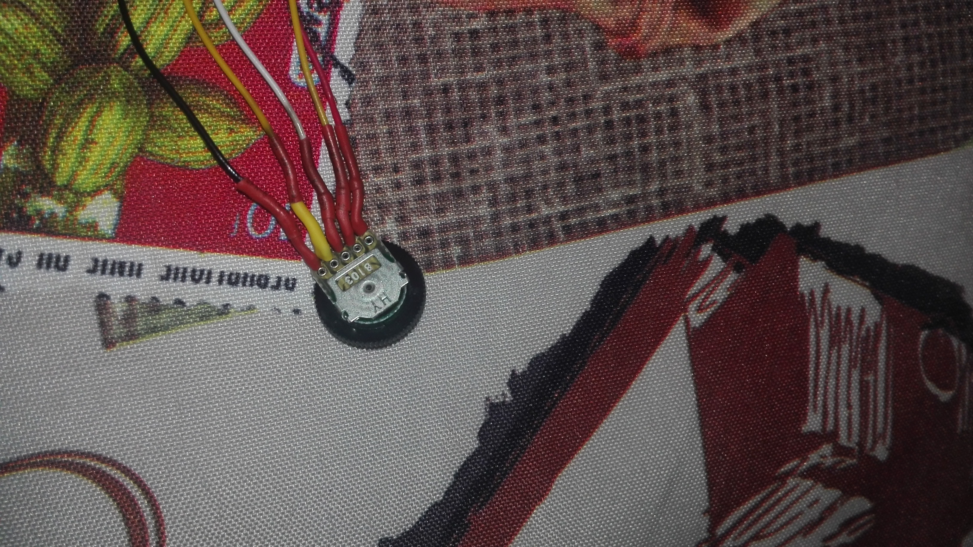

Ruleta de volumen con todas las soldaduras
Conector jack con todos los cables soldados

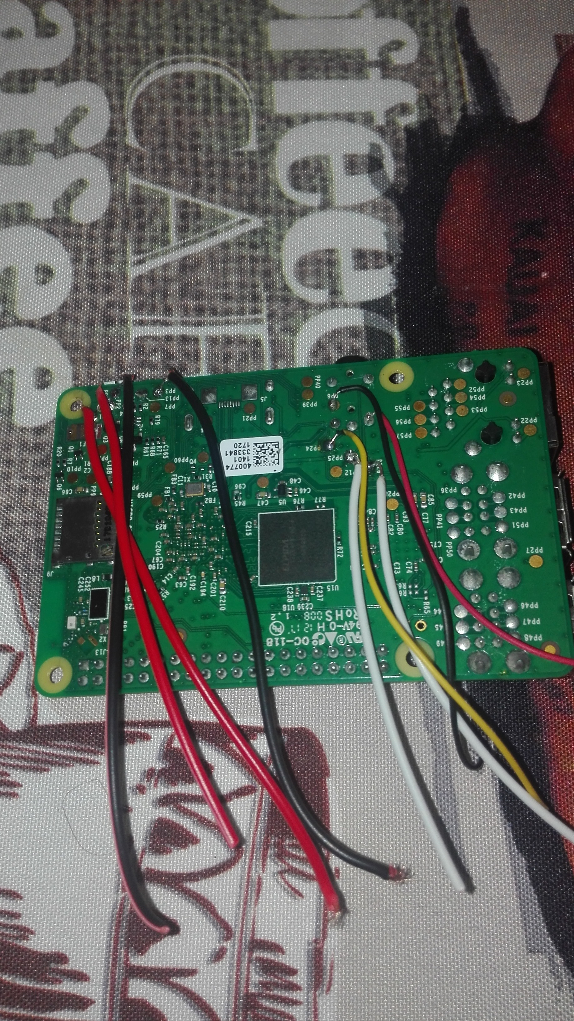

Raspberry con todos los cables soldados

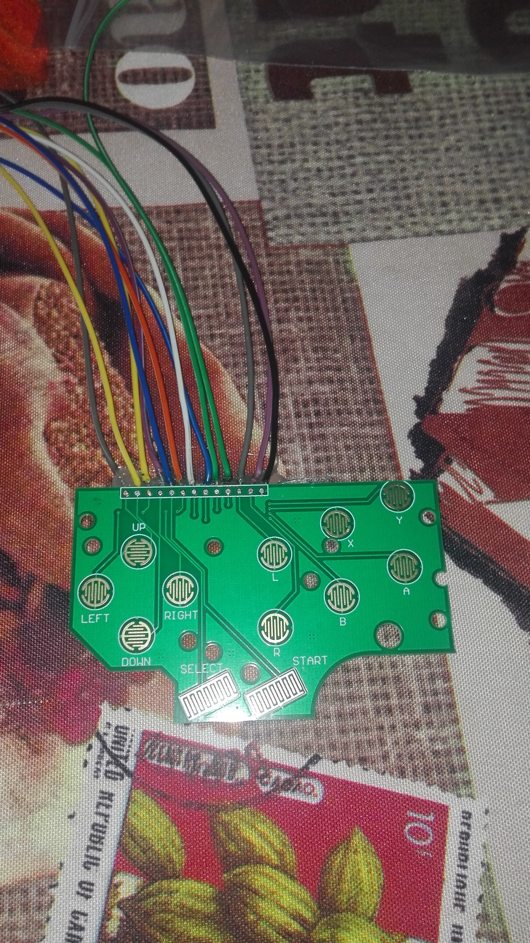

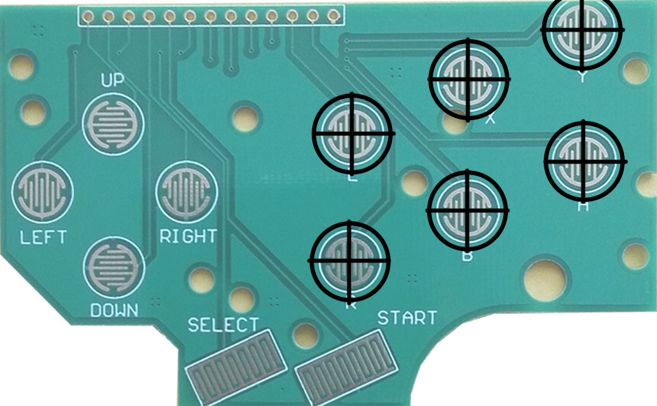

Controlador botonera adquirido en Aliexpress

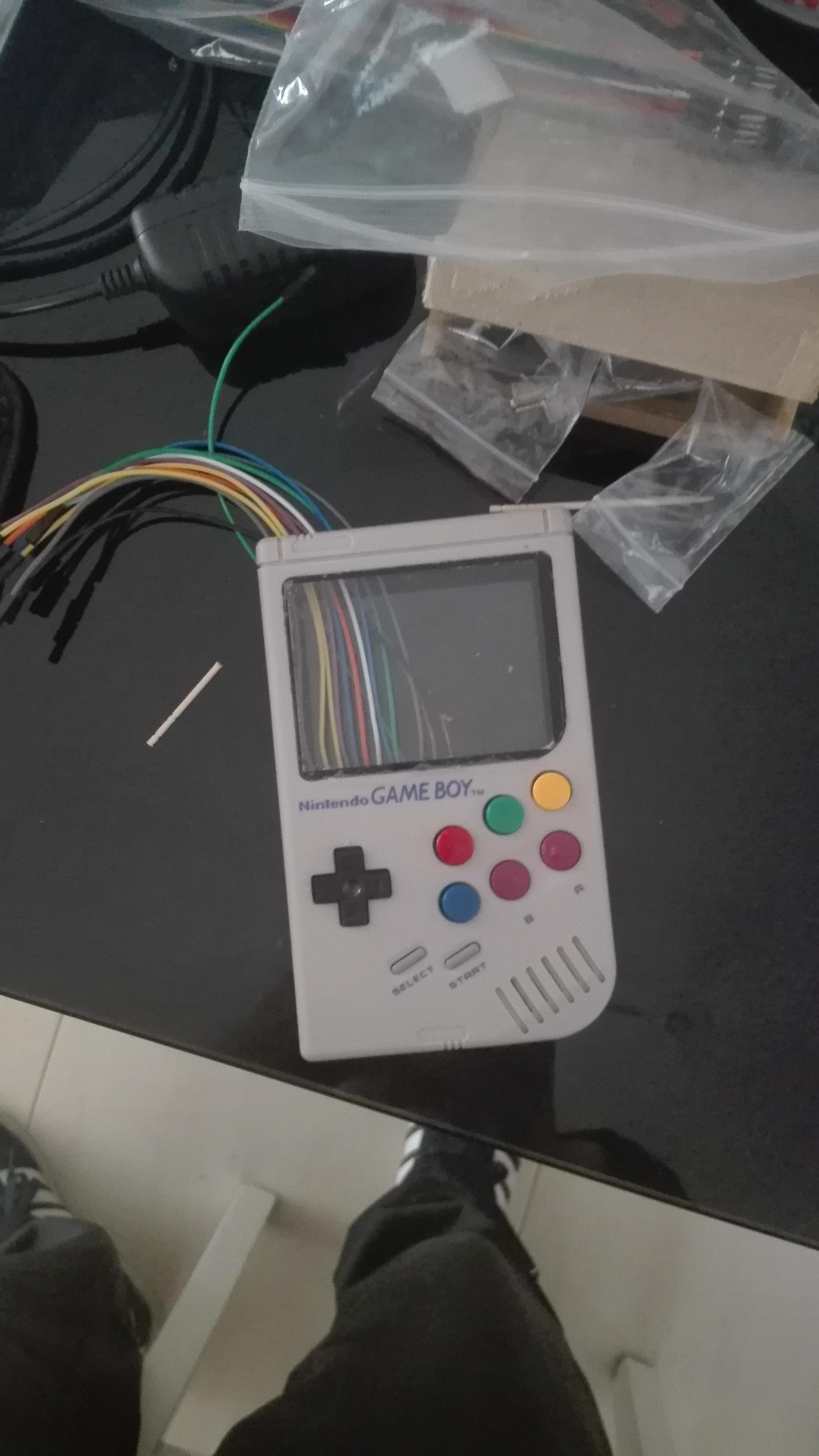

Carcasa modificada

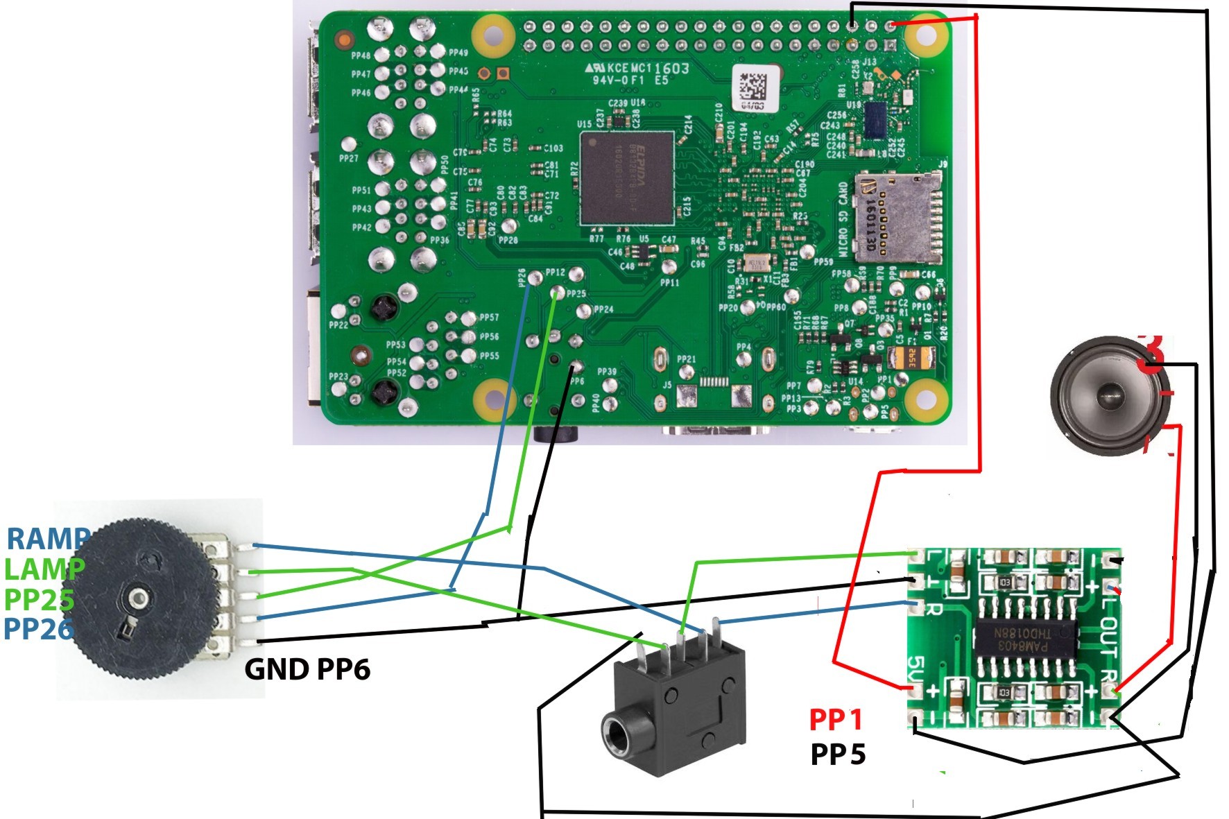

Hello friends.
For those who are a bit lost, here is a small outline for the sound of our Game Boy, based on Rpi3. I've tried it on my project and it works perfectly.
I hope it serves you.
A greeting.

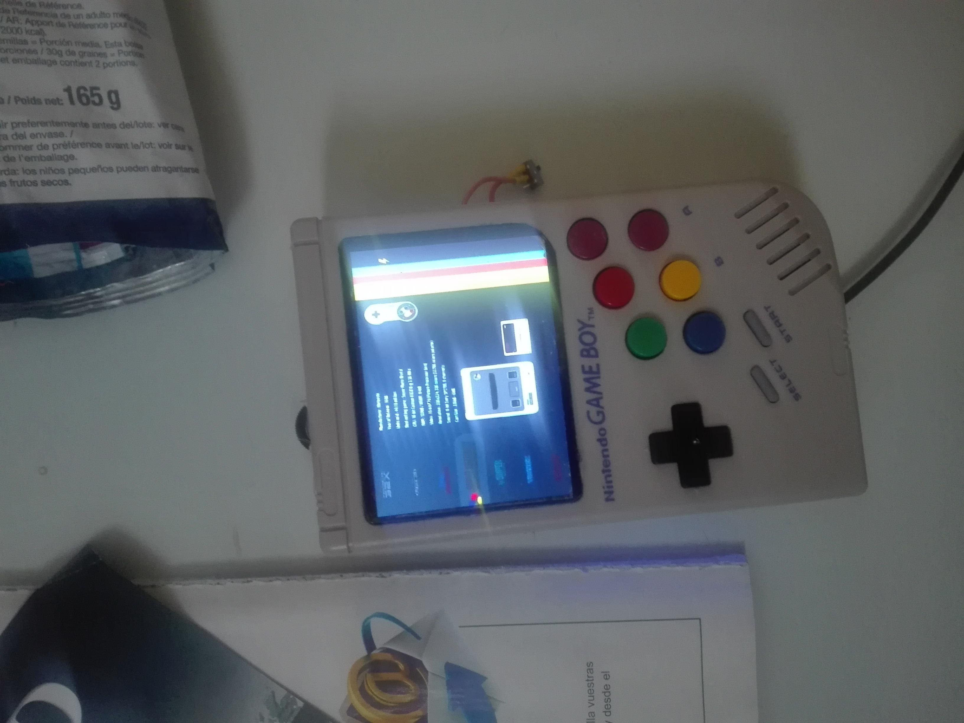

Post by gazpachero » Fri Jul 26, 2019 2:25 am
Here you can see the final result. To power the raspberry I used two batteries of a Samsung S2 in parallel. It works very well. If you have any questions, shoot.
