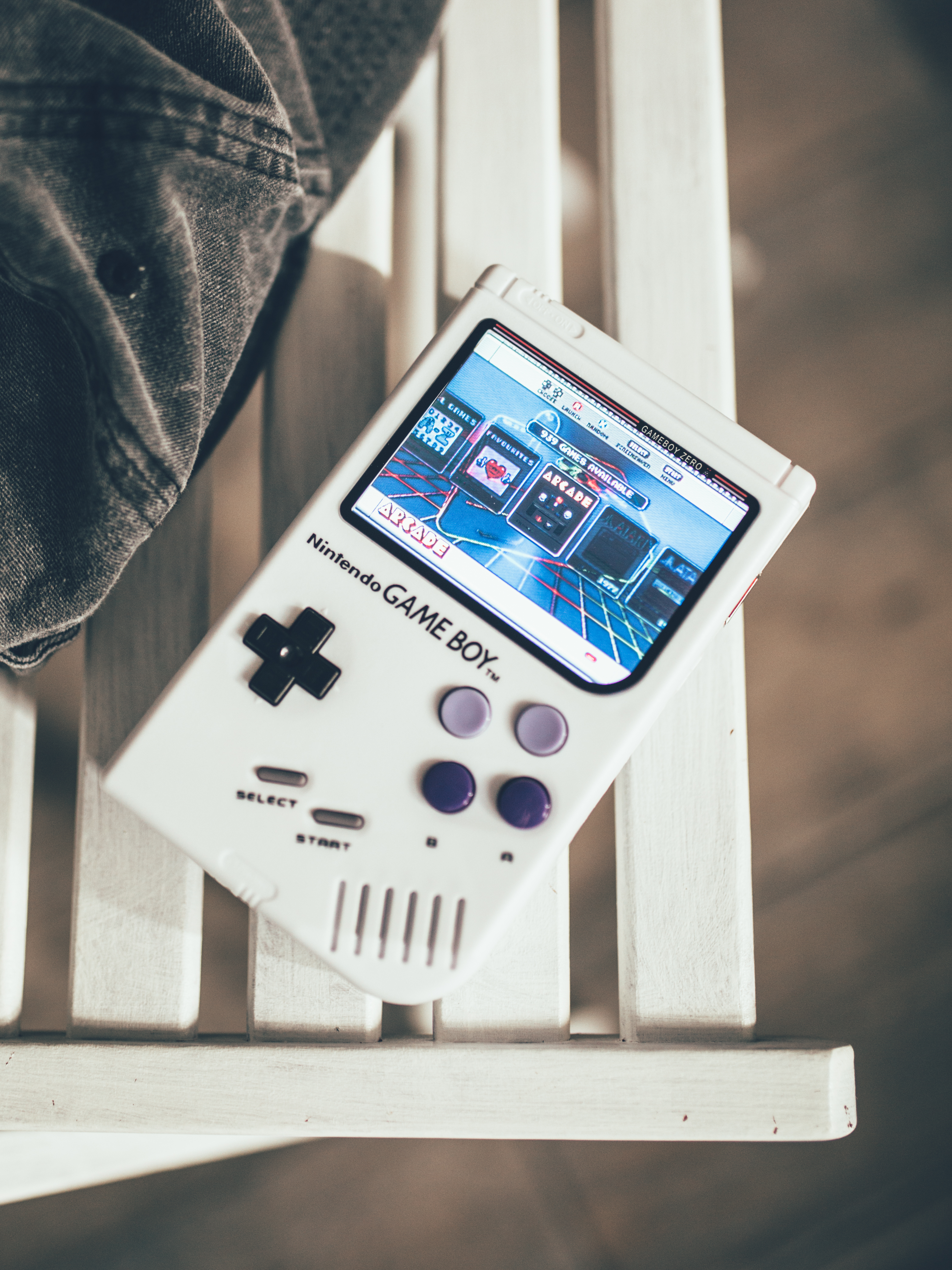

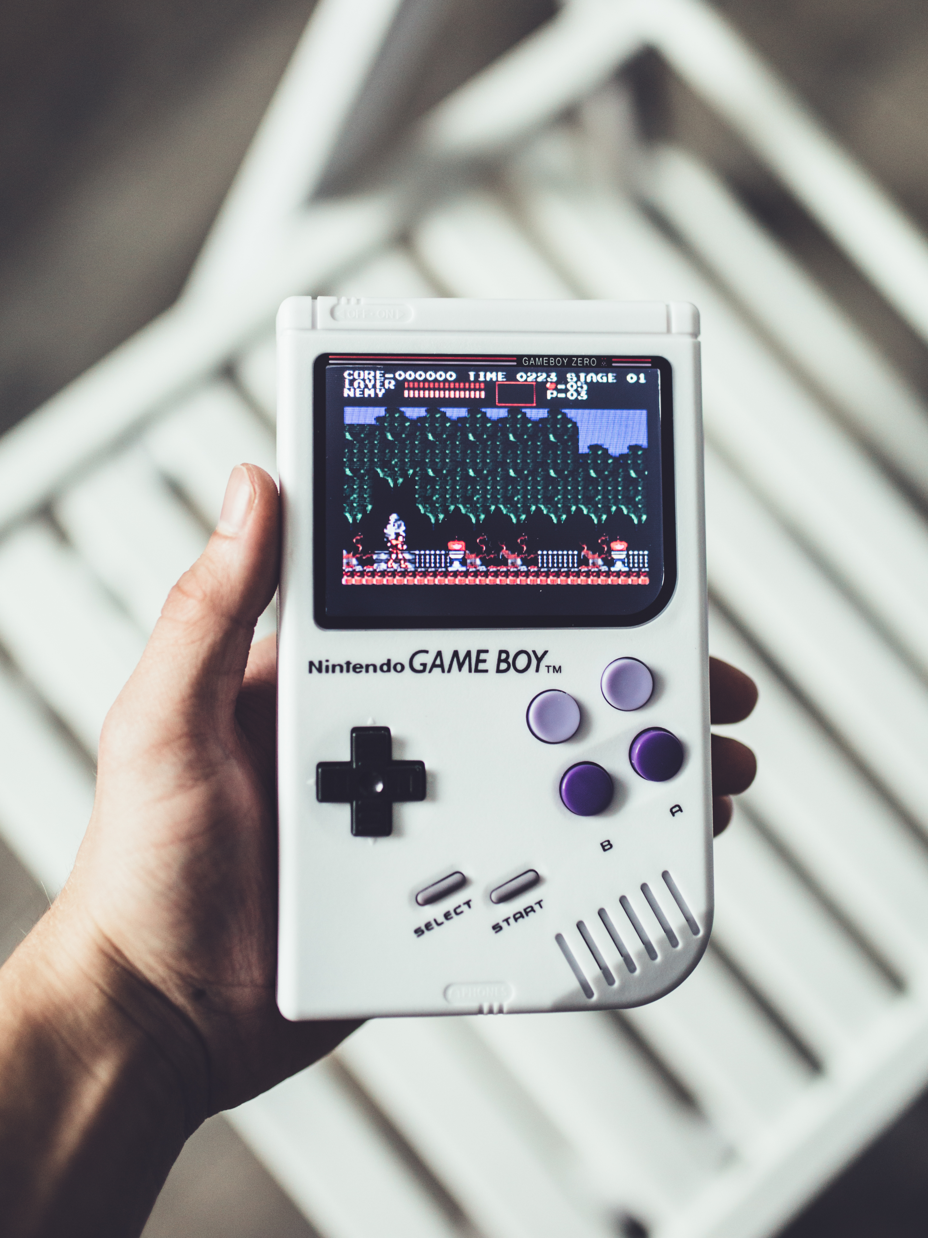

My first gbz build is finally done and I can't thank this forum enough for the help!
everything works well but there is no safe shutdown or battery monitor :( and I was pretty unhappy with my dremel job on the shell so my second build will have safe shutdown, battery monitor and I'll use a 3d printed stencil for a better dremel job! (also is it possible yo use Arduino pro micro as a battery monitor?)
There's also a pop with the speaker when the device turns on but I can live with it.

Now that's a good looking Gameboy! The Super Nintendo controller theme really came out well.
thank you :D
