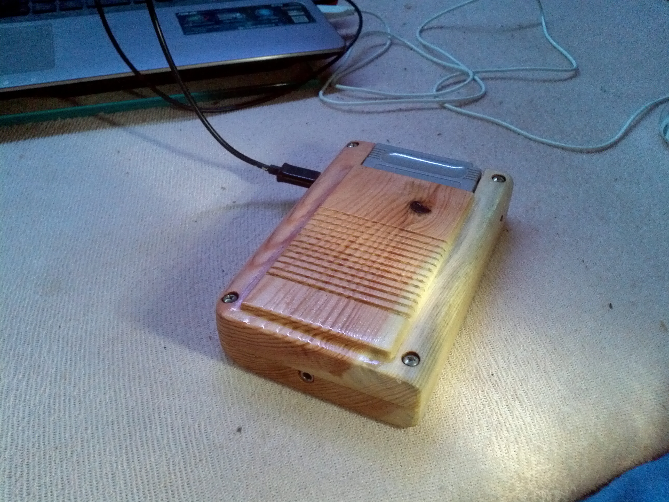

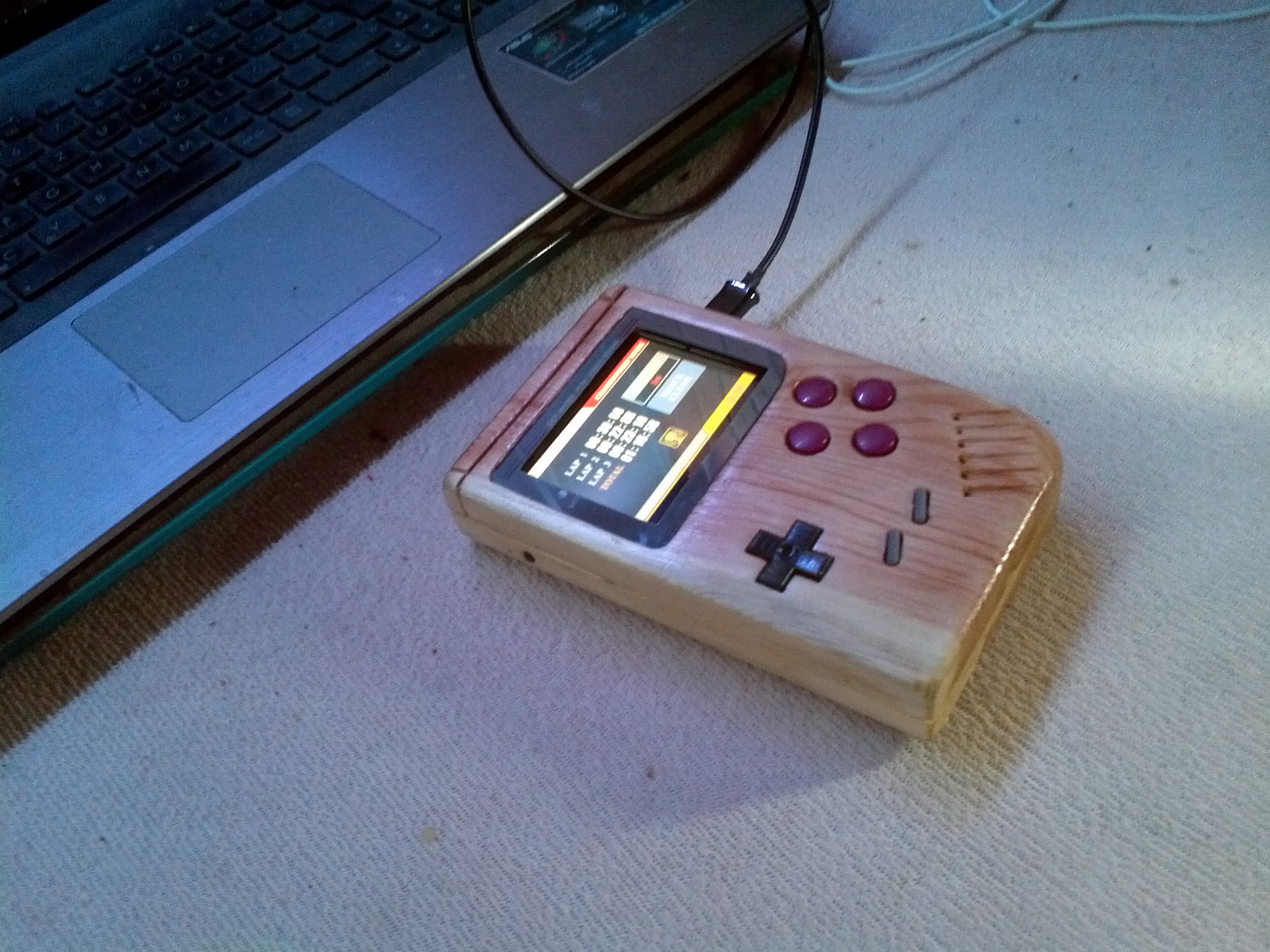

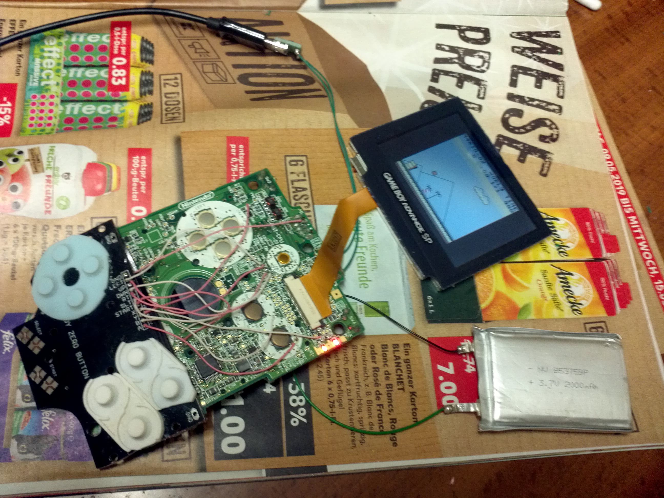

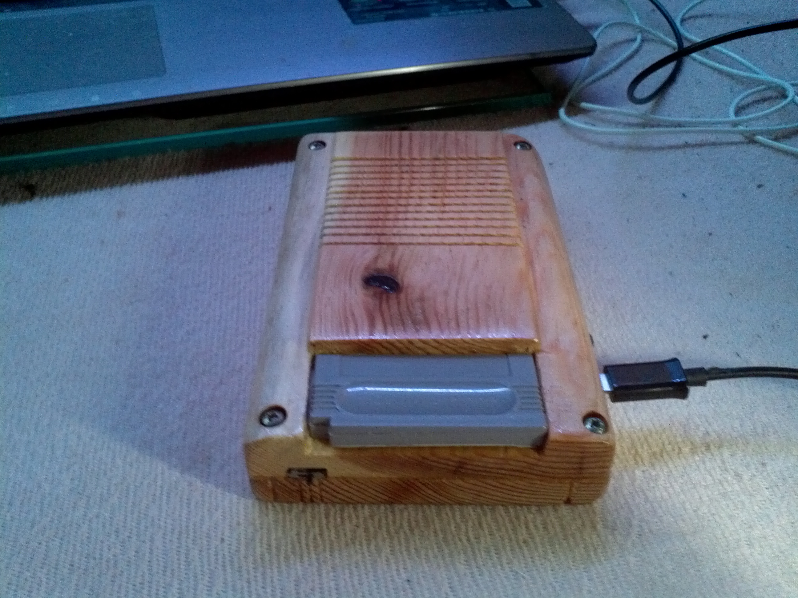

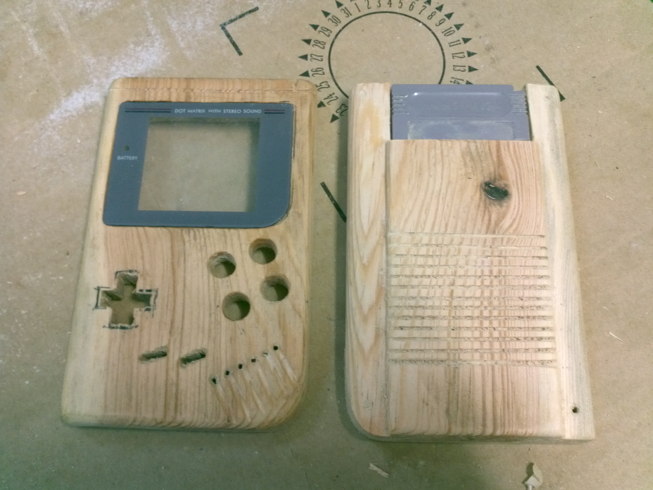

Hi, build a DMG with wood. right one children playing with toys out of wood! :D Oh, it was a lot of work... All is handmade without machines. Very stupit idea to do this! :?

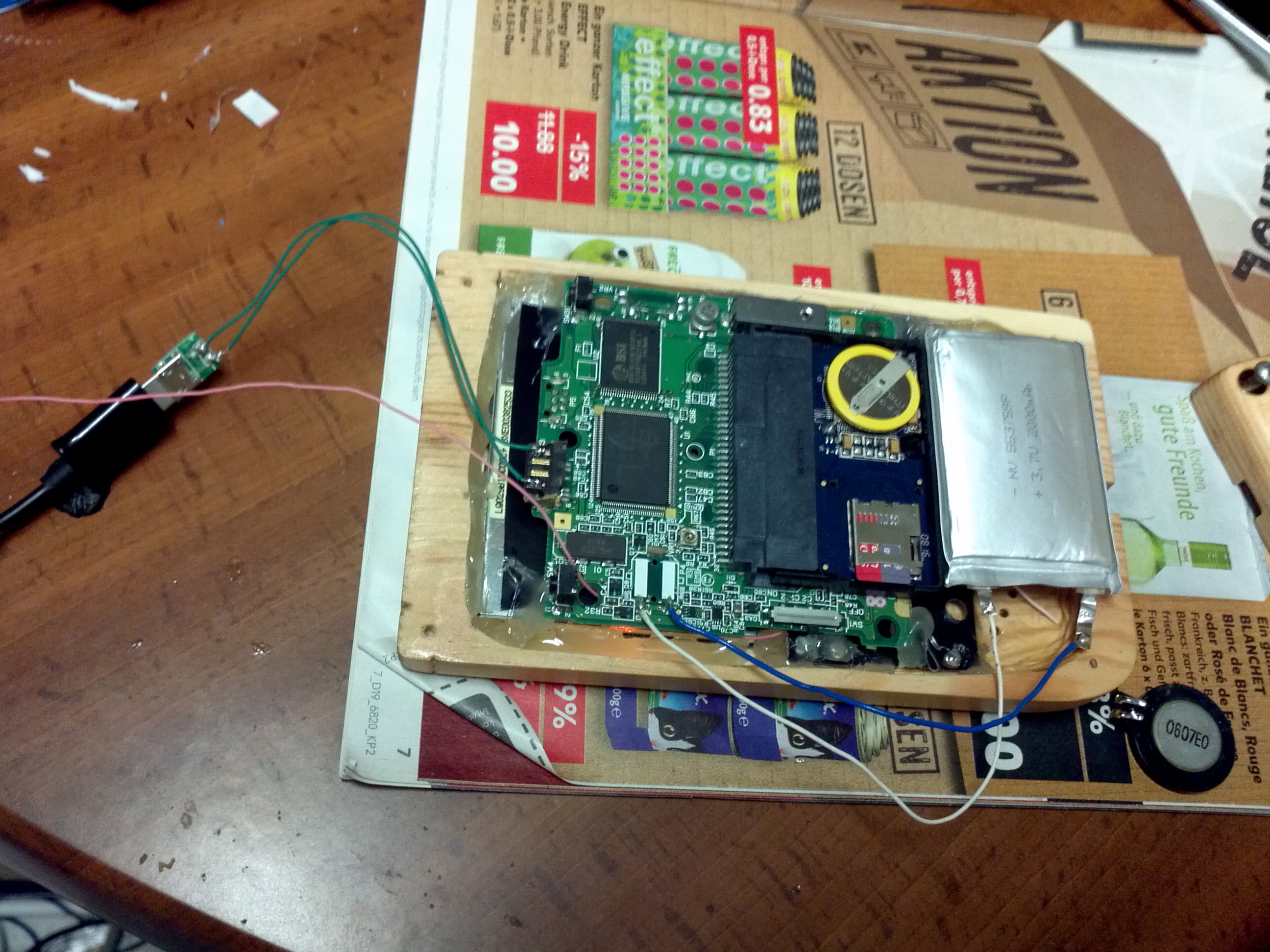

Inside is a GBA SP ags-101. First plan was to fit a Bittboy in it. But this Consol is to buggy at the moment. Now the DMG have 4 buttons on Front and X+Y now sholder buttons from GBA.
Use a micro usb breakout board to load and a 2Ampere Lipo. A reset switch is on the left side and on the right the orginal Volume slider from the GBA. Inside the GB a Ez-flash 4 the Cardridge is only Dummy. The wood finish is 3x layer of clear lack.

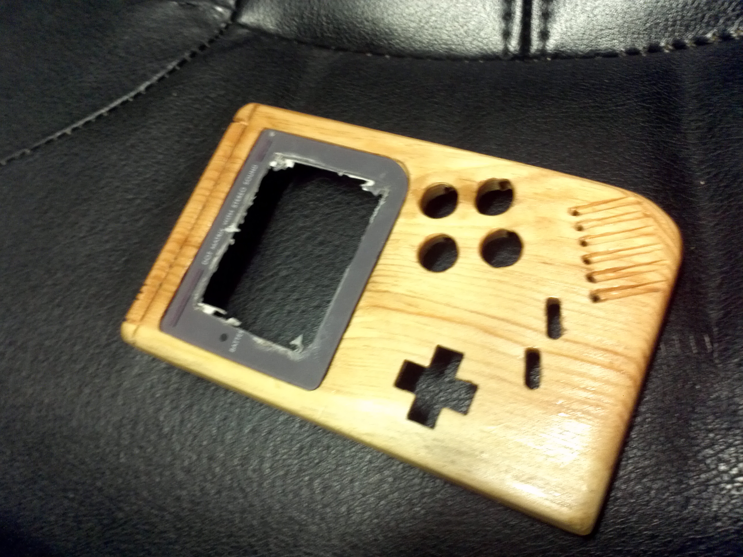

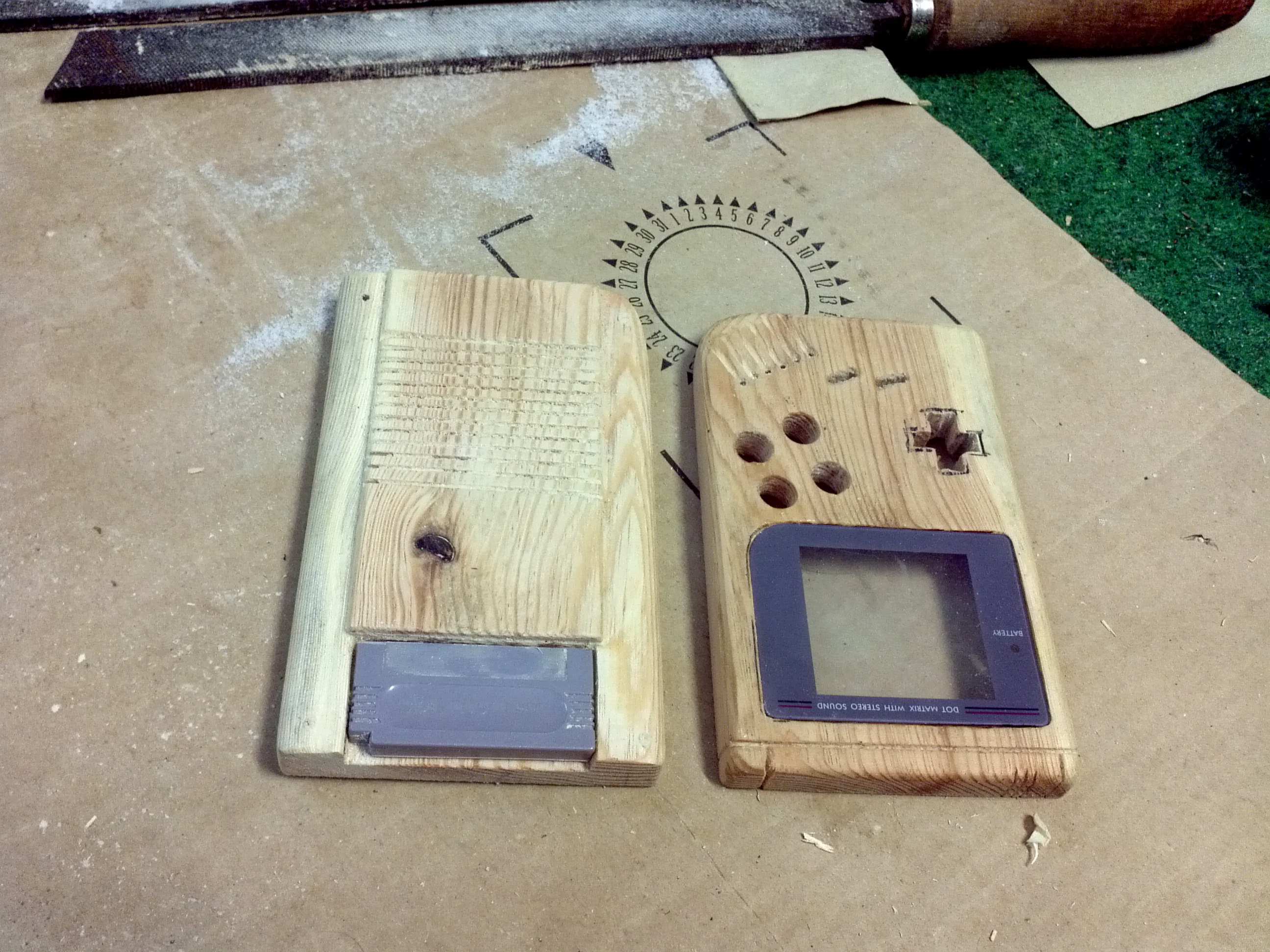

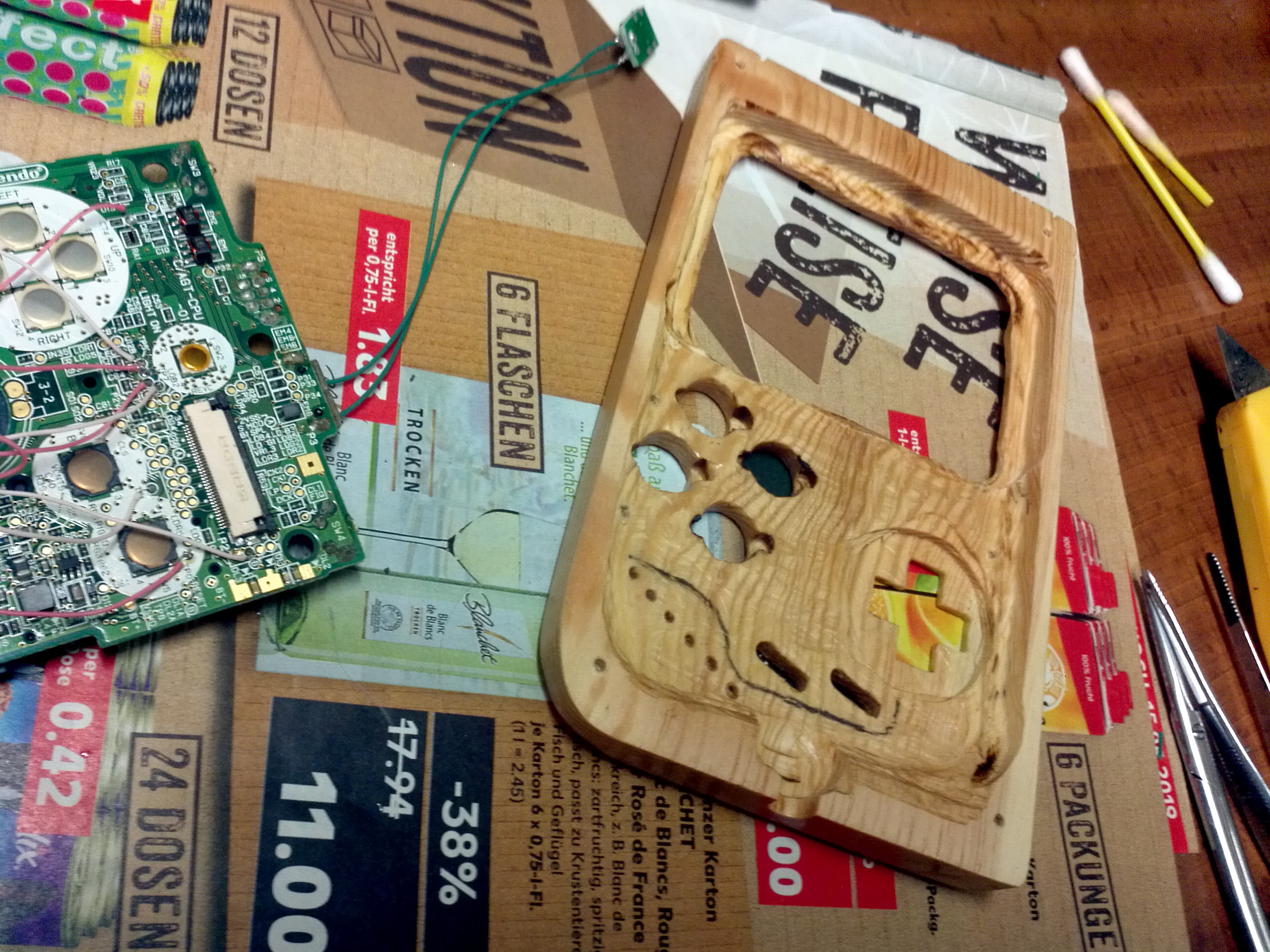

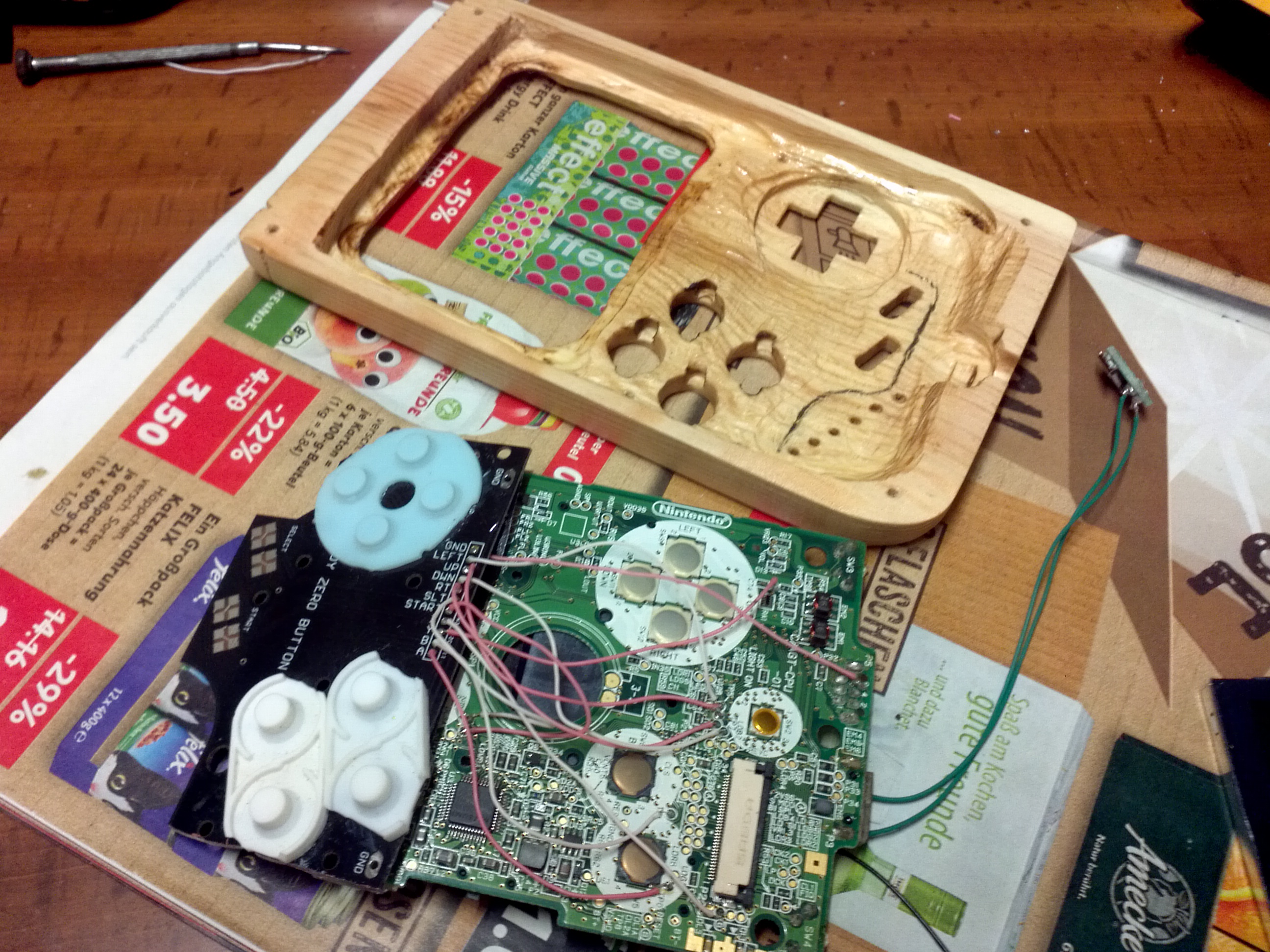

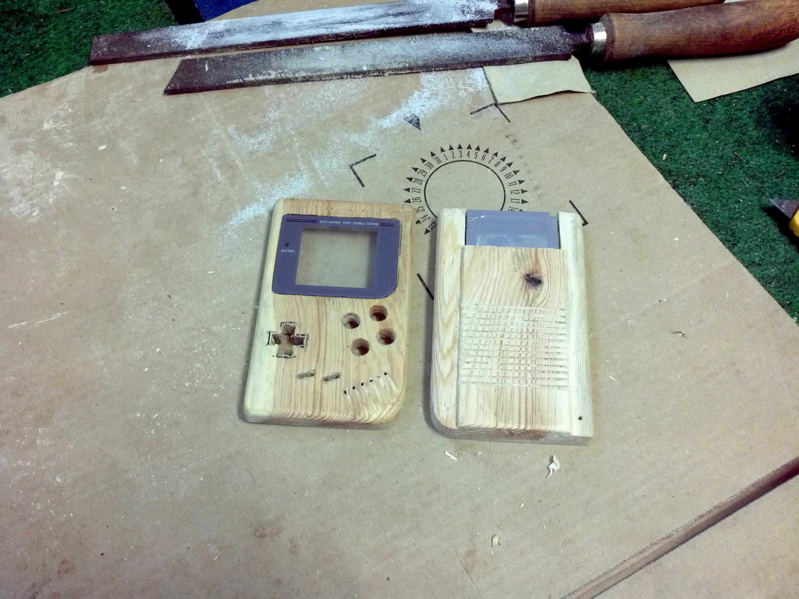

Some more pic`s:

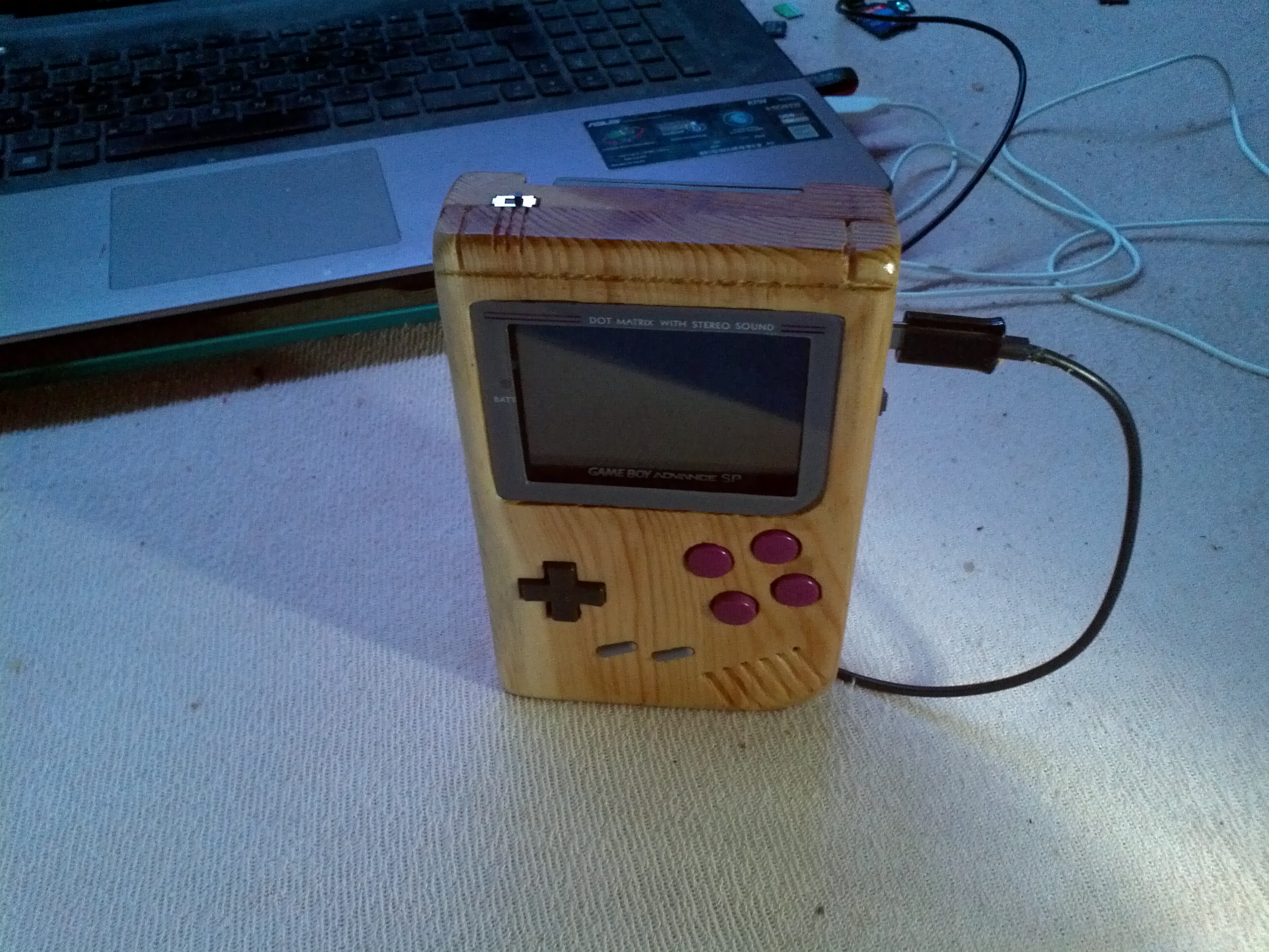

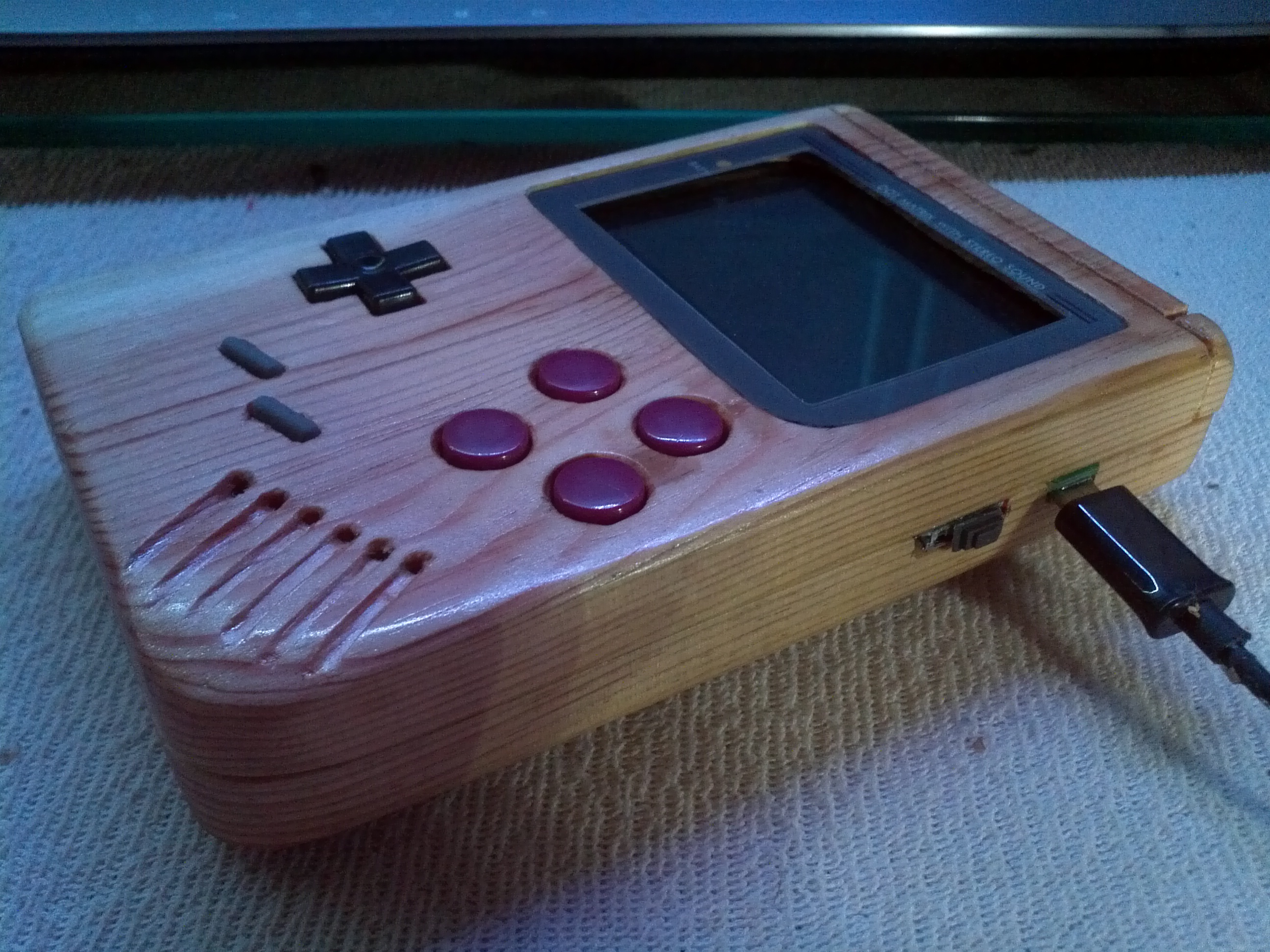

Post by nexus23k » Wed Jun 12, 2019 3:36 pm
Finish:

Thank you guys! Next build with pi-zero and a small 2,4" Screen is started.
