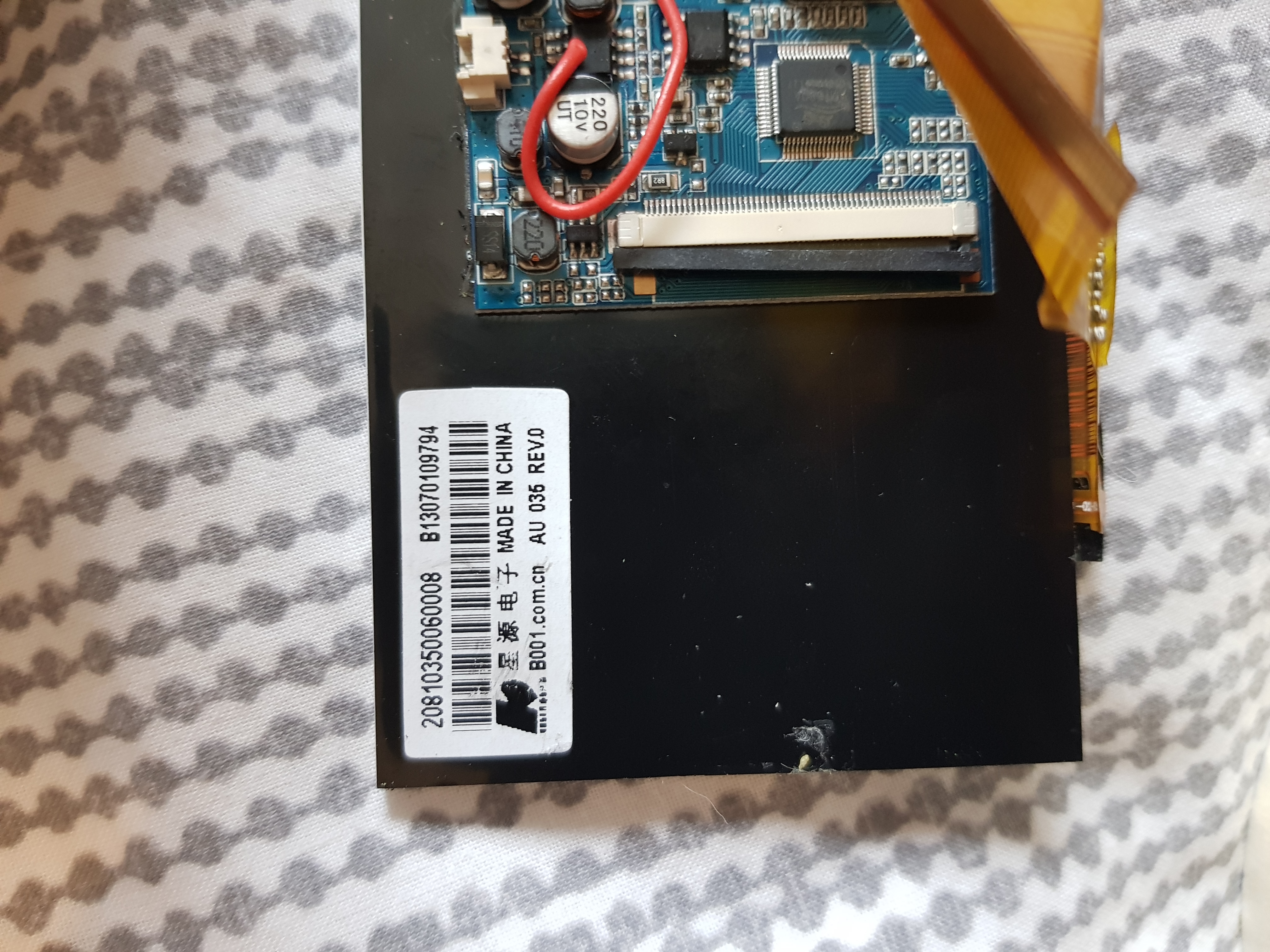

When disassembling, I found that the LCD screen was shot - a resistor had been knocked off the ribbon cable (possibly by me). Had no idea how to repair it (or even if it can be repaired?!)
First port of call was to buy a replacement BW 3.5" reversing monitor. When it arrived, I removed the LCD then modded it for 5v as per the Sudomod wiki.

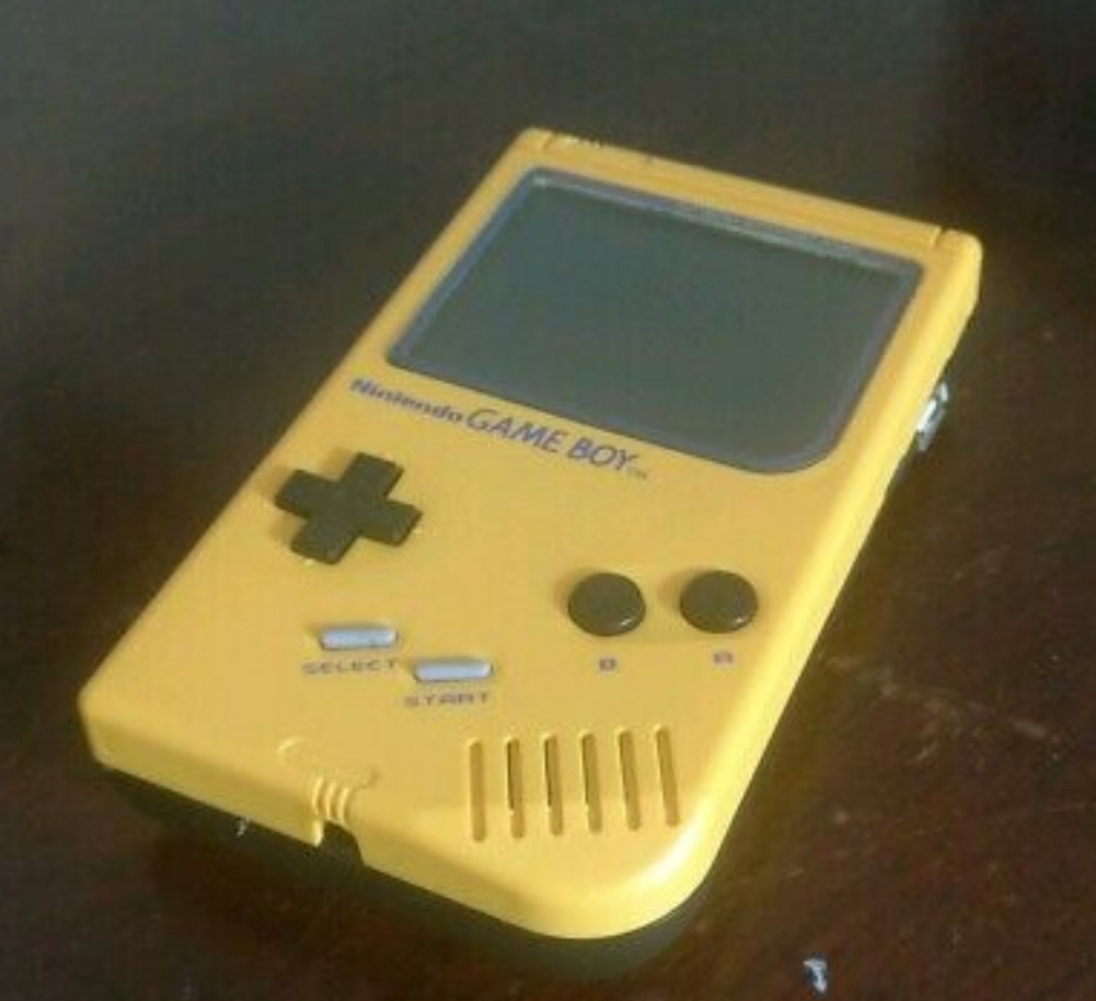

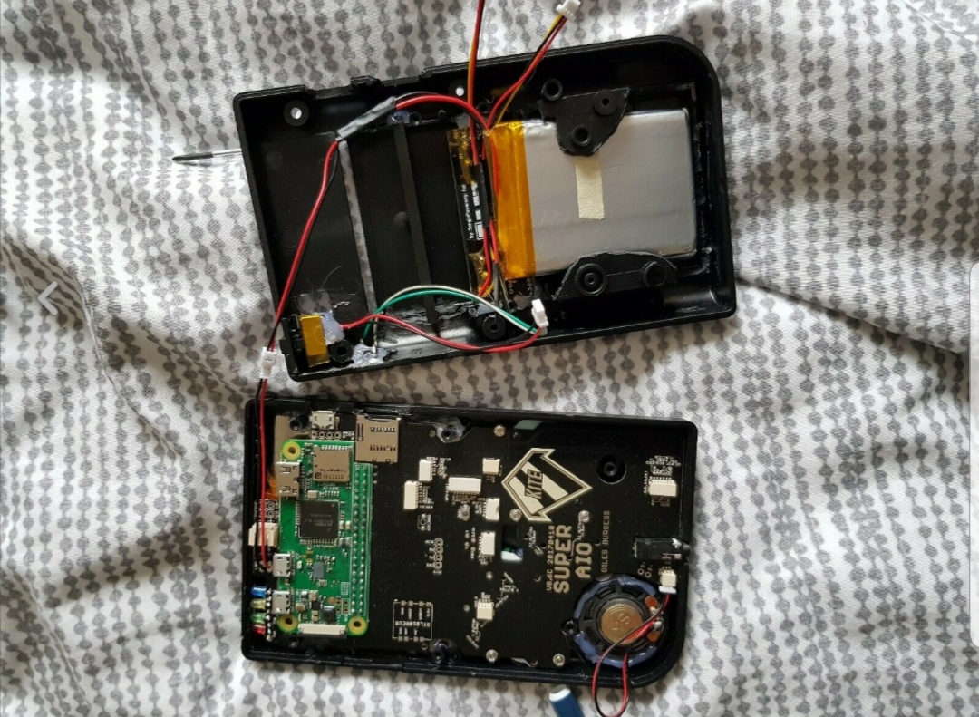

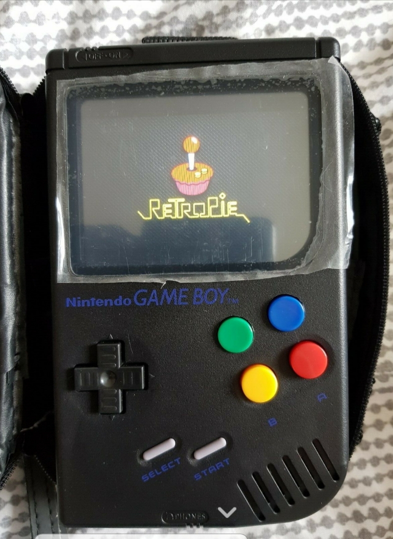

Sorry about the photos... my completed Kite Super AIO build
- 20190713_224402.jpg (587.12 KiB) Viewed 13887 times
- 20190713_224420.jpg (644.41 KiB) Viewed 13887 times
- 20190713_224438.jpg (495.78 KiB) Viewed 13887 times
- 20190713_224904.jpg (516.69 KiB) Viewed 13887 times
- 20190713_224347.jpg (578.57 KiB) Viewed 13887 times

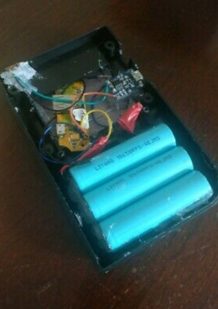

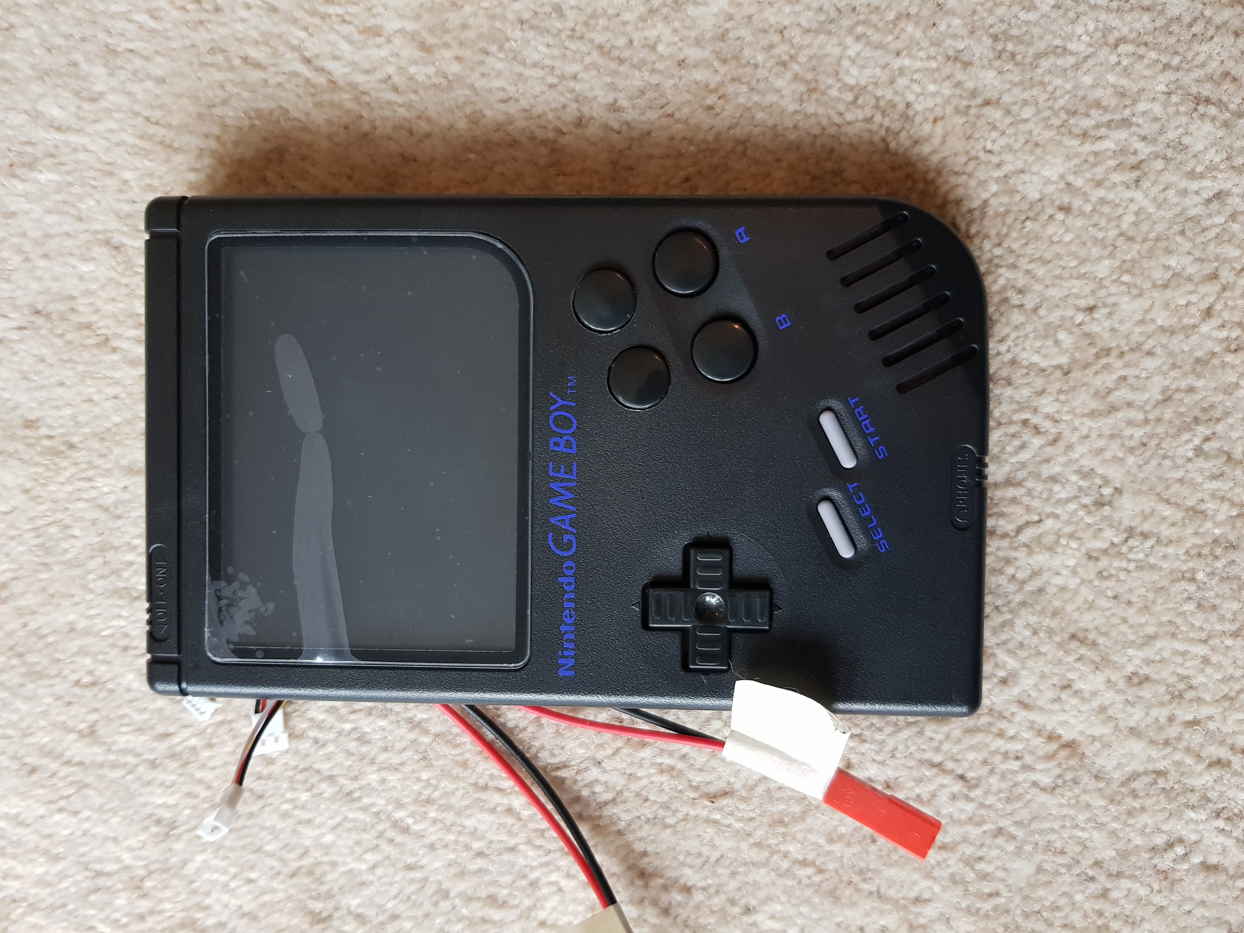

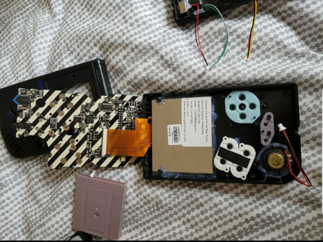

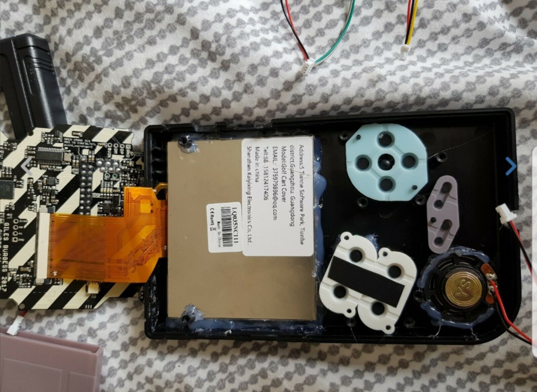

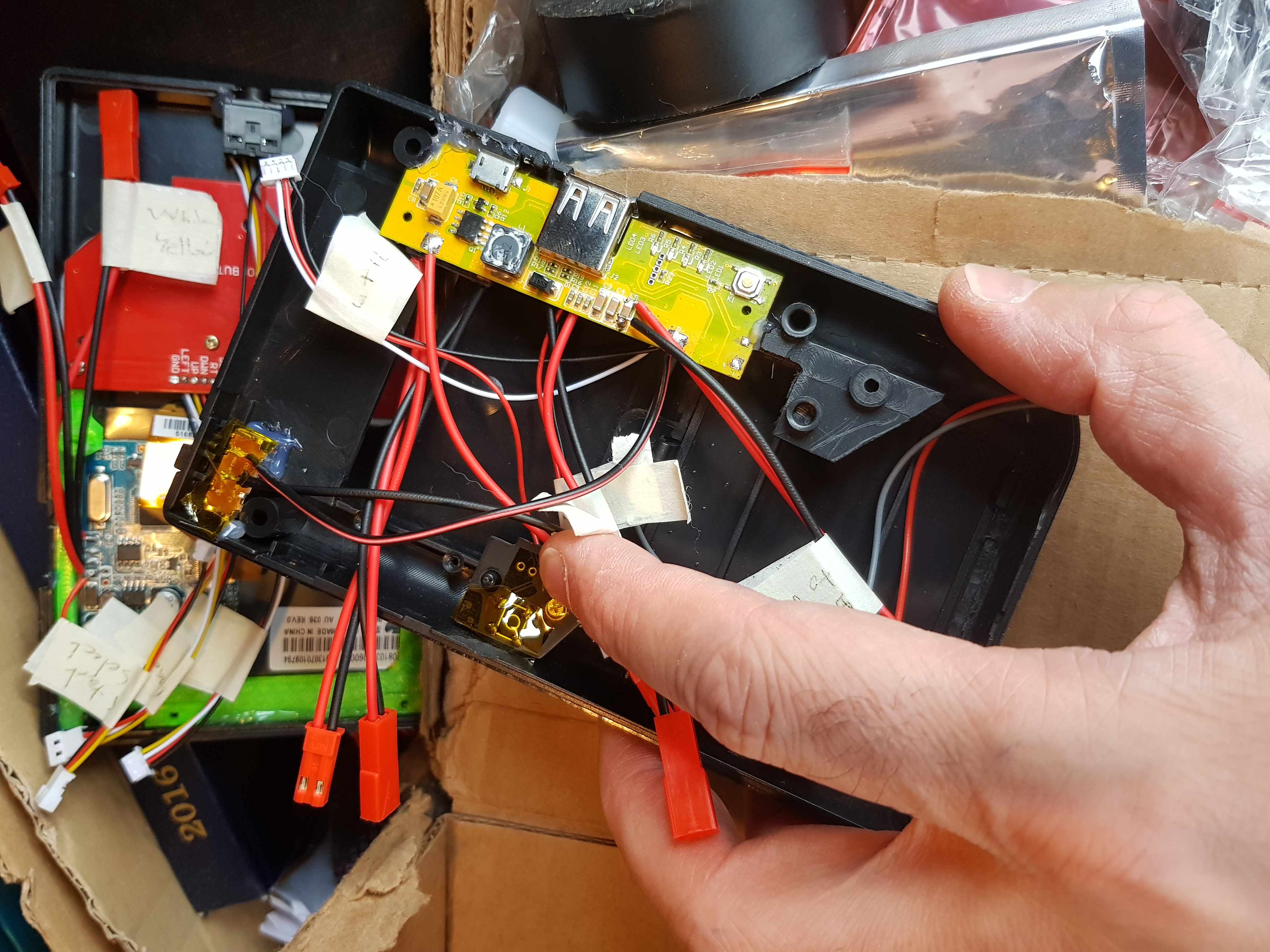

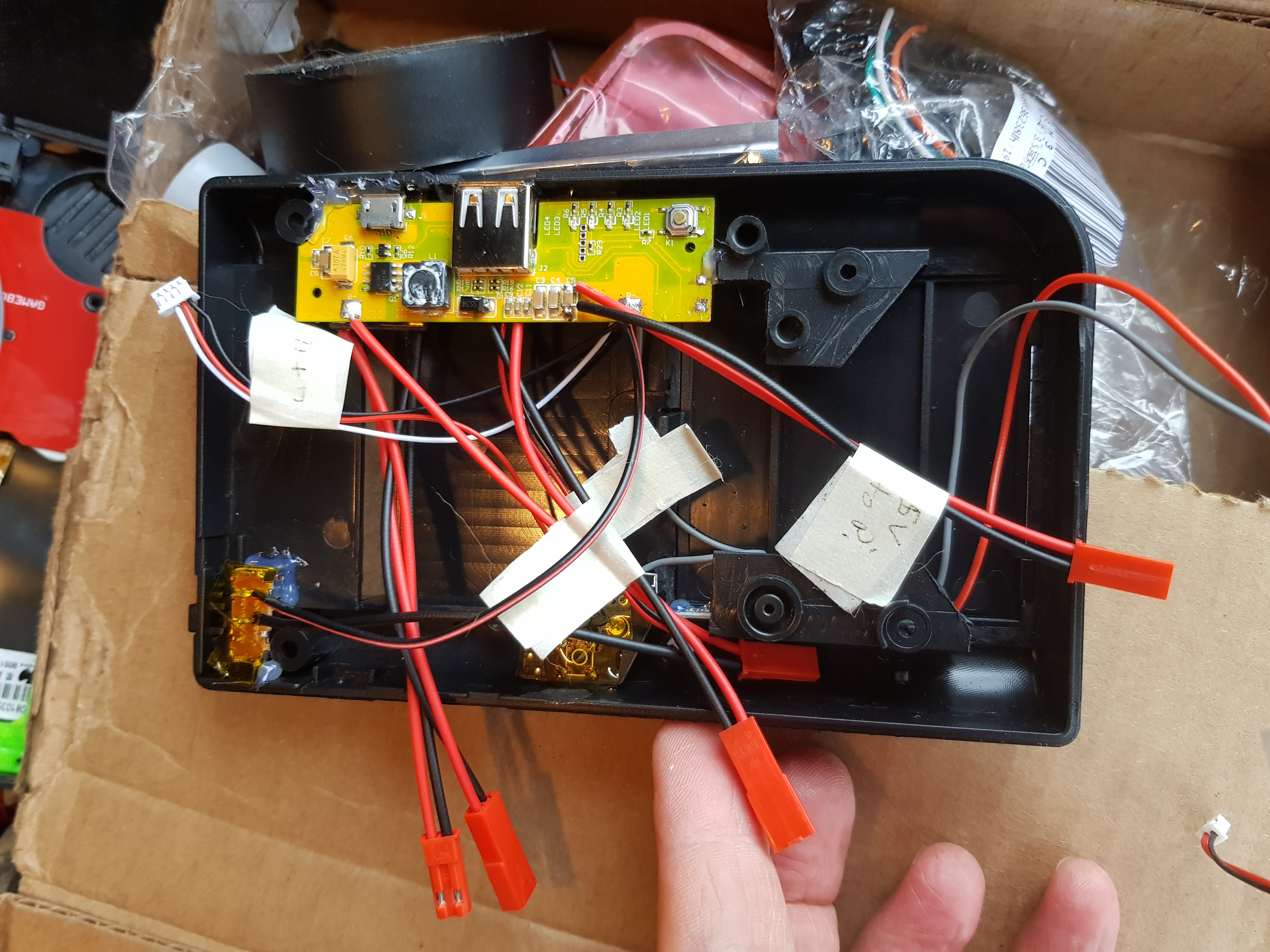

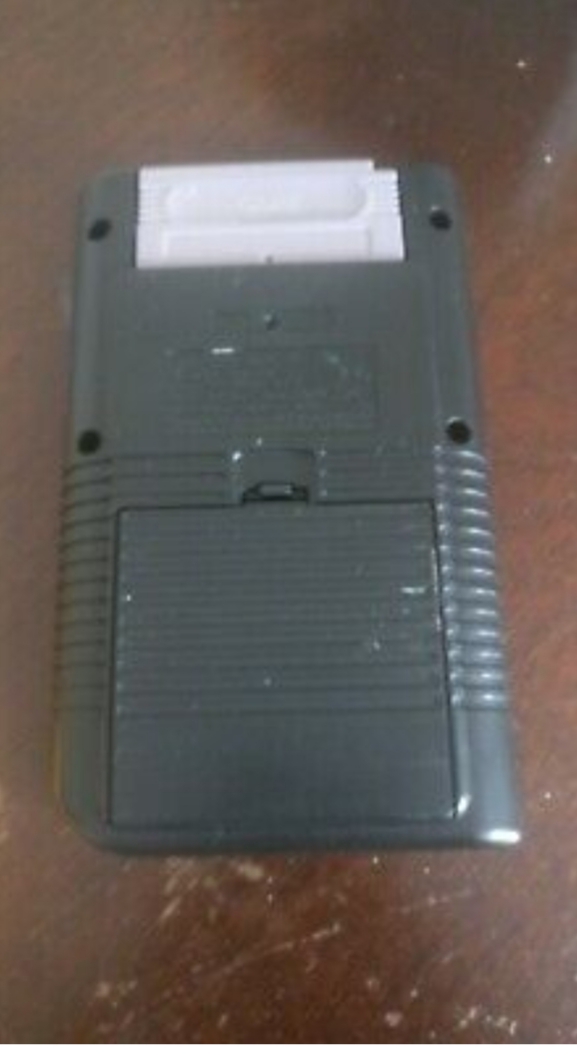

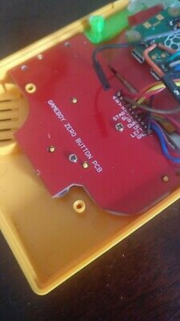

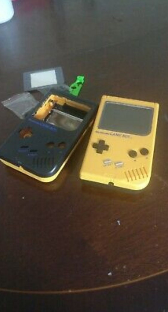

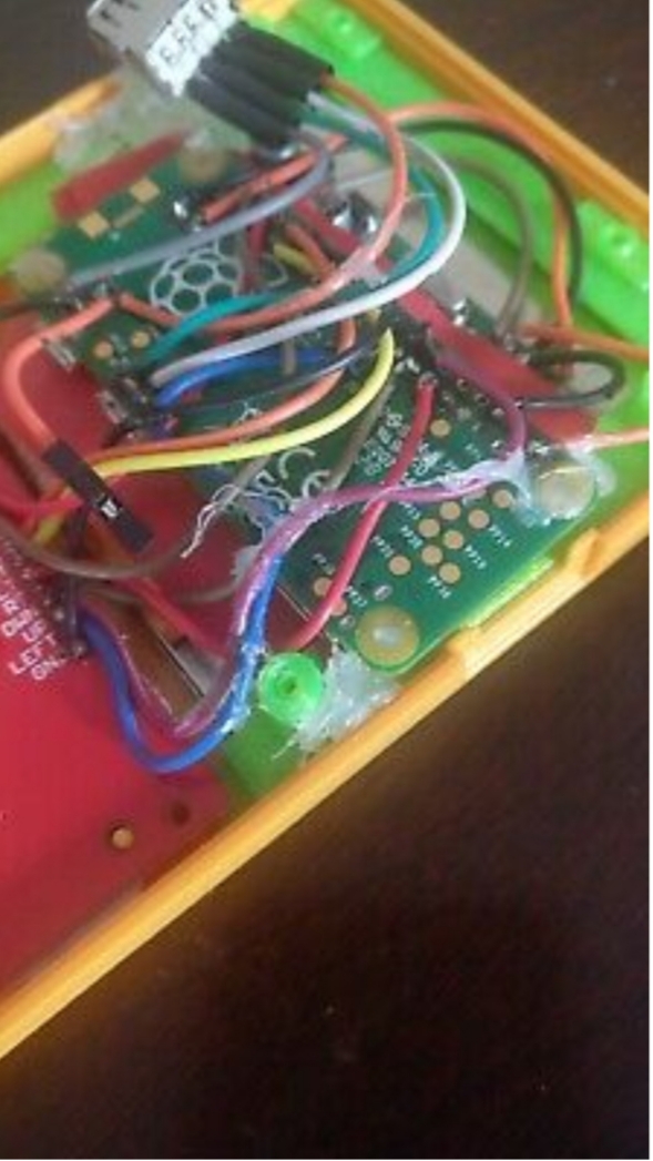

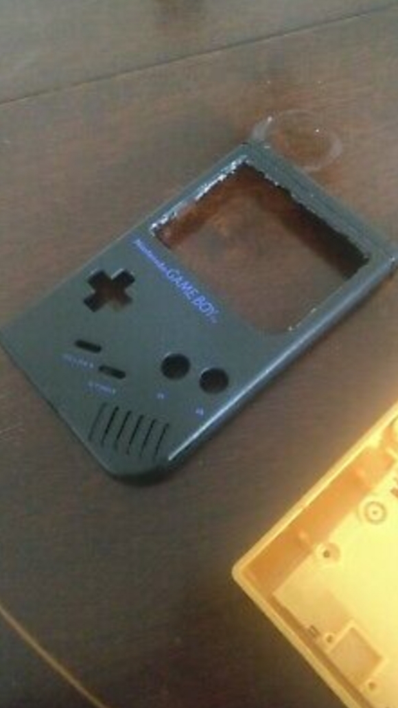

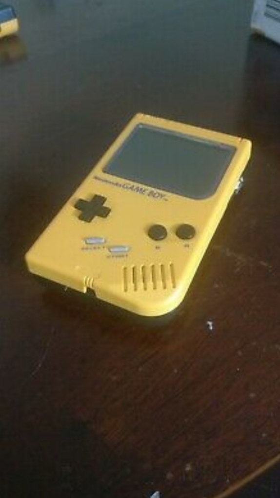

GBZ part built as I bought it
- 20190713_224534.jpg (698.24 KiB) Viewed 13887 times
- 20190713_224034.jpg (189.4 KiB) Viewed 13887 times
- 20190713_224054.jpg (285.62 KiB) Viewed 13887 times
- 20190713_224127.jpg (213.87 KiB) Viewed 13887 times
- 20190713_224203.jpg (247.14 KiB) Viewed 13887 times
- 20190713_224224.jpg (184.98 KiB) Viewed 13887 times
- 20190713_224247.jpg (287.05 KiB) Viewed 13887 times
- 20190713_224309.jpg (202.46 KiB) Viewed 13887 times
- 20190713_224330.jpg (307.95 KiB) Viewed 13887 times

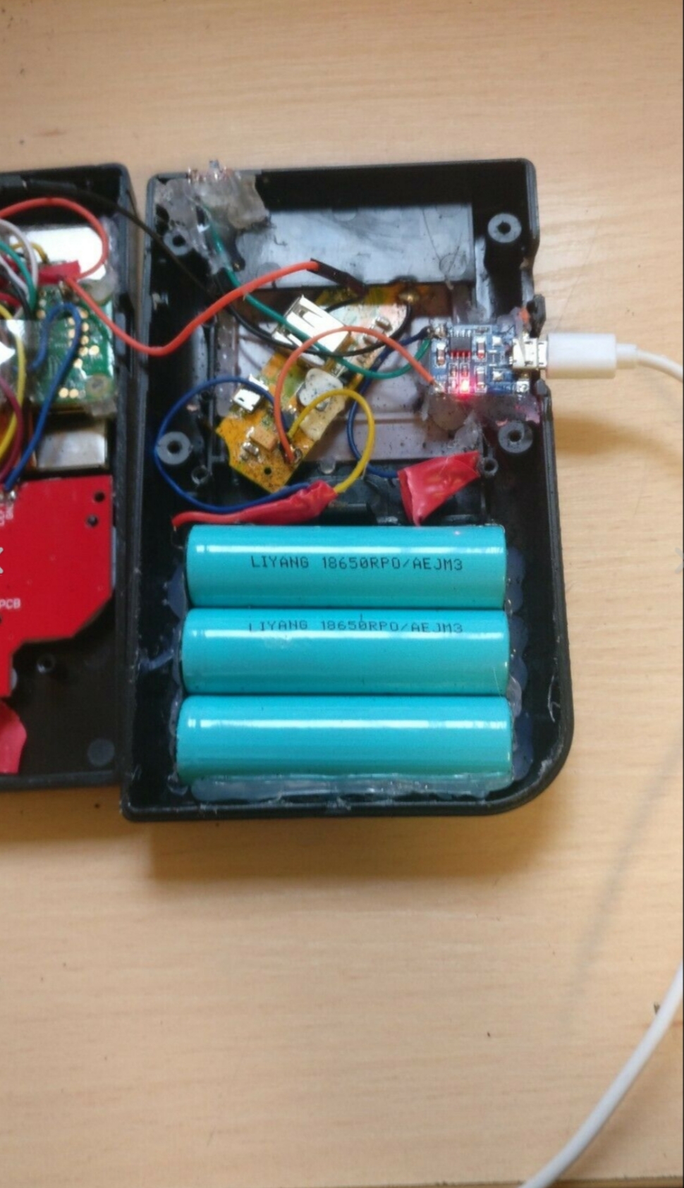

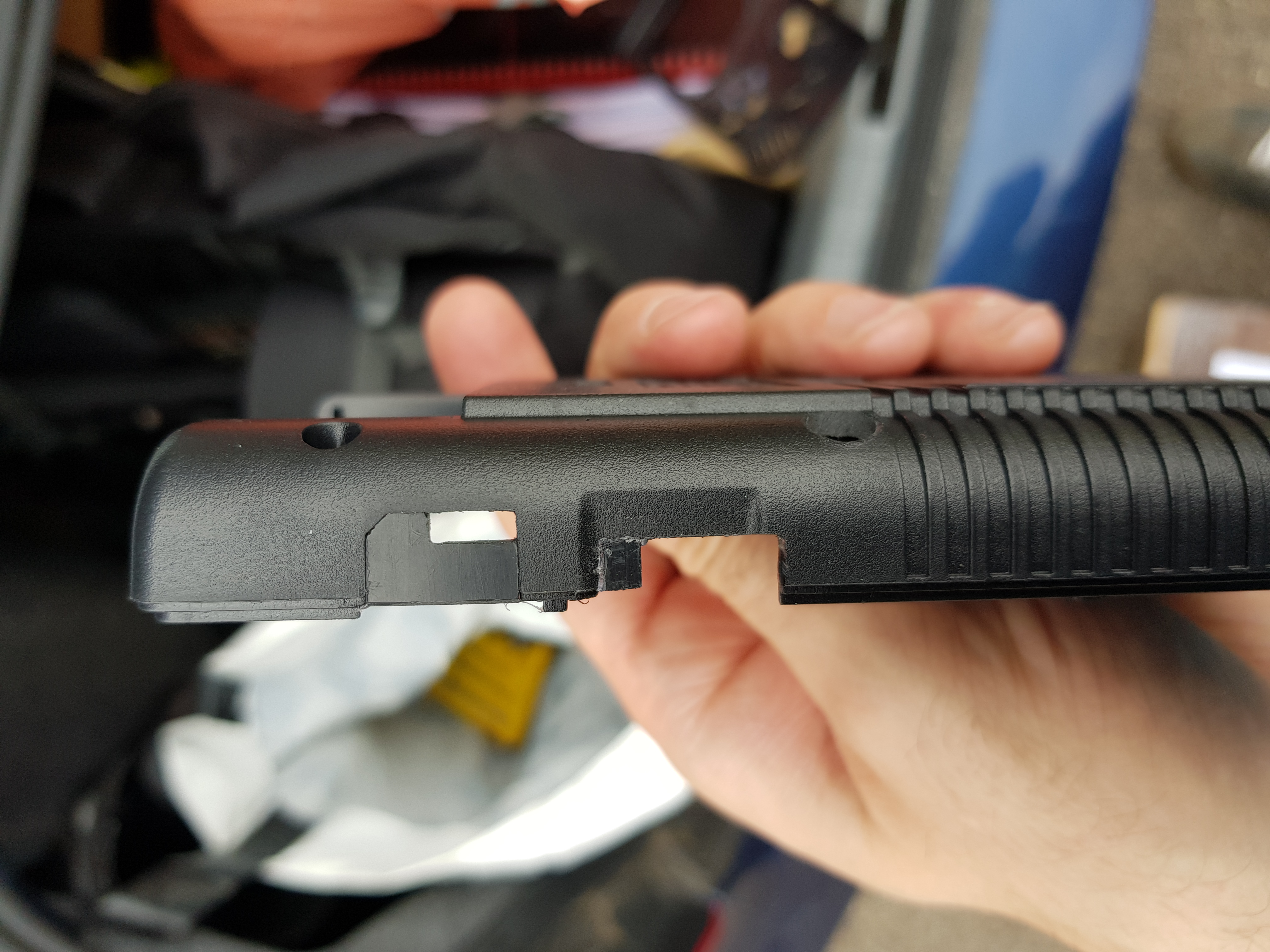

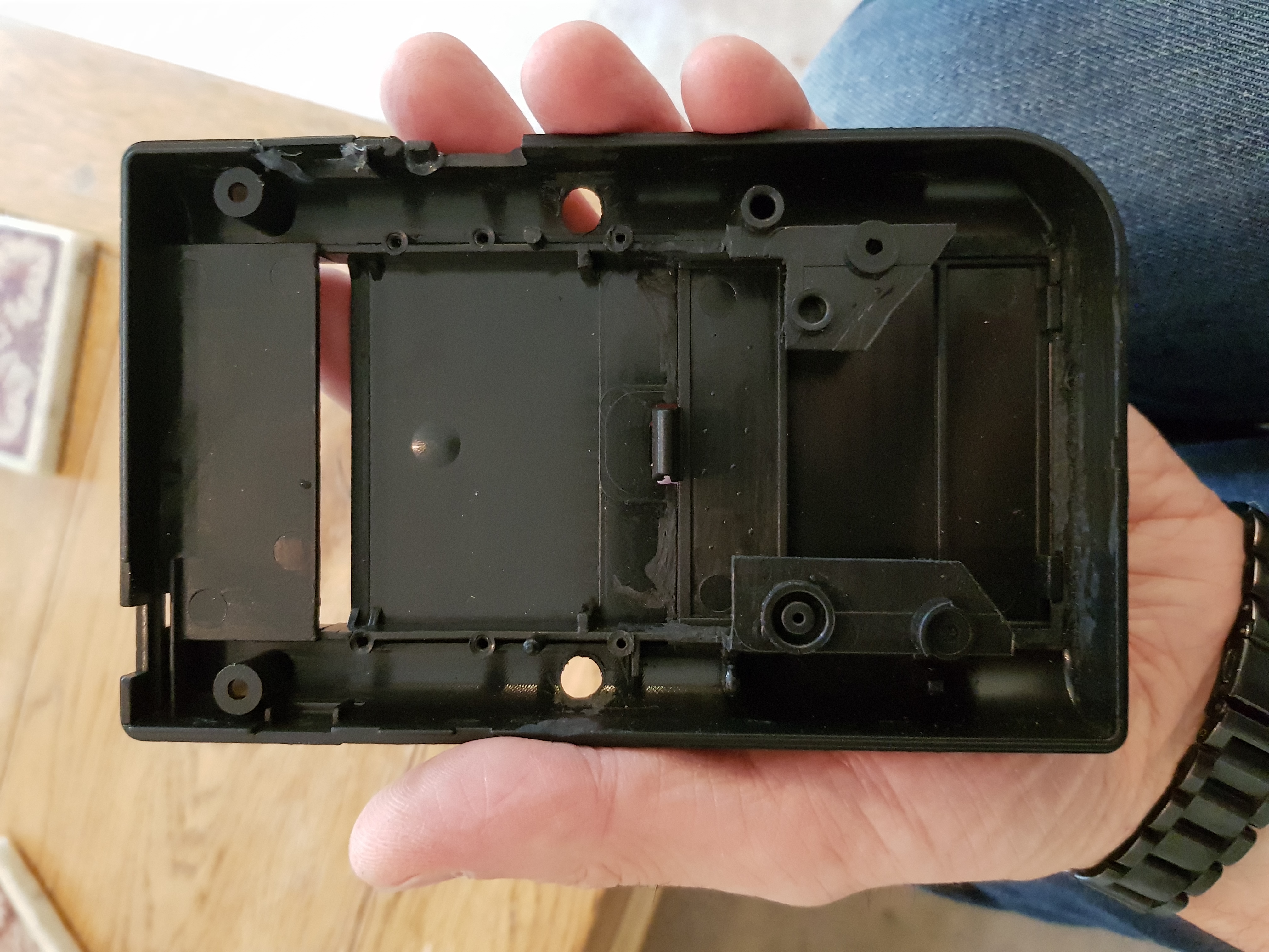

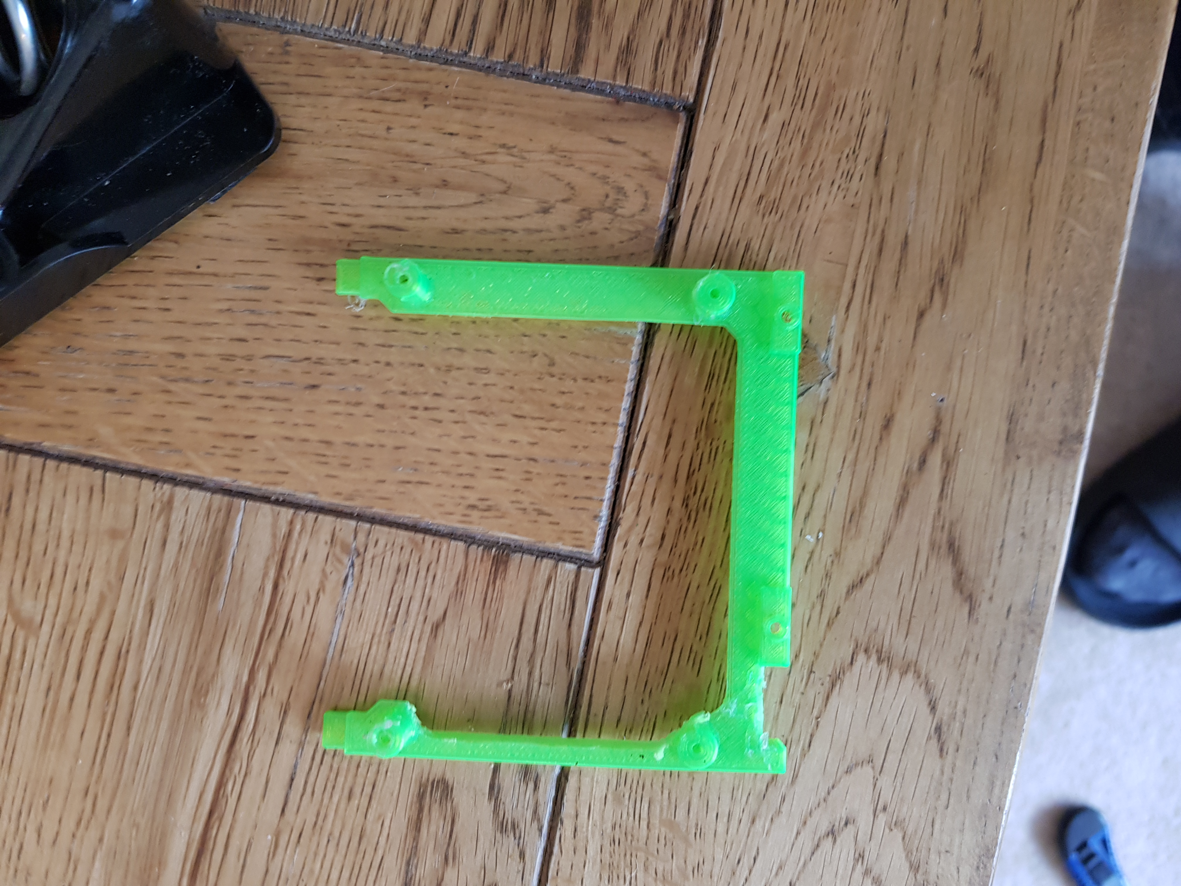

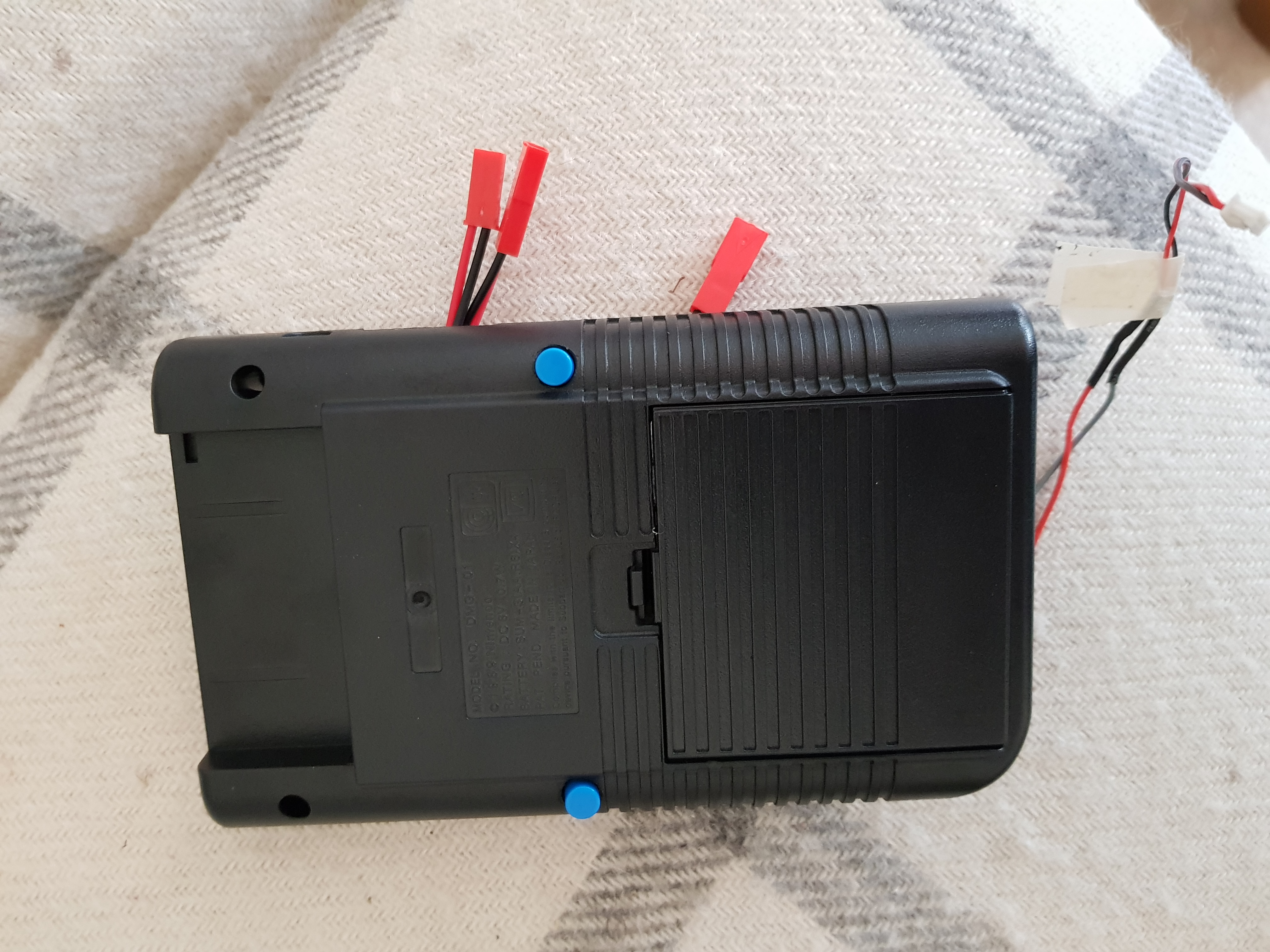

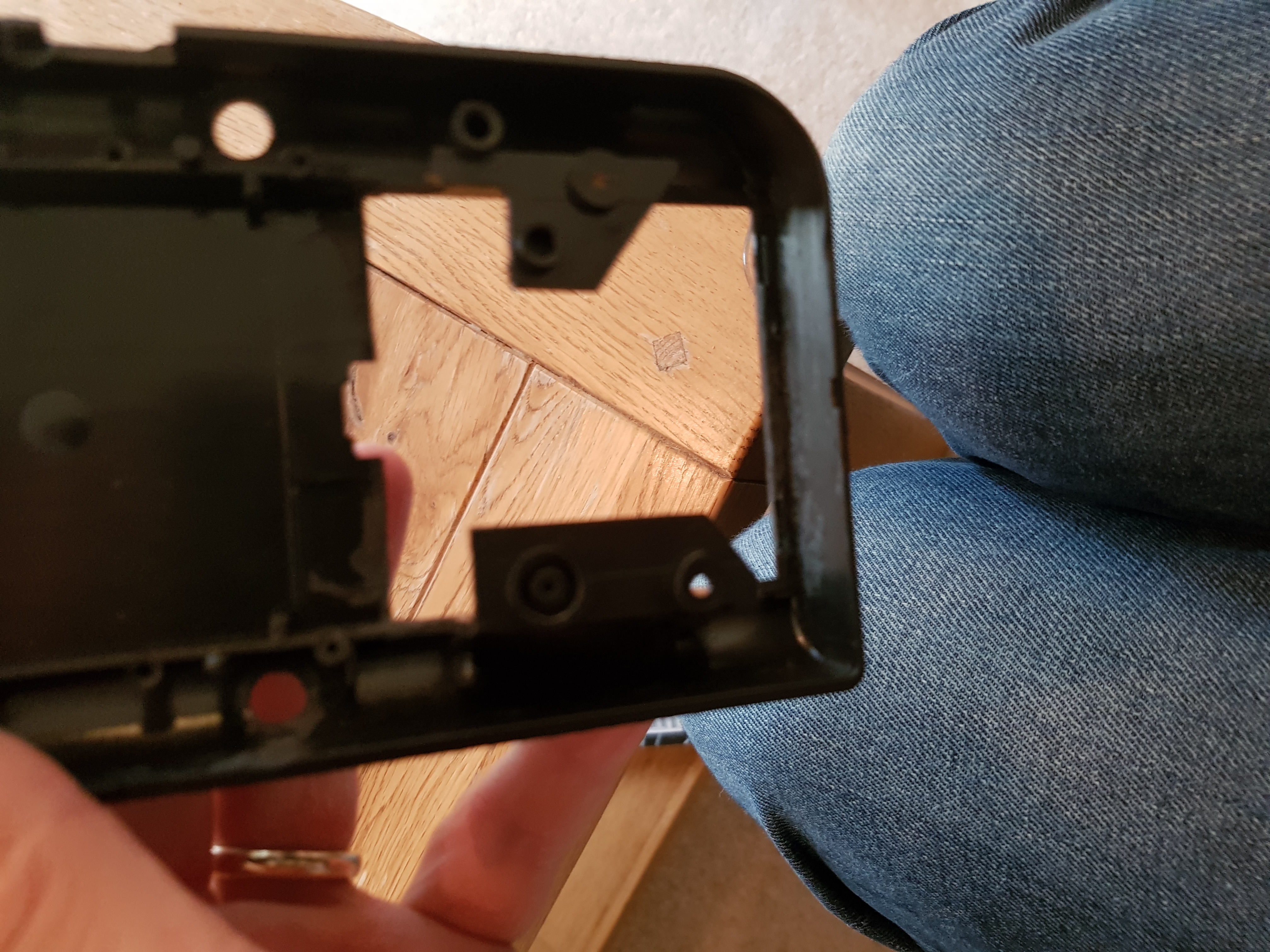

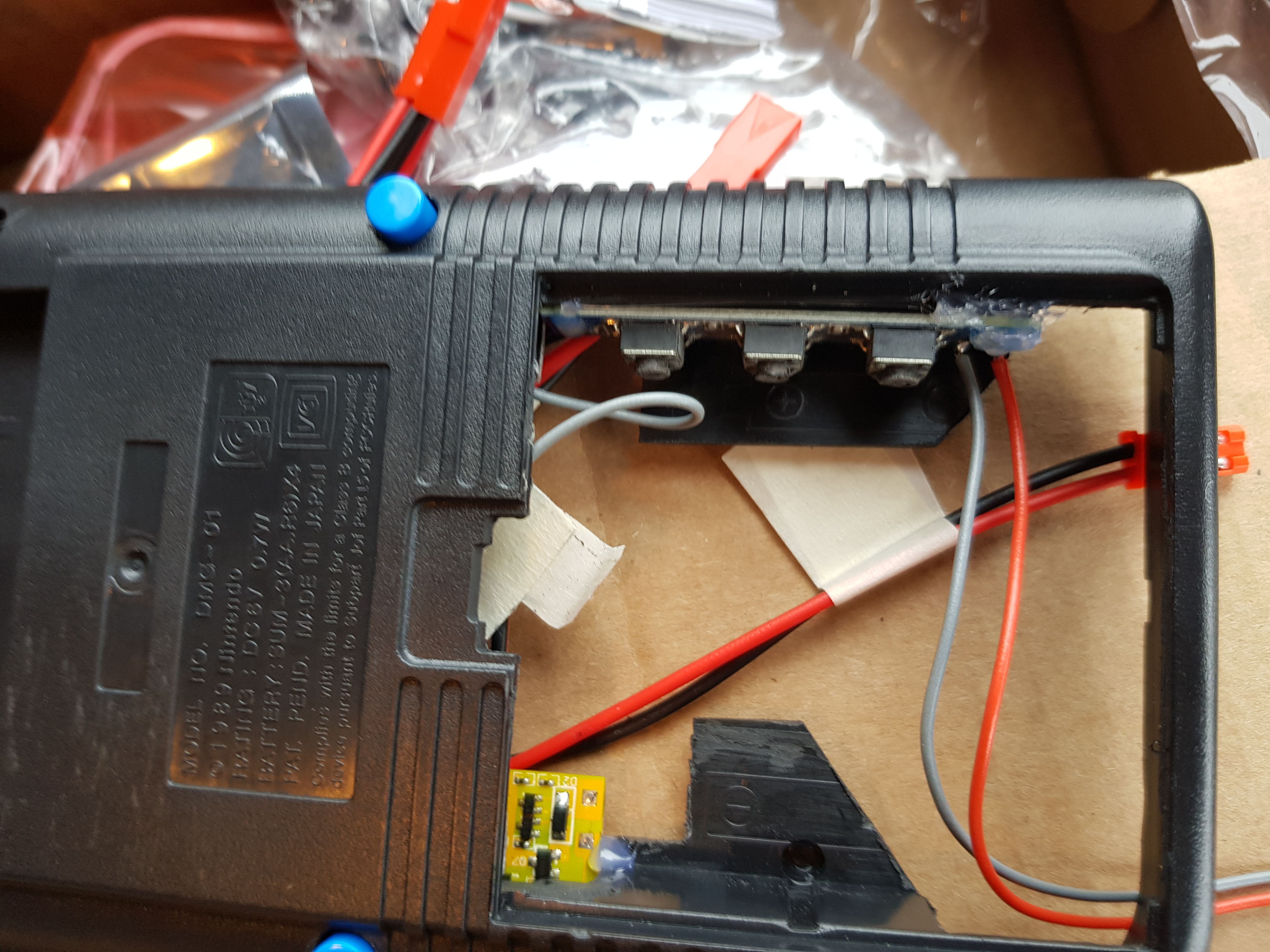

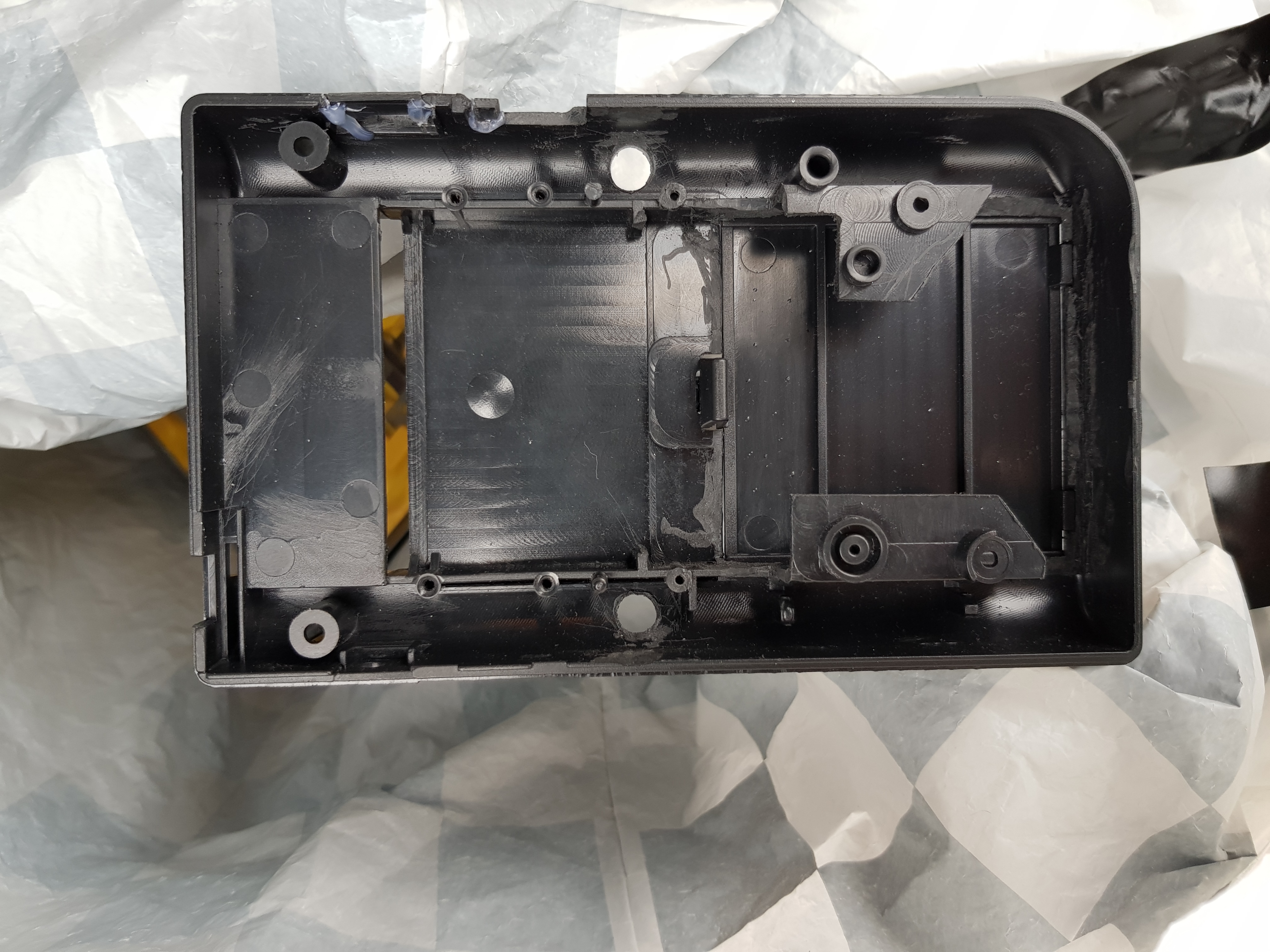

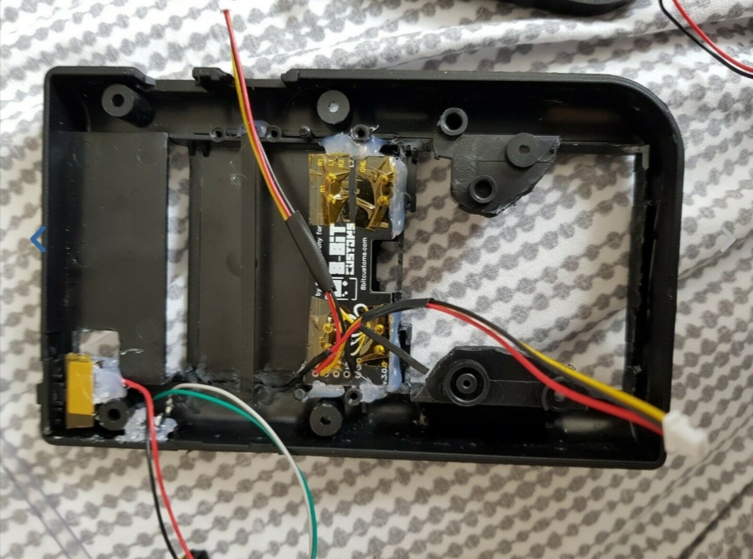

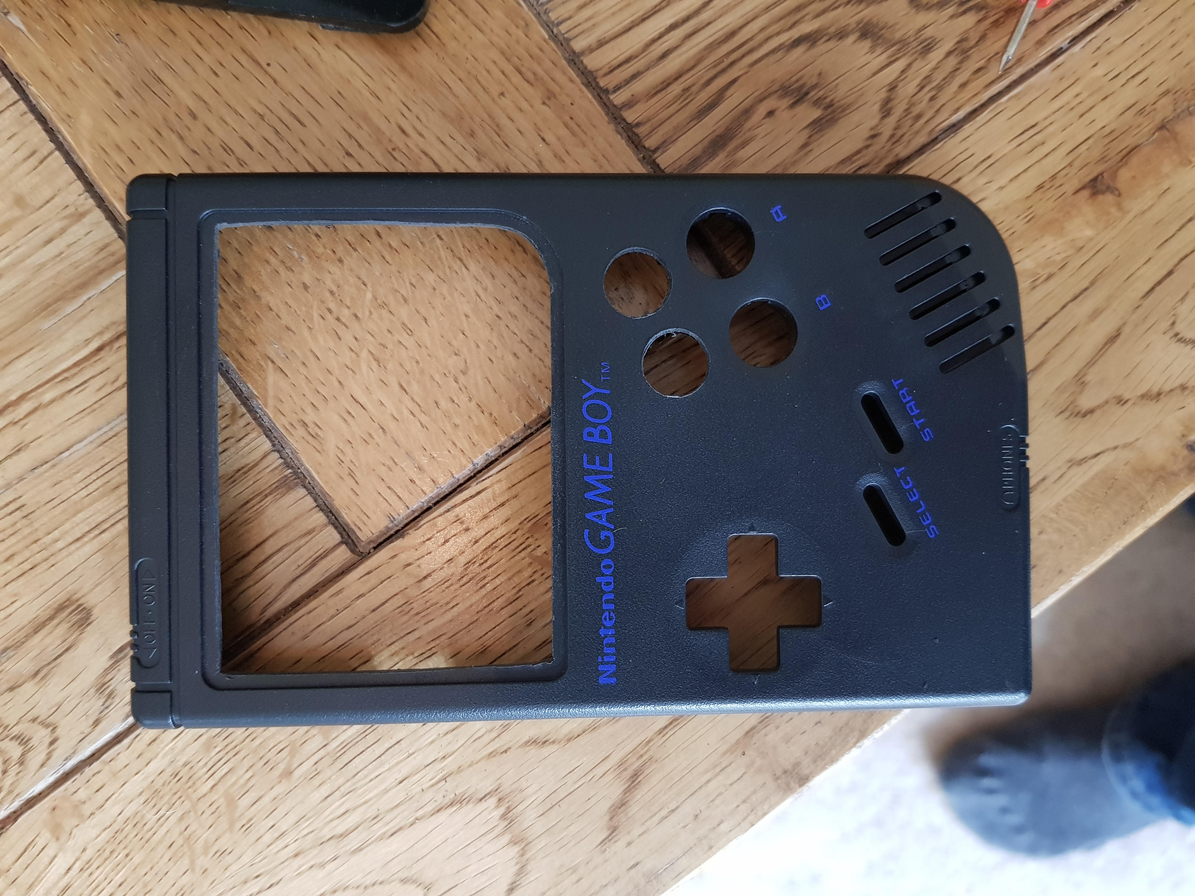

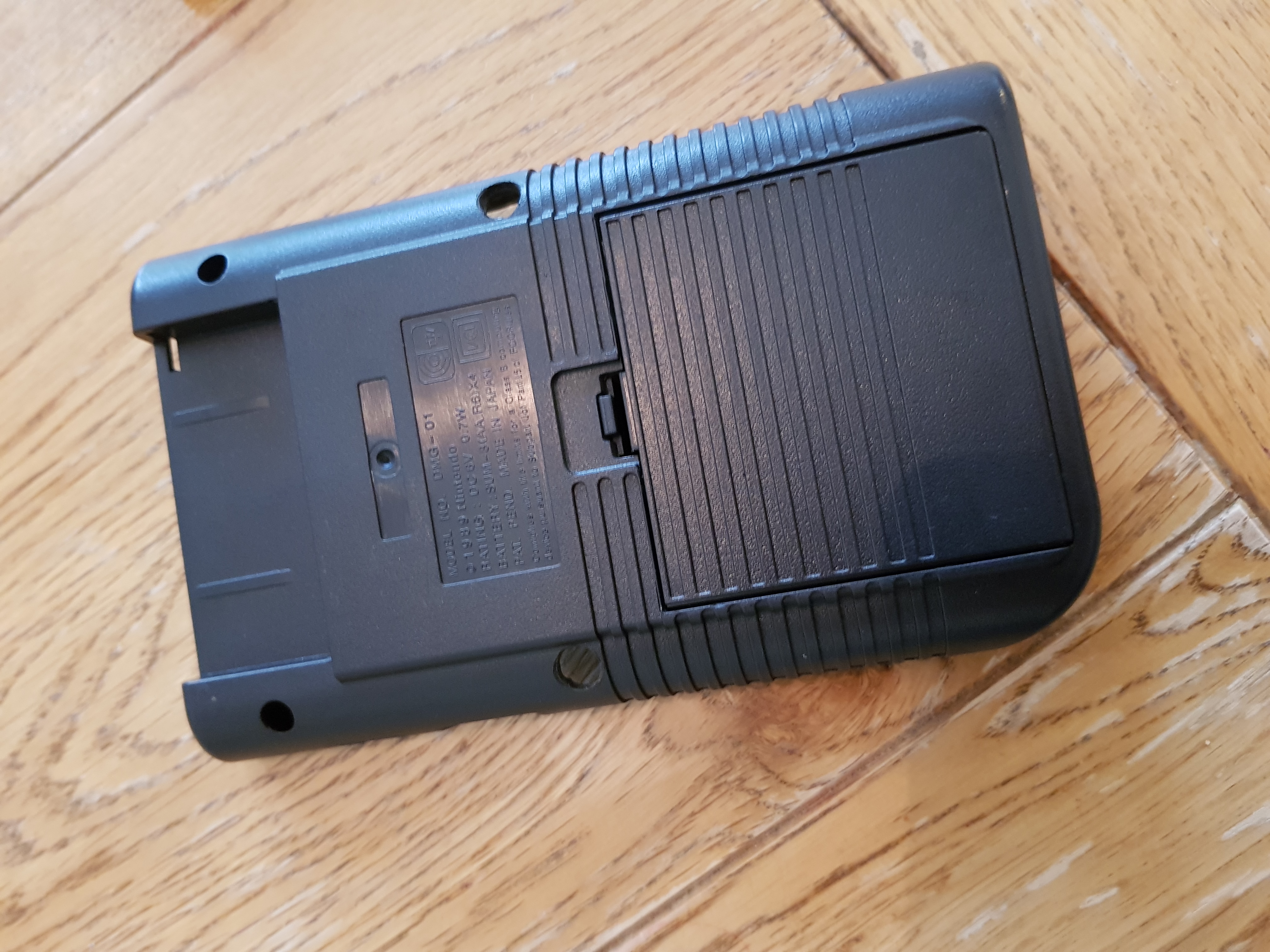

Case mods I've done to cut away the battery compartment, for the L and R back buttons and for the USB and micro-USB cut outs
- 20190713_172404.jpg (3.22 MiB) Viewed 13887 times
- 20190713_172408.jpg (3.34 MiB) Viewed 13887 times

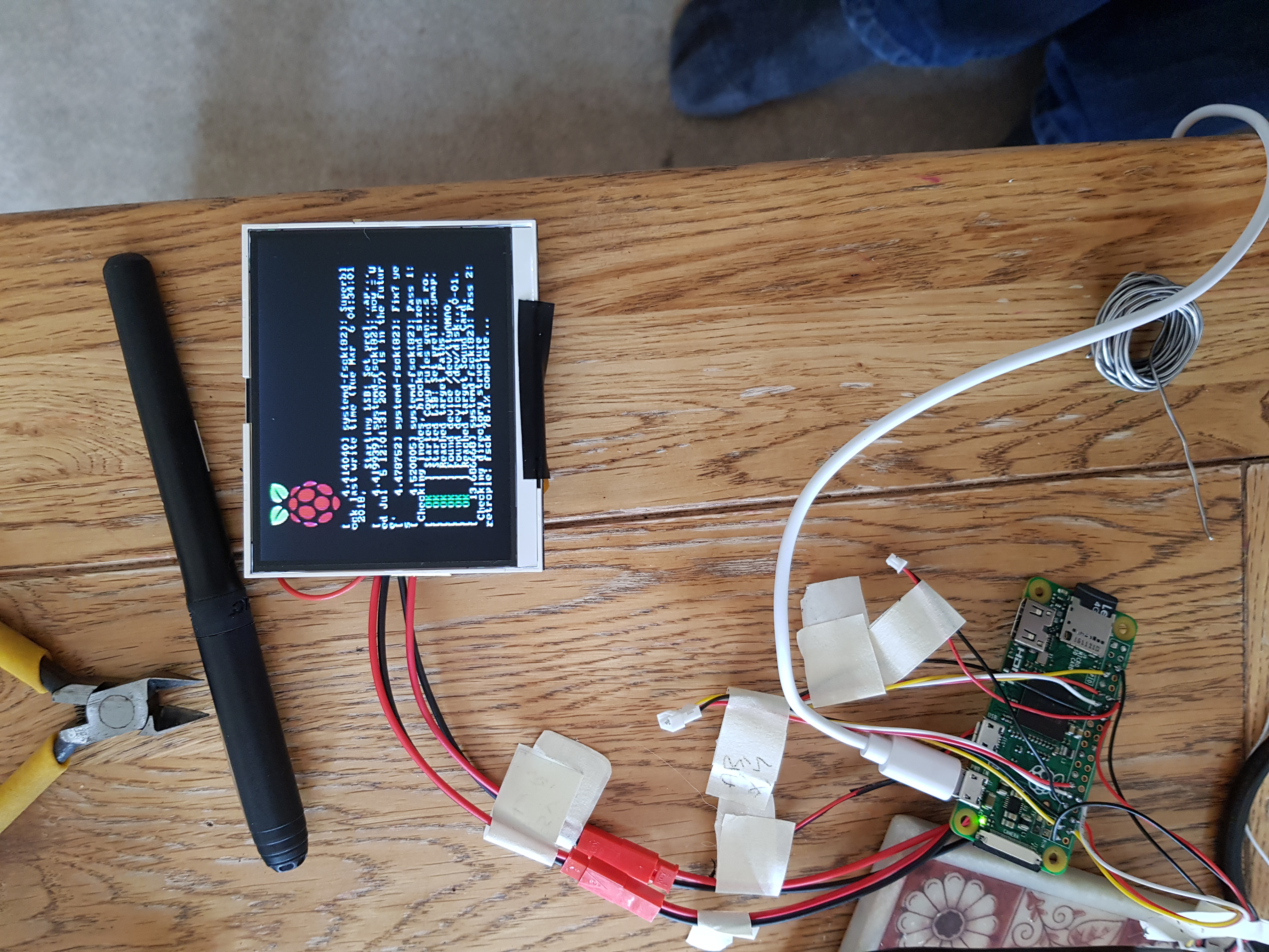

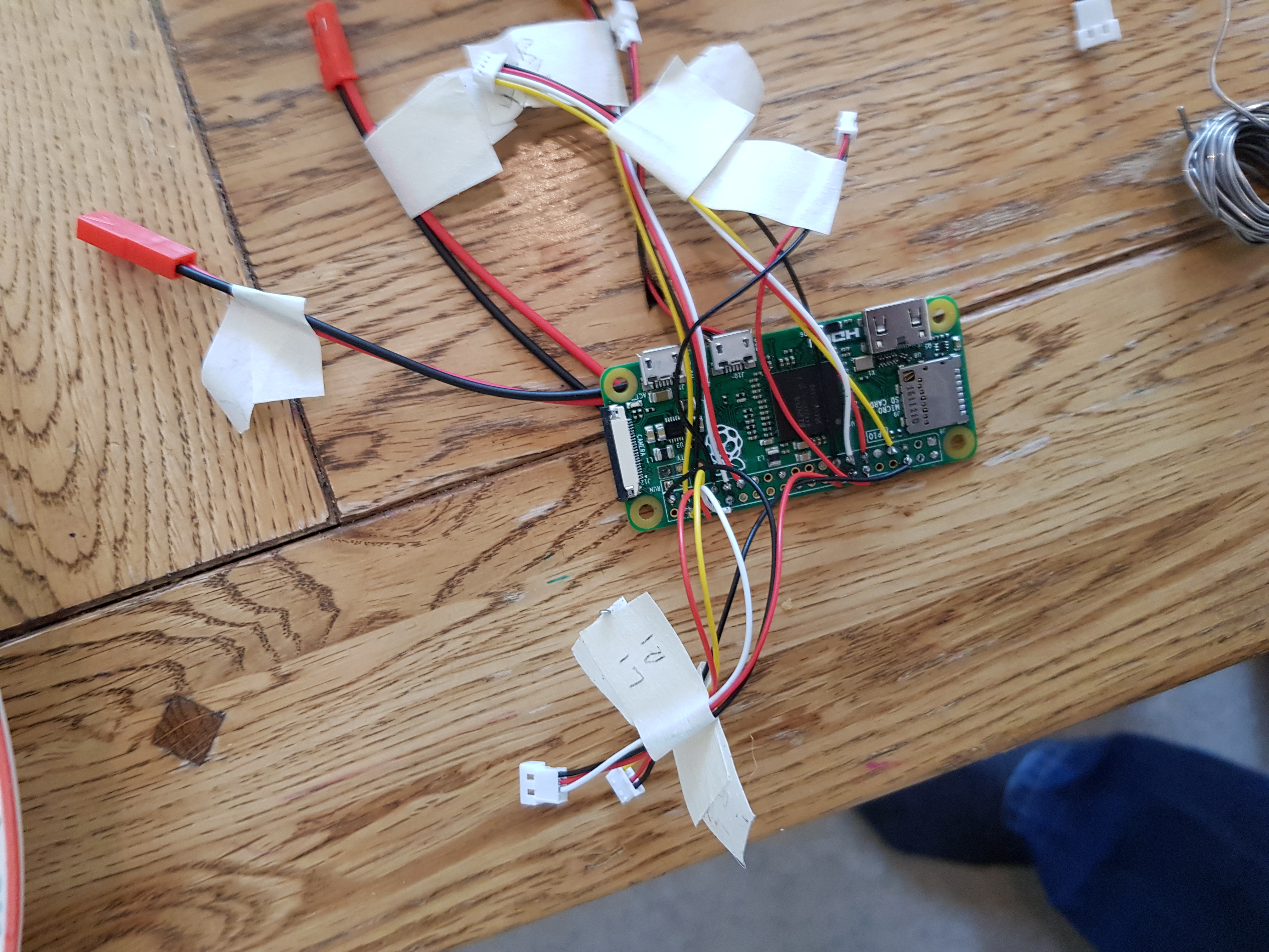

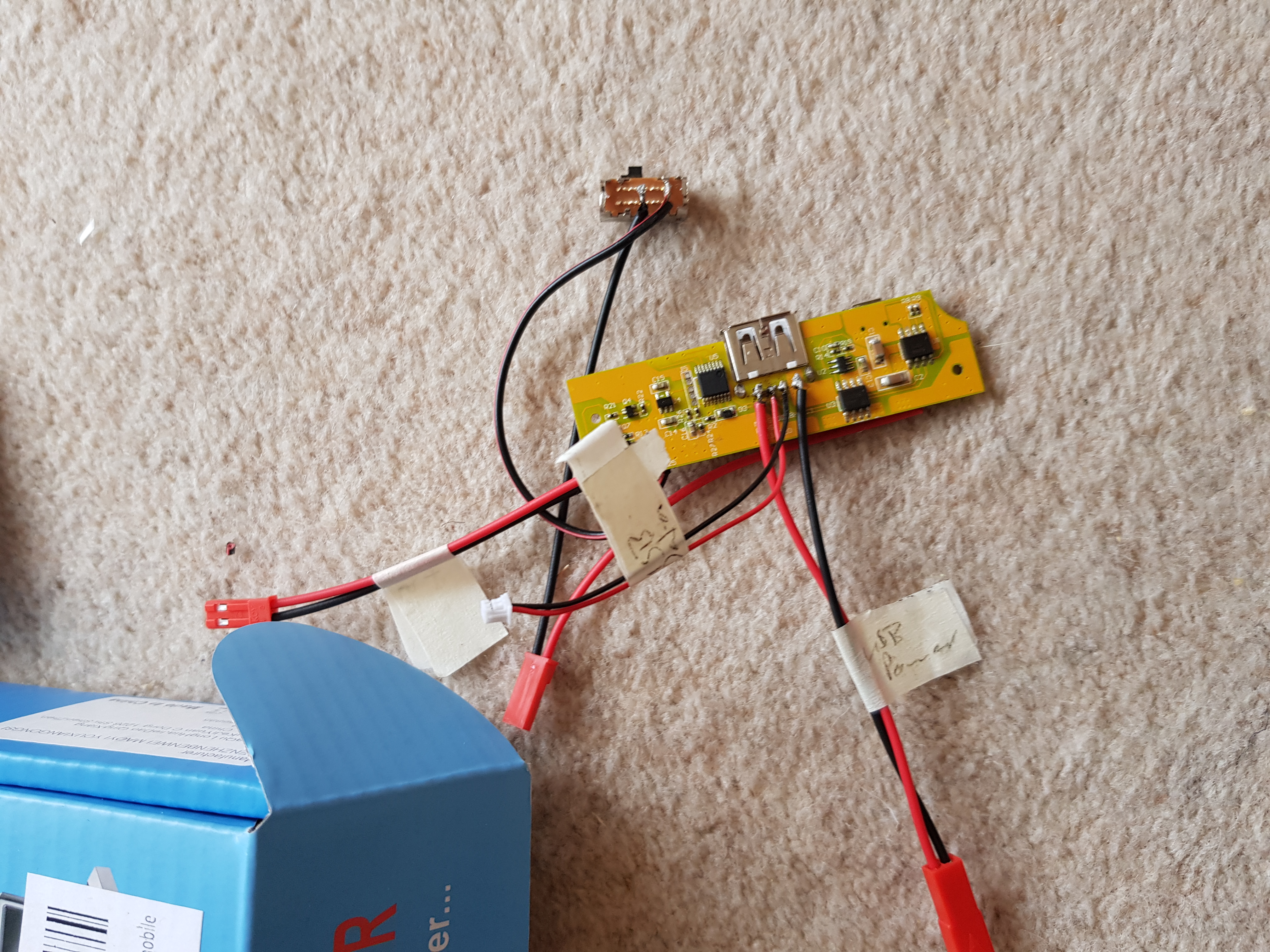

I got a lot done today.
I tested the Rpi Zero and screen and they both work.
I had previously tested the power supply / battery charging circuitry, so I already know that they work.

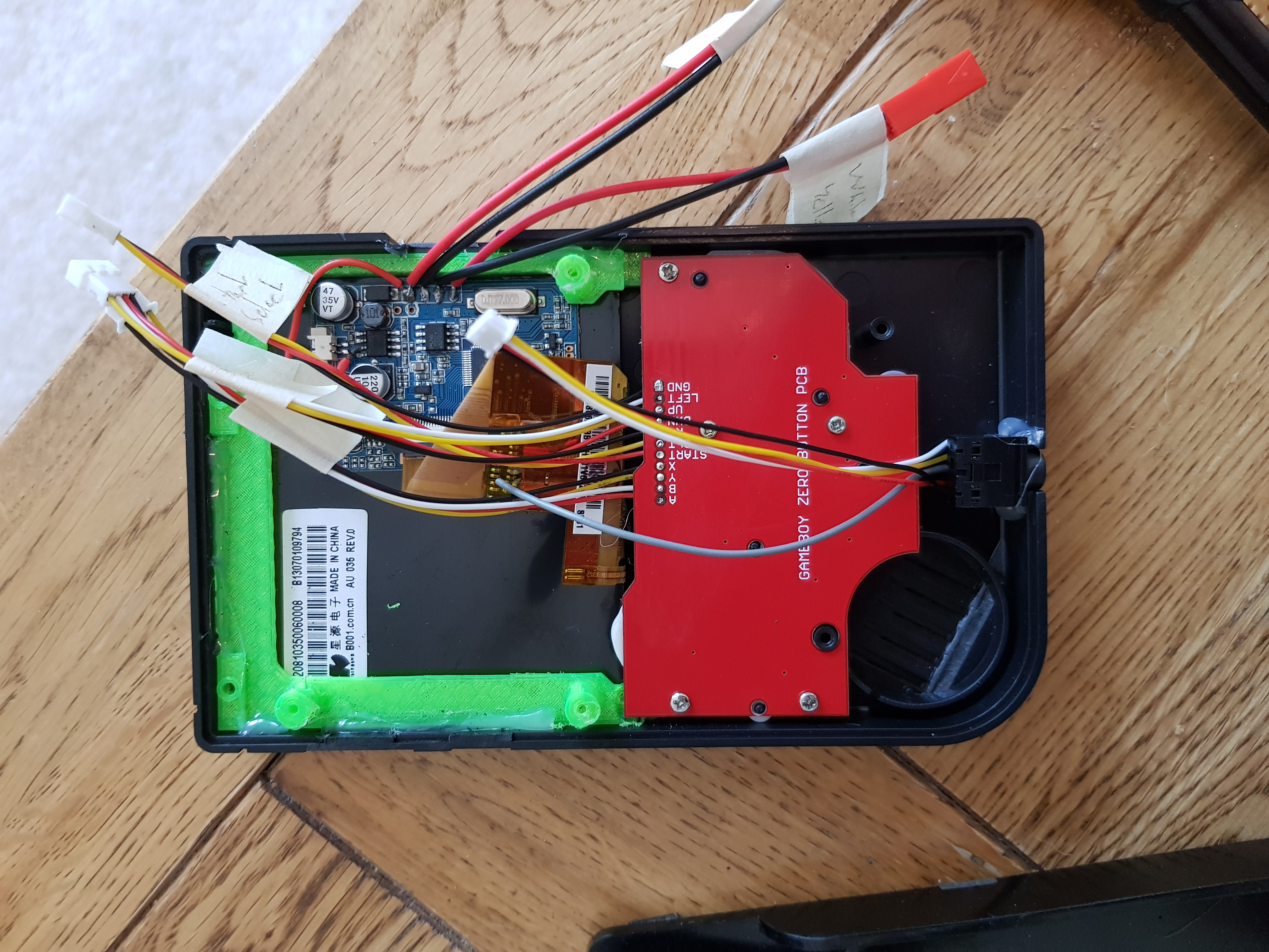

I installed the screen in the front case half after a bit of fettling to get the LCD mount to clear the screen control board (the board was very well bonded to the back of the LCD, so didn't want to risk causing damage by removing / moving it) and notching the bottom of the bracket to clear the button control board.
I installed the front buttons and control board.

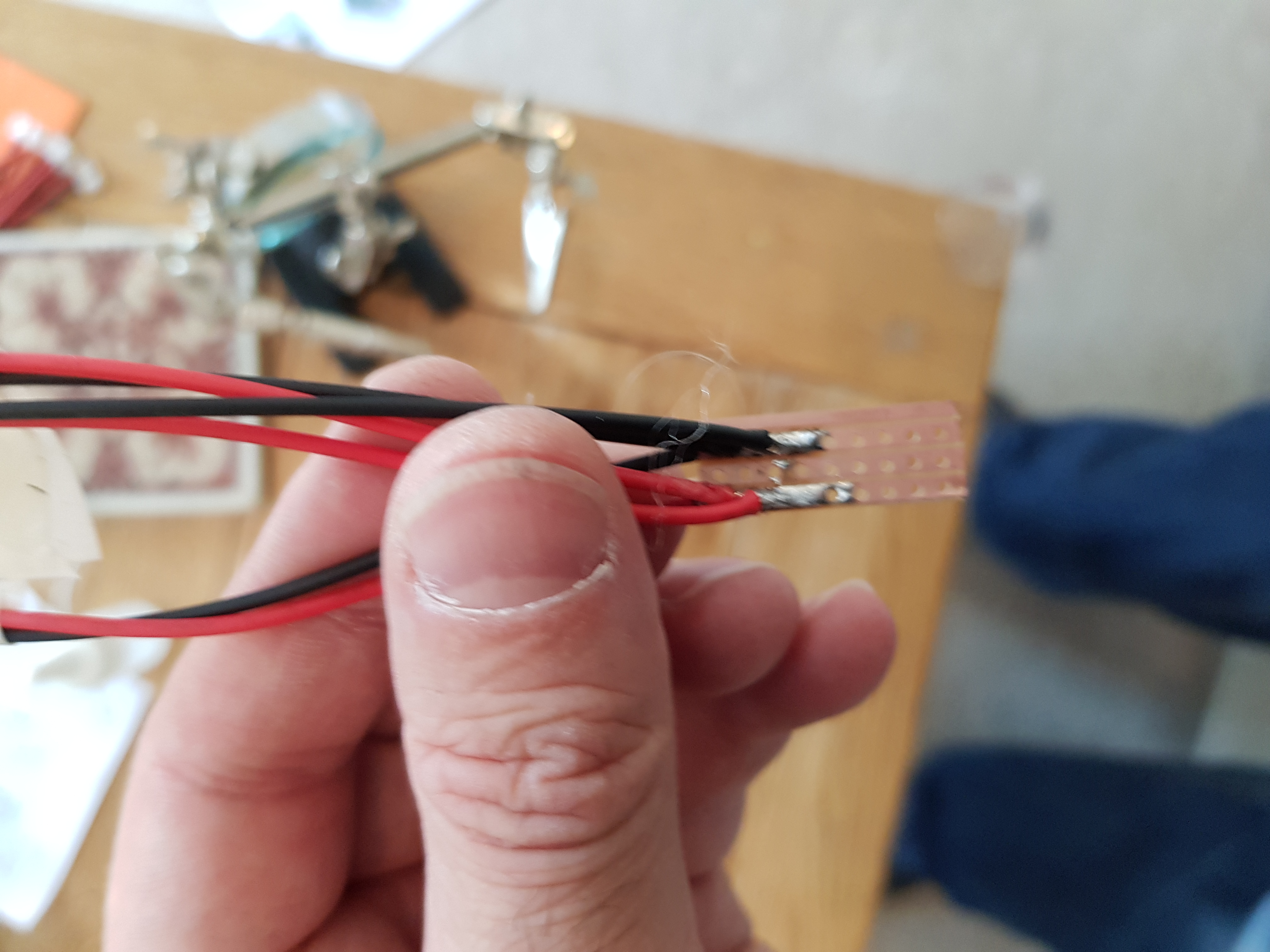

I simplified the power distribution by cutting out a bit of strip board to produce a gnd and +5v power rails. Everything except for the power switch, battery and battery charging module will be wired back to this using connectors. I'm using heavier gauge wire for all power cables.
I modified the USB A port on the power boost so that its directly wired into the gnd, +ve, d+ and d- (the latter two to the pi and the former to the power distribution board). I've checked previously that this port isn't wired into the board.

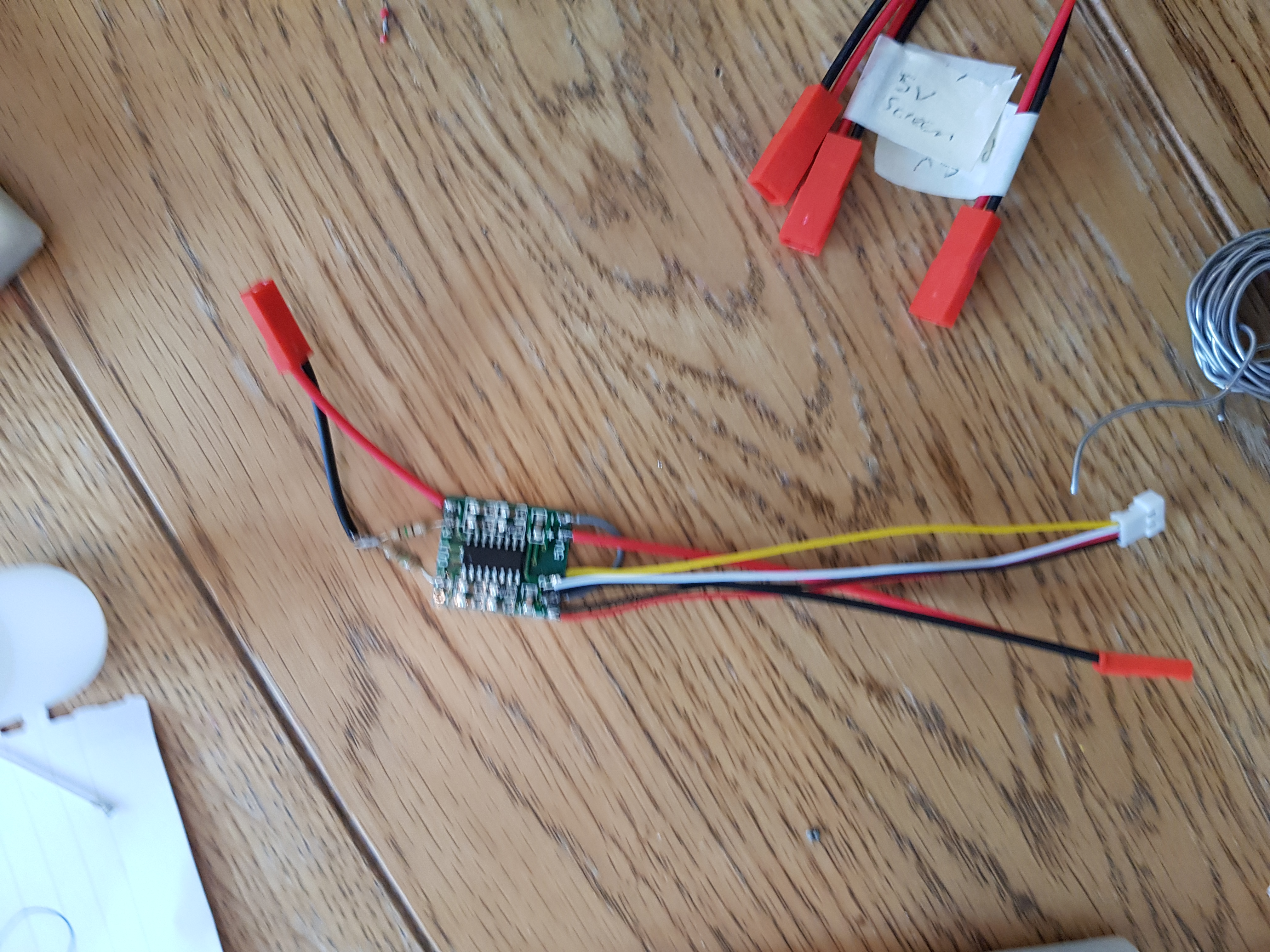

I installed the power boost, power switch and battery charging module. I also installed the L and R back buttons.

I also wired up most of the connections on the amp. Annoyingly I've mislaid the speaker so had to order another. The stereo pot hasn't turned up yet either.

- Power distribution strip board
- 20190719_143317.jpg (3.31 MiB) Viewed 13536 times
- Front of case - screen installed
- 20190719_140536.jpg (4.03 MiB) Viewed 13536 times
- Back of case and buttons
- 20190719_143346.jpg (3.48 MiB) Viewed 13536 times
- Wired Rpi Zero
- 20190719_143309.jpg (4.17 MiB) Viewed 13536 times
- Front case half assembled
- 20190719_143427.jpg (3.63 MiB) Viewed 13536 times
- Fettled LCD bracket
- 20190719_122325.jpg (3.91 MiB) Viewed 13536 times
- Screen and pi zero working
- 20190719_121351.jpg (4.57 MiB) Viewed 13536 times
- Modded case
- 20190719_121556.jpg (3.71 MiB) Viewed 13536 times
- Modded case
- 20190719_113912.jpg (3.97 MiB) Viewed 13536 times
- Modded case
- 20190719_113858.jpg (3.22 MiB) Viewed 13536 times
- Modded case
- 20190719_113903.jpg (3.29 MiB) Viewed 13536 times

- Wired power boost
- 20190719_132004.jpg (4.48 MiB) Viewed 13531 times
- Wired amp
- 20190719_143311.jpg (4.01 MiB) Viewed 13531 times

- Inside of back case half
- 20190719_164352.jpg (3.46 MiB) Viewed 13531 times
- 20190719_164400.jpg (3.6 MiB) Viewed 13531 times

Well, what a frustrating day!
Managed to wire up the audio circuit with the amp, stereo pot and speaker no problems.
Scratching my head with the safe shutdown pcb though and battery monitor pcb.
Ordered both from Galaxy Gaming (I'm in the UK).
https://galaxygaming.co.uk/shop/gameboy ... y-monitor/

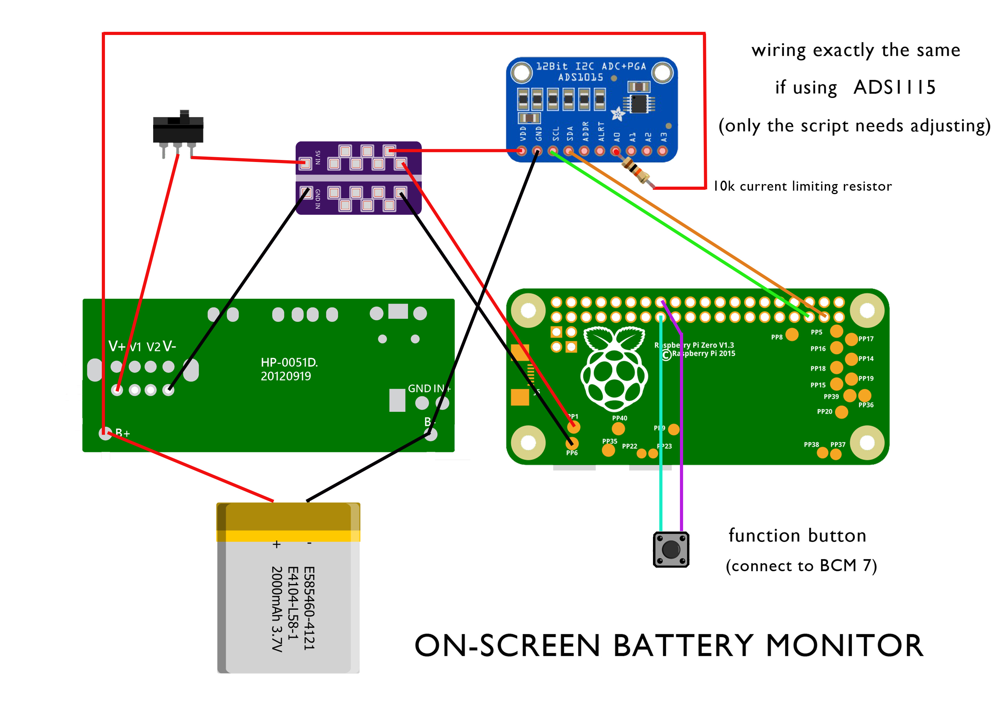

The new 2.1A power boost had also arrived from HK too so I wired that in bypassing the old power boost. Just using the USB A port on that now.
I think the power circuit is working although there was no wiring diagram on Galaxy Gaming's website for the safe shutdown pcb and had to do a bit of digging as it was non-branded (there were no identifying marks at all on the pcb).
It appears to be a Polulu pcb knock-off with the sliding switch removed.
https://www.pololu.com/picture/view/0J6541
I used this and modified the below wiring diagram (very useful- thank you to whoever produced it
Any way, wired it all up tested it and it is producing 5.2v and 3.7v where it should be.
The big frustration was that the rpi would power up and using the micro-hdmi port with the TV, booted up correctly. No signal on the GBZ LCD screen though.
Checked for shorts / continuity and nada. Tested the signal and power cabling to the LCD controller and got a voltage for both so that's ok.
Swapped out with a spare LCD controller board from the first screen which broke and still nothing.
I then spotted a minor nick in the ribbon cable so that must be it (with a gentle twist the cable split halfway!). I think it was because the ribbon cable was bent to form a 90 degree angle so that it entered the controller board which put stress on the cable at the bend.
I've ordered a new LCD (minus the controller - I've got two already and one of them is bound to work, fingers-crossed).
Also just realised how tight a fit it is for an rpi 3A+. With so much cabling in there (needs to be slimmed down and better routed / managed) there's not much space for an RPI zero, never mind a 3A+.

- Another LCD screen bites the dust!!
- 20190731_174848.jpg (3.72 MiB) Viewed 13359 times
