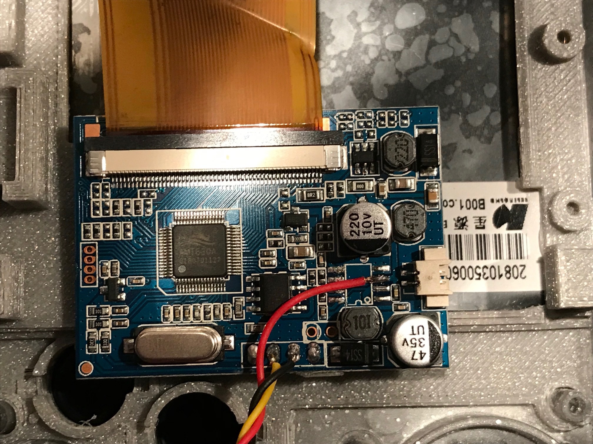

So I used the backup camera screen that Wermy mentioned in his Custom Parts video. As he warned, the screen I got had a different board confirguation to it then the one he demonstrated with. I spent some time looking through the forums on here to see if I could find the informaiton I needed... but as I hinted at before, I have basically 0 electronics knowledge and was really just kind of hoping that I would know what I was looking for if I found it. Which... yeah. An hour or so of searching with that mind-set... not a great expecation of results.
so I hijacked a thread where someone else asked for help but didn't actually post any information or pictures of their board or anything. VeternGamer was good enough to point me at the exact information I needed in regards to the screen mods.
Aaaaand I think this is where the monkey screwed up.
I made the mods the article laid out,
and used Wermy's guide to connect the wires to the Pi Zero W...
and I get nothing from the Pi. I plug it in with a noobs card in the slot.
As far as I can tell, I tried the Raspberry pi Zero W somewhere along the line. I'm hoping that's not the case... but yeah. Not looking good in this regard.

first: you have connected the yellow wire to a ground input on the pi - disconnect that. the white wire (av2) is connected to the correct spot. you can just leave the yellow one disconnected. (you probably want to shorten up the wire too - looks like it's going to bridge some of those other pins)
second (if the above alone doesn't fix it): you may have to clip off that chip where you bridged the 5v to, completely, and then just run the power to that pin there.
also, when testing, you can use hdmi to make sure the pi is booting up ok, and that its just the screen that's the issue and not your os

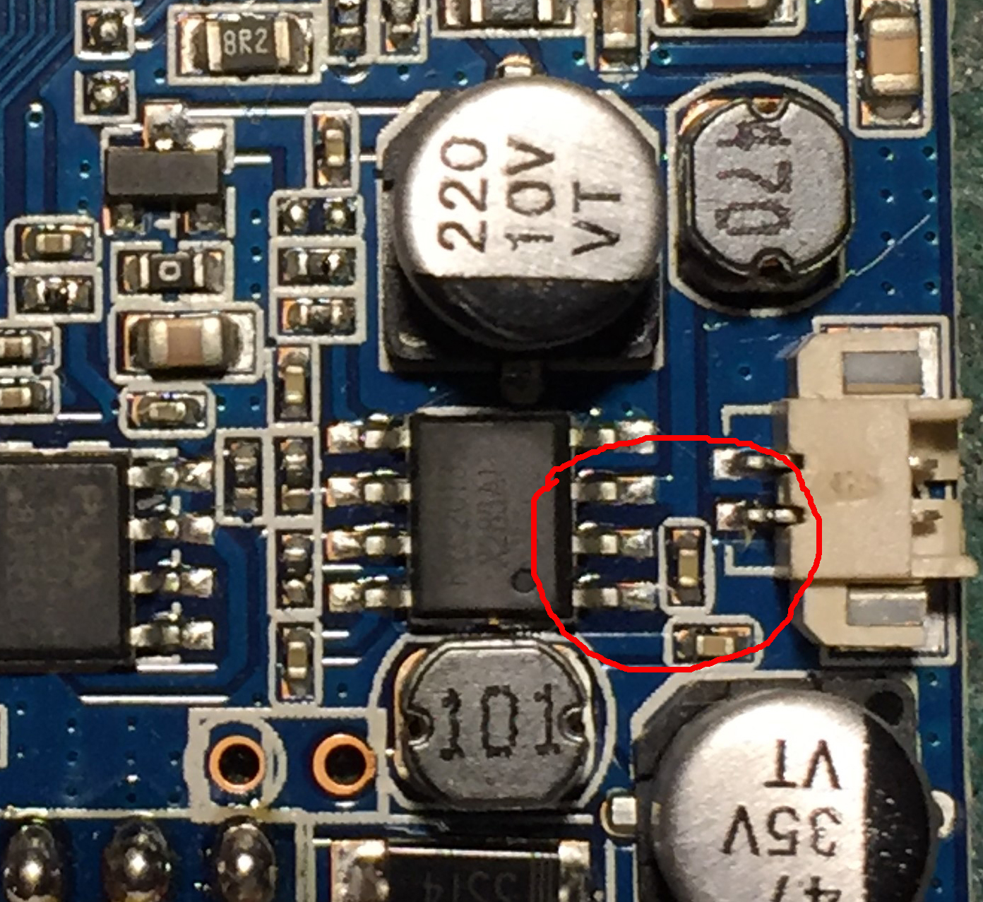

Went to remove the IC where I bridged the 5v line to... and I was greeted by a very interesting surprise:
the chip, and the bridge I put on, is gone.
So... wtf and wtf (what and when)?
It looks like I tore the chip off at some point. I would think I would have noticed something like that. But yeah. No clue when that happened.
On the plus side, the Pi Zero W works now.
so I guess this attempt is a wash. I've ordered a new screen.
Any chance I can bridge the connection on the board with what's left? Or did the etching get torn out too like I'm guessing from the look of it?

maybe.. if you can find where that pin was, and scrape it to expose some of the copper trace, you can solder just to that...

So I tried doing that, used an exacto knife with a type 11 blade to the spot. The feeling I'm getting from the blade, I don't think I'm scratching at anything other then perf board. I don't think there is anything there where the bridge was.

try more just outside/above that area, like where the pin was connecting to, under the blue part. it's likely there's nothing left in that rectangle area where the pad was. but, there might be something left under that blue area, if it didn't pull out of there too

you don't need to scratch anything....
you might end up making things even more worst....
that point of the IC (the track) also goes to the capacitor nearest to it.....
try making the connection there.....
(go easy and try not to dislodge the capacitor as well)

Well, I think I can stick a fork in this screen as I'm pretty sure it's done. I ran a new bridge from the 12v line to the capacitor. Since I was using really thin wire on this, I encased it in some hot glue to insulate it from anything else.
Got it all wired up, and hooked up and...
a whole lot of nothing on that screen. HDMI works just fine. Tested that, no problem. I tried flipping the ribbon cable over thinking maybe I had in upside down, no change. I tried reconnecting the adjustment controls thinking their absence may cause a fault or something. No change.
So yeah, I'm thinking I either killed the screen at some point or it was dead on arrival.

i had one of these screens laying around here, so i just gave it a try on this new build. if you end up with another one, this is what worked for me - clipped the chip off with a flush cutter, desoldered the white wire, and then moved the red up to where the second leg was attached... worked right away...
