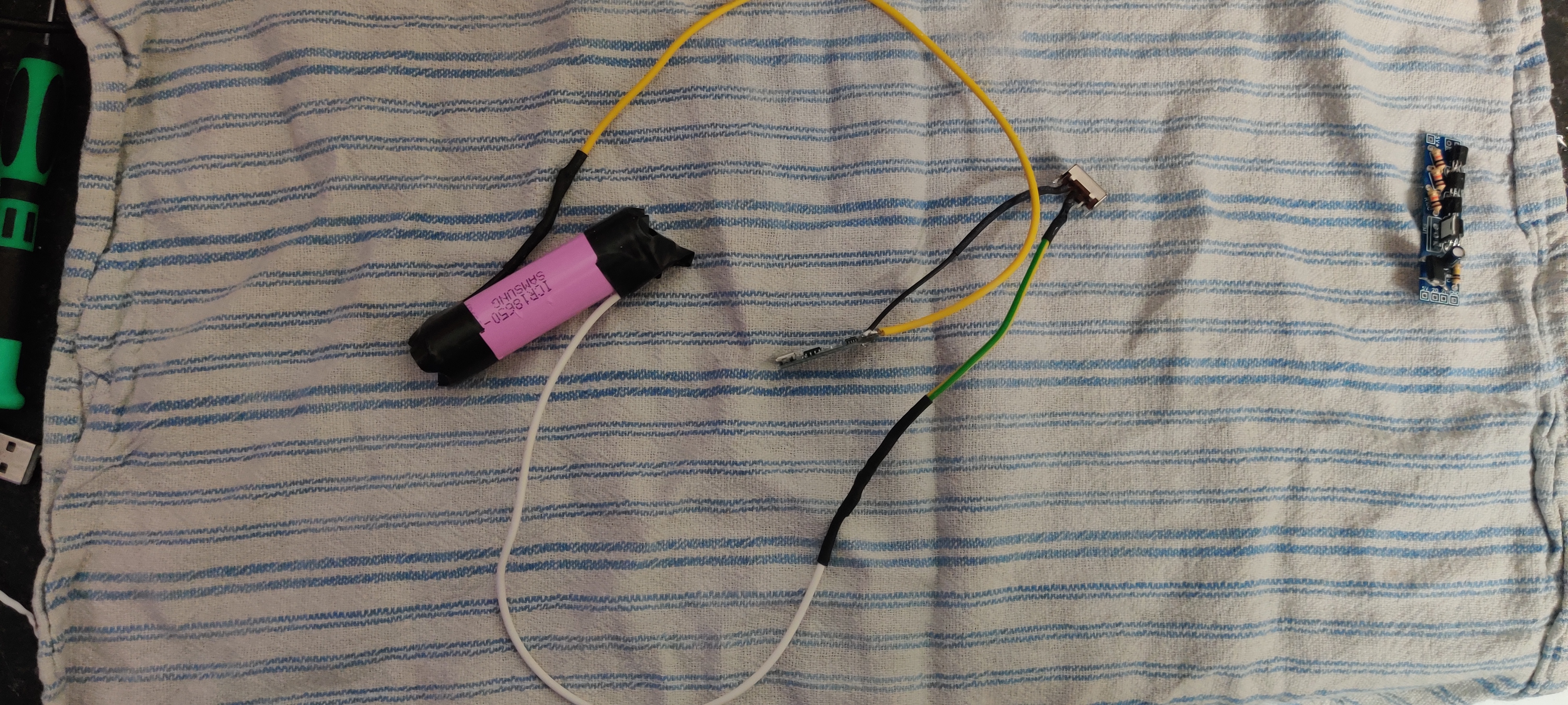

1. The Power
For the power I've recycled a laptop battery which utilises 18650 batteries at 2.6Ah each. So 1 of these and the TP4056 Chip to charge and boost to 5v makes my main power system, but I've added a switch on the battery input to the board to help conserve power.
What about the AC input?
Well unlike many on the forums and YouTube I am opting to use a DC barrel jack as the mains input from a USB to barrel cable to pass 5v 1A power to the charging unit.

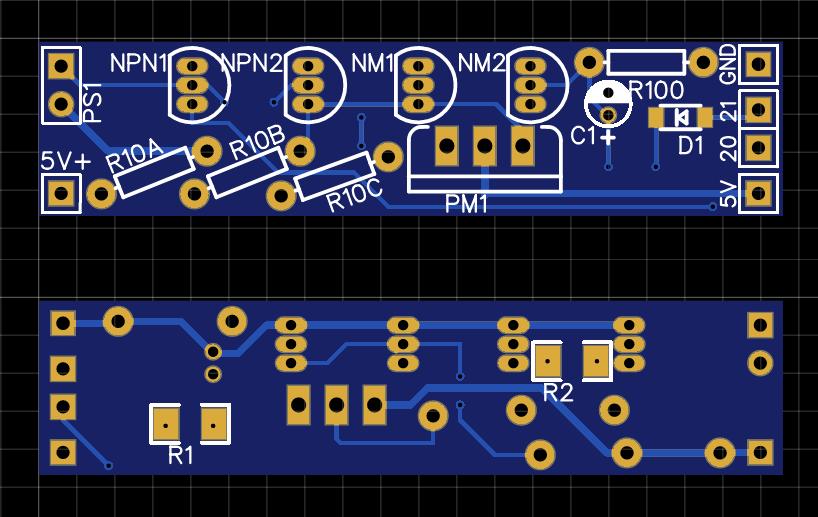

Now I've seen the boards on the market place, but as I am an absolute novice at soldering, I had thought I'd try to design and produce my own prototyping boards following a guy on YouTube and his schematic.
YouTuber: Kevin Farrah
Link: [youtube]https://youtu.be/pAVGv7mzmZY[/youtube]
So from this I designed my board which again is using a button/switch from a old vTech InnoTab Max as I wanted to have a PSP style power switch.
Behold my PCB design.
SafeShutdown_PCB
Now as you can see there are 2 pins marked 20 & 21 which will connect to the GPIO pins 20 & 21. The 5V out will go to a power strip and to the pi.
