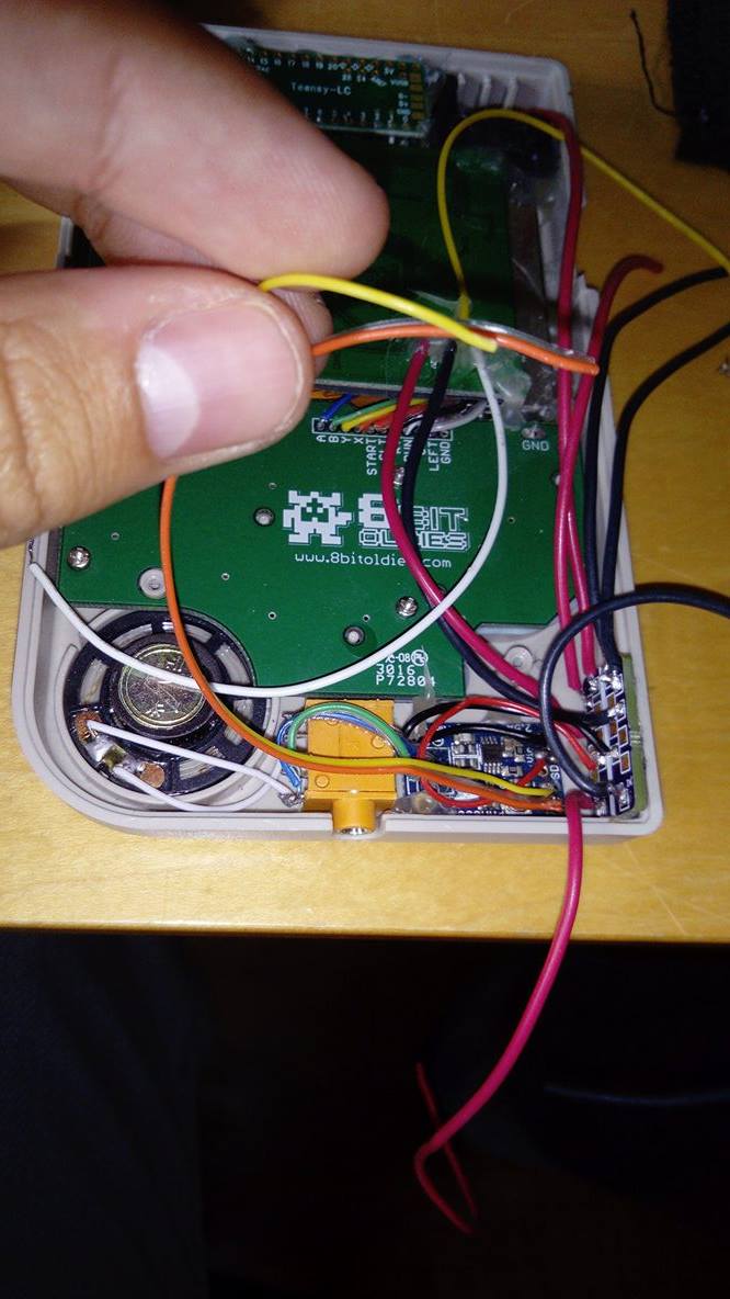

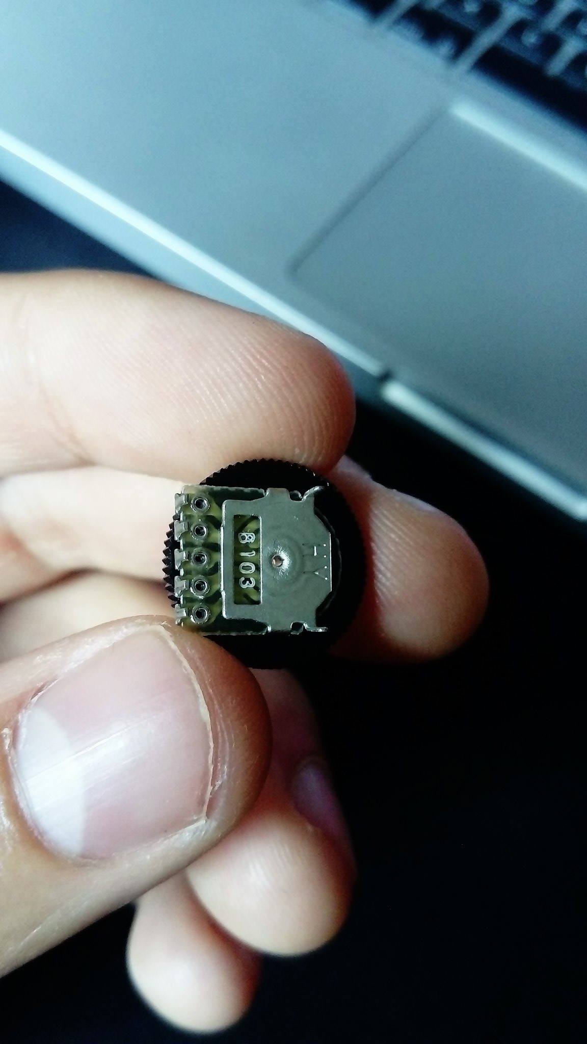

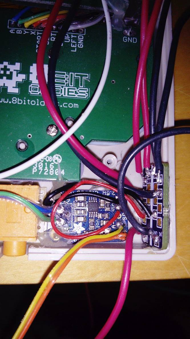

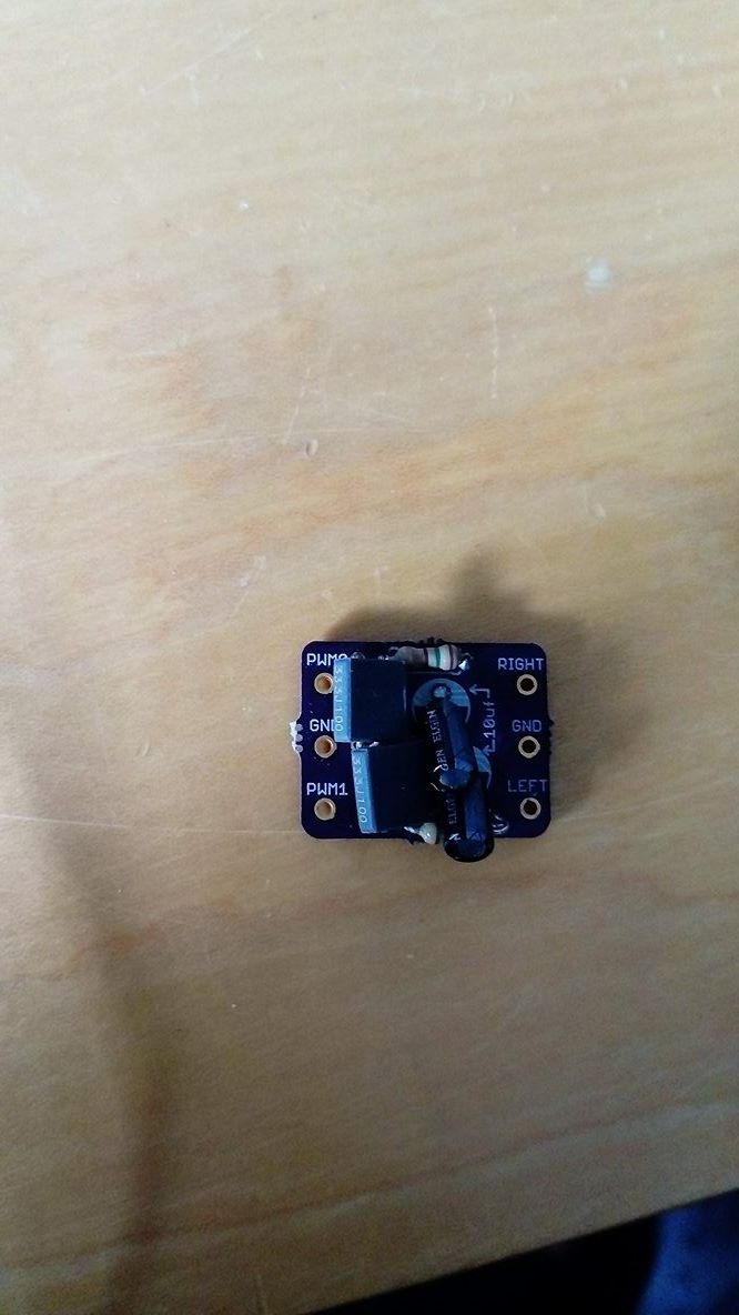

Hello everyone
I'm having some trouble figuring out how to wire my amp to my low-pass filter, my potentiometer and lastly my pi zero.
I do not have an AIO board and I'm running the audio in mono. I followed Wremy's original guide with the mono amp from Adafuit but I'm stuck now since I do not know where the wires are supposed to go. I am very new to all of this and all help is appreciated.
Thanks
Need help with audio wiring

Re: Need help with audio wiring
audioShow
Probably. I'm not sure what the radio shack pot wheel is, or how it compares to mine (ebay). If it has 5 pins it's likely the same as my diagram.
