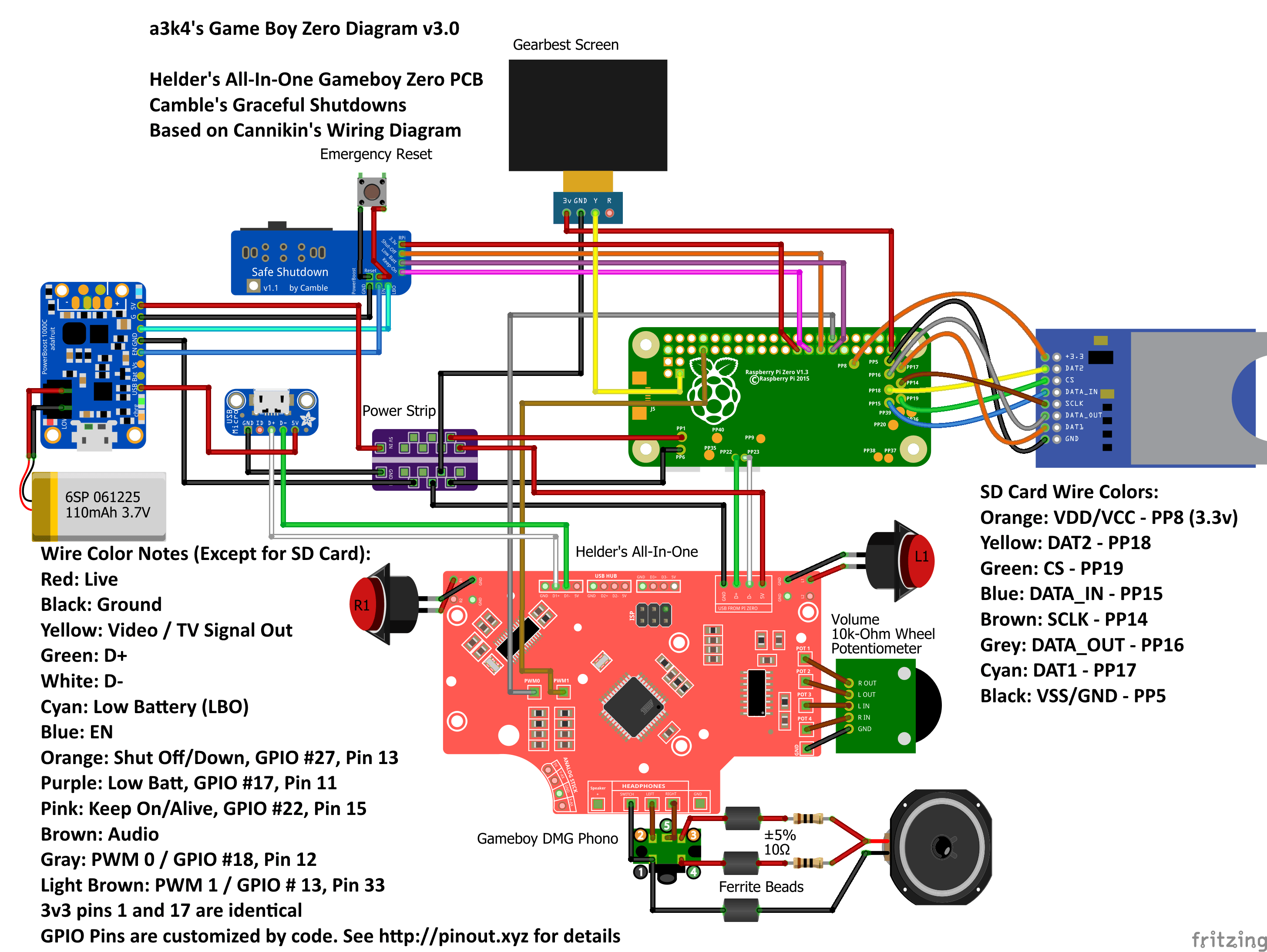

In terms of the Cheaper PCB Board it is very different from the Helder's board of course and I was wonder if there is still a way of connecting the same components with the cheaper board. I know it would be different but I have this diagram for Helders set up
Just wondering if there is a diagram for the Cheaper PCB

Re: Cheaper PCB
Post by YaYa » Sat Aug 05, 2017 11:13 am
You don't have a specific thread for your board but keep asking here and people will help you as much as they can.
Re: Cheaper PCB
Post by YaYa » Sat Aug 05, 2017 11:17 am
You will hace to wire everything to the pi itself directly with your board as its goal is just taking care of the buttons (by the way, do you have a circuit for buttons or do you need to then wire to the pi itself ?)
Edit : sorry, didn't took a big look to your post. Yes, your board is just collecting contacts from buttons, and you need to wire everything (yes really everything) directly to the Pi
