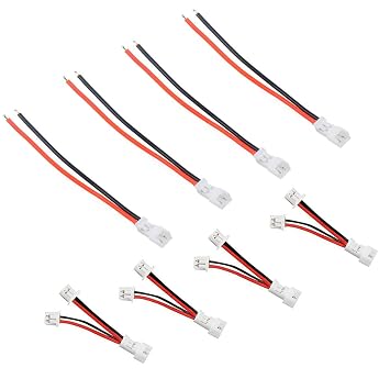

Dont see why not. I used a samsung galaxy s2 extender battery with about 4000 mAh. I removed the pogo pins and soldered a jst cable directly to the battery. Still need to update my build log below though :)

Woah, so if I had one of these... I would just solder to the gold bit on the battery?
Also, there are 4 gold bits, are two connections enough?
Thanks very much!

Yes you have V+ and V-. The other two pads are useless

Yeah, if you are going to use a battery like that, you'll have to solder directly to it. Like YaYa mentioned, only 2 pins are used, two are useless. If soldering directly to the battery, just be careful, and try not to expose the pads to too much heat for too long. It's easy to solder to.
As for the pogo pins, same idea, but you would solder to the pogo pins that correspond to the pins on the battery that you need to use. and then when the batter presses against it that would transfer power.
Check out YaYa GBZ in his signature, he uses the pogo pins I an talking about.

Will get hold of one of those JST cables and get it soldered to the battery woohoo :D

goes without saying be very careful when soldiering to the battery do not heat the battery up and do not bridge the contacts
