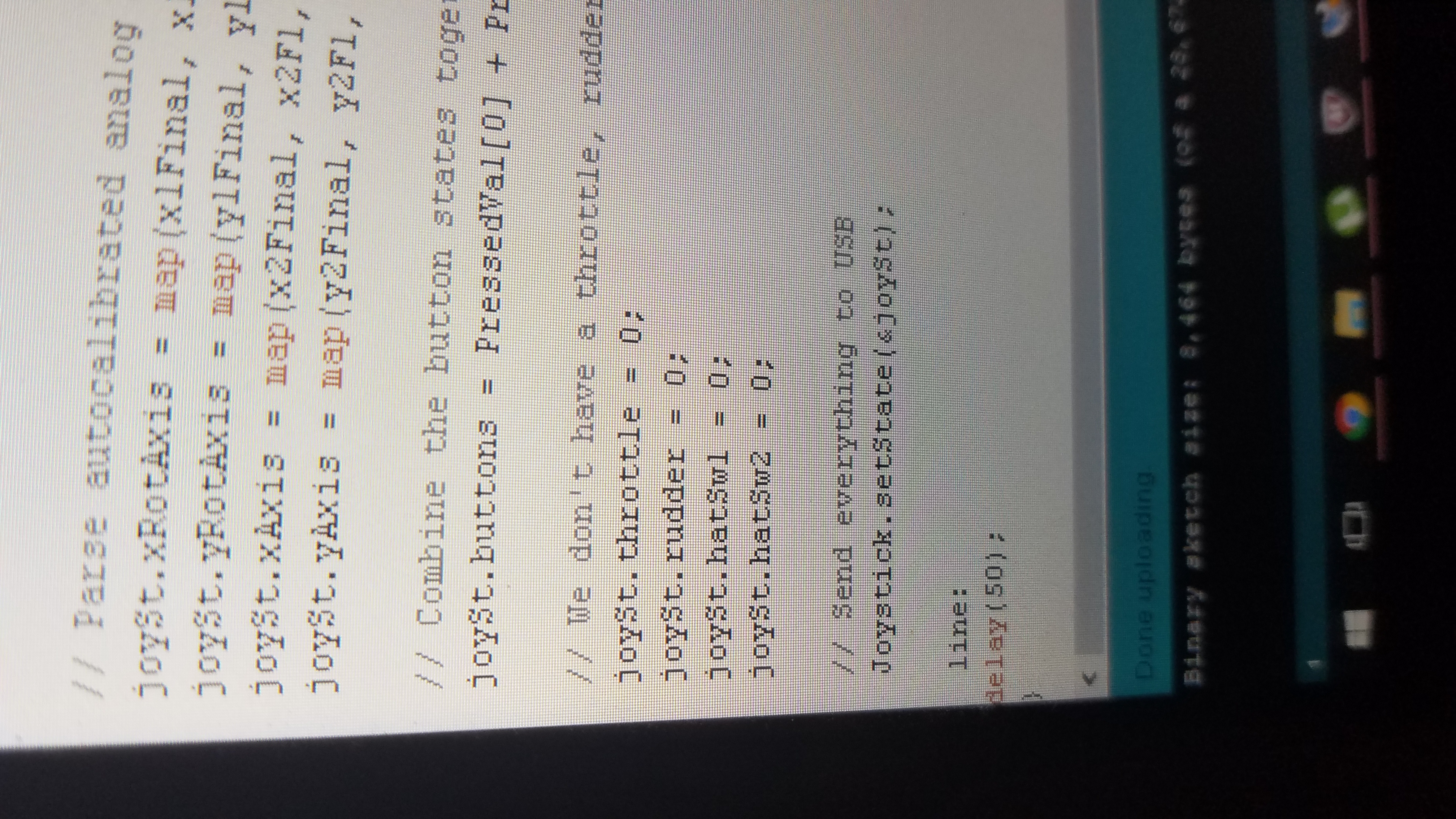

I applyed the line to the code .. it worked great no more double clicking or skipping and button are still fast and responsive. Thanks alot

Hi, thanks for testing it out and replying.
Please remove the "line: " from your code. It is not necessary. Code should be:
// Send everything to USB
Joystick.setState(&joySt);
delay(50);
Please also report this change back to the original creator thread.
A little theory: A lower delay value means more inputs/second. A higher delay value means less inputs/second.
e.g.:
delay(50) --> <= 20 inputs/s (should be more than enough).
delay(100) --> <= 10 inputs/s
delay(1000) --> <=1 inputs/s (not enough for most games, possible high delay between presses and the game reaction)
greetings from Germany

The Delay Code worked!!! No more double button pushes. I got the start and select working a LITTLE better by centering up the PCB better.

This worked for me! I hadn't run into this issue with any previous builds (3 down, no problems) but this 4th was having so many "A" button bounces that it was unusable. Added the small snippet of code as stated above, and the delay of 100 worked for me. 50 wasn't good enough. Everything works like a charm now.
