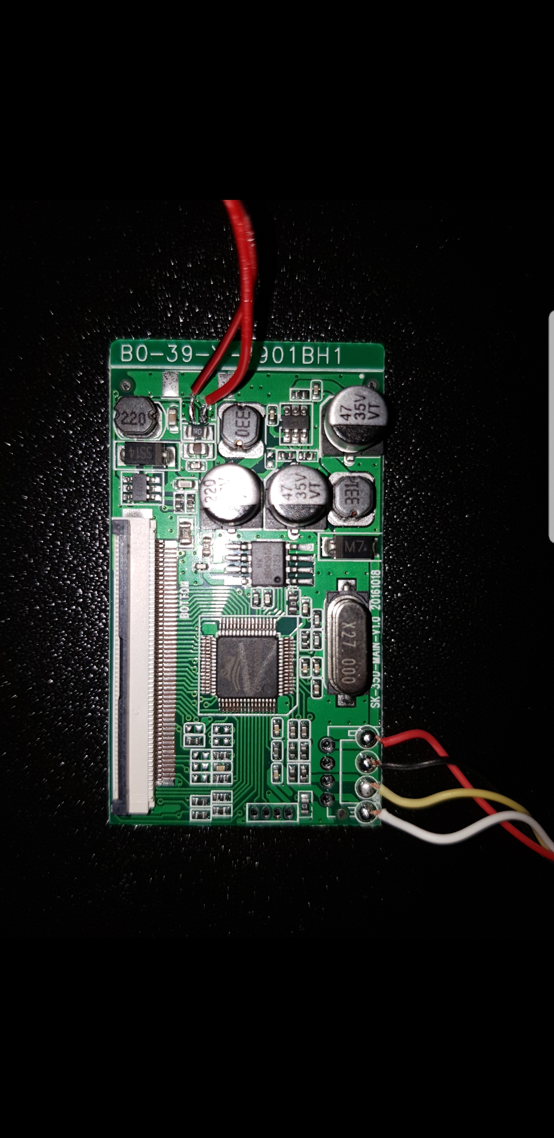

I recently got a screen for my GBZ project and it isn't a screen that isn't on the forum. This was a screen bought off Amazon, (https://www.amazon.com/gp/product/B0045 ... UTF8&psc=1) and due to the nature of taking a product apart, I probably won't get a refund. If anyone could help me with this, it would be much appreciated! :D

Jump the power (red wire) to pin 3 on the AM569
http://www.datasheetlib.com/datasheet/1 ... #datasheet
It may work better if you remove the chip, not sure though

Another safer and sure shot method is to use the 3.3v pin of the pi to 3.3v pin of the board for power supply. GND to GND and TV to AV1. That should work just fine

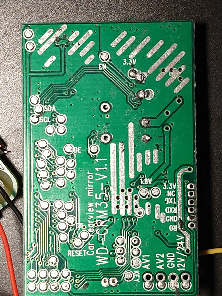

I got this bw board and I don't know how I can make it to 5V.
I would be happy if somebody can help me

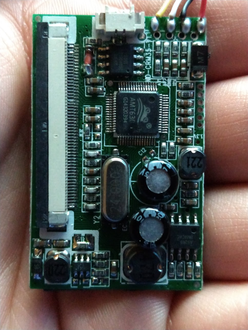

Here you go, good luck with your build. :D :D
GBZ BW Screen.jpg (751.87 KiB) Viewed 10733 times

And you only have to connect the yellow or the white wire to the raspberry or?
Thump52
Posts: 111
Been thanked: 27 times
Re: Help getting board down to 5v
Post by Thump52 » Mon Apr 09, 2018 11:31 am
Yes only one, I personally just use the yellow wire.
