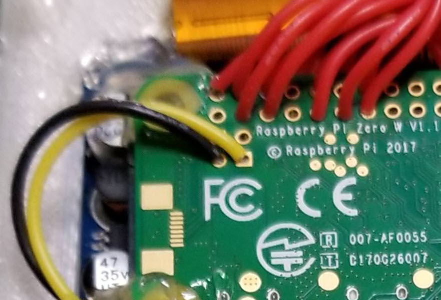

As for the screen, I have found that the gearbest screen is the best of the composites. (for me at least), I see you have wired the ground to the pi's GPIO's, what I usually do is actually wire the ground right beside the white av wire (that hole is ground as well). It seems to help, at least I have noticed a difference when wired there, versus the GPIO or power strip. The screen should have came with some shielded wire, which is usually sufficient.
I have also soldered and removed the connector, and just kept the connector, I have seen no noticeable difference.

Thanks for the quick response man, I will order some of both :D I actually just swapped the white for the yellow (AV1) & tried moving the ground before you replied, is this the spot you are talking about? it was the closest ground I could see on the pinout. Or do you literally mean the hole to the right of the yellow wire?
Unfortunately the wire it came with was not shielded at all (the wire I am using is the one it came with). I think I might try and remove the connector not to sure how yet but I will give it a go lol

I mean right beside the av wire, here is a pic of one of mine:
6-14-2018 8-58-08 AM.jpg (92.37 KiB) Viewed 6753 times
In this case I removed the connector and soldered my own wires (28 AWG silicone coated wiring). Removing the connector is not too hard. You can actually just snip the 4 pins on the back, and then snip the two support legs with flush cutters and pull the plastic stuff off. Then Just heat the pads and pull what ever is left or the metal legs with tweezers etc...
