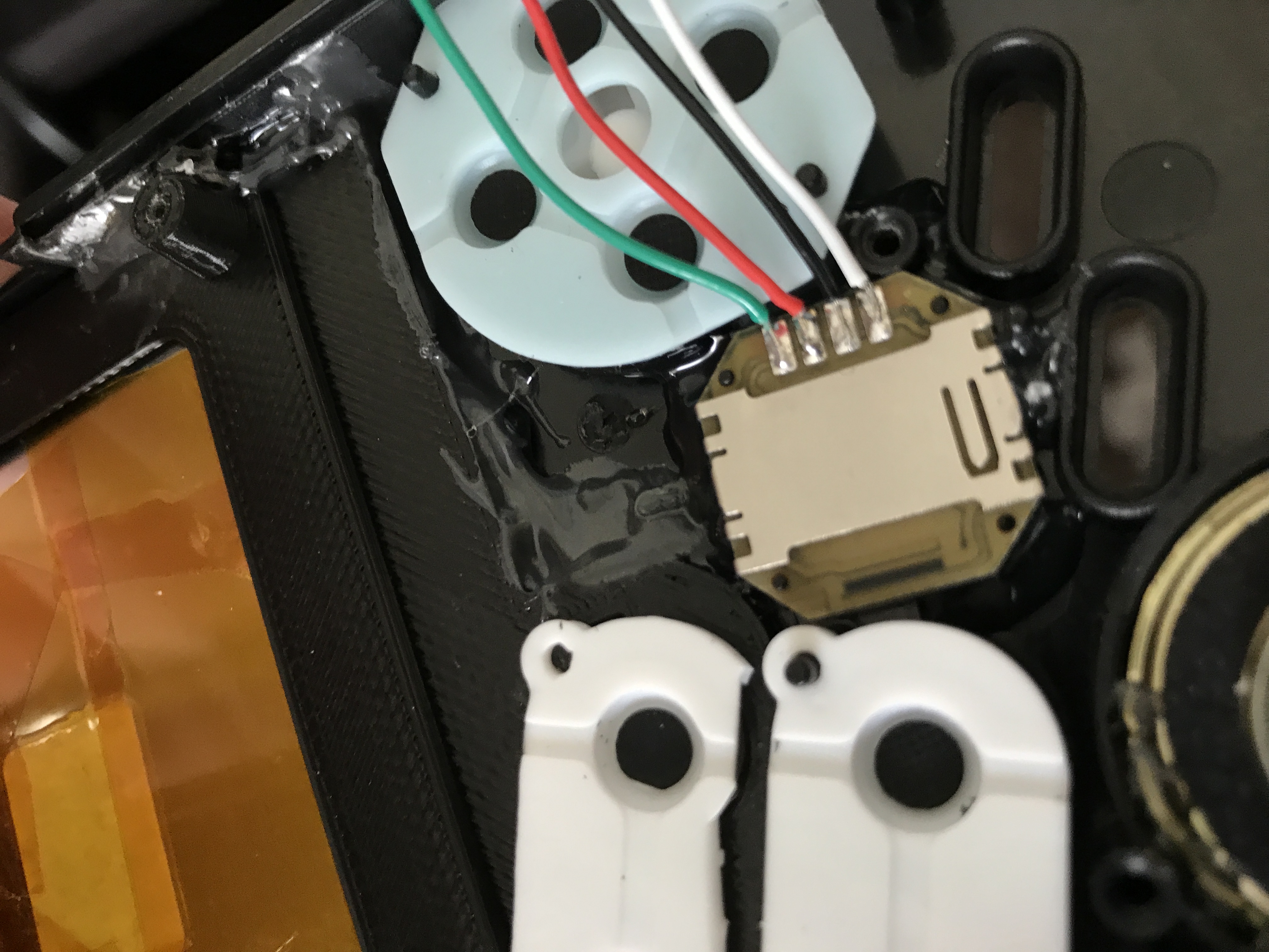

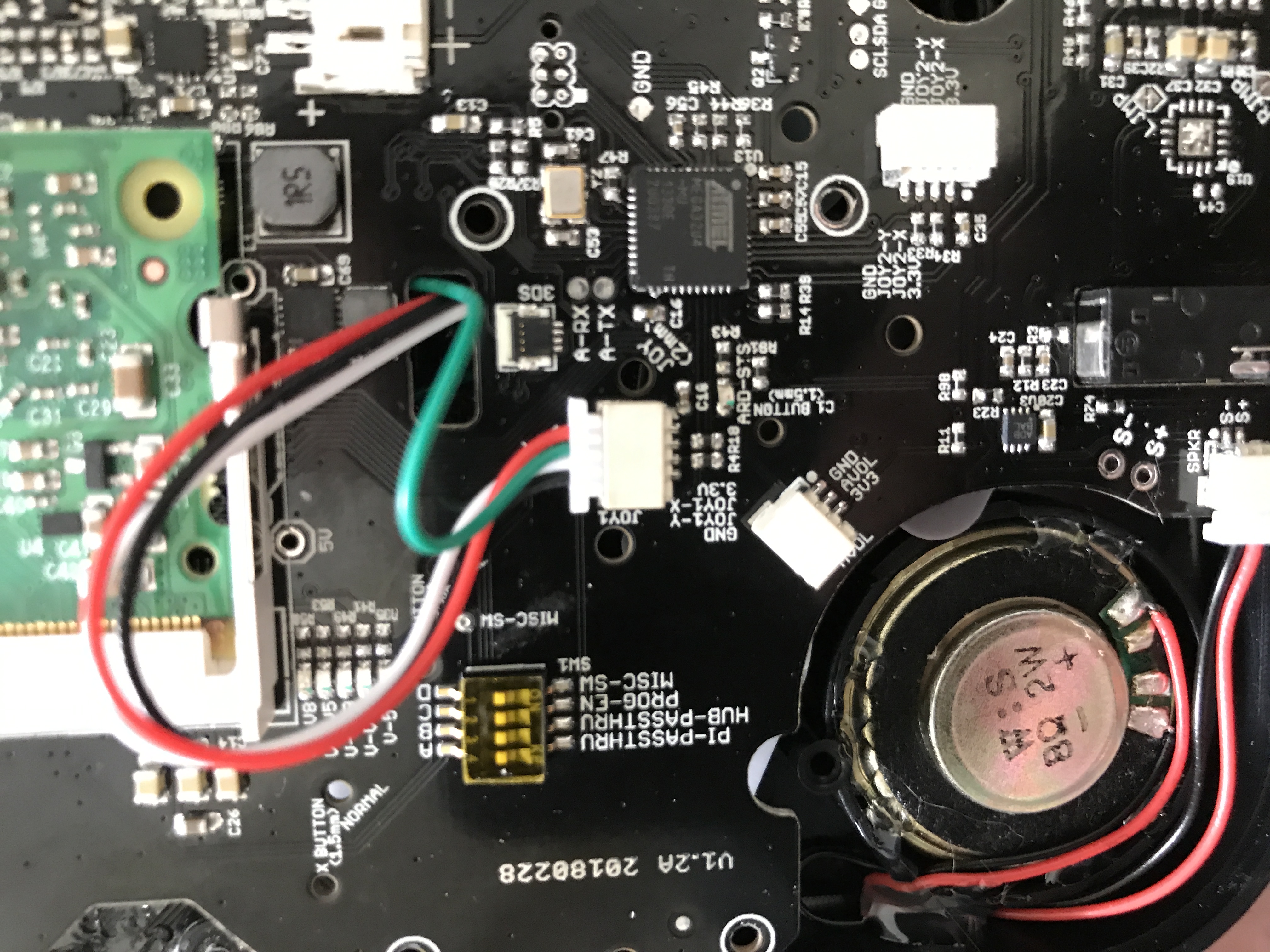

Just completed my first build with Kite's Circuit Sword and everything is working very nicely except for the PSP 1000 joystick.
When I wired it like this the Up/Down Axis was inverted:

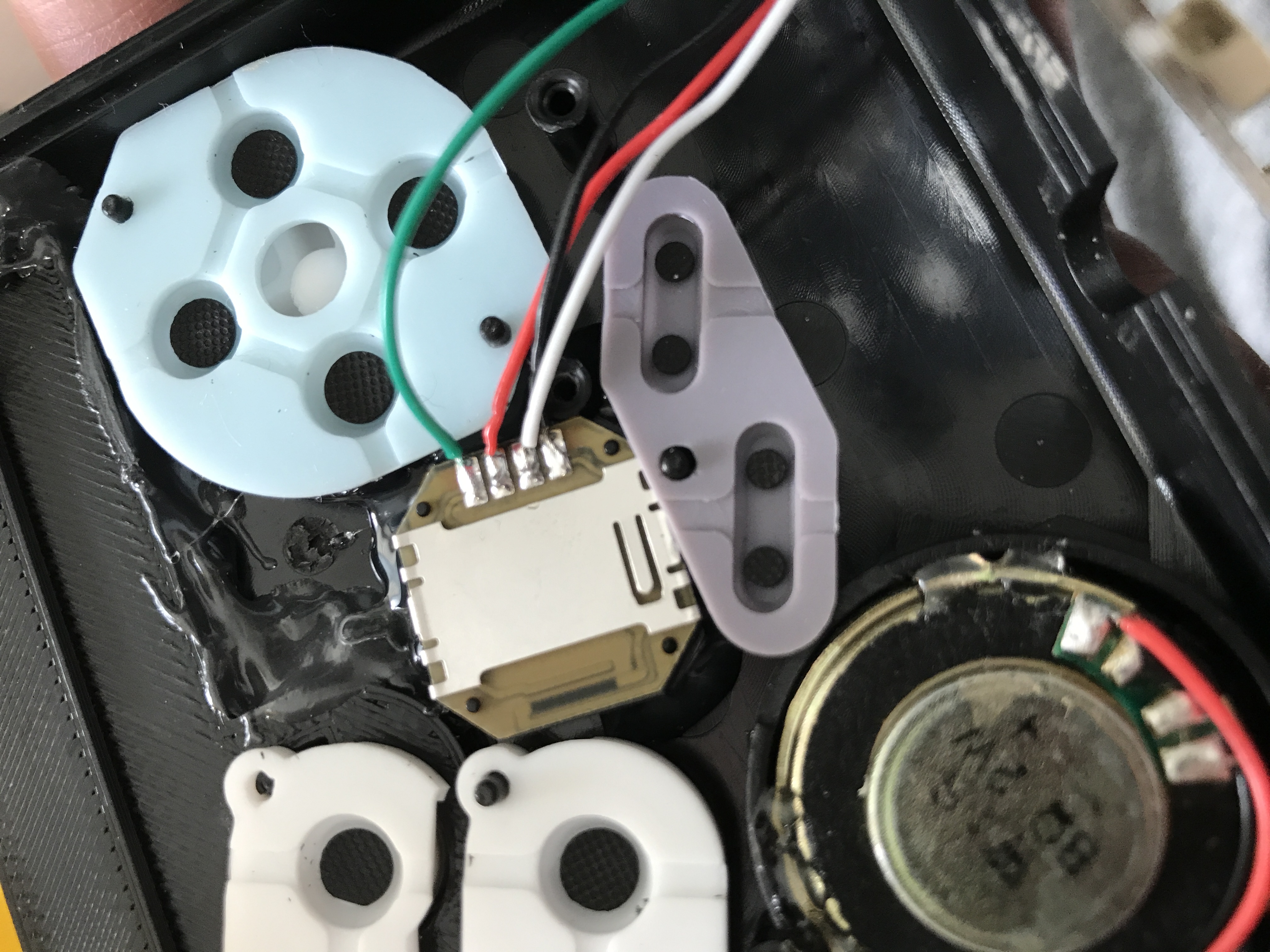

When I wired it like this the only direction that works is left, and it makes Mario go forward:
And here is how it's plugged in:
Please tell me how to wire this darn thing.
I kinda think the first way I had it was correct and the config file needs to change but can anyone confirm?
P.S. I am a monkey see monkey do-er and I looked at four different builds and each was wired differently 🤷‍♂️Totally lost.

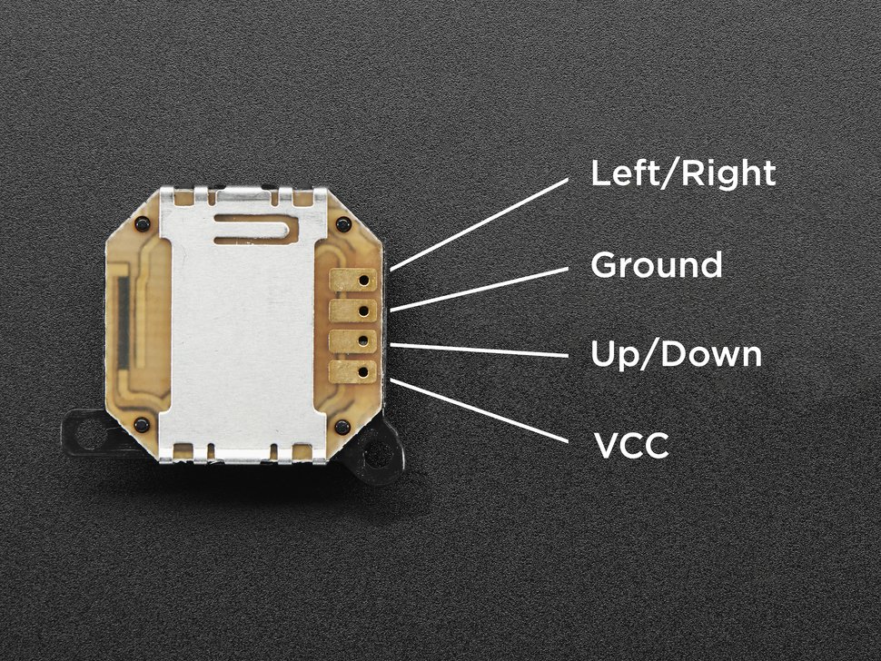

New wiring according to this diagram:
Now left/right are inverted.

Alright, in the last few minutes I downloaded putty, learned to ssh into pi, ran the config file, inverted the joystick, and solved the problem!
Used the instructions here:
https://github.com/kiteretro/Circuit-Sw ... he-arduino
