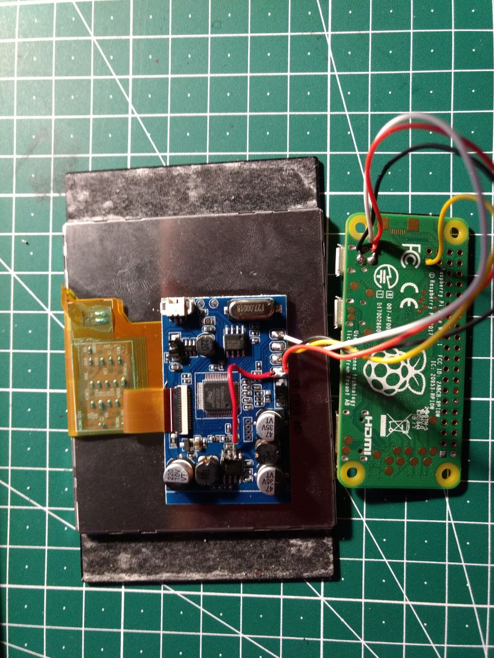

Hello,
i wired up my rasperry zero with a composite screen (variant 9). But it doesnt show anything.
in config.txt i changed:
#hdmi_force_hotplug=1
sdtv_mode=2
any ideas?
Peter

https://www.sudomod.com/wiki/index.php/ ... t-9_5V.jpg
1) remove the chip completely
2) you have soldered to the wrong pin, see pic in link above, solder to the pad below the one you have soldered to.

Last discussion about the Chip was ending up with keeping it in Place. But yes i did solder it wrong
