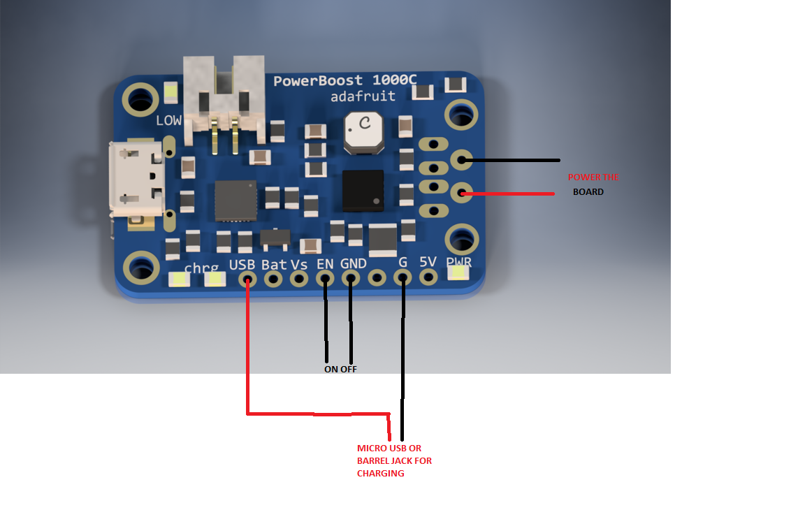

I find these projects fun, but unfortunately I have no natural intuition for them. I'm working on my 2nd build (my 1st one was a total disaster), and I need some help. I'm using the tinkerBoy 2.0 controller and the Powerboost 1000c, and I'm stuck on a couple of points:
1. Where do I connect the wires for the the on/off switch to the Powerboost? The through holes I've seen on other diagrams/videos are used in other ways with the tinkerBoy board?
2. Where do I connect the wires for the micro USB charging port in this setup? The tinkerBoy or the Powerboost?
Any help would be greatly appreciated!

Post by EVE-TECH » Tue Oct 09, 2018 8:18 pm
Hope you get it

Post by retrov » Tue Oct 09, 2018 10:03 pm
Thank you so much! I’ll try it tomorrow, and post here about how it went.
