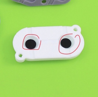

Clean these black pieces and button pads with alcohol or perfume, even if the button rapper are new
