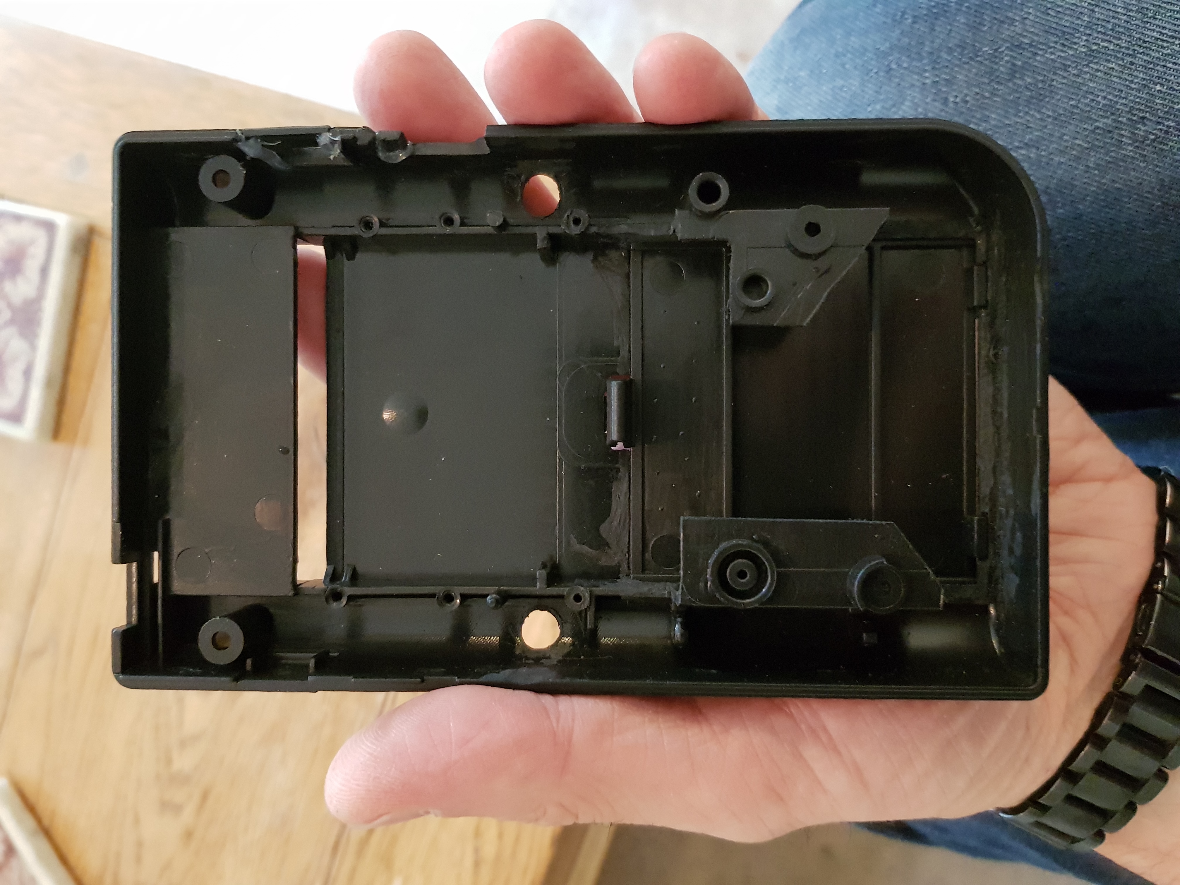

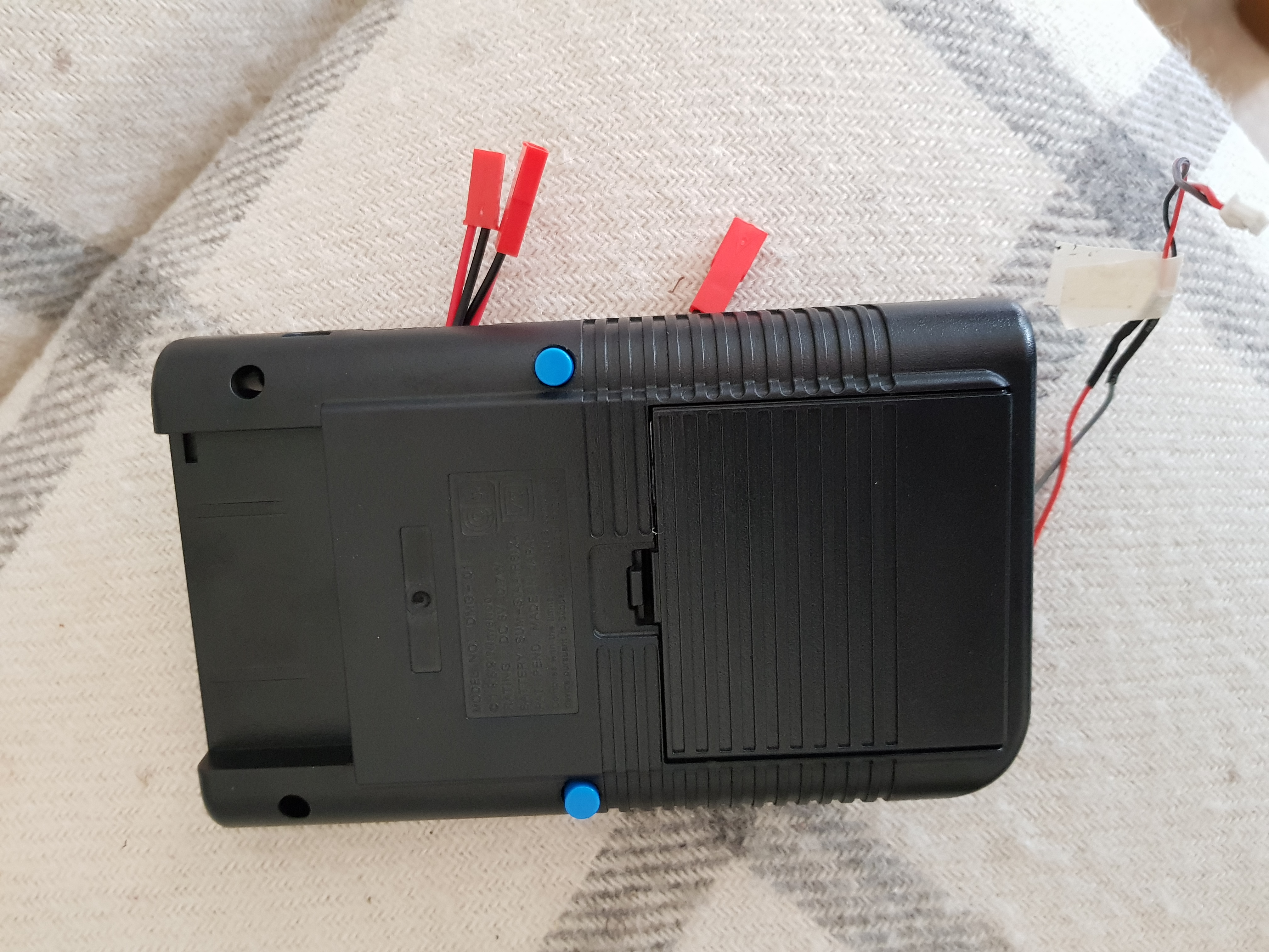

Like this...
L + R back buttons installed
Middle case mounting holes drilled out for L + R back buttons
