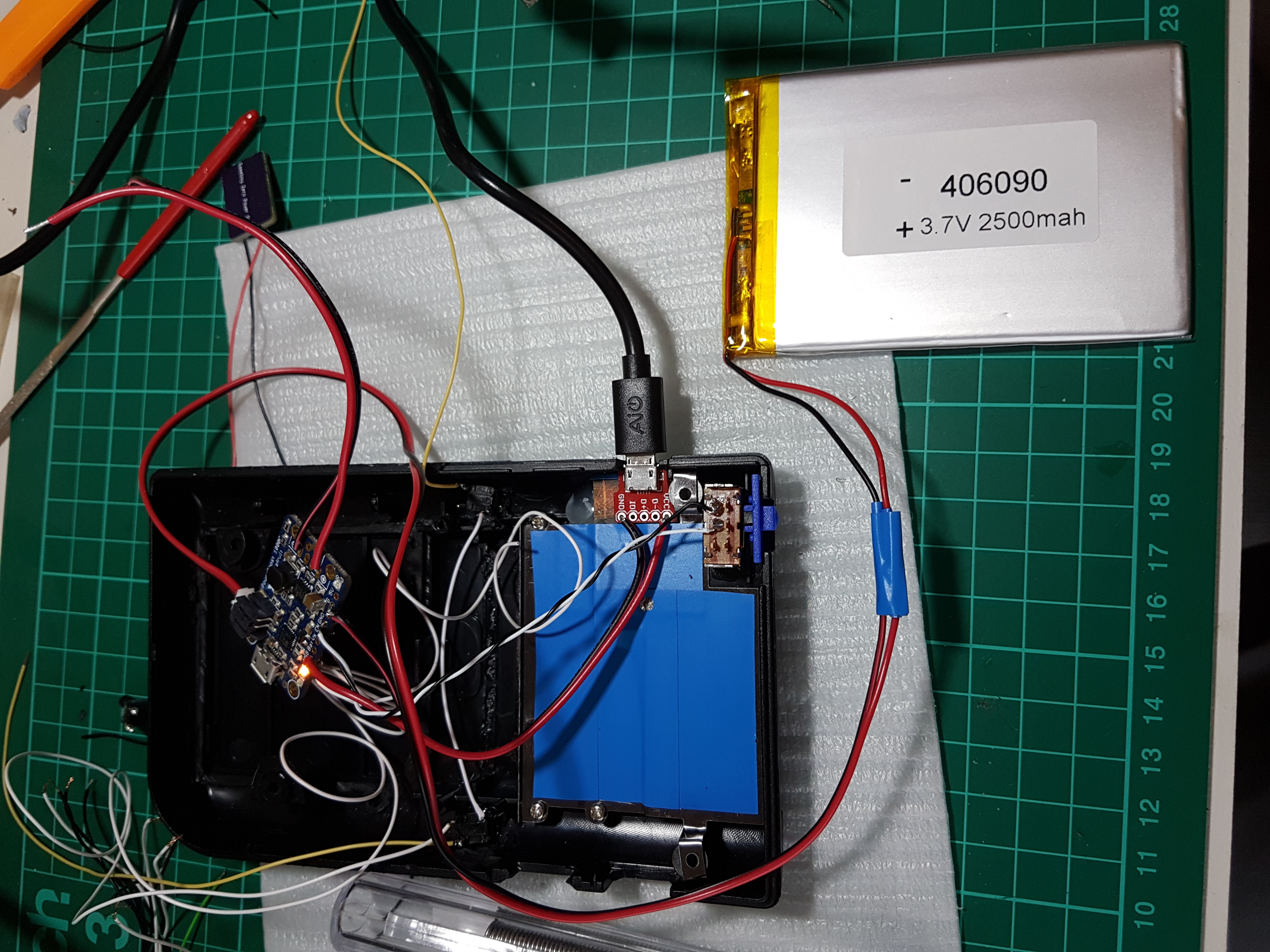

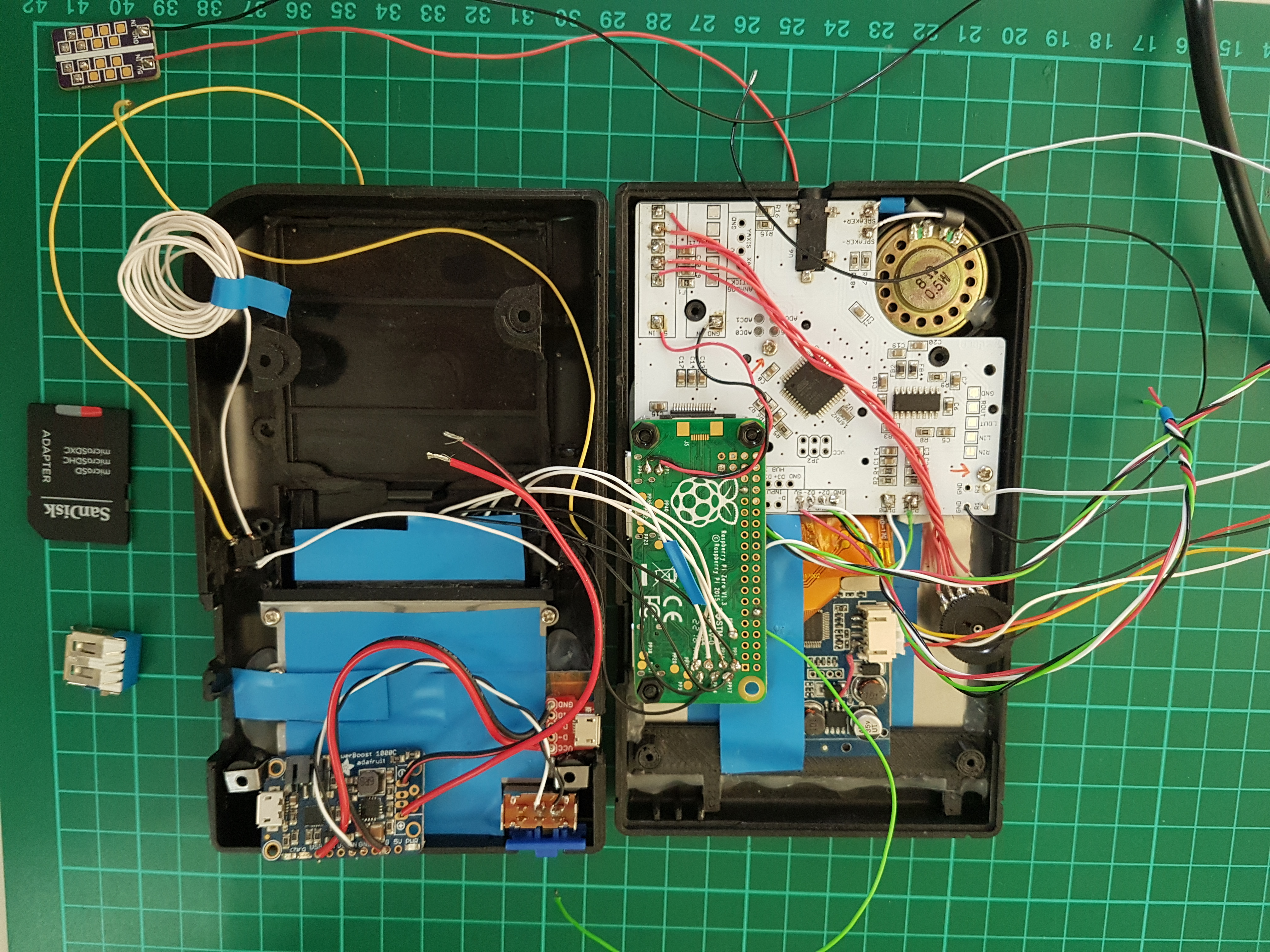

Thanks for your reply, most recent pics here:
2019-04-30 13.59.09.jpg (4.86 MiB) Viewed 4743 times
2017-06-28 16.29.18.jpg (4.01 MiB) Viewed 4743 times
Yeah, I would rather finish it myself it's just a time problem. If I get an hour or so to work on it I spend all my time going through the various guides and videos to work out where I'm at and why I have done things a certain way. By the time I get to the next step I have work or parenting or whatever to do and I'm back at the same spot the next time.

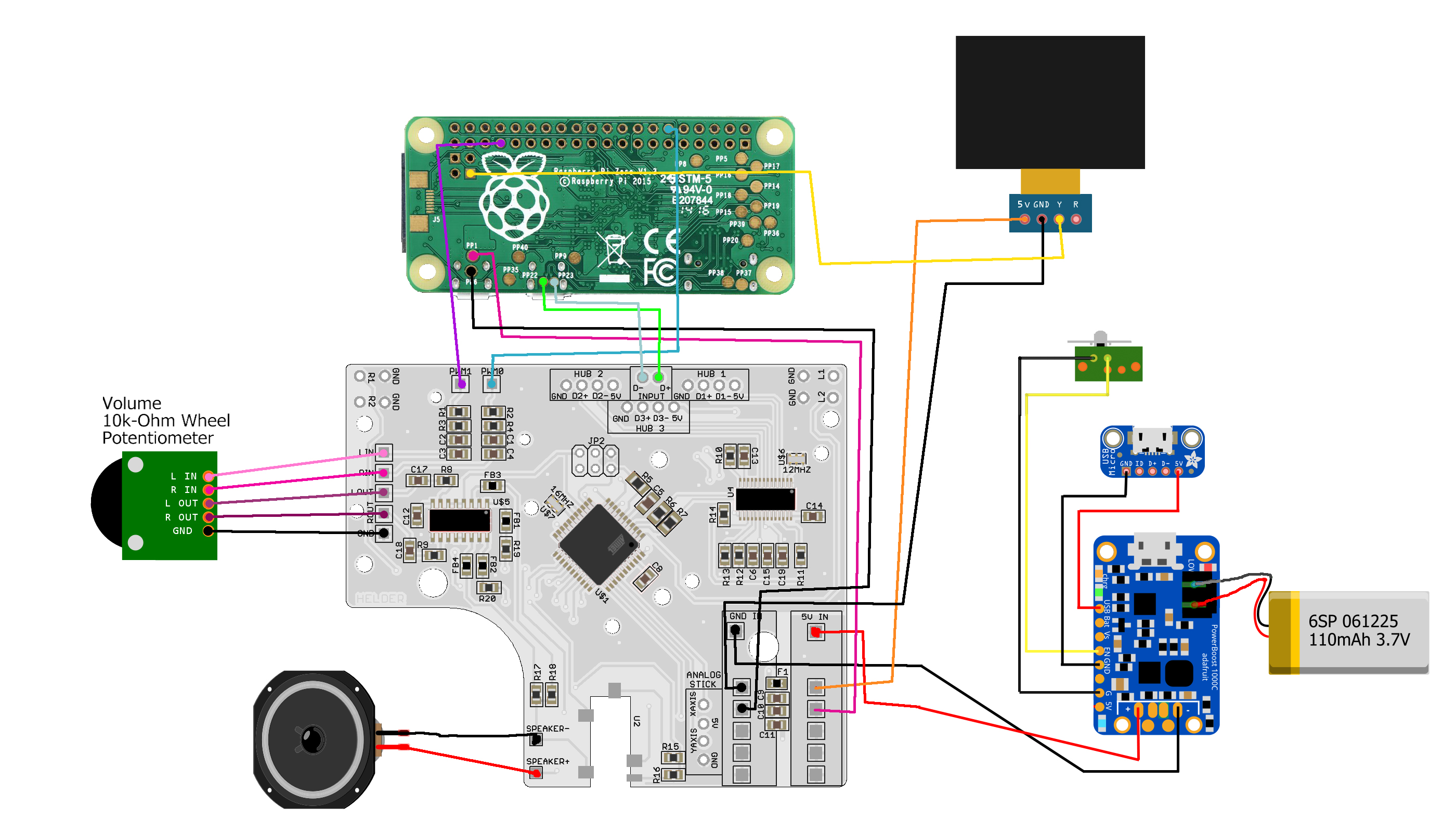

Your wiring is all messed up....
Volume wheel (wrong)
RPi0 (wrong)
Power strip (wrong)
And more....
here is a diagram based on the parts/components I can see in the pics you posted......
(this is ultimately based on all the parts working as they should.... for example the LCD)
wiring diagram AIO.jpg (1.11 MiB) Viewed 4718 times

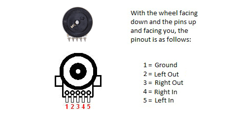

not exactly sure which volume wheel you have, but this is how I've always wired mine
b103 wiring pinout.jpg (71.55 KiB) Viewed 4718 times
I’d personally desolder everything that is wrong first and start a fresh...
1st get the LCD/Screen working
2nd get the AIO connected properly to the RPi
3rd get the sound going (volume wired properly)
You may have to hook up power before all or any of these
I would make sure solder connections are all solid.....
and try to limit the length of the wiring.... This helps for better signals and will come in handy when trying to close the build...
(some of your wiring choice should also be looked at again)
also...
I'd scrap the SD card to cartridge mod (just MHO)
but if you did want it...
then test and setup everything with the SD card in the RPi, and once everything is working (LCD, Sound, USB) then concentrate on that aspect its one of the most finicky parts of the whole build/project
