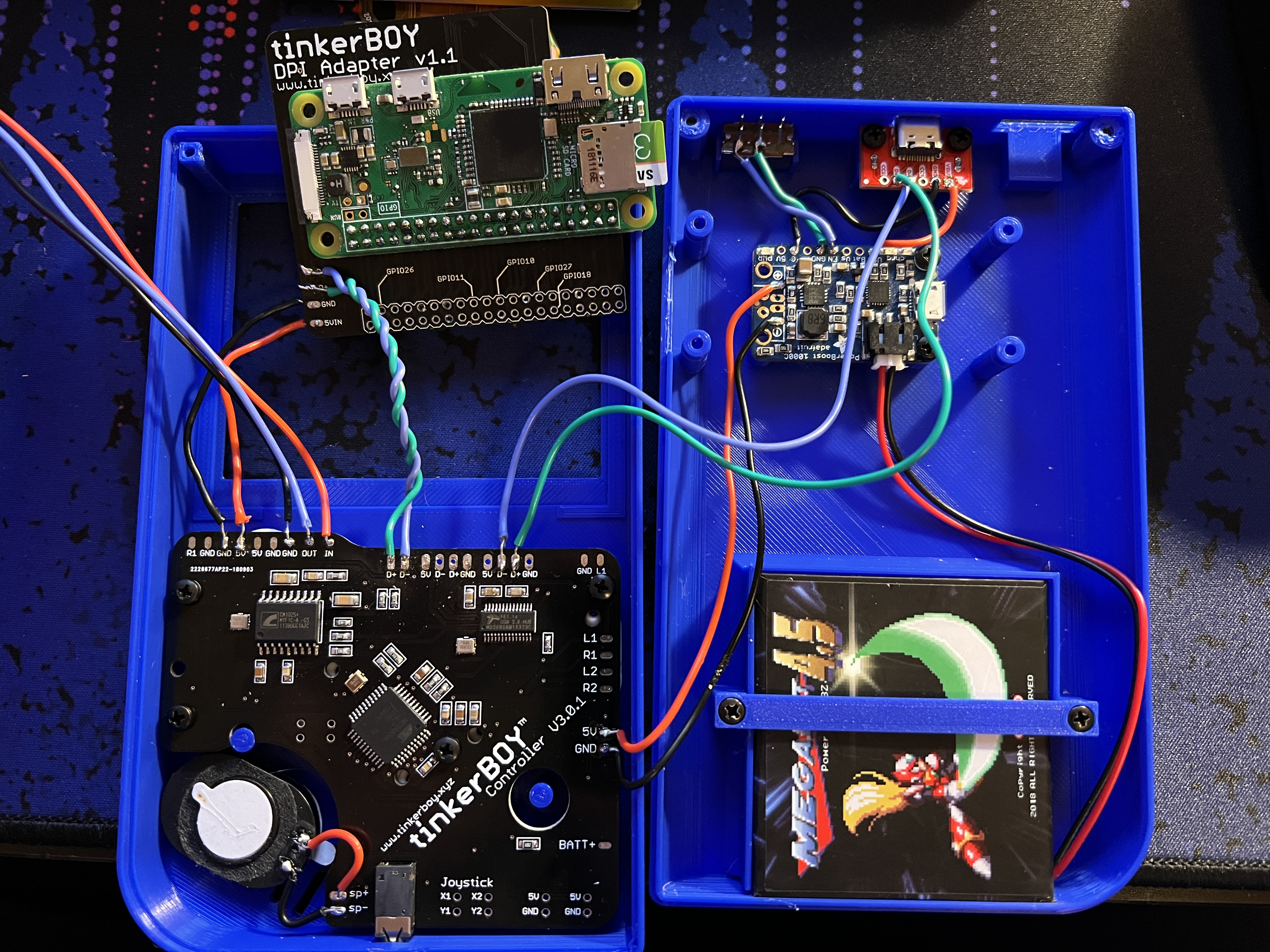

Hello,
So I've been working on a custom pi0 build with usb-c and a custom case. The only issue is that I keep getting the "No controller recognized" screen, and when i try holding any button nothing seems to input. I've attached all my wiring. I have also already attempted to used a micro-b cable and use those wires and plug directly into the usb port on the pi, which didnt work. Finally I also tried to use my switch pro controller through the USB-c port and that also did not recognize. There is no continuity between D+ and D- according to my multimeter, and honestly Im out of ideas as to why this isnt working.

Post by rodocop » Fri Jan 21, 2022 8:46 pm
Just to confirm, on the other side of the DPI board there should be two solder points for the data pads on the pi. I assume those are soldered?
