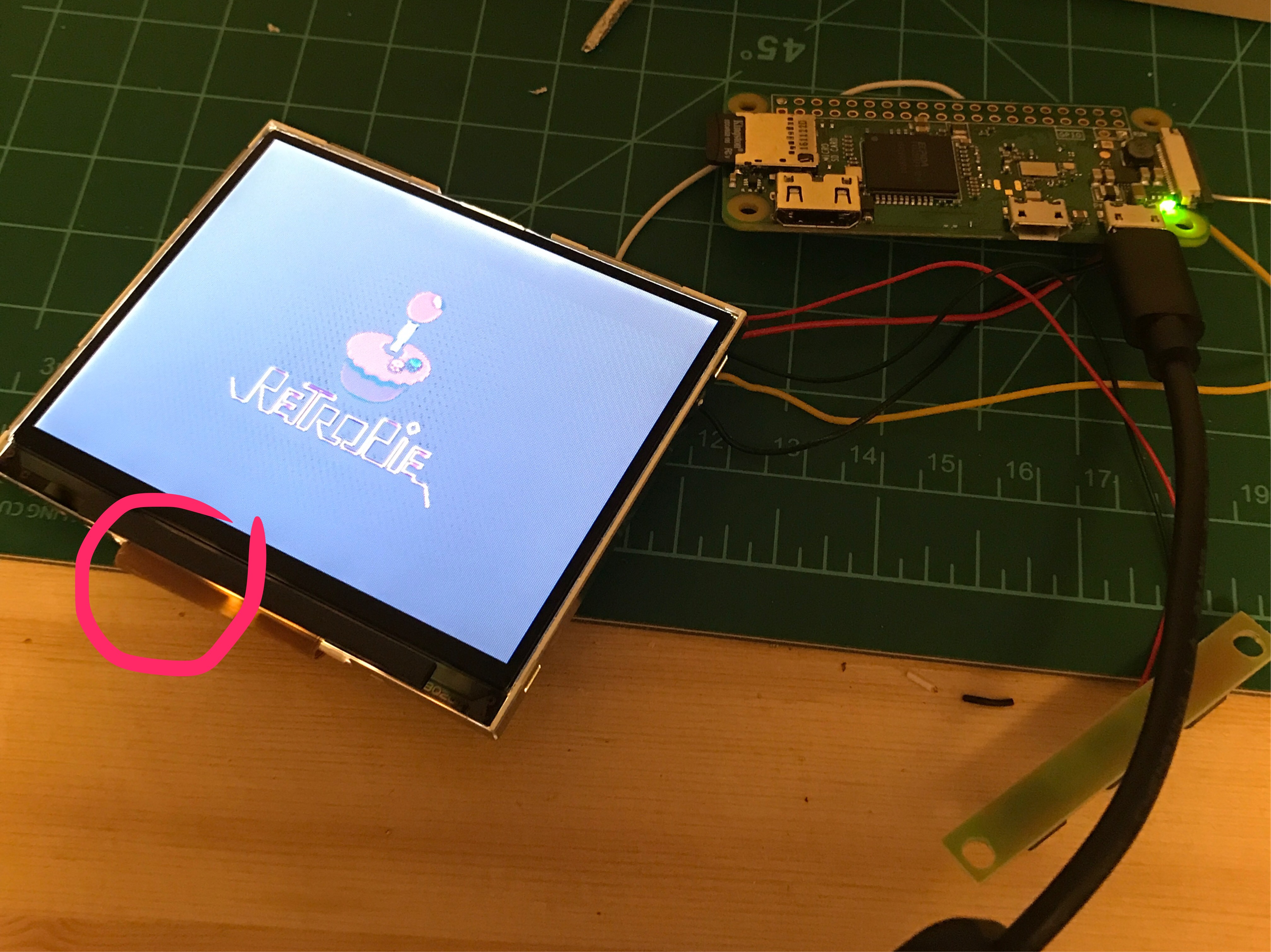

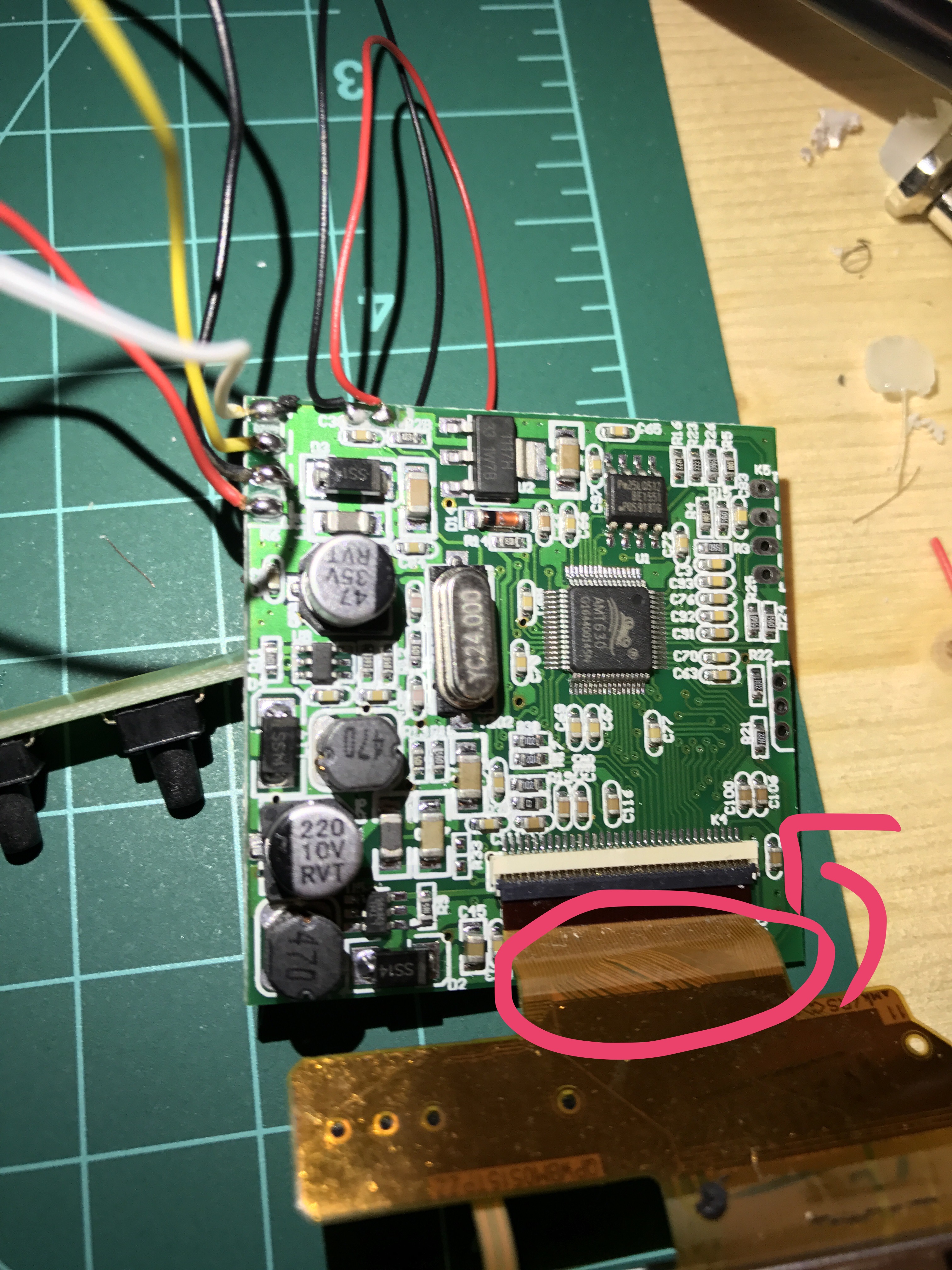

it could be the ribbon unfortunately... it seems we have the same board (variant 8). Everything was fine for me testing but when it came to resoldering I noticed that there was noise and discolouration. I panicked as this was the 2nd screen i ordered but, I found out if you held the ribbon down were it folds near the connector the display comes back. I guess the original monitor case it came in held everything together. I am trying to find a way to hold the ribbon down without interfering with the display. Maybe electrical tape or something? Any better ideas?

drsolow wrote:
Sat Sep 16, 2017 11:06 am
I would love to see a photo! I've tried this multiple times with my hands pressing down and moving the cables and wires, and while I have pretty good eyes, I can't detect any changes. :shock:

I'm currently at work but, I have a previous photo from my first screen which probably had he same problem but, I got frustrated and ripped it to shreds... lol
But, I think the ribbon has to be tight hence why I think it being in its original case made it work cause it held everything down. Every time I pushed that flap down or over close to the ribbon connector there was a proper display. Or if I held the ribbon against the bottom of the screen it worked as well. I really don't wanna put tape or anything like that on the ribbon cause I'm afraid it might break or something like that
