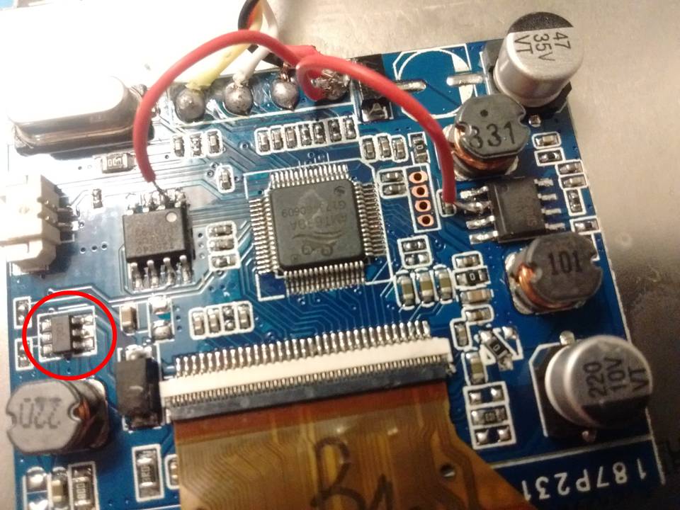

There is a small 4 pin header next to that 8 pin IC that I believe is the 5V, Ground and the 2 video signals (at least ground and 5V are there). I tried connecting to there and it didn't change things. I was running from a USB cable cut up and plugged into my laptop, maybe the screen needs more than 500mA or something (but then again I think the are USB 3.0 ports so I should have close to 1A anyway. But maybe my laptop does something weird with them on battery power. I tried running it at 9V at that point too and I have probably killed it now. Not sure why it wouldn't work at the 5V, that is exactly how I have modded every other screen, remove the IC and solder 5V input directly to the pad that the SW output pin was attached to. I guess I should have tried it before removing the IC

don't you believe that the 6 pins IC in the red circle could be the power IC?
Like that: https://www.sudomod.com/forum/viewtopic ... 892#p44008
or that : http://lcd-television-repair.com/newsle ... er_IC.html

Has anyone looked up the data sheet for that 6 pin IC? The thing is the 8 pin IC in the center of the board checked out has a form of voltage regulator but maybe there are two on the board?

Bridge your 5v cable (red) to PIN2 of the RZC2013S chip:
http://diodnik.com/wp-content/uploads/2 ... ZC2013.jpg
It is called VIN (note the dot on top of the chip to orient it).
The screen works without modding it, but i noticed some flickering in games, so i modded it anyway.
