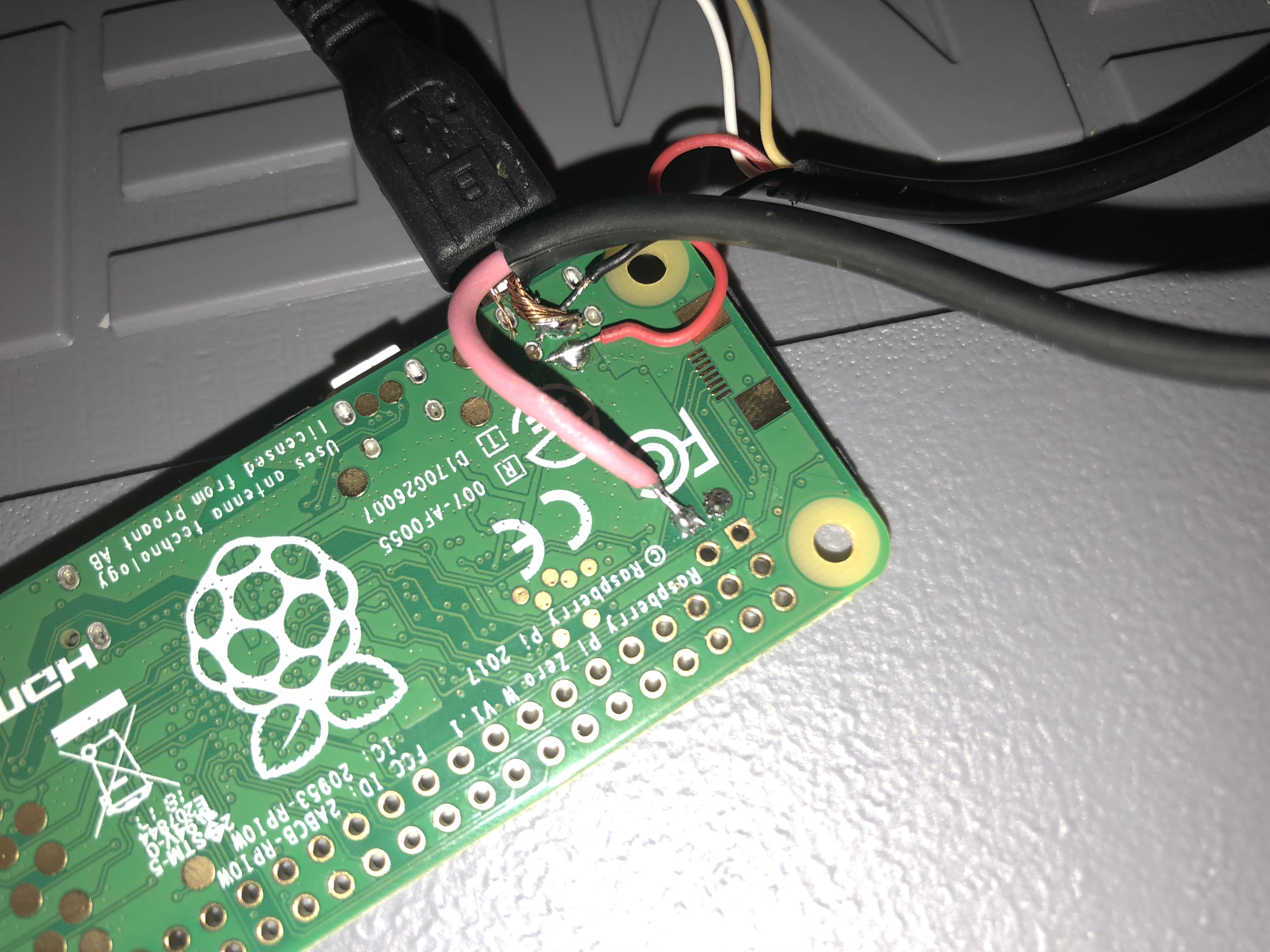

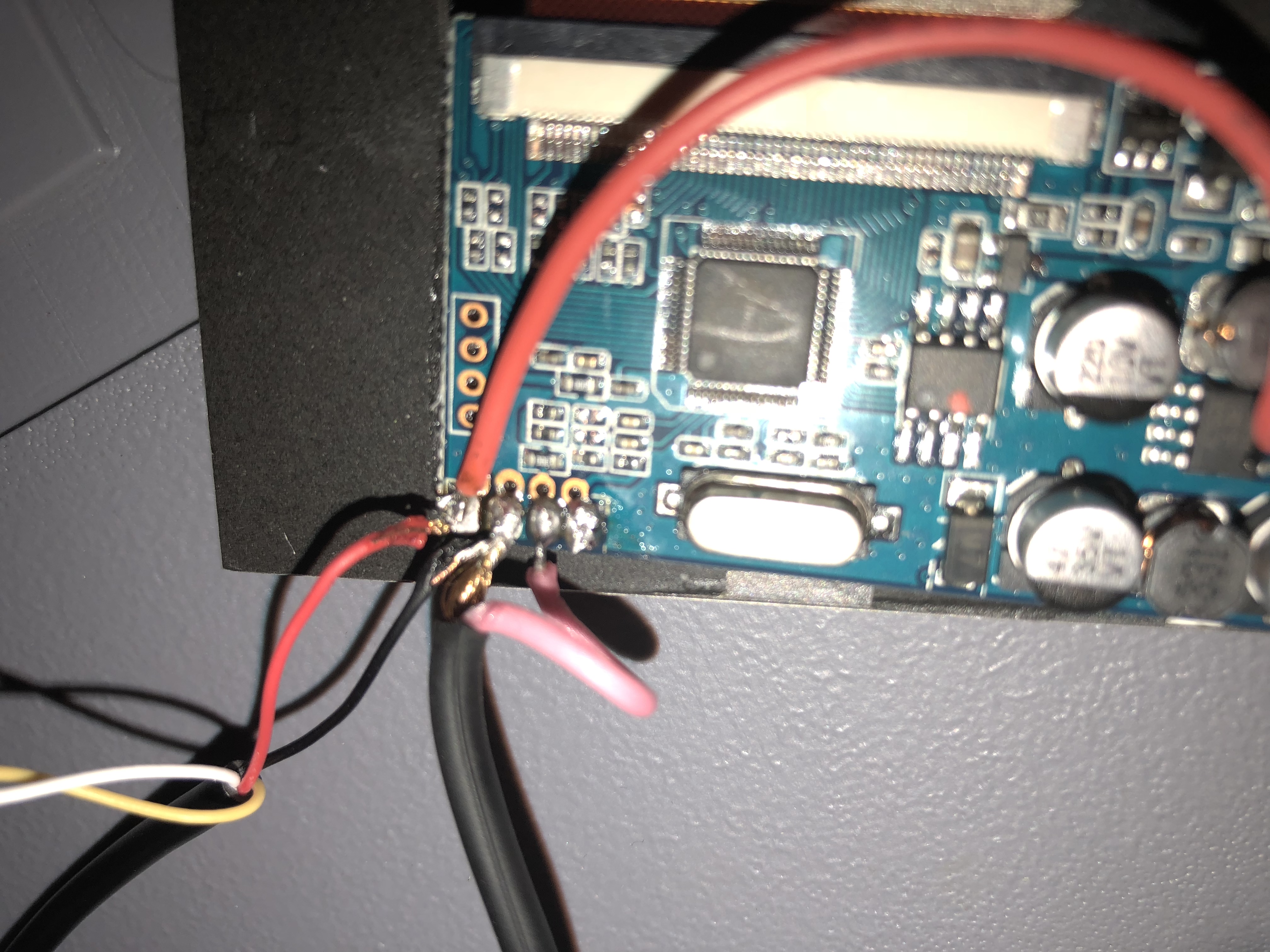

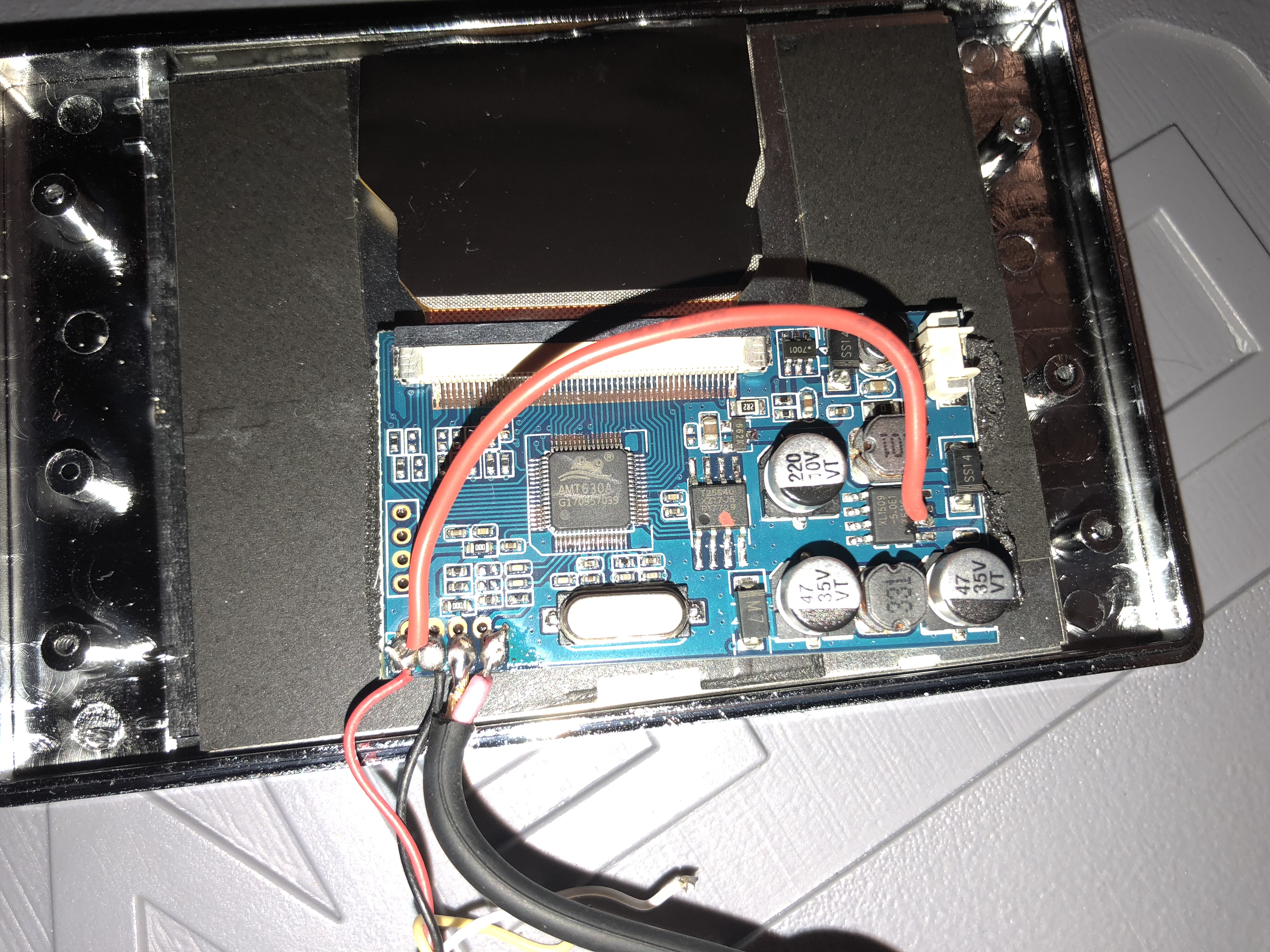

Ok so I’m having the same issue as the OP. I’m getting like a weird “interference”-like noise at the top of the screen. I followed the directions and used an old RCA cable but I’m not positive that I’m hooking everything up to the right spots. I’m using the backup camera screen from amazon and I have variant 7. So the board is practically glued to the back of the lcd. As long as the colors of the wires don’t change from one variant to the next then I think everything is in the right spot. But it still doesn’t look that great. I can’t seem to get a photo of the noise I’m seeing. Still trying. Here’s how I have it hooked up.

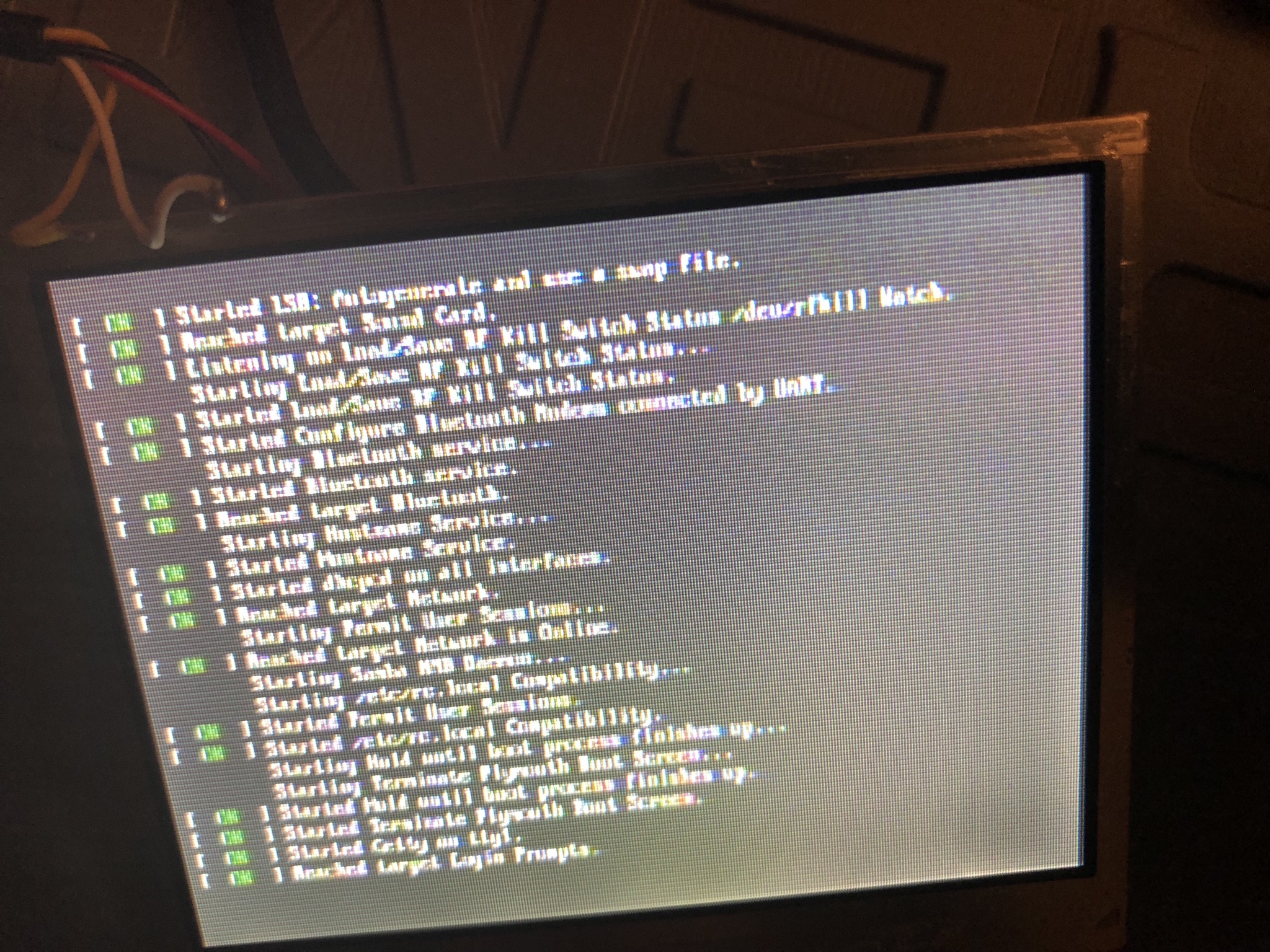

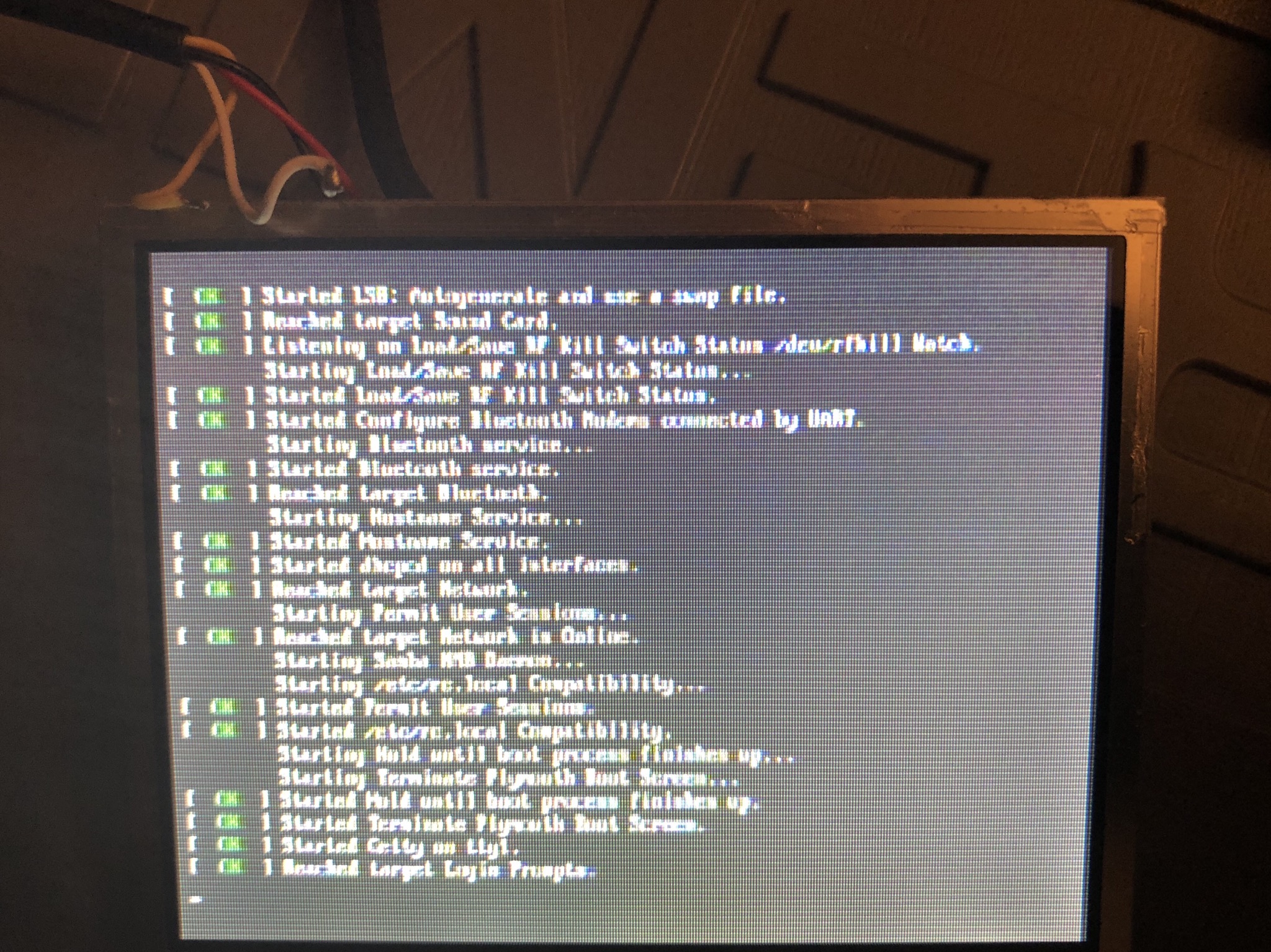

Ok. So when I start it up...it says AV2 on the screen. Do I have the video signal going into the wrong input? I used wermy’s first video as an example but he was using the adafruit screen. Also...here’s what the noise kind of looks like.
Top right corner.

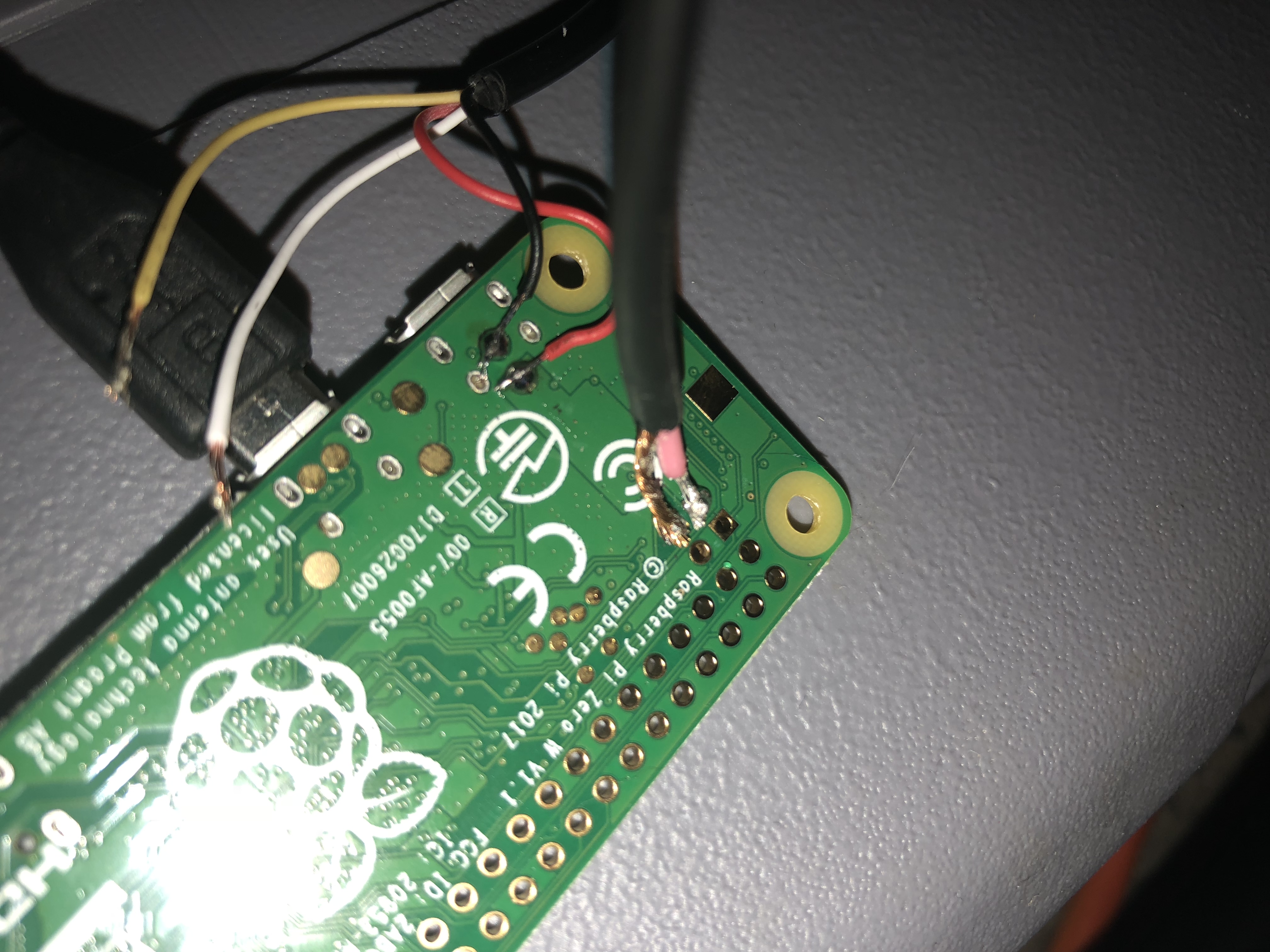

Ok redid everything. Still the same. Took off the white AV2 wire.
Now going from pi OUT to AV1 using the inside part of an rca cable. The ground i think is grounded on the lcd and the pi. Power to power.
Still have the noise. 😕
