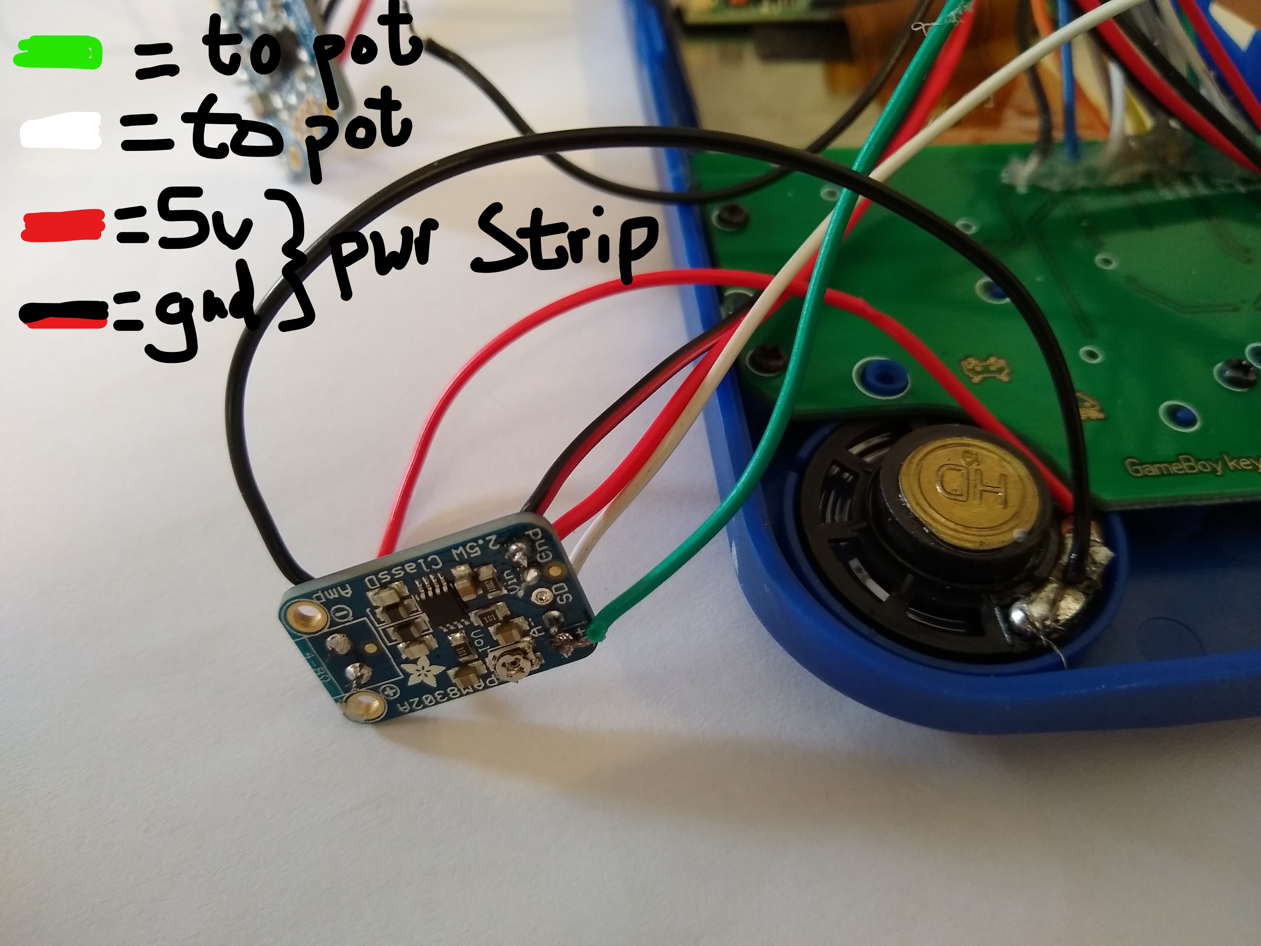

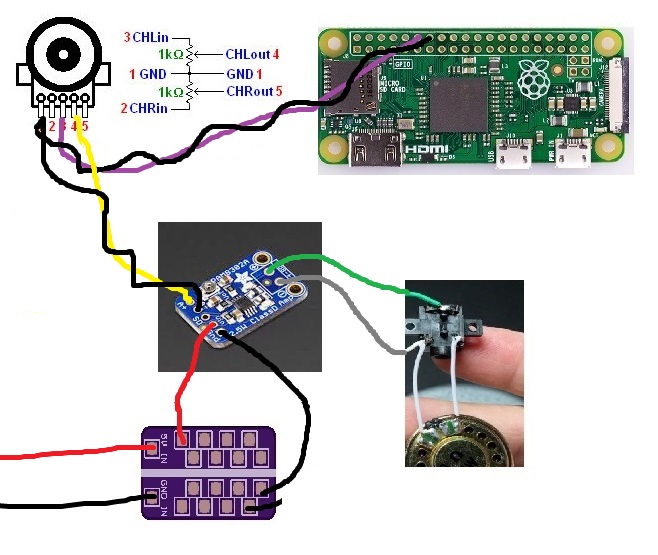

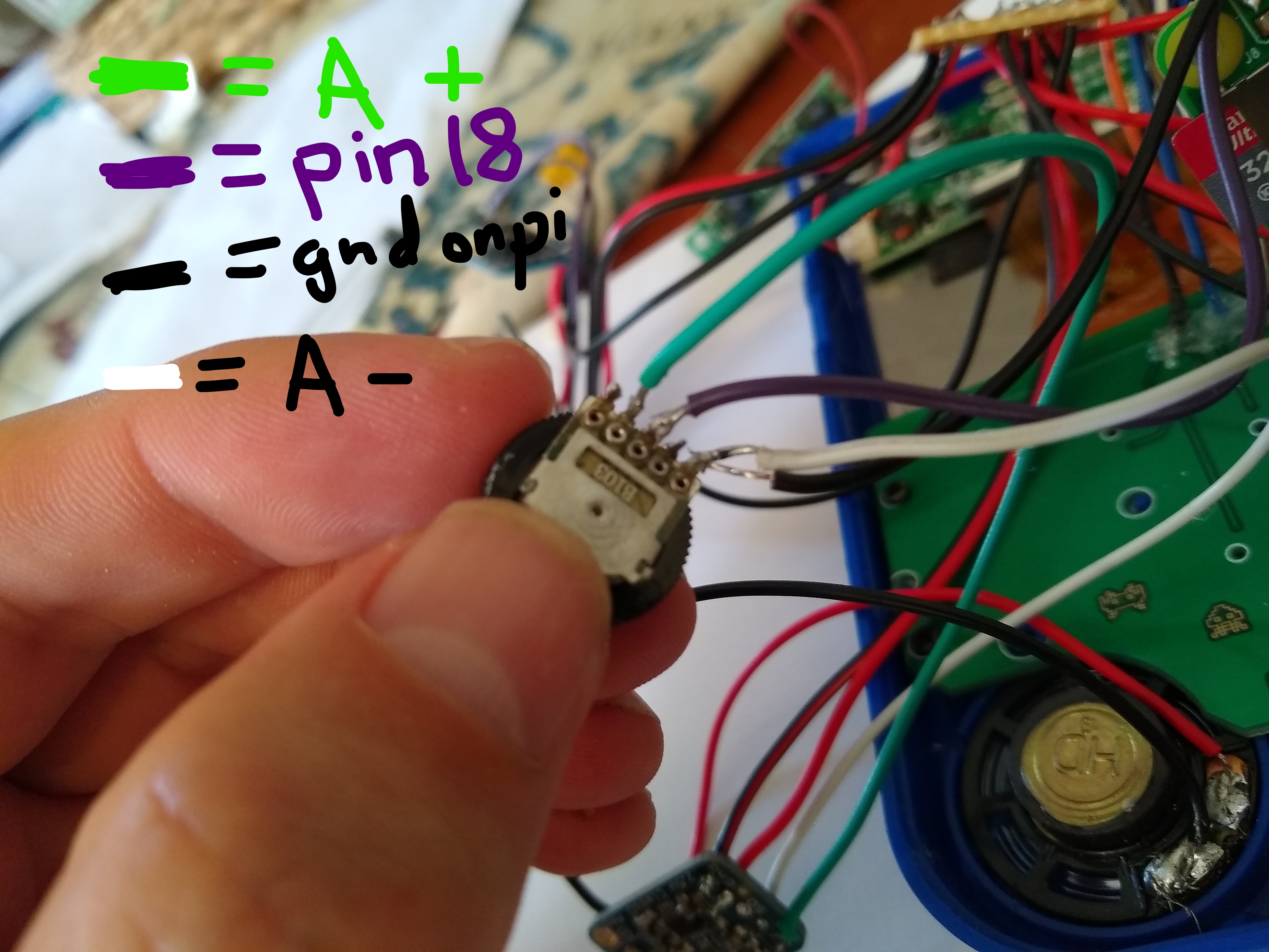

-Adafruit PAM8302a, 2.5W speaker, 10k ohm vol wheel pot, headphone jack, DIY low pass filter (following guides), NOT WORKING!!!
Audio circuit currently setup according to Rodocop (except headphone Jack) see images:
Have tried disconnecting/adding parts eg low pass filter, headphone jack, vol wheel. Also swapping different speaker.

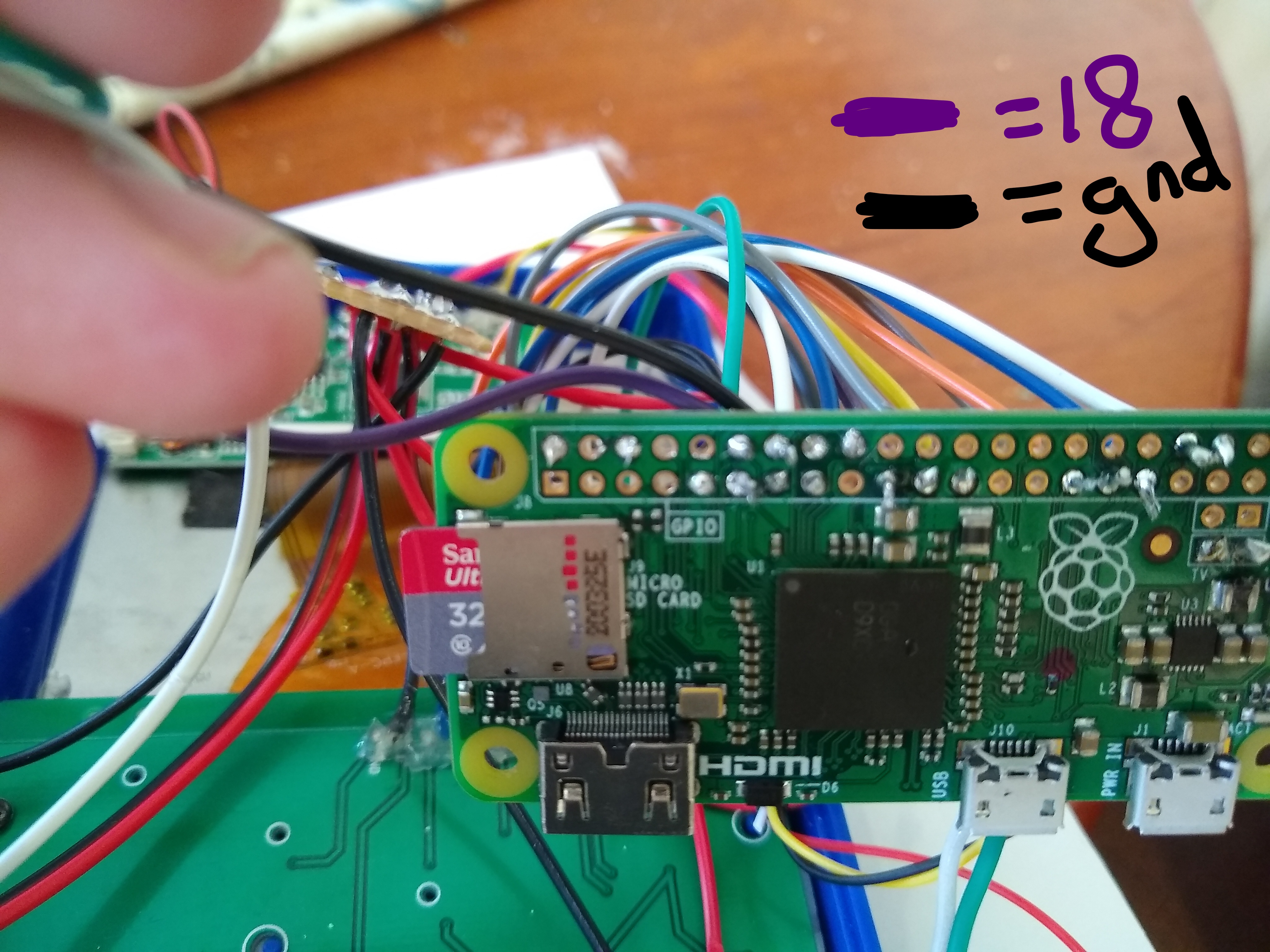

Currently on GPIO pin 18 (12th?)
Edited config:
Is it some software setting I'm missing? In emulationstation? Do I have a conflict with using Retrogame?

The amp has a small screw pot on it. Which can be used to adjust volume. Maybe that's it? Easiest solution.
As for retrogame. Check is gpio 18 is referenced in it at all...
You could also swap to gpio 13, which is also a pwm pin. You would need to change the config.txt line as well.

It's also been a long time since I've done a gbz...but one thing to try is to flip the wiring on the
volume wheel. (If that makes sense, flip it over and wire according to the diagram).
