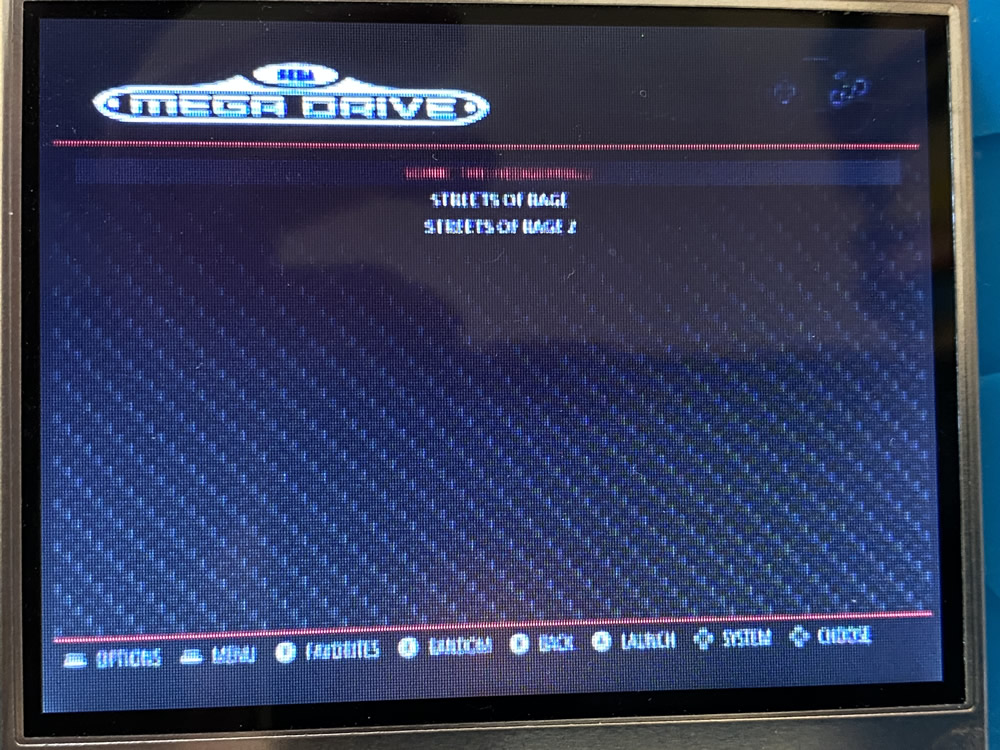

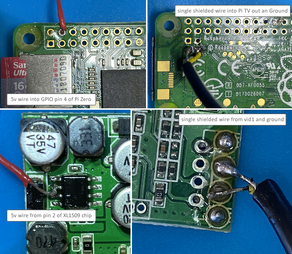

I have just wired up my BW composite screen (variant 7 I think) to my Pi Zero but the picture seems to be very blurry -
I have wiired the screen up using a shielded rca cable as suggested here - viewtopic.php?f=44&t=2850, but this doesn't seem to make any difference.
Is there a problem with my wiring, or is this the best I can expect from this type of screen?

Not going to lie. The quality of the composite screens by default isn't that great.
Download a new theme. The one I always used was gbz35 by rxbrad. It's optimized for these little 3.5" screens.

Post by hutch78uk » Fri Feb 25, 2022 10:16 am
Thanks Rodocop :)
I actually tried this before you replied, and by coincidence went for the same theme.
Verdict is that the improvement is slight but also effective.
