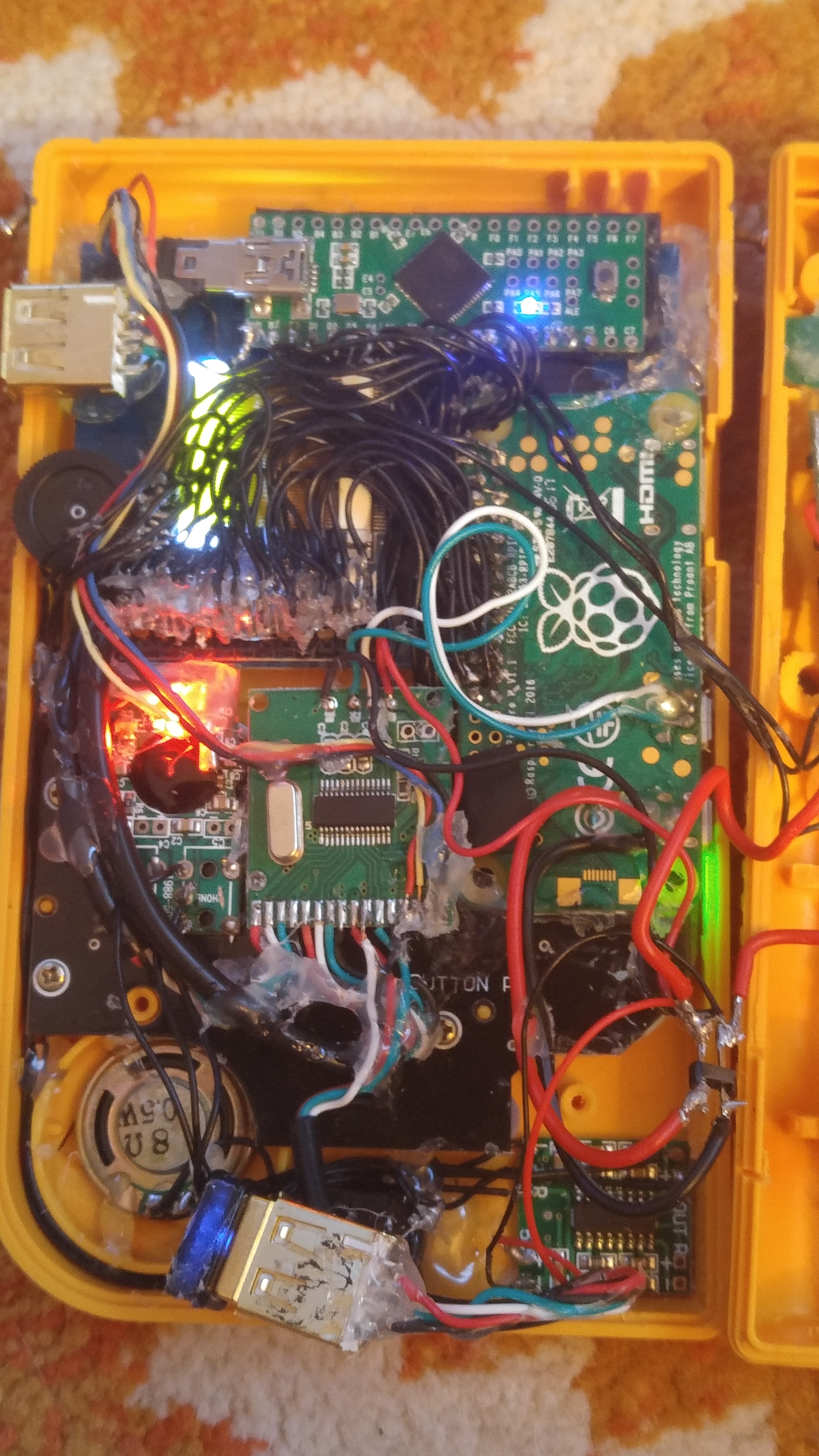

Hello, I recently completed my first GBZ. And though I'm pretty happy with the outcome, there is a little problem with the buttons.
I used a plain Button PCB with common ground thats wired up to a Teensy++. The buttons worked fine at first but now they often register one button press as multiple button presses. Especially in the retropie menu, when you select emulators and roms, one press to the left or right, often skipps two or more menu selections. The weird part about this is that when I clean the contacts for the buttons on the PCB with alcohol, they work fine again for a small period of time.
I realy hope you guys can help me out with my problem. Much thanks in advance :D
In case it could help, here is the code I uploaded to the teensy. I found this code on this forum:

As for your problem, make sure you have a good solid connection between the teensy and your button PCB. Also use some isopropyl alcohol to clean off the traces on your button PCB.

@wermy I checked the connection to the teensy with my computer and it seems to be fine.
could it be some issue with the ground? I got this feeling like the PCB is kind of 'storing' the connection between the ground and the individuel buttons.
