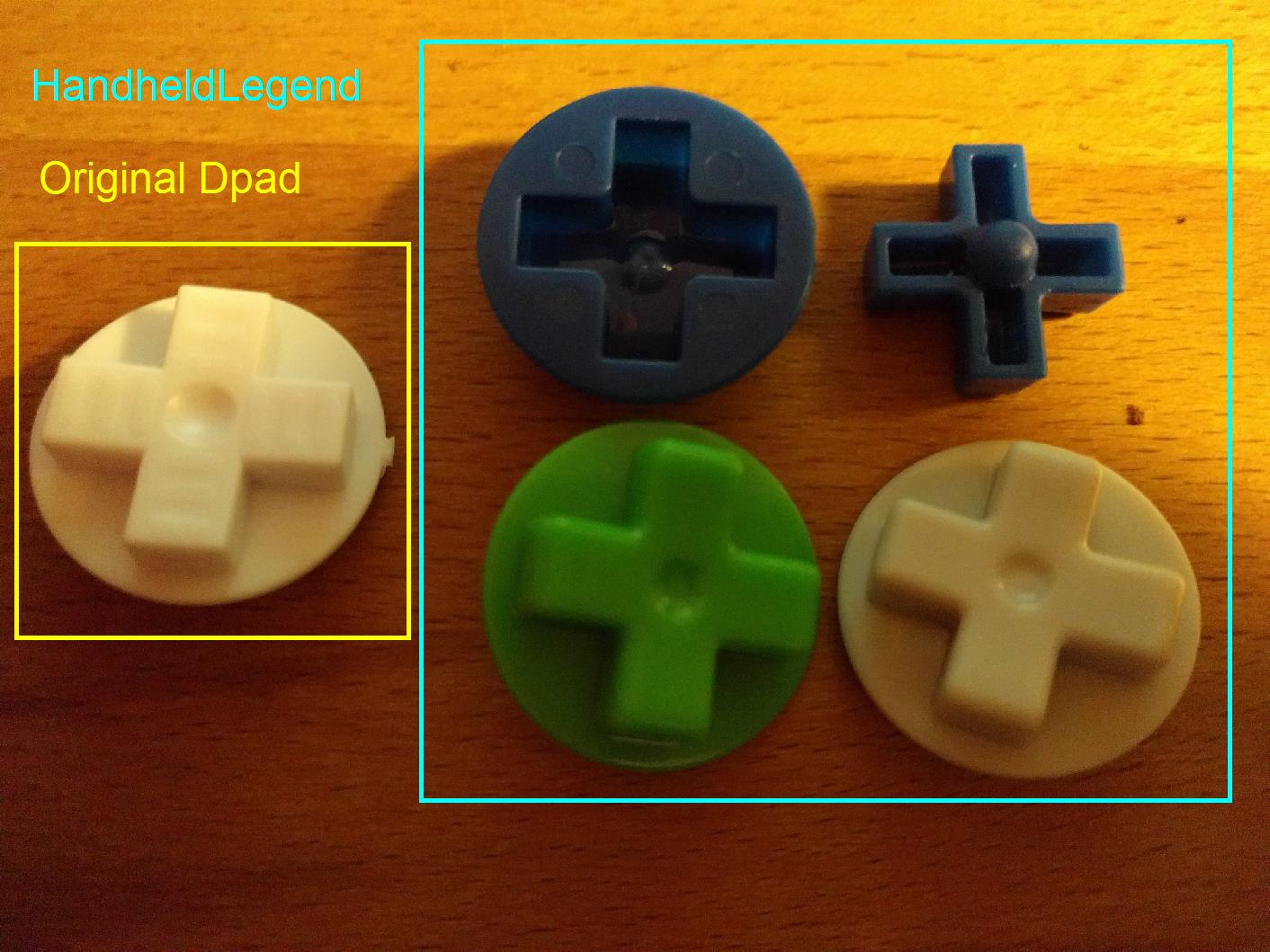

The dpad is in 2 parts, outer and inner, and I think you could just stuff something inside before putting the inner part in which would solve the problem. Here's a picture of the dpads:
You dont happen to be located in germany? If so, I could send you a blue, green or grey dpad from HHL (see pictures).

Im in California, but I appreciate the offer. I'll open her up and see if maybe I can stick my original GB dpad in there or try the glue trick. I don't think I'll need the guide unless it mentions anything interesting about tinkering with the brightness of the screen. lol thank anyway
