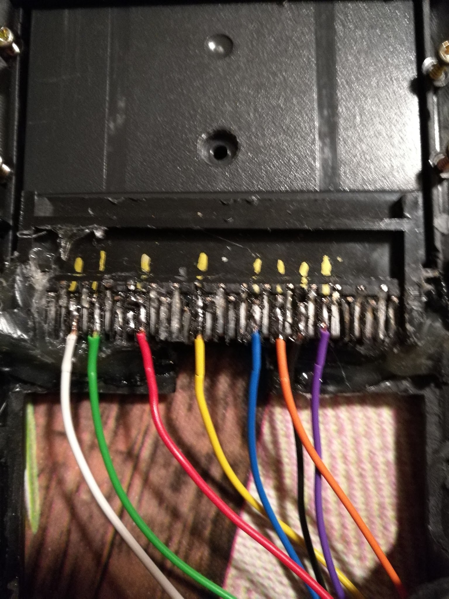

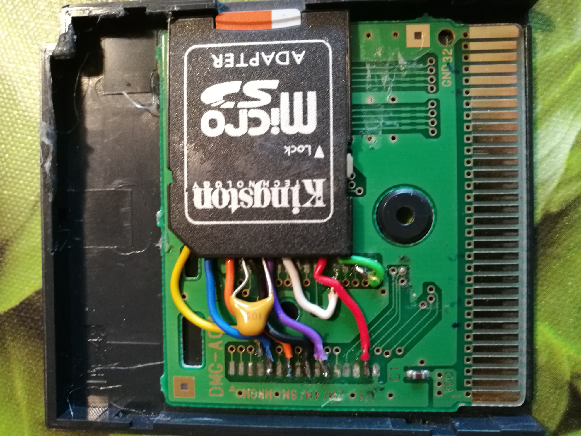

Need photos of your wiring.

Tricky picking through the wiring.
But with the cart mounted I have continuity from the wire/Pi solder pads and the pins on the SD card adapter

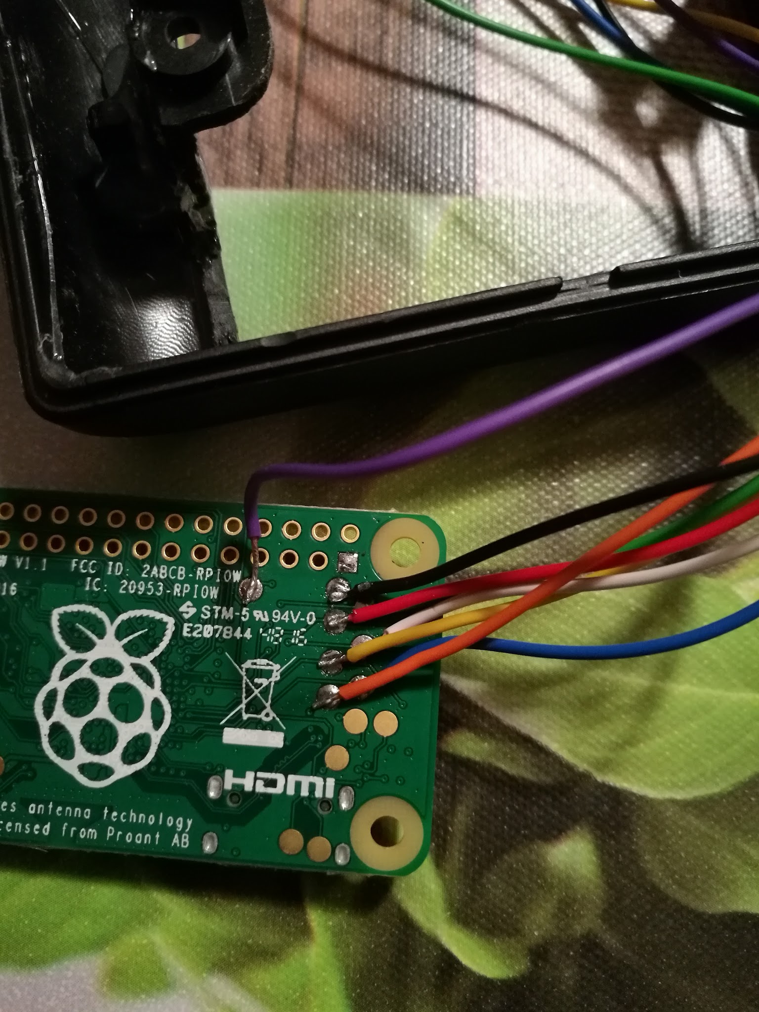

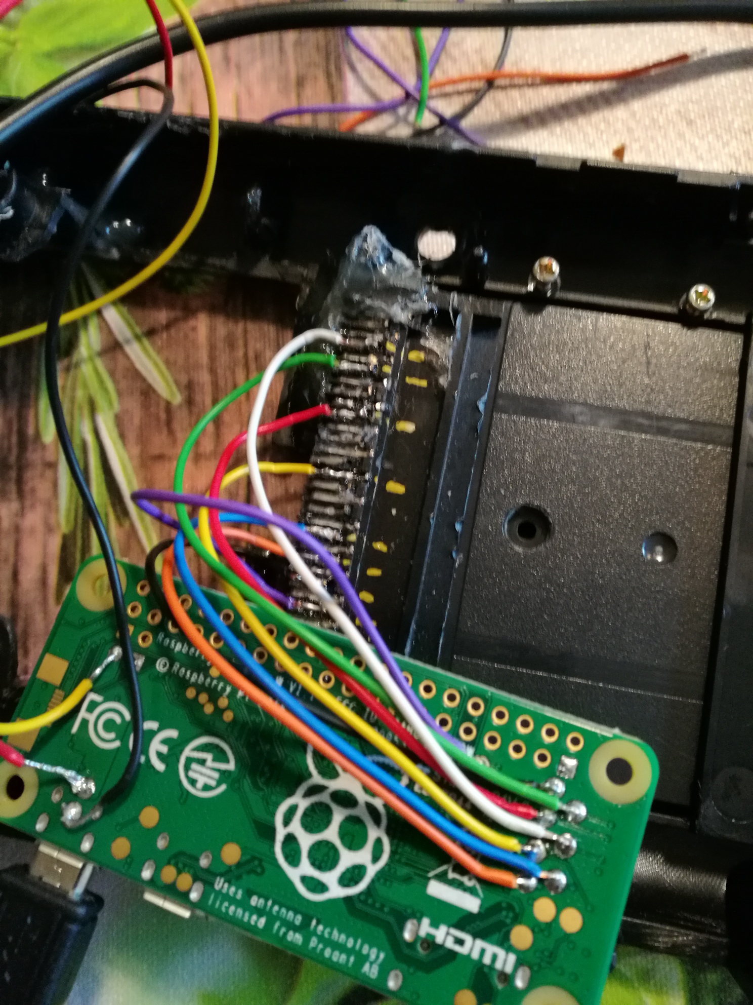

OK. I have shortened the wiring. I have checked layout (Its all matching colours now) and continuity is good from the adapter to the pi zero.
I have shielded the wires with foil and still nothing.
The only thing i can think is a dodgy adapter? But it worked in my laptop...
I am getting prepared to cut my losses on this and move on (I have spent ages on it already).

Hummmm. Looks good to me, cables are short, you even added the filtering...
did you test the sd card on another pi ?
did you test another sd card ?
is your pi booting when this sd card is inserted into its own port ?
