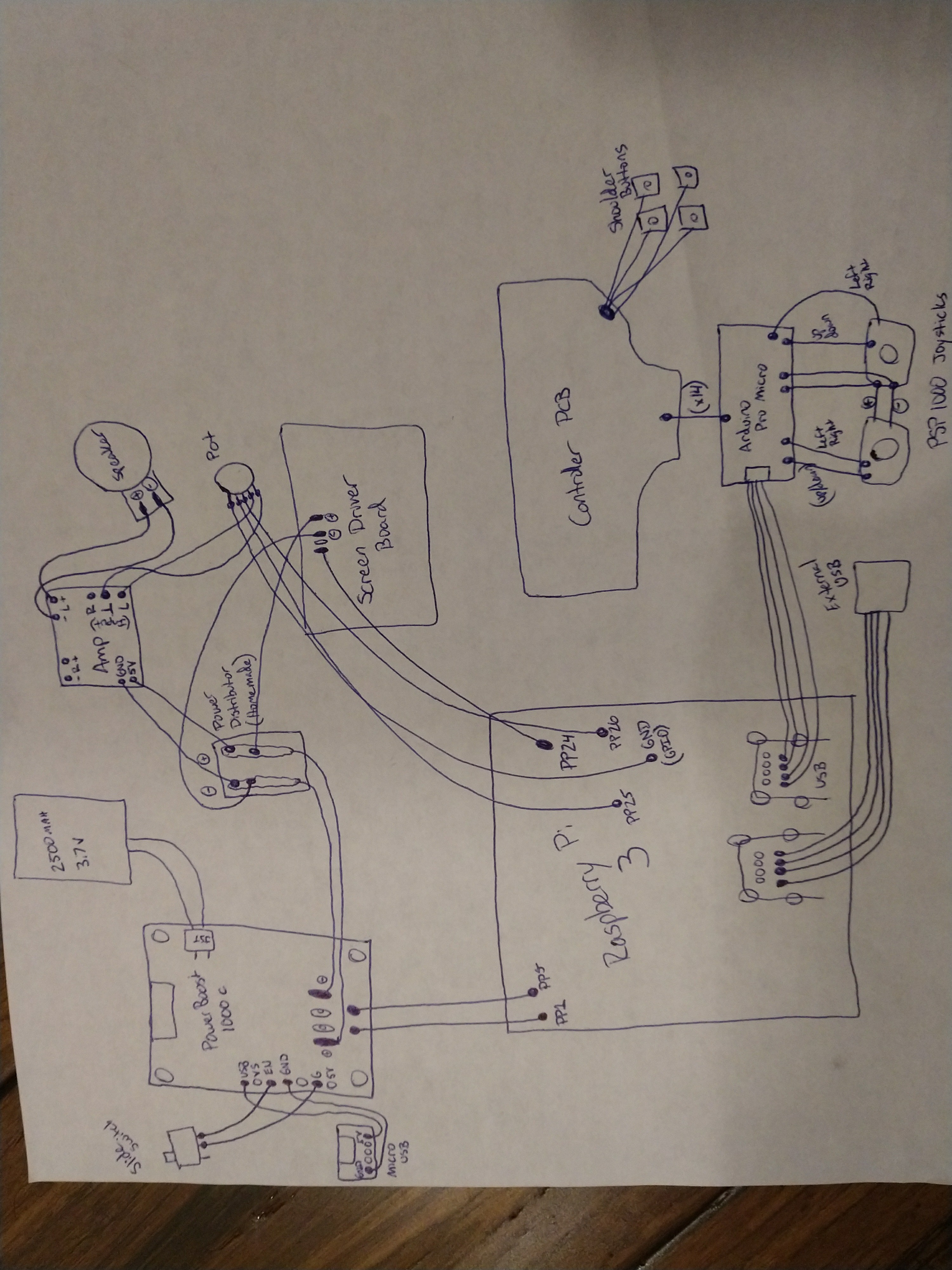

I know this is not an answer to your problem but I was wondering if you have a wiring diagram for your pi3 build? I am having a trouble wiring everything on mine. Also which powerboost are you using maybe I can try and help.

its hand draw, hopefully you guys can understand it.

Post by firestw152 » Tue Oct 03, 2017 4:21 pm
Kenshin16 wrote:
Tue Oct 03, 2017 4:09 pm

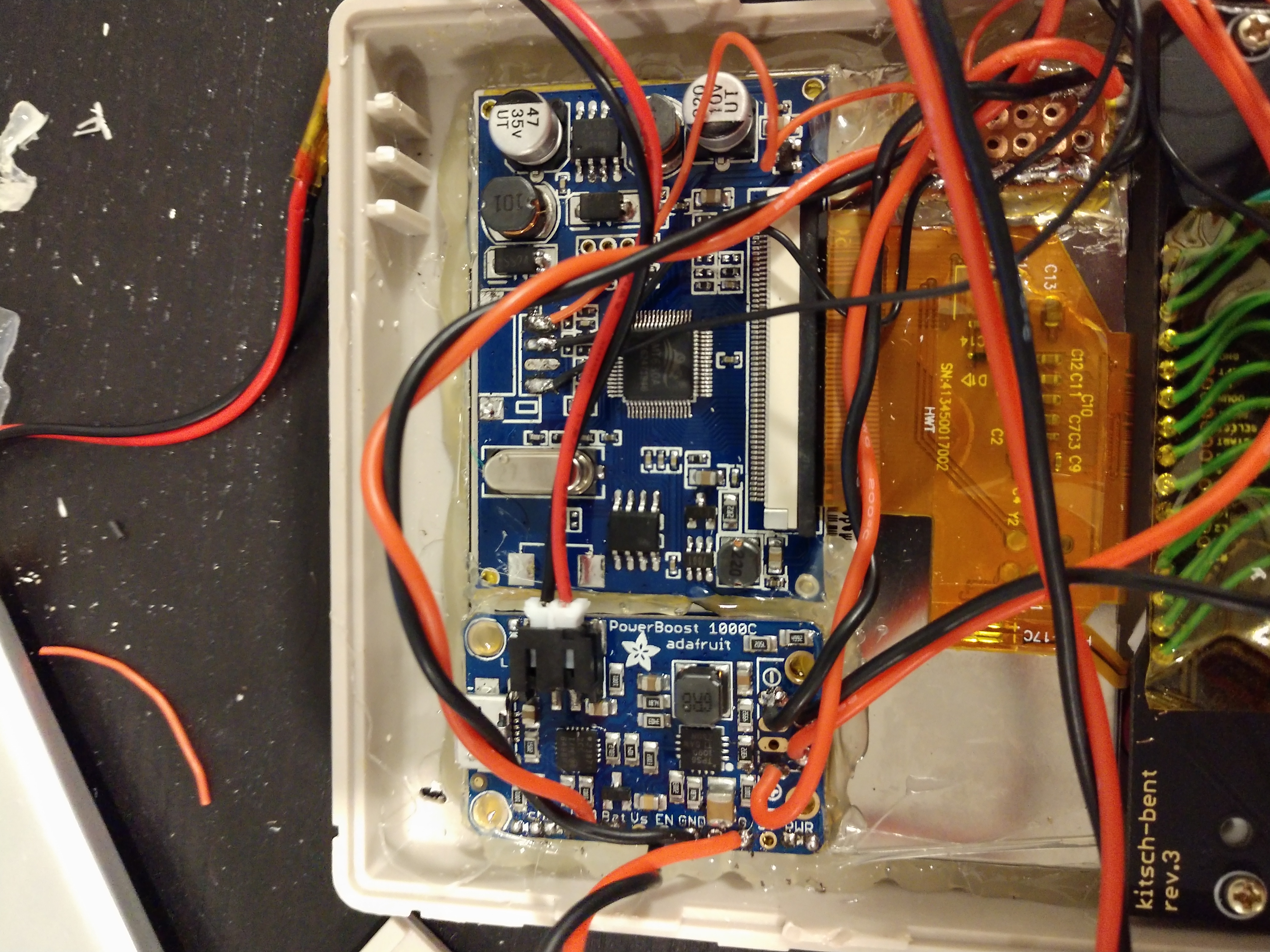

how hot does your powerboost get? I had a problem that the 2 bottom leads on the power boost that is powering up the pi was not giving it enough power but when I moved it up to where you have the power strip connected the problem stopped.

So you're say just switch the pi power leads with the leads of the power distributor?

Post by firestw152 » Tue Oct 03, 2017 5:23 pm
Kenshin16 wrote:
Tue Oct 03, 2017 4:53 pm
yes that worked for me and it also brought down the temperature of my powerboost. Can't guarantee that it will fix the problem but can't hurt to try.
Also what gauge wire are you using?

I'm using 30 gauge wire for the buttons and 26 gauge for anything carrying power. And i did what you suggested, switching the leads, and so far it seems A-OK. haha. I haven't seen the voltage bolt in the corner. SWEET!!!
