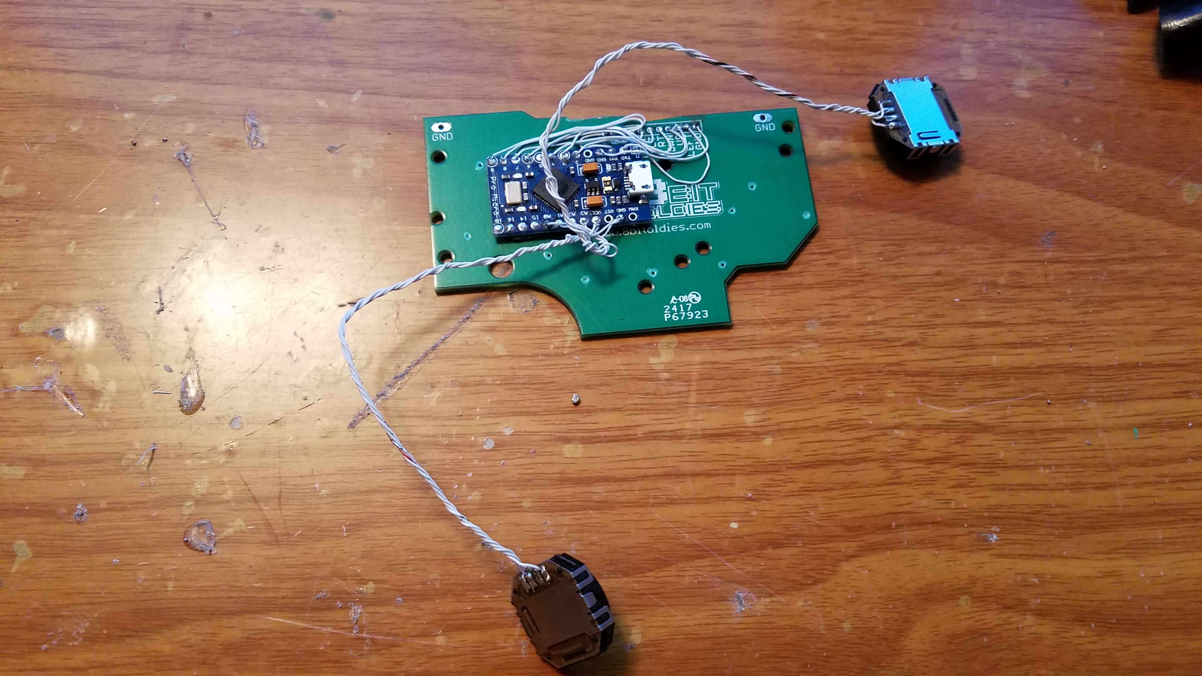

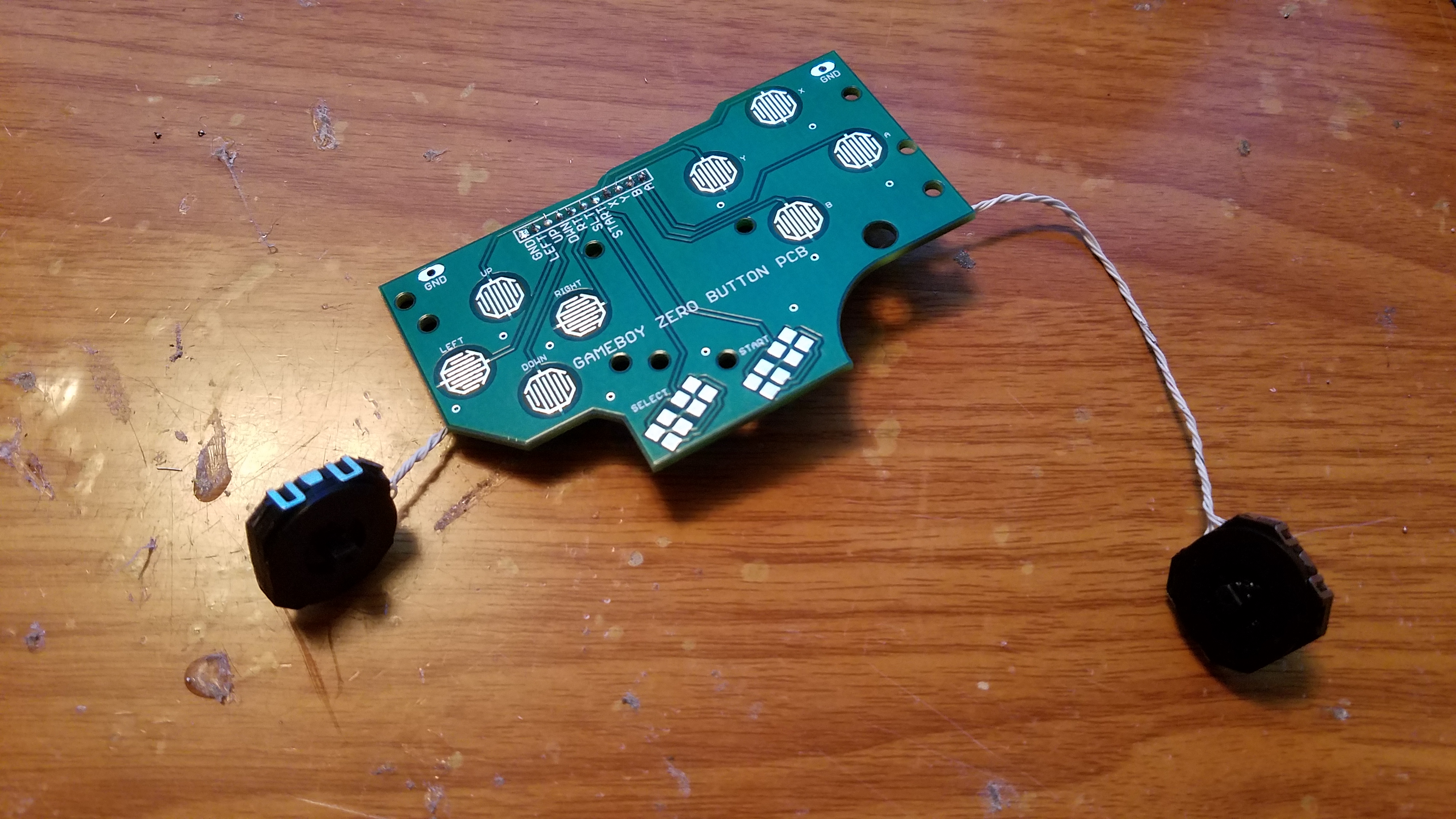

Whats up guys im having probelms with my gamepad the buttons skip when i press it or one click presses multiple times say i click to the left it will countinue to go to the left .. even a gentle press .. or when i click A to enter a game system it will double click and enter the first game in the list .. im using Leonardo Pro Micro ATmega32U4 and a simple 10 button pcb
Also two psp analog sticks
I followed this guide
http://www.sudomod.com/forum/viewtopic.php?f=22&t=1766

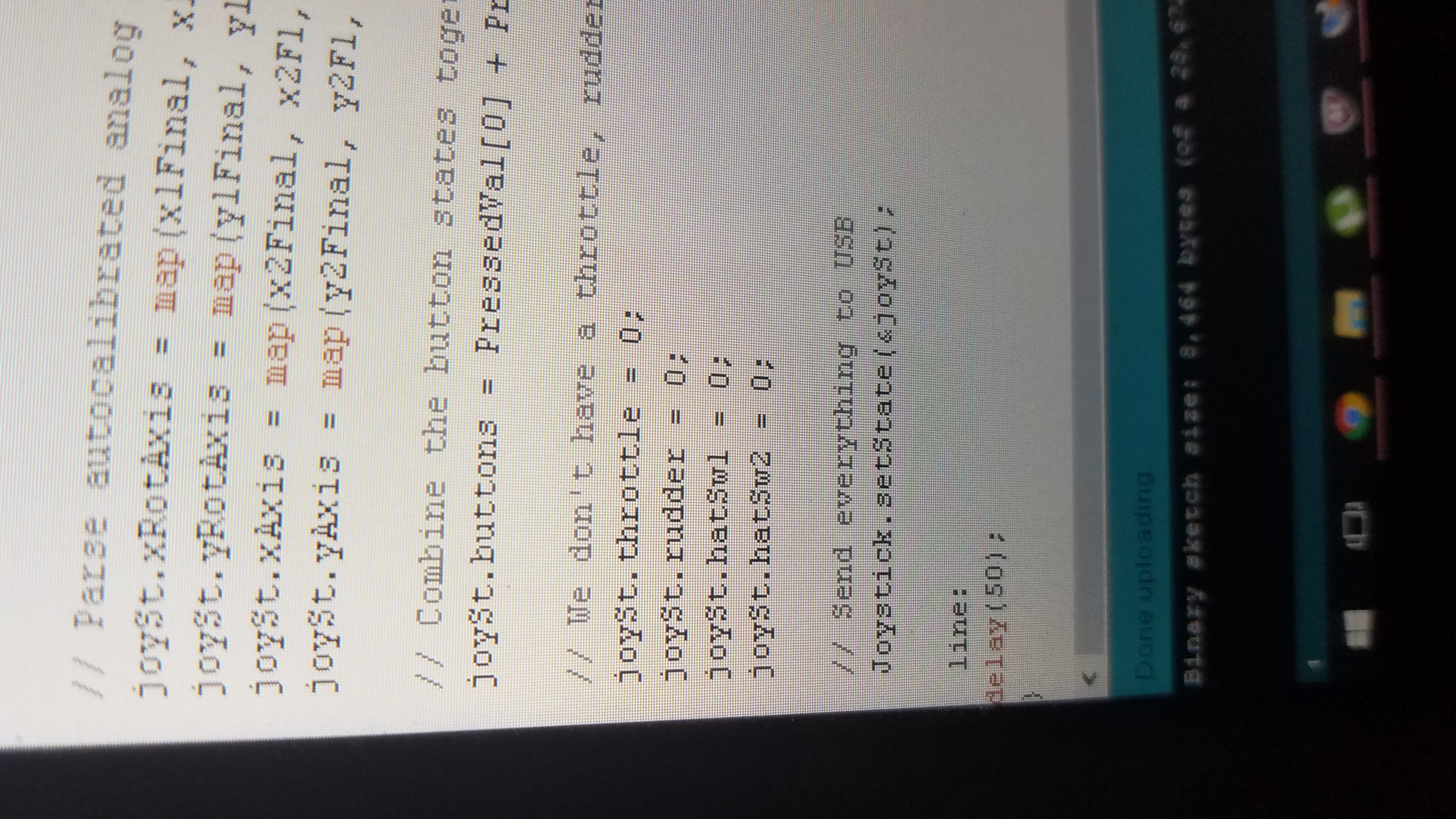

At first buttons were working great when i didnt use them with analog sticks .. then after a while i start led getting trouble with them in games they work just fine maybe theres away to add a small pause between clicks when in emulation station.
Ive used didnt leonardo chips and 3 different gamepad pcb and no luck .. thought it mike be the wire so i changed it for a bigger gauge and still same issue... please help .. ive only see one other person in the forms with this issue
Current build .. raspberry pi zero .. 14 buttons hdmi screen, 3 usb ports

For anyone who finds this page .. this issue has been fixed thanks to a extra line added to the code
From @salami738
Here is the original post
http://www.sudomod.com/forum/viewtopic. ... 270#p46591
