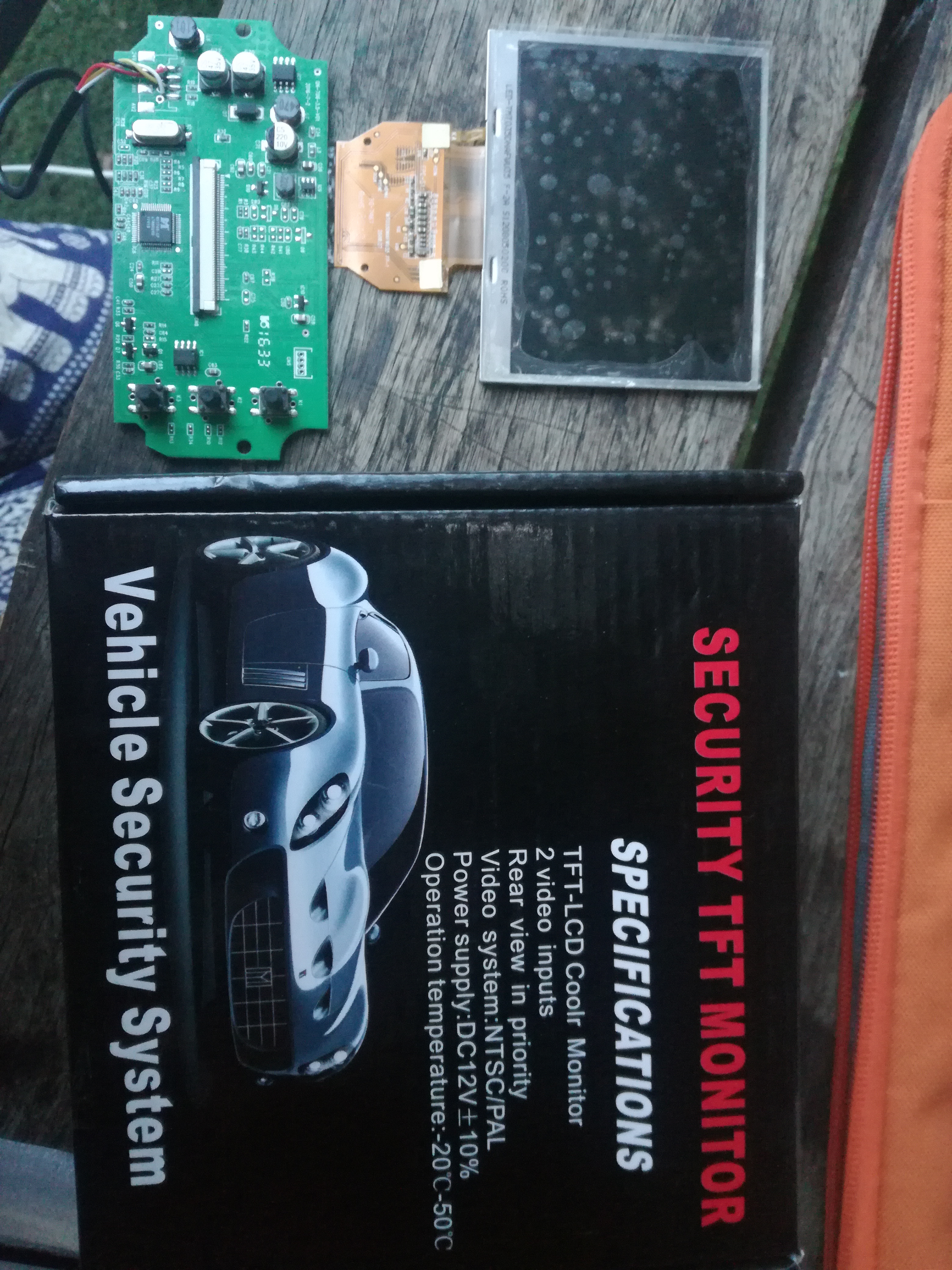

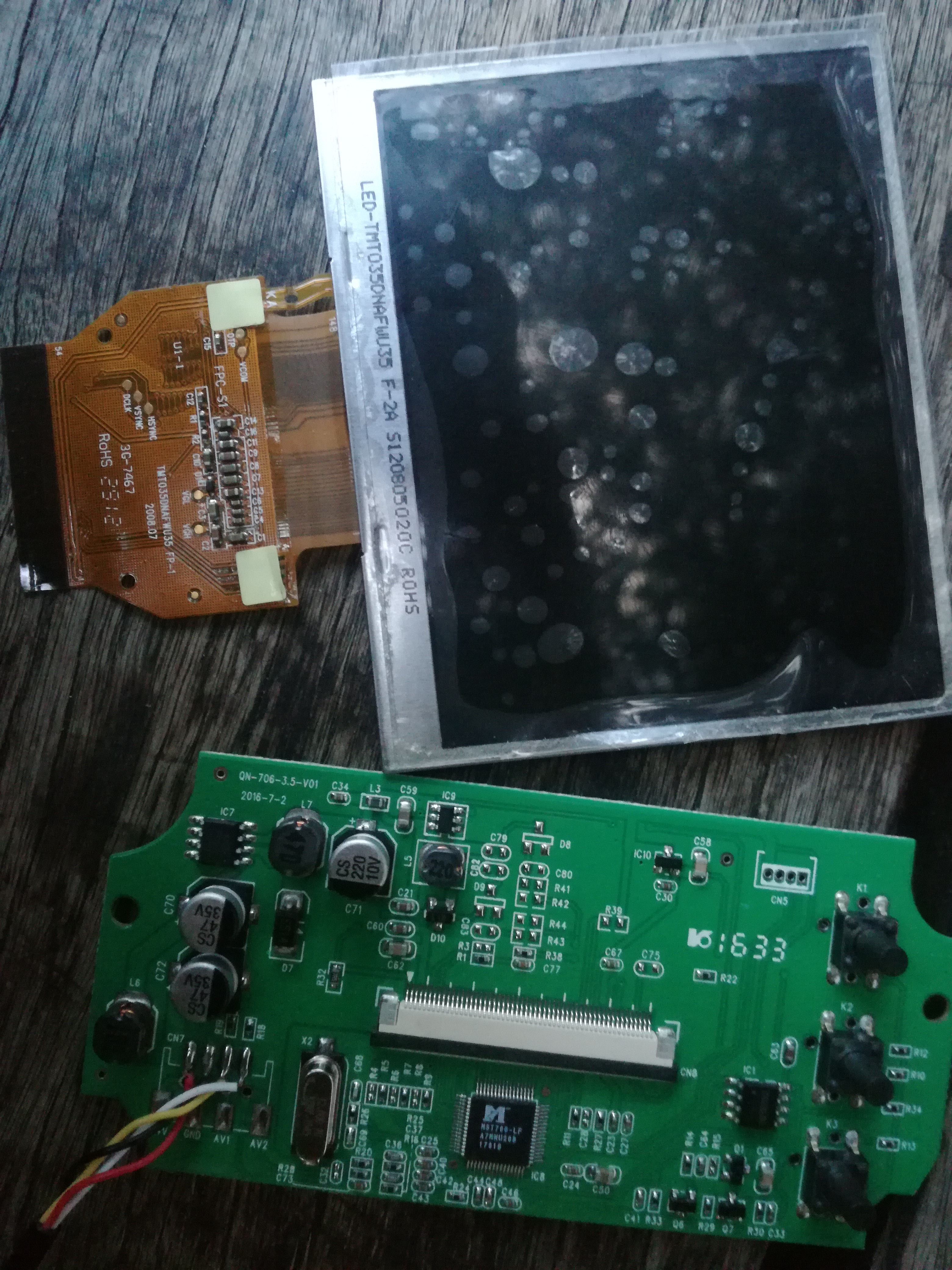

Anyone seen that screen/ board before?
It says it needs 12 Volt, so should i connect the power to the same piece as they do on the BW screen (the 4 leg both side with that small dot in one corner. which i got 2 on my board, which i think is the regulator)?
Can i cut of the buttonpart from the board cause otherwhise it won't fit in my case if I dont hurt any other connection that doesn't belong to the buttons?
And don't give me anwsers like "get that screen cause we know it works" I'm in Australia and I'm lucky i got my hands on that one.
Cheers guys.

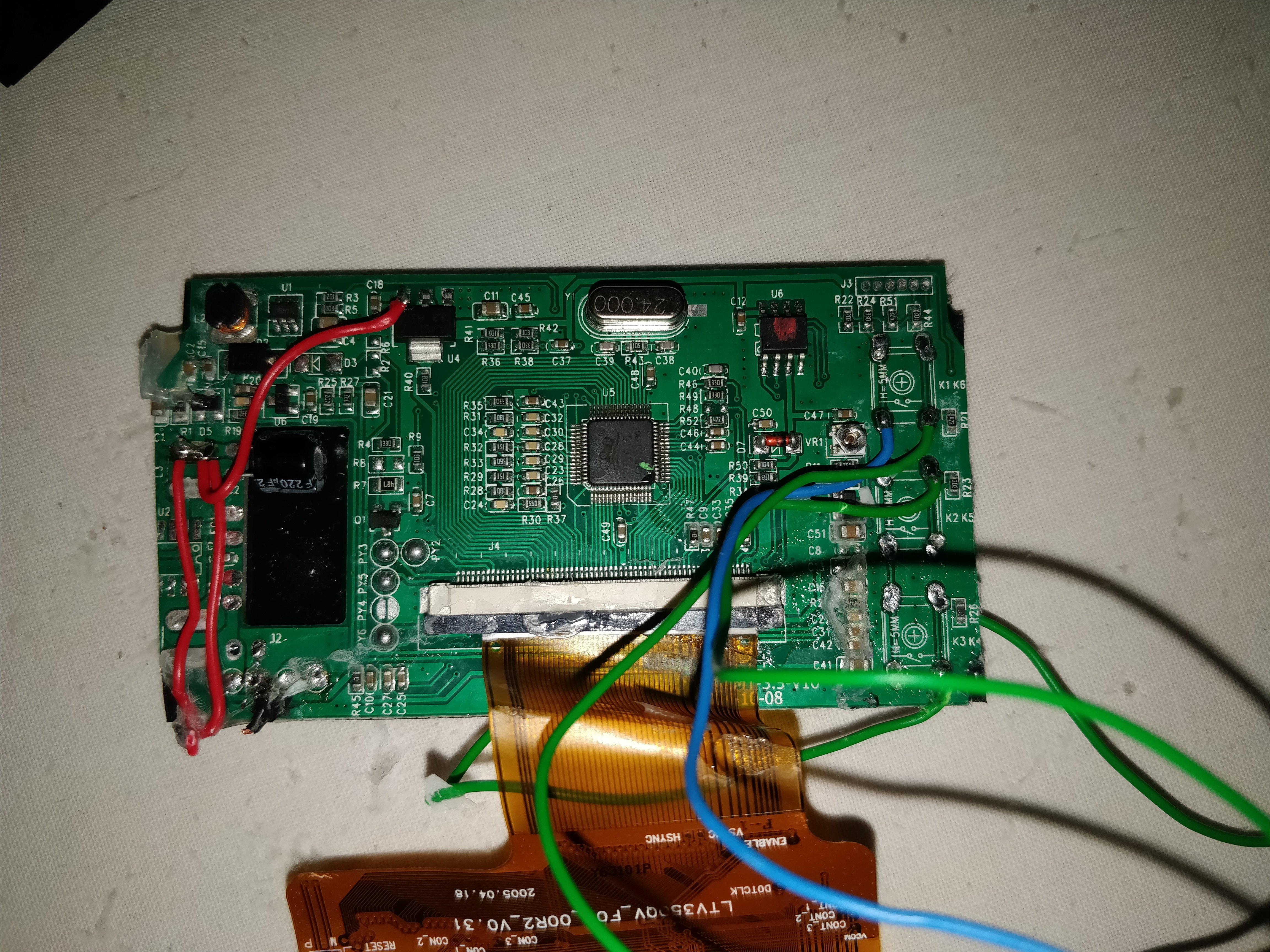

I had a very simelar board. Quite long so I had to cut left and right side. The right hand side buttons where extended into the battery bay. On the left side after removal of all the not need 5V conversation parts I had to do some bridges due to lost connections after cutting.
On top my panel draws a lot of power and went warm. It draws something like 400mA. Finally I replaced it to the KEDEI HDMI screen.
