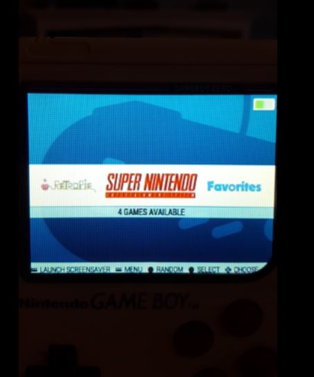

Here's a picture from Rodocop who's recently set this up himself and introduced a battery monitor, too 8-)
Re: mintyPi image for GBZ
Post by rodocop » Sat Nov 18, 2017 10:56 am
Thanks for the shout out! Good info.
I tweaked my over scan a bit more and got an even better picture size I believe.
