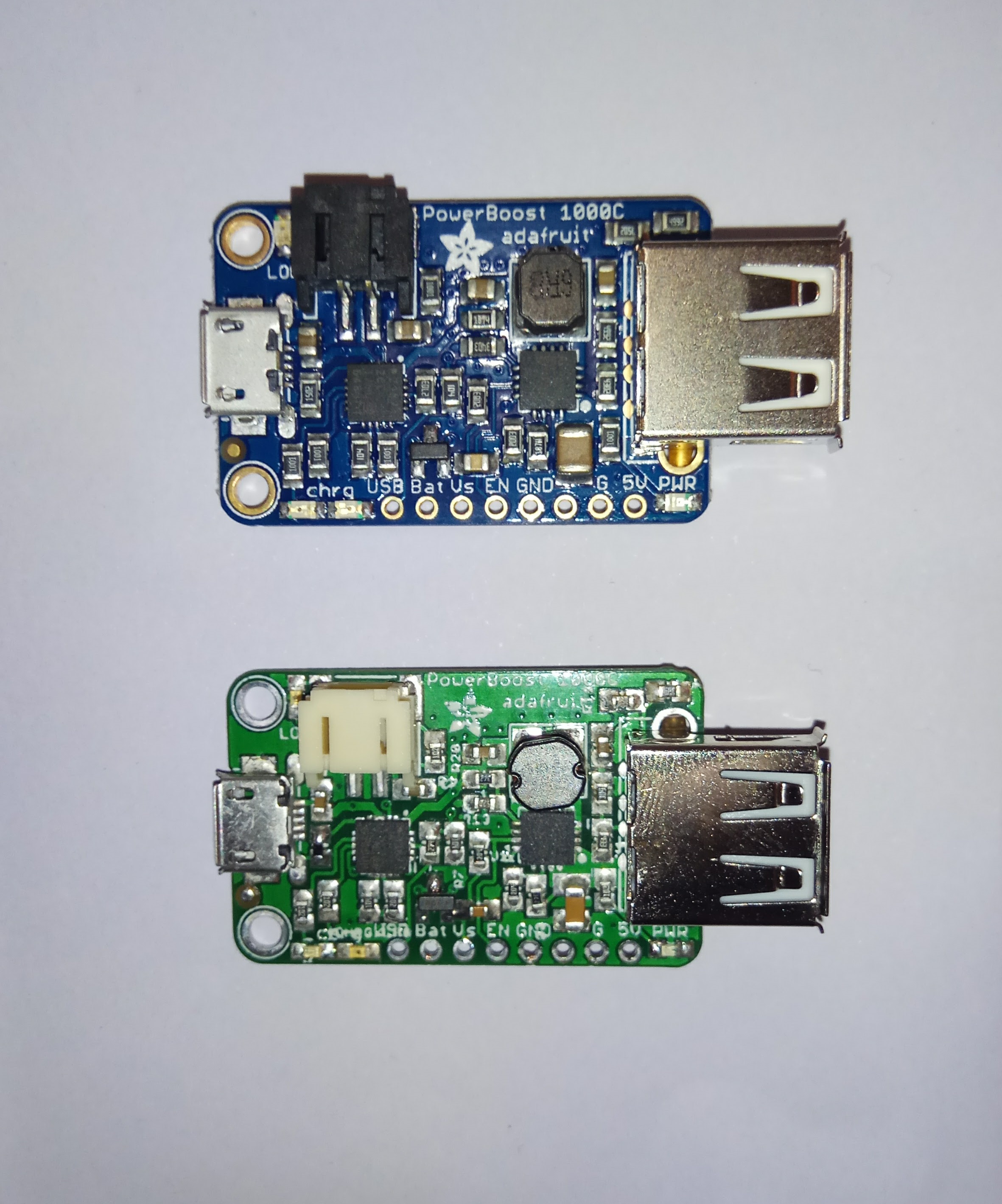

On a whim I tried sourcing a boost converter/lipo charger on Alibaba. I pointed a PCBA manufacturer to the PowerBoost 1000C page and asked if it was possible to have something similar. They assured me it was possible and quoted a price of $6 per PCB sample. After paying for the order and waiting a few weeks I received this nearly one to one clone of the board.

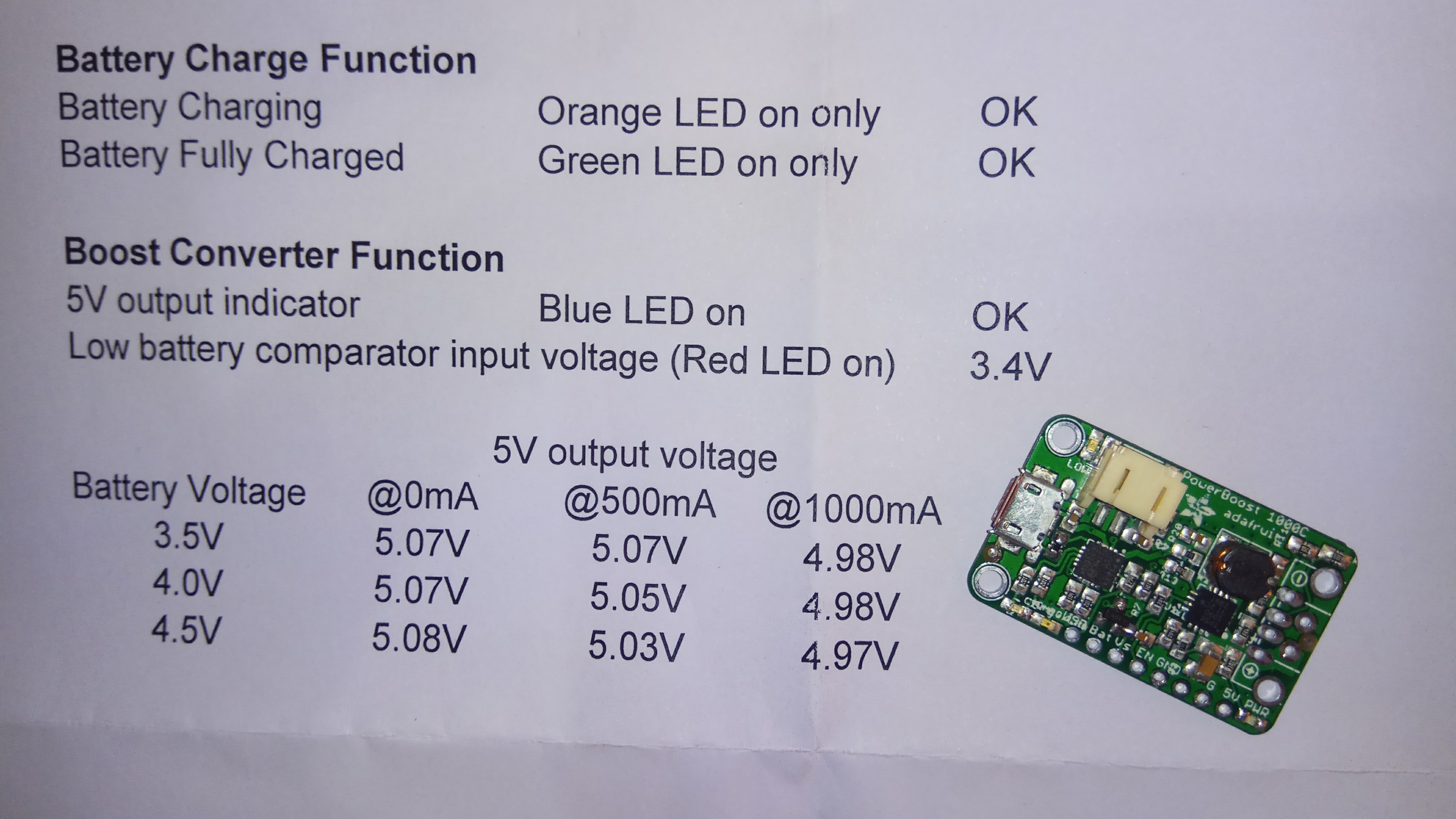

The board came with a test report for the charge and boost function. Based on this report, would it be suitable for a GBZ build? Also, before I use it, how do I verify these results for myself, and how do I check for the smart load-sharing function?
Thanks.

And please - for your own safety - double check that the clone stops the lipo charging at 4,2V.
LiPos and LiIon batteries react extreme to overcharging!
You dont want your house to be burned down for 6$.
One differenct to the adafruit one is the output voltage. Adafruit says on the page that they use 5,2V output voltage to stabilize the output. This one has a slightly lower output voltage. Shouldnt be a problem.
Re: Testing PowerBoost 1000C clone before use
Post by YaYa » Wed Dec 06, 2017 3:08 pm
Could be a problem with big sudden current draws that will drop voltage... better to throw some head room !
