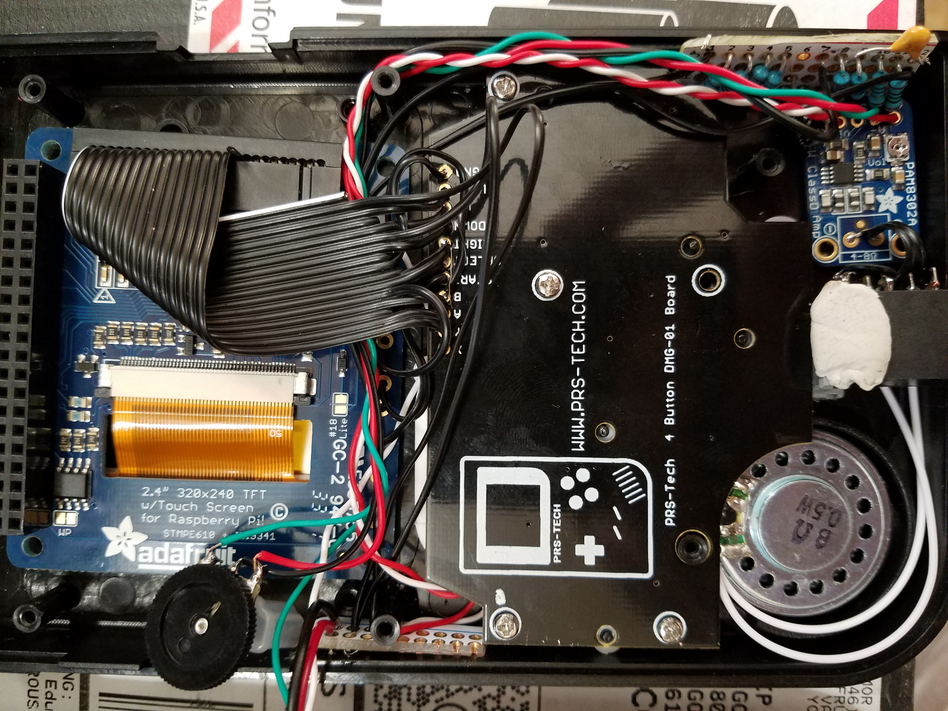

Good morning all, I've been following along for a good bit and made a rough GBZ a few years ago but it didn't look as good as i would want and i analog controlled the inputs. it was a gift for my wife and now i am re doing it but I am having some issues with my planned route on how i would like to do the wiring.
When i did it before the Pi zero interfaced with an Adafruit 2.4"TFT and the 26 pin ribbon coming off of the TFT connected to the buttons and power supply. I feel this cleans up the wiring some and make it fit better in the space.
the question is if i am in the correct place to change the pin/GPIO so that i can reallocate them to the new layout on the common ground PCB?

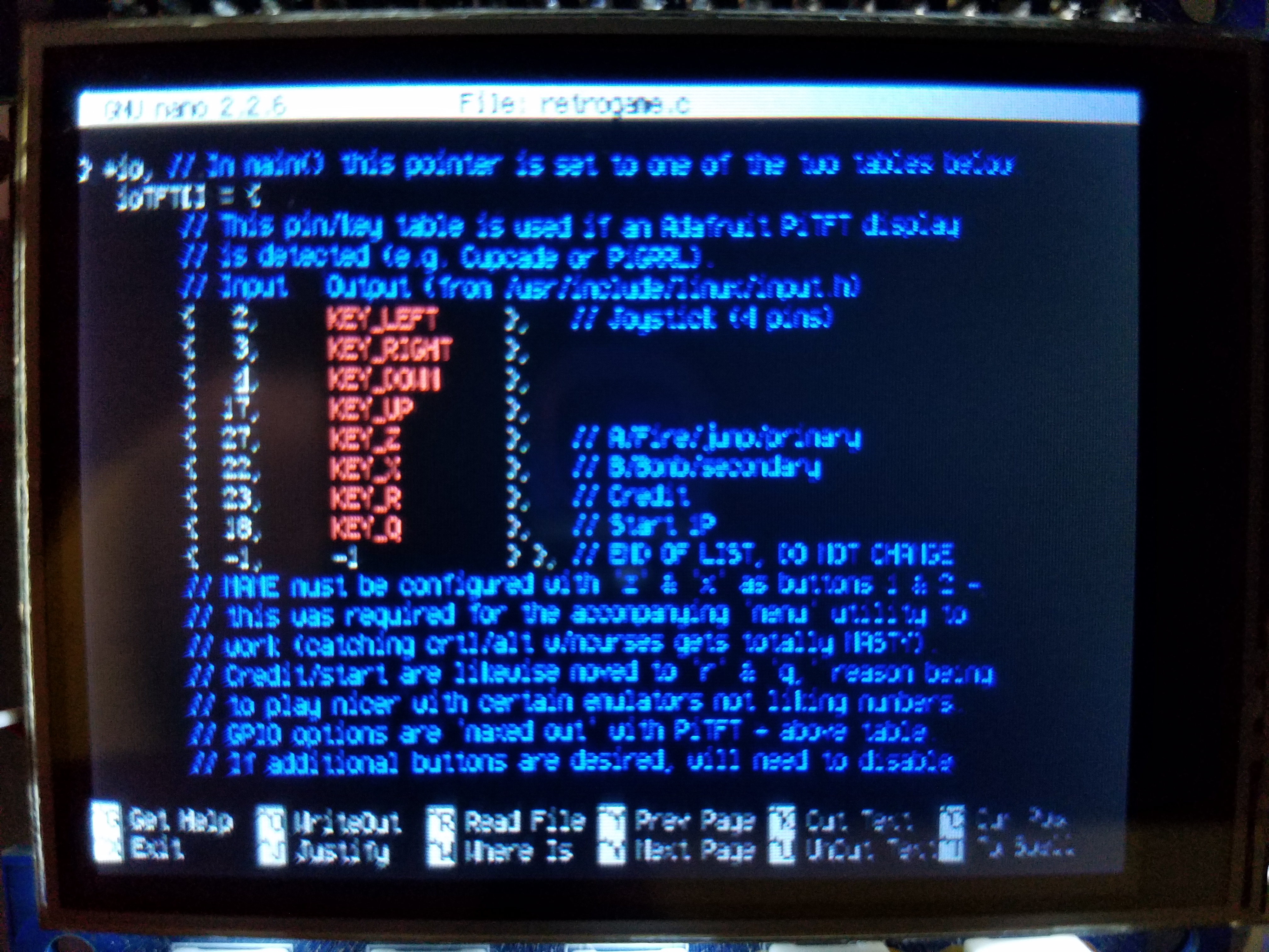

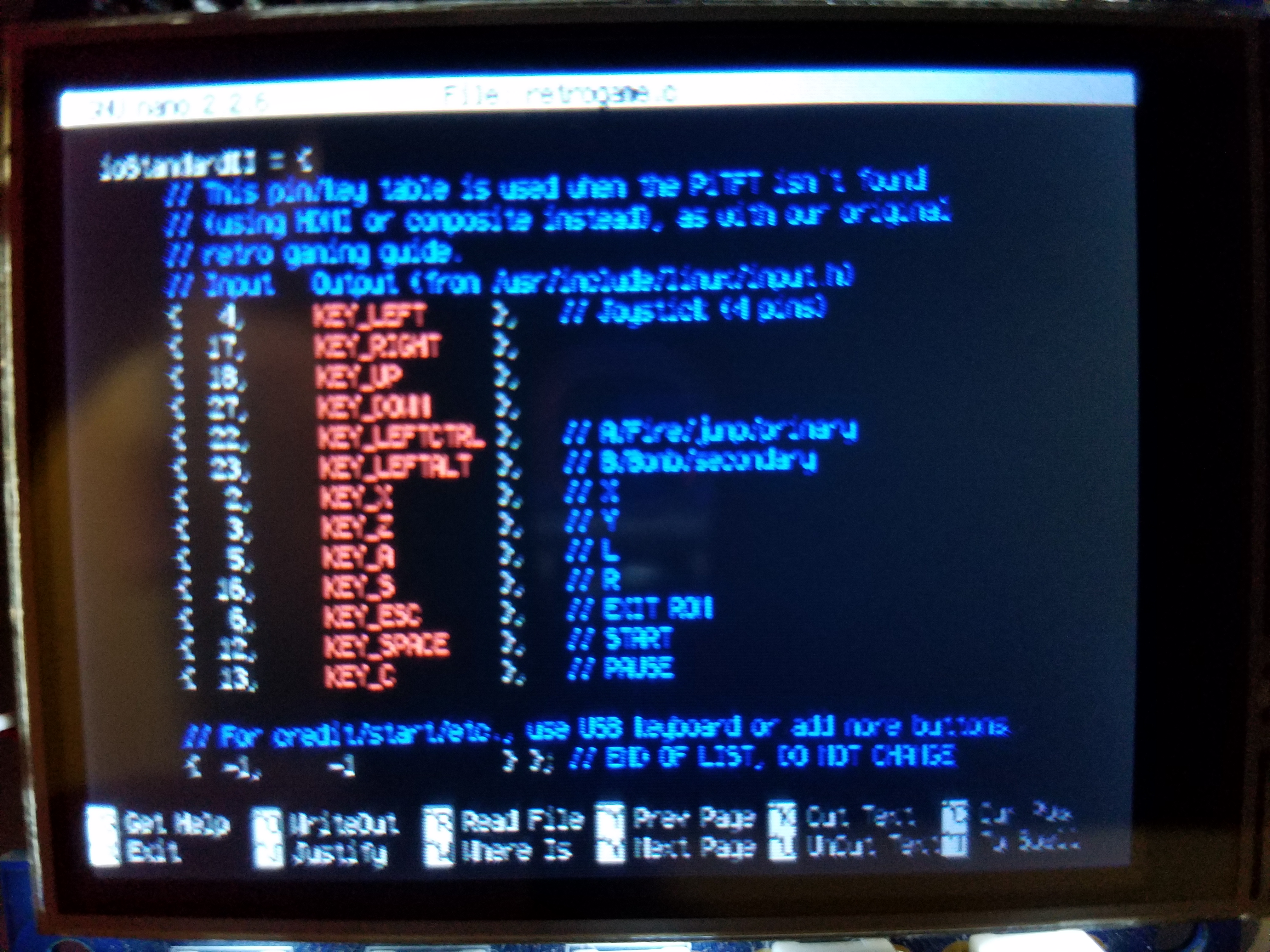

this is how it looks, I have gone in and changed the files to align with the pins as it indicates but it appears that there is something i am missing to get the reassigned GPIO to work.

So you have edited the retrogame.c file to the gpio pins you used? (use the gpio number not the physical pin number).

I think i read the code at face value and did it per pin instead of per GPIO designation, I'll use the chart you provided and recode it to the GPIO number instead of the physical pin.

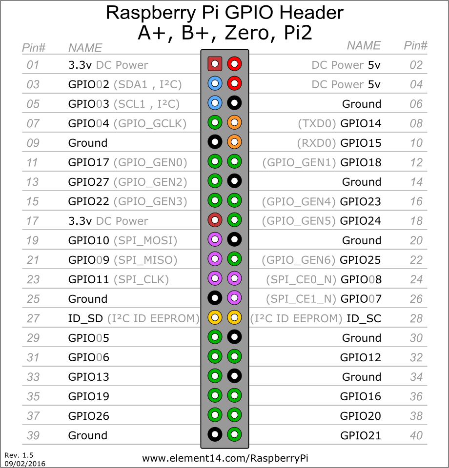

in the diagram above, make sure you do not use any of the purple ones for the controls, those are meant to be used for the screen. Maybe that would cause issues if you have one mapped to a control as well? Use the green ones only for controls.

Okay. So my next thing is to make sure that those black wires are actually connected to the proper gpio pins on the screen driver board and that they correspond the gpios you are mapping on the pi.
I've never used a screen like that, so maybe it uses more gpios than I'm thinking.
Can't really think of anything else to get it to work.
If audio isn't working make sure you have not mapped the pwm pins for controls. If you have followed prs's guide then you shouldn't have.
You have the pwm audio all wired up? And you added the proper line to the config.txt?
Worst case wire everything to the pi, and skip the screen. Use an HDMI screen to test, and if it works that way there is something with the screen board that is not allowing you to pass through controls.
