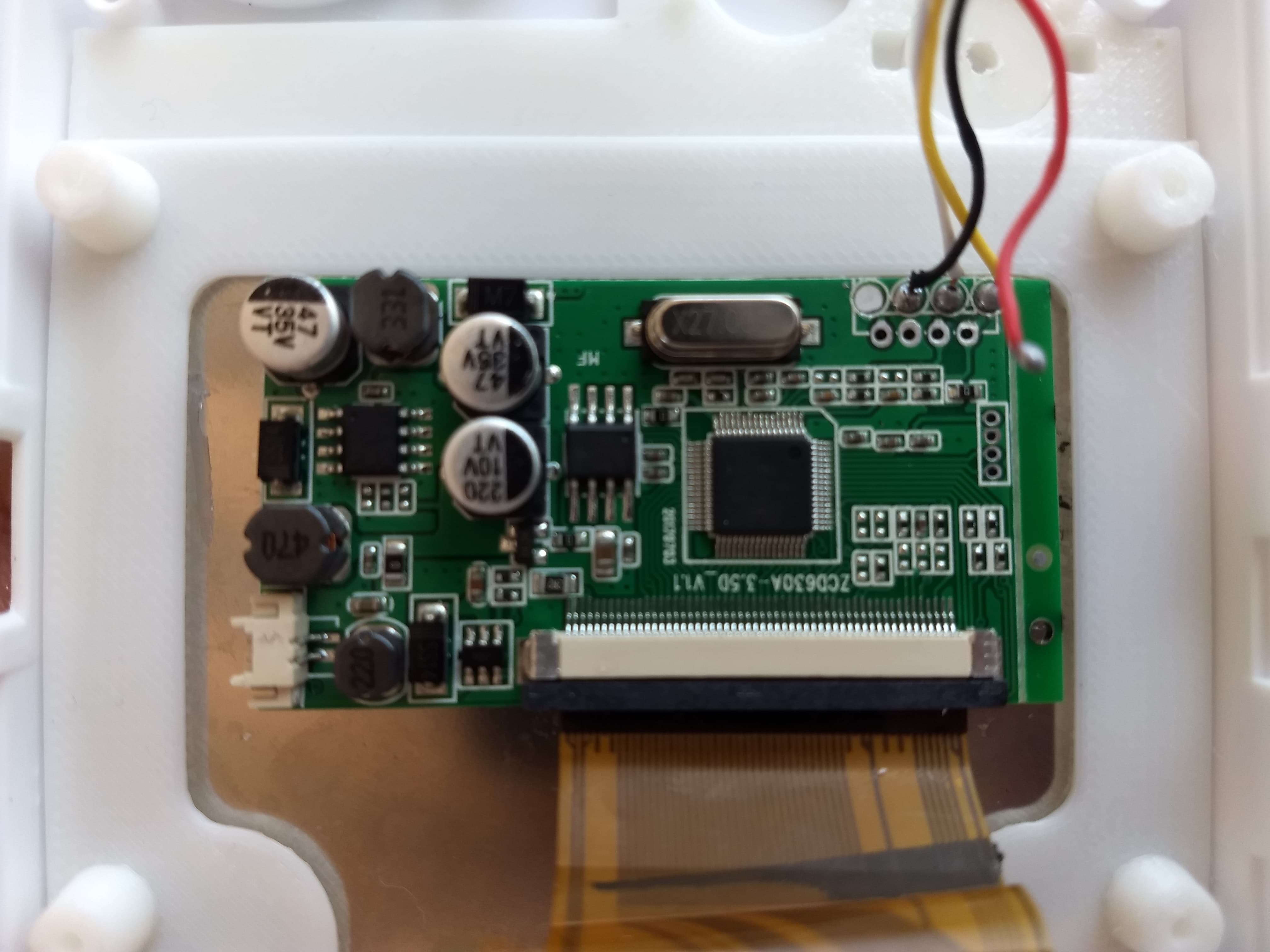

Hello,
Let's go for the production of my GameBoy Zero. On this post I found my driver edit but the photos are no longer available. I sent an email to CerbereOrion I wait for the answer. I post a photo of my driver if you have the solution ...
Thank you
