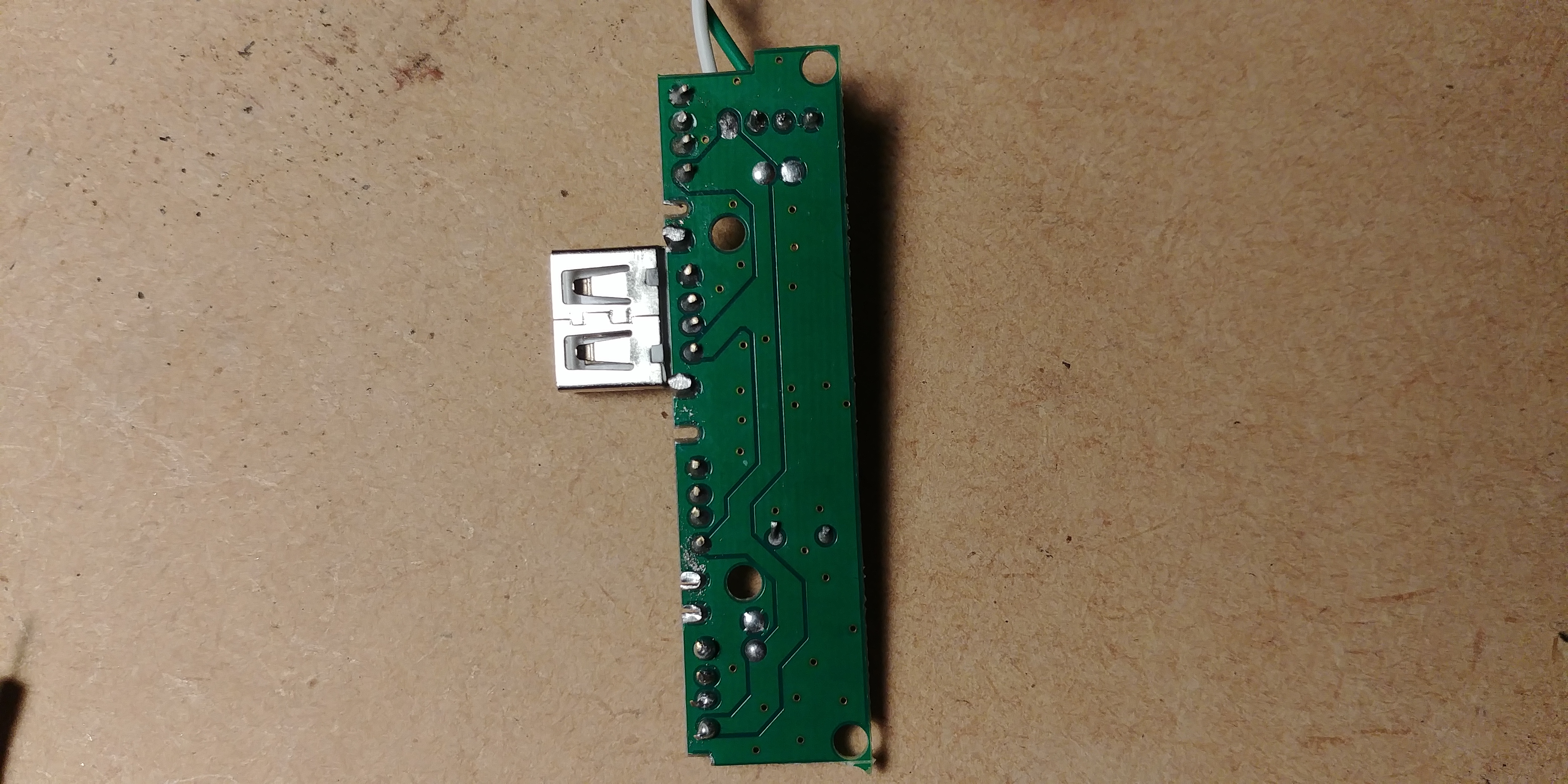

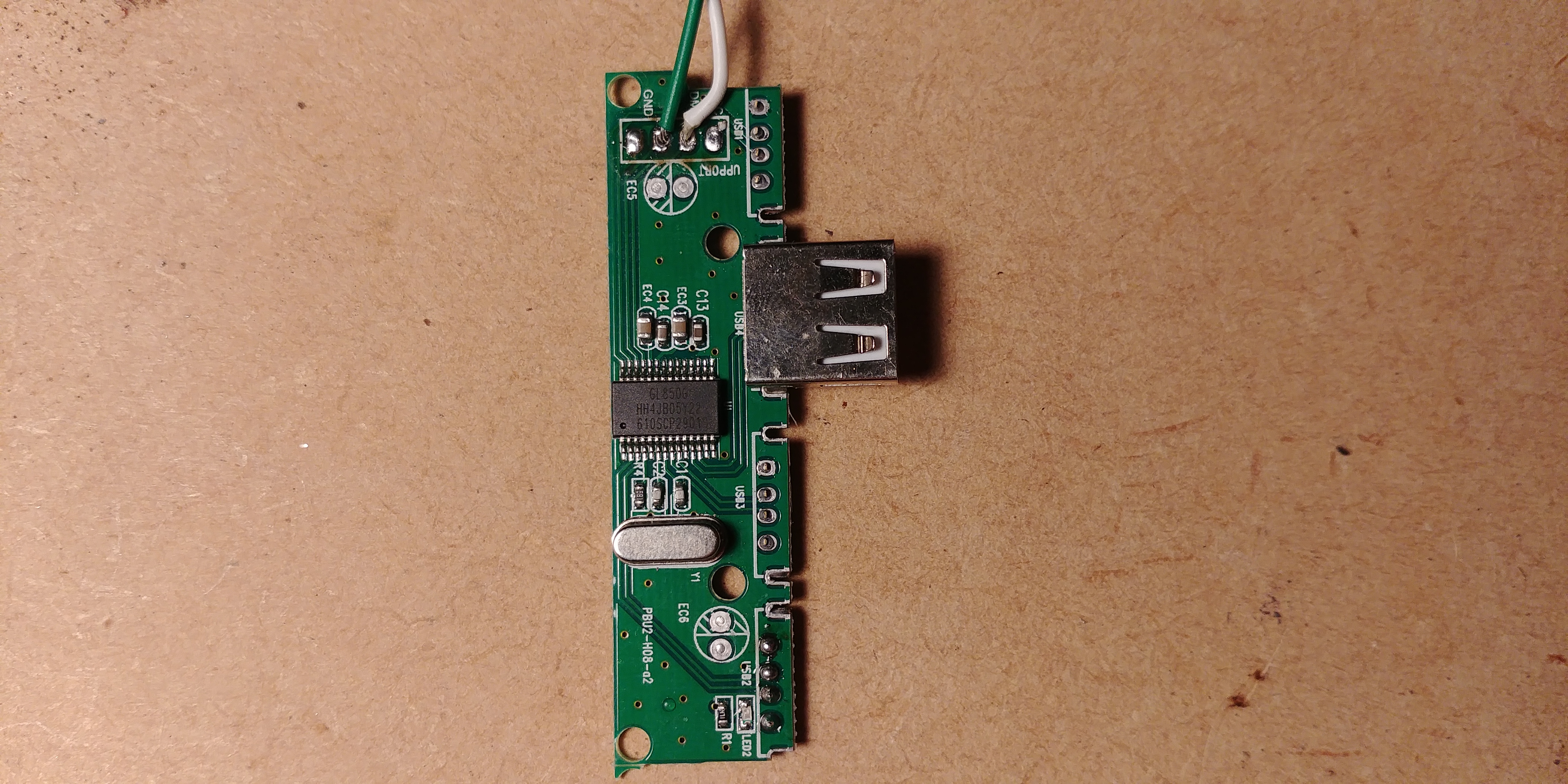

Need help with my USBHUB.
Where can I cut it without losing functions? Need to make it smaller so I can get it to fit inside my GBZ.
Would like to cut the left *empty* part so the remainings will be following: *empty* *USBFEMALE* *empty*.
Hope I posted in the right place!
Look me up on IG: gameboyzeroswe :)
Thank you!

Could you draw a line where you want to cut the board ? Use like paint or photoshop and repost the result here please

Post by VeteranGamer » Wed Dec 20, 2017 1:30 am
Wheelbite wrote:
Tue Dec 19, 2017 3:09 pm
where ever you cut it your gonna loose function, unless you make the ground continuity again.....
cut it any where around the red line
and to fix the ground, put a jumper between any two points on the ground (blue line)

Post by Wheelbite » Wed Dec 20, 2017 10:21 am

The red line is about where I want too cut it. So after cutting that I can just put a wire where the blue line is?
This was just the kind of answer I was hoping for!
Thank you very much, will try it out soon. :)

Post by Wheelbite » Wed Dec 20, 2017 10:22 am

Pretty much where VeteranGamer marked it :)
