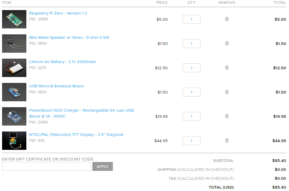

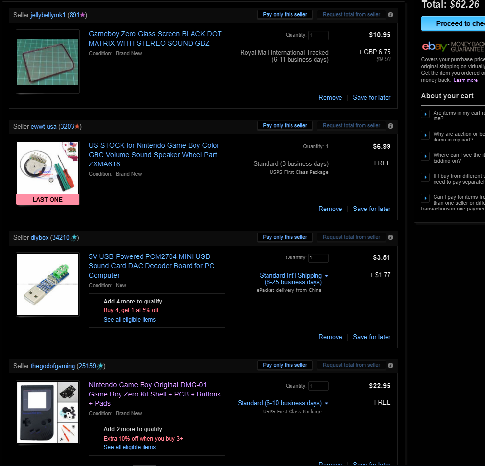

Is there anything missing?
I did look at the wiki and watched wermys videos.
I have zero experience in this kind of field. So right now I have a mix of parts from the custom game boy zero wiki and the original gameboy zero wiki. Maybe someone could link me a build tutorial with this kind of PCB I am using? I want to try to follow a build guide 1:1 I would like to experiment with options but I don't have have the knowledge on this kind of project! :lol:
Thanks in Advance
-Rob

Post by rodocop » Tue Feb 06, 2018 5:51 am
I recommend a pi zero W. It's the same but has built in Wi-Fi and Bluetooth. You can also fit a bigger battery, (you can find a perfect fit 4000 mah on ebay) I'd also get the screen from gearbest (check wiki for links) way cheaper and does not need a 5v mod.
Also, you'll need a headphone jack (only of you want one), and power switch. It's also worth looking into hoolyhoos screen bracket. It includes buttons wells and new screw posts. You can buy from him on the forums. Or have it printed yourself. Also, for should buttons you will want some type of tactile button, or have a look at the forums for erik_gee's shoulder button brackets which are also a good option.
Also, I can't tell from the photo, but make sure your kit has enough silicone button pads. If not buy some more.

I prefer the I2S amp and a DC socket rather than trying to get a mUSB to fit somewhere. Also you can get a 3000 mAh battery for about 1/2 the price, yes you give up a little bit of capacity but you can free it of its plastic case and it will also fit in the compartment with zero mods.

Ok I have updated my list now. How does this look now?
https://docs.google.com/document/d/1hSX ... sp=sharing
word document of the list
Re: Do I have the right parts?
Post by rodocop » Thu Feb 08, 2018 1:24 pm
looks good to me. Maybe get an empty game cartridge too? But I would also consider skipping the teensy, and wiring the PCB directly to the pi's GPIO's (following the link I posted earlier). But it's up to you, using the teensy will eliminate the single usb port of the pi zero, so if that is okay with you go that route. I prefer to use GPIO controls, and then extend the pi's micro USB to a full size usb out the EXT port, that way you can still connect a keyboard or something if you need, plus it fills a big gap in the case. I didn't see on the list, but if you plan to use a usb hub, then it really doesn't matter, since that will give you the extra USB's.
Also, if you're already buying a bunch of stuff from Handheld legend i'd get the gameboy case from them too, then you won't have to deal with slow ebay shipping. (might cost a few dollars more I guess).
But...... alternatively, you can check out the seller gamerszone on aliexpress, they have pretty good prices, and if you use epacket shipping (select one item with epacket shipping, and then select all others in the cart set to free shipping, they will only make you pay epacket prices once, which is really nice.) it is pretty quick considering it's coming from China, you can get all the buttons, silicone pads, volume wheels, gameboy shells/cartridges, and glass if you need it (only clear ones though, no gameboy zero branded ones like HHL)
