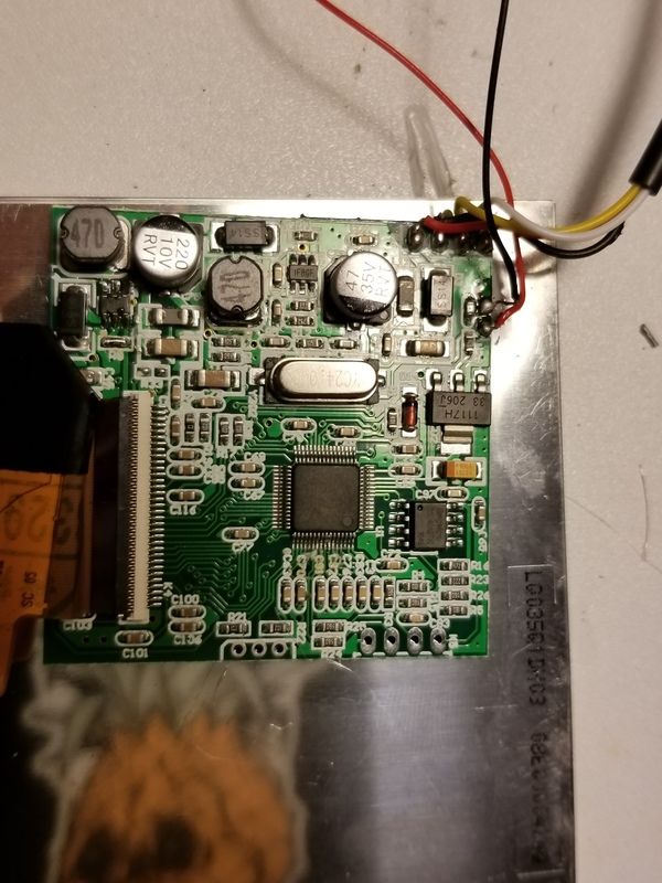

Re: Newbie with questions about 1st build.
Ok, I just got the screen connected and it is blinking a lot. I used the $15 back up screen that most people are using. I didn't see my version of the screen board on the wiki so Im not totally sure how to fix this issue.
Im guessing I need to connect a wire from one of the legs of that little black rectangle on the lower right side. If anyone knows what I need to do please help.
ok, I think this might be the same board here, "https://www.sudomod.com/wiki/index.php? ... 8_Mod1.jpg"
But I don't see any info. Do I just connect the red wire as seen in the image and that is all I need to do?
