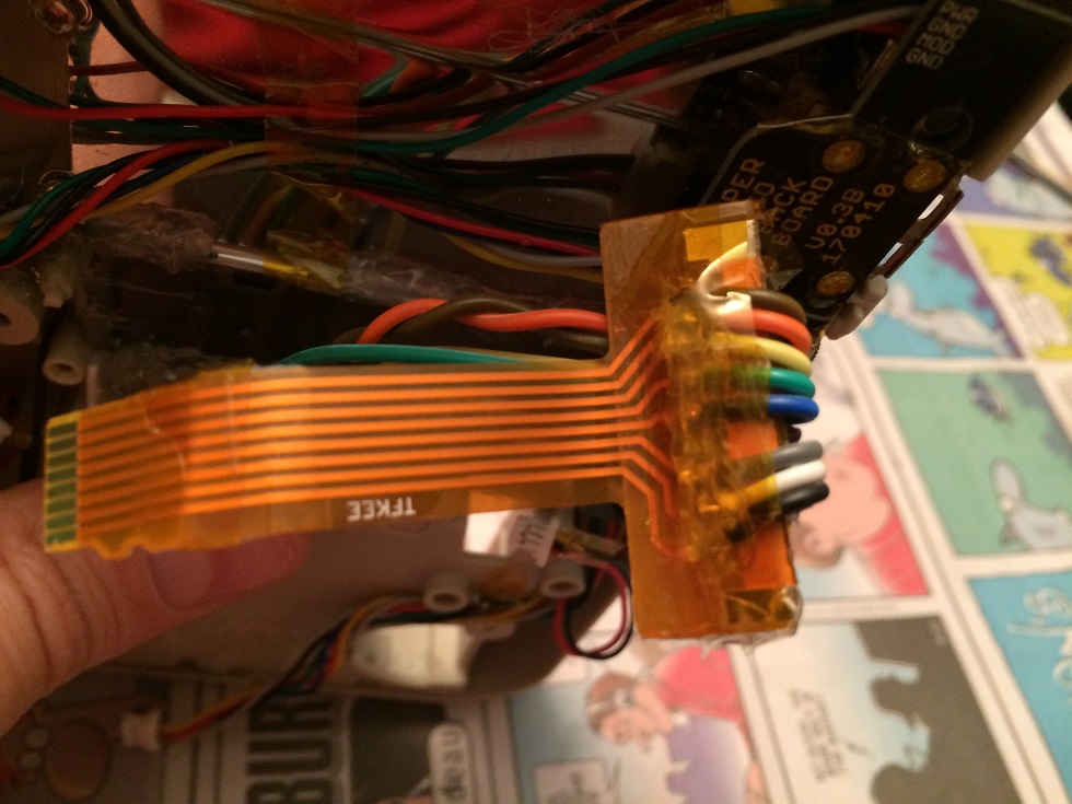

Hi all,
I have nearly finished my build and wanted to add some tweaks, like putting the SD-Card into the Cartridge.
Im using the PRS-Tech Board plus GBA Cartridge reader plus flat ribbon SD-Card extension.
I have wired everything that pin 1 from the SD-Reader from the pi matches Pin 1 in the Cartridge.
All lines have "beep" when testing but it doesnt boot up.

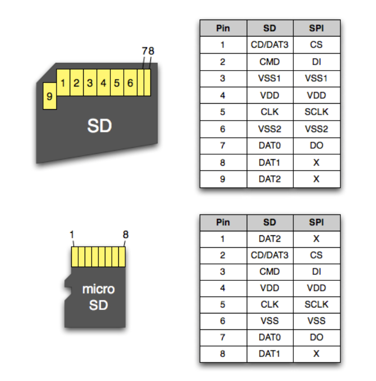

I realized PRS-Tech board only have 7 contacts used but the SD-Card has 8.
How I can check if there is a signal arriving at the pi?
I will try to shorten the lines also but I want to make sure that the wiring is correct.
Pin 6 from the SD-Card goes to Pin 15 from the Reader but there is no contact at the PRS-Board.

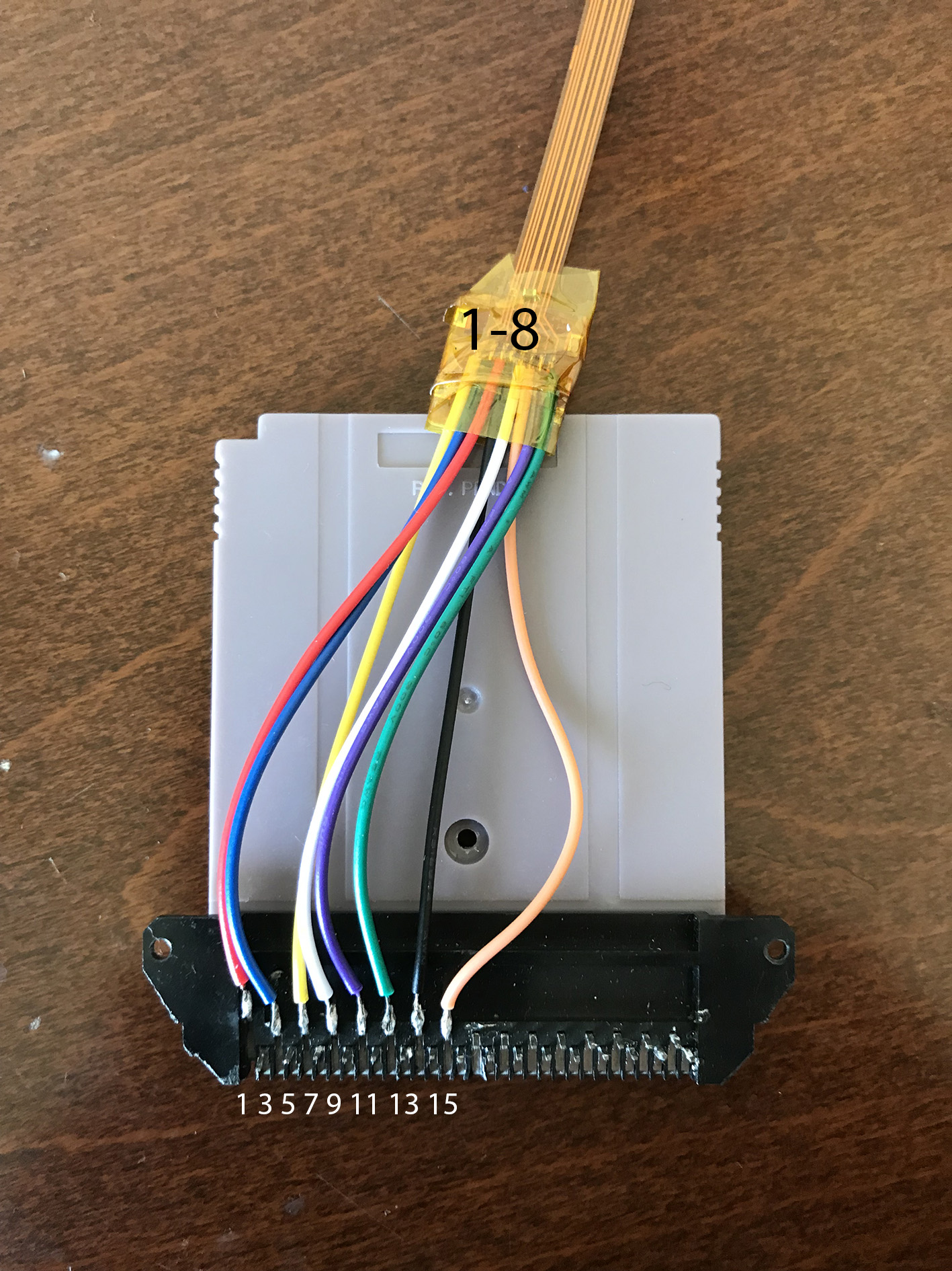

Connection from SD-Card to Cartreader is:
1->5
2->3
3->1
4->13
5->7
6->15
7->9
8->11
Im kinda lost.
Thanks for any help!

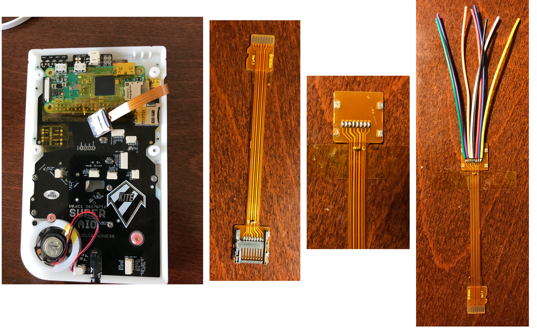

Post by YaYa » Fri Mar 16, 2018 3:56 pm
Your wires may be too long.
Here is the wiring diagrem from prs http://prs-tech.com/Tutorials/Cart-Wiri ... iring.html
Start checking here

This is the correct wiring. It matches mine -- I used the same adapter in an SAIO build also with a PRS card reader.

The sd card reader has eight pins because it has two ground pins you only need to use one ground pin
Credit to: wermy for the pictures and schematic
