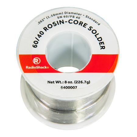

Like this stuff. The technical term is “rosin core”. This is what you want to look for. The thinner gauge, the better.
