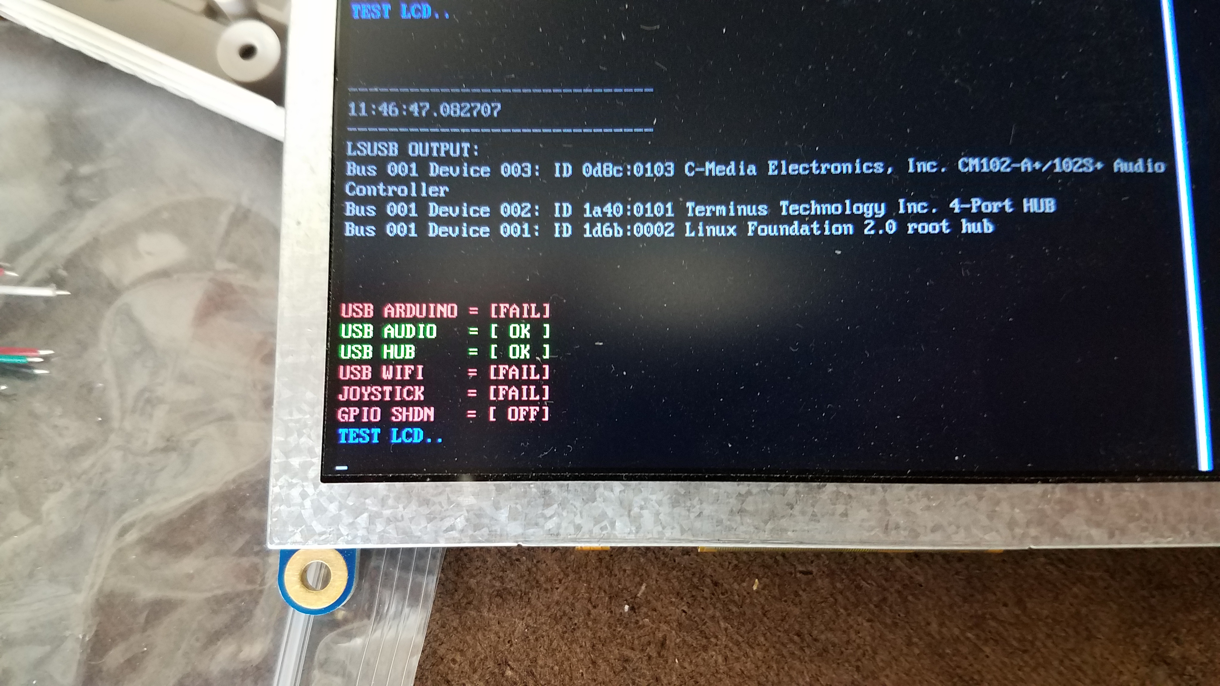

I'm finally getting around to building my Kite SAIO, and am running into a testing issue. I've finally worked the two USB pads on the Zero to finally make a connection, but am confused as to why the USB Audio and Hub work, but not the Arduino or Joystick. What pads control them? I'm working off of Kite's build on gethub here: https://github.com/kiteretro/Super-AIO/ ... SAIO-v0.6c
What do I need to look at?

What a pain, but I figured it out. One of the surface mount chips wasn't properly soldered. I was inspecting the Arduino area of the board, and noticed that there may have been a lead not properly soldered. I couldn't get a real good look at it since its so small. So I added some solder to it, and boom, Arduino and Joystick show up as OK now.
Now my question is, what's the GPIO SHDN? Mine still says off, but in Kite's example, it shows ON.
